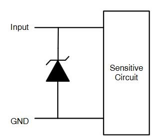

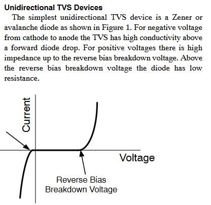

cd_sharp posted this 4 weeks ago
Hey, guys
Long time of silence. I've been trying several unidirectional TVSs as a replacement for the classical diodes. I could not see any notable difference in how the circuits behave. This was something that puzzled me for quite some time.
Today I remembered this and I did a quick lookup. I found this document (also in the attachment ).
The unidirectional TVS must be used similarly to the Zener diode. It needs to be reversed. That is the explanation for the fact that I could not see any difference from a classical diode.
Maybe some of you know this stuff already, but for me it is something new.
