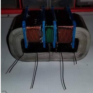

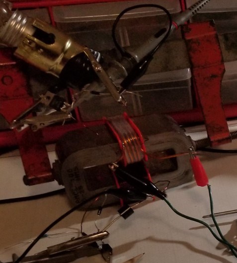

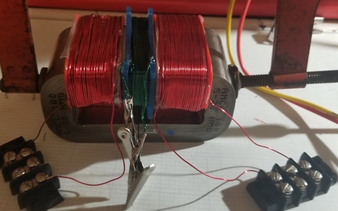

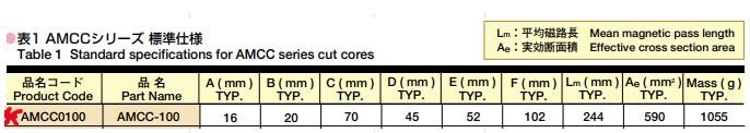

Core is Hitachi AMCC0100
Excitation primary is 22AWG, comprised of 4 parallel wires tied at the ends and then wrapped 6 times Anti-Clockwise going left (ACWL). I opted for this over thicker wire because it's easier to work with, parallel resistances & inductances decrease, I had to start somewhere, and why not?
1st and 2nd Secondary's are 23 turns. I realize now that one should probably be longer.
The 1st Secondary (left) is Clockwise going from left to right. I think this is the load coil.
The 2nd Secondary (right) is Anti-Clockwise going right to left. I think this is the assist coil.
This clockwise/anti-clockwise right hand rule left hand rule stuff is maddingly ambiguous the longer I stare at it and is incredibly fundamental and important I know. I wish I could strike the idea of current going positive to negative completely from my memory. I feel like I MUST visualize current as a phase conjugate starting from the wire end opposite the highest NEGATIVE charge but when I add coil direction to this I realize that I'm painfully disinclined mechanically.
Before I wound this thing up I spent many hours trying to make it right only to realize afterward that I never get it right the first time. I tried making a calculator to calculate current based on some wonderful pigeons calculator. His commentary is hilarious.

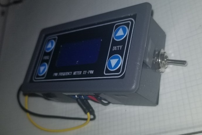

I put a toggle switch in this handy little PWM Generator

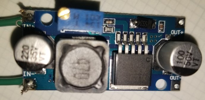

Which got it's power from this DC-DC buck/boost converter
I was originally using a 6V battery as a power source but moved to a DC power supply. I kept the buck/booster in the mix because I didn't see the harm in getting familiar with gain staging with it.

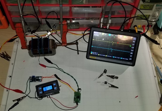

So the setup started to look something like this

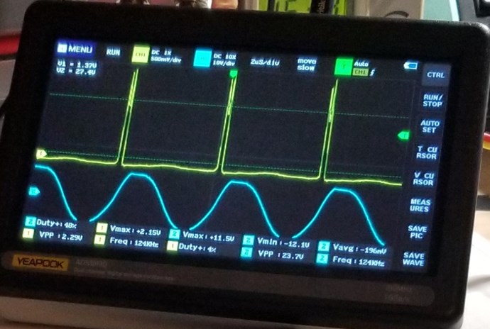

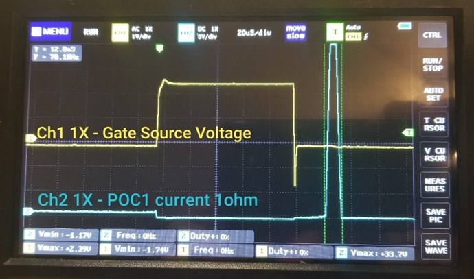

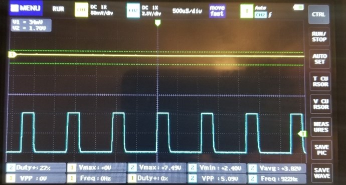

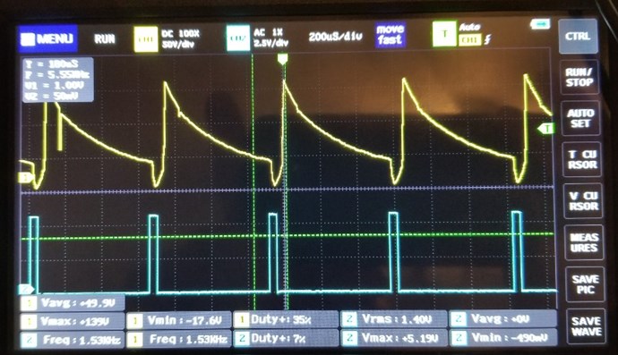

I started pulsing and looking at the voltage first to make sure I could get sharp pulses on the excitation coil (blue). At this time I think the yellow was the left coil with a diode and 1ohm resistor shorting it. note the 100x multiplier.
I connected a 7W lightbulb directly to the signal driver to see if I could get it to light up.... not so much....just a dim glow.
Next I tried step 2 and tried to get the light to glow dimly across the left secondary. only 2 coils were connected at this point... I couldn't get it done.
This is where I started questioning everything from the direction of the diodes to the windings to whether I should be using the left hand rule. I swept from 1% duty as high as 15 from 600Hz to about 5Khz adjusting the voltage to the excitation coil all while keeping an eye on the power supply to make sure I didn't go any higher than .5A.
At this point I'm tired and don't have what settings went along with with what scope plot but I kept on trying different things trying to see if I could eventually get a knack for it. I've been doing that for 2 days now.
Something felt right about the above but I have nothing to back it up. I have nothing to back anything up really.
I've been taking current measurements across a 1Ω high power "no inductance" resistor and a switching diode. I don't have 0.1Ω resistors yet. Soon.
I've been placing the diode at the ends of the coils with the line closest to the end of the coil because I want the current to travel towards the center. I've been placing the probe positive on the side of the diode closest to the coil. I don't know if this is right.
At one point I was putting in 6V and was getting out 21V or so on the left secondary (load?) coil. At that point I connected a 10V TVS across the right (assist?) coil. Nothing noteworthy happened... but that's not to say anything I've done up to this point makes one lick of sense.

Hello Kritischer,
Very nice work! Thank You for sharing! Don't worry, I fail, even now, sometimes an idea is not always as easy as it seems in ones mind! Failure is part of the path of learning.
So far, this is great!
First recommendation, study the thread: The Input Coil
It appears your Input is staying on, well after the switch off, this needs to be resolved. Input, where the switch is, once the switch ( Mosfet ) is closed, there should be no current flowing from the input, is there is, and it appears there is, there is a problem! You need to work on the Input, making sure, the Input is totally off when the Duty Cycle has ended.
Another thing, Your Input Coil and one Partnered Output need a closer Coupling, wind your Input Coil on top of one Partnered Output Coil! Make sure this Partnered Output Coil is in Transformer mode, direct Coupling to the Input Coil.
Make sure, all Coils are Loaded at all Times!
Your Thumb, the Right Hand Grip Rule, make sure your Thumb is in the Direction: 1 + -1 + 1
Conventional Current, from Positive to negative.
Of course, your Partnered Output Coils must oppose at all times! E.M.F must be induced from the Partner:
  1. Input Coil opposes POCOne
  2. POCOne opposes POCTwo
  3. POCTwo Assists your Input Coil!
You are doing a good job! Keep it up! Do not change anything else except the few things I recommended. Coupling is important!
Think of it this way, Transformer is 85%, you only need to add 15% to get to Unity! Any extra is: Above Unity!
Thank You for Sharing! This is great work! Document everything, here is you need to! Video, Images and Text. So you don't forget it. Remember, little steps for little feet!

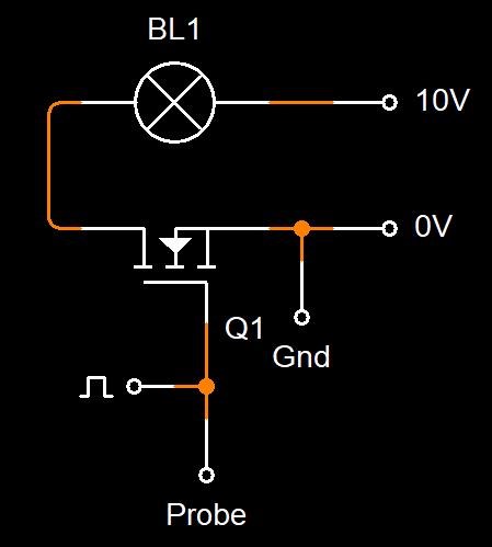

Probe the Mosfet Gate to see what the Gate is doing. Make sure the Gate is off at the right time.
It may be needed that a 1K resistor may be needed from Gate to Ground, or something similar.

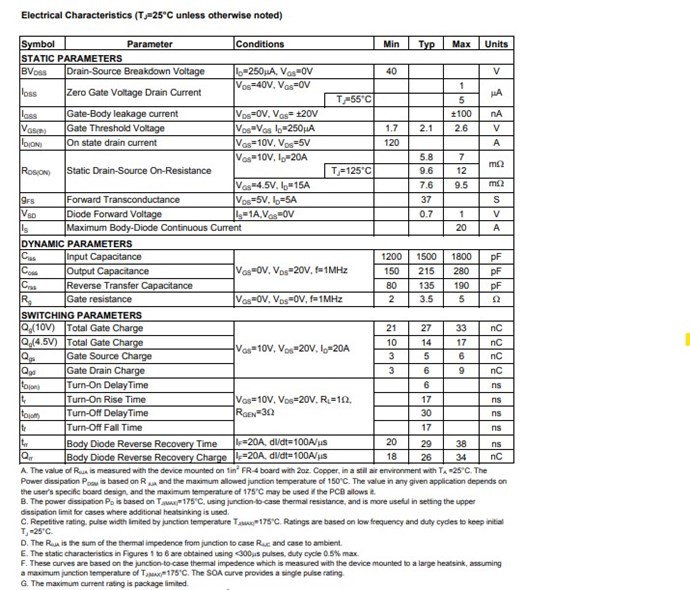

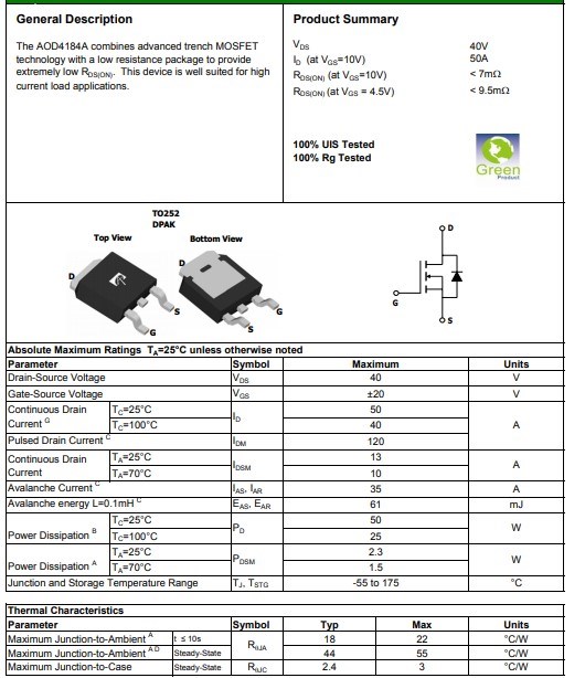

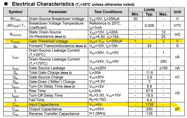

What terms can I look for to help with this? 1k from gate to ground doesnt do anything but i know it was just a suggestion. What could "or something similar" mean? I just spent over an hour trying to find the right search terms after spending an hour trying to figure out if probing the gate actually tells me anything.

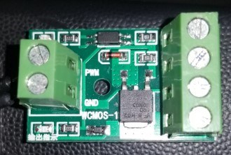

Mosfet Datasheet
 I know this isn't circuits 101 but this is a showstopper for me.
Chris posted this 29 December 2020
Hey Kritischer,

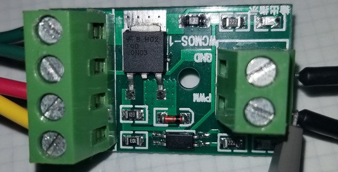

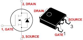

On your board, you currently have a 10K Resistor pulling the Gate Down. Probe the gate before you do anything!
The 3 digit SMD resistor code 103 stands for 10 kΩ

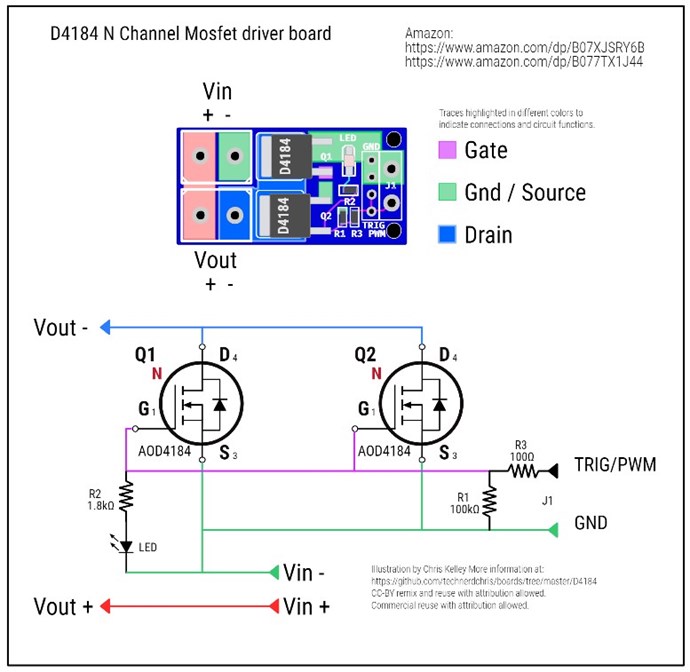

Here is your layout: SMF Mosfet:
If your Gate is Low, Zero Volts when you want it to be, then the problem is not here.
Best Wishes and Thank You for sharing!
Kritischer posted this 29 December 2020

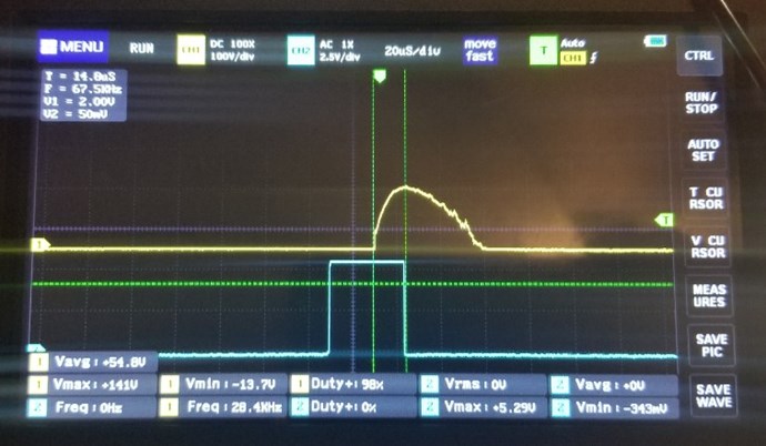

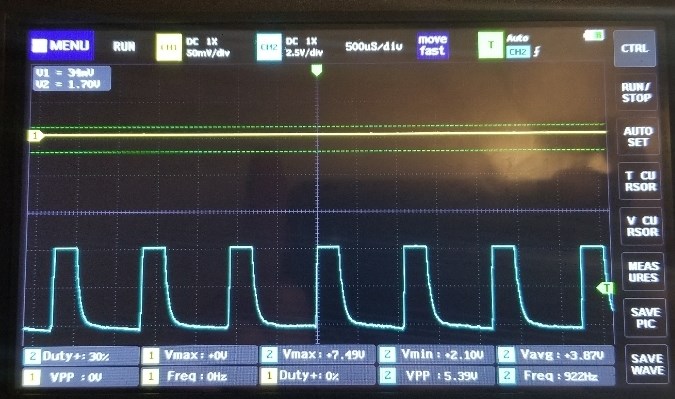

The only thing I seem to be able to improve is done by putting a 330ohm resistor between the drain and one of the grounds
OP
Hey Kritischer,
Yes, there is some slow turn off time in there! The Curve is not desirable! Un Solder the 10K Resistor and solder a 1K or 330 Ohm Resistor in place and re-test.

Hi kritischer, The issue seems to be more of general layout of your circuit. It is not likely that the pulldown resistor is the cause, although the gate signal have improved. If you are powering the device and also the driver of the switch from the same source (dcdc converter) you should connect a decoupling capacitor next to the switch, or use separate sources better, the driver IC's usually need 12- 15v for proper operation. Edit: when I was reviewing the images on the PC , I saw that the switch board seems to use a standard optocoupler, these are not designed to drive a MOSFET, it s likely the cause of the poor switching performance. I hope this helps some. Vidura.
Vidura I'm grateful to have woken up to see your thoughtful comments even though they do serve as a stark reminder that I am very much lacking in practical circuit experience. I hope that after 100hrs of actual bench time I can look back and see good progress and that after 1000hrs I can be as helpful to others as I've seen you be here.
I selected the 60N03 I've been using specifically to be driven from a 3.3v source. Do you have a strong opinion about this being a bad choice?
 I agree. I'm sure the circuit is doing exactly what it's supposed to be doing... for the way it's setup. However... it's setup incorrectly so I can't expect what it to function the way something setup correctly would.

Problem -  I realized that I'm sending more than 3V to the gate. The PWM generator output level is based on the input voltage... which is connected to the DC Supply set at a level higher than 3V. It still functions but I don't know if it has damaged the gate.

In hindsight I should have just gotten mosfet components instead of this modular thing. When I try to save time I usually waste it instead.

I recently reviewed, and have edited the last post. The MOSFET has a THRESHOLD voltage about 3 v, but should be driven by a much higher voltage. The optocoupler is not capable of driving a MOSFET properly. As optoisolated driver it could be A3120 or si826x series. Regards Vidura.
Vidura posted this 29 December 2020
For your questions: Most MOSFETs have a max gate voltage of 18-20v, you can find the value in absolute maximum rates of the datasheet. If you use a battery the decoupling capacitor ( on the rail) is likely unnecessary, using reasonable wiring layout. Although it depends on the application, the decoupling on the rail is used to provide current peaks for switching, large electrolyte caps are commonly used. There are other types of decoupling also, you can seek on internet. The last question I answered in the previous post, this module might not be the best choice for this experiment.

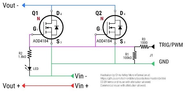

I also have several of these modules based on this D4184A N channel Mosfet that I'm going to try tonight instead. If anyone sees something that makes this a bad idea please let me know. I don't see a flyback diode but according to the seller they don't require one. Isn't that dubious?

I did some experimentation with a new primary wrapped over the 1st POC for better coupling as was recommended.
Primary is ~3 turns of what I think is either 14 or 12 AWG.
1st POC 20 turns wound opposite the primary, 16 or 18 AWG I believe
2nd PC is 30 turns wound  opposite the 1st POC, same as the primary

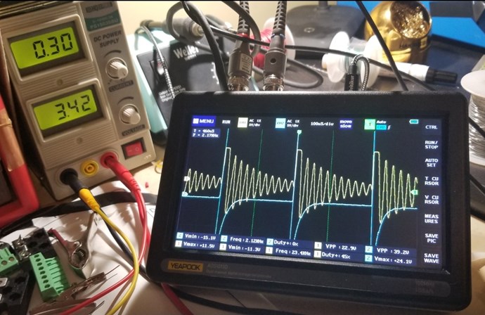

Using the module described in my previous post the power supply was set to 15V and drove the input directly.
Yellow signal is 1st POC, Blue is 2nd. I think I found a resonance of the 2nd POC at 1.24Khz, 26%DC, 15.3V on the PS.
Measurements are taken across a 1Ω resistor in series with a diode. I think the diode is going the right way...
Actually I DID have a lot of fun sweeping around trying to get a feel for what it's like to find interesting combinations of voltage, frequency, and duty cycle. I can see how getting an intuition for finding resonances can't be "taught". I can see how some people might develop a knack for it and I want to be one of those people.
I did find some combinations where waveforms seemed to fold into and out of themselves as I swept up and down in frequency.
Here is a video that can illustrate what I was seeing when I coaxed the duty cycle and power as high as I could when the power supply showed 0A.
I then put a 10V TVS across the 2nd POC but once again nothing interesting like a sawtooth wave formed. It is a bidirectional TVS and I have no idea if that was the right thing to get. That section is fuzzy to me. I don't know what to expect.
The 7W load light never did anything and is connected to the 1st POC which I think is supposed to be the load coil.
Question: Does it matter if the load goes before/after the diode?
I may need more than 15V to the input but I don't know.
The highest voltage I saw across on the second POC (1&Omega was just over 75V.
I STILL don't think the driver is turning off fast enough and and this point I don't know how to even know. I will say that I saw the voltage across the coil look vertical at a 5uS time scale...but I didn't see that signature look of "no vertical lines" that I see on other scopes.
The gates are connected to the signal via a 100Ω resistor in series and a 100K shunt to gnd. If there's anything I should be trying I sure would like to hear about it.

I'll be at it again this weekend. This is also a test message because I'm having trouble posting a reply on another topic I care about.
Chris posted this 08 January 2021
Hey Kritischer,
Good to see you're still here with us Kritischer. I think your switching circuit will be sufficient for the mean time. Its switching much better than it was.
Monitoring Input Current, aiming for the Input Current going negative after Switch off, then you have more than enough to make this work!
When you're ready, post your Input Current Scope Shot and we can see what its doing.

The POCs are now closer to 150 turns heeding CD Sharps advice. One is 4 layers, the other is 5. The number of turns per layer is about 30.
I really am struggling to forget I know that the current  and voltages are conjugates so I'm trying to use conventional current and RHR.
Last night after I wound the new POCs I had several minutes of panic that I wound them wrong again so I looked again at the simplified 3D model and made sure that was the way the windings come out at the middle (from the top) and that the primary goes the same way as the left POC. Left POC wound left to right. Right POC right to left.
Im needy and need validation haha. Is this correct winding direction?
I think looking at spirals and directions does something to my brain hemispheres that causes my "issue".
You all have been really great. No shaming or trolling. Just help. I gotta remember I'm not all alone anymore and that no one person is going to be the mentor I need so badly.

Kritischer posted this 09 January 2021
Just some quick updates:
I'm not actually sure if the titles are right. I have videos but want to edit them a bit.
POC2 not connected above.
Below is with a 10V TVS on POC2
In this video I believe I'm not sure if I'm looking at voltage or current. I'm measuring across a diode and 1ohm resistor and noticed some effects as well as felt some.

I was able to find the resonant frequencies of the POC's while the coils were open under no load
POC1:~56.5Khz
POC2:~49.0Khz
I don't even know how many turns they are at this point.
POC2 is longer, lower resonant frequency
Excitation coil 20turns 16AWG wound over POC1. Turns are opposite like a transformer
I can get 60W lightbulb to glow.
No Asymmetrical Re-gauging present on POC1 scope channel across 1Ω resistor and diode with light bulb in series. Tried reversing diode as a sanity check. sticking with conventional current model.
Tried locating POC2 to the Right of POC1/primer coil. Tried locating POC2 under and over as well.
Tried 5V, 10V, 20V, 40V TVS across POC2 in series with 1Ω resistor.
Tried switching diods across POC2 with 1Ω resistor
Tried no resistor, just switching diode
Right hand rule using conventional current checking out conceptually in my head.
Swept up and down (3V-15V) at 1%,10% 25% 50% Duty Cycle to 150Khz while watching gate and POC1 Current. Not seeing Sawtooth current on POC1. Not re-gauging,
Reviewed Asymmetrical Re-gauging thread, reviewed What is BxV Thread, ran out of steam on Some Coils Buck and some don't. It's got to be there, or It's got to be POC1 and POC2 are connected in the middle like the fcuking diagram shows, or I need to use a magnet in the core or some sh!t. That would be just the kind of trick I can't put together that keeps me wandering in darkness for eternity.
