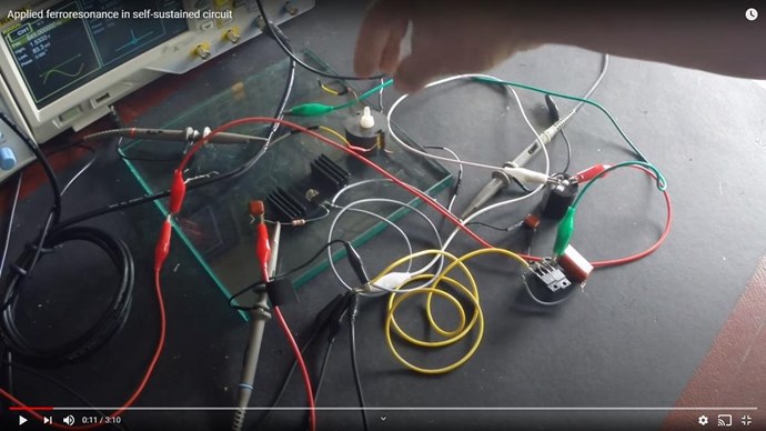

I want to first list A Valon's videos:
and:

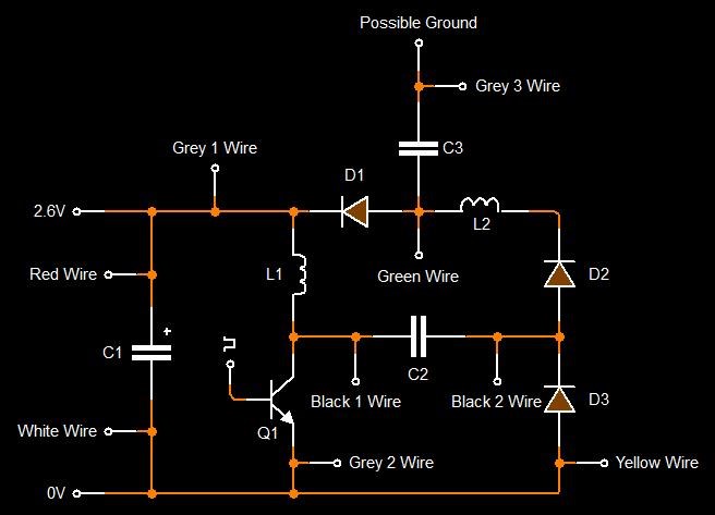

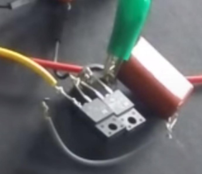

In the first video, we saw a Circuit, a bit hard to follow, but this Circuit was shown to self run:

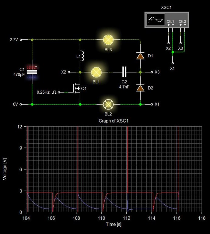

I have tried, it is a bit hard as its not clear, but tried to draw the Circuit out:
D3 to me makes no sense, but from what I can see, this is how it is drawn? Please if you see a mistake or something that needs to be fixed, please let me know!
Now, I cant help but think this experiment I have done, in replication of YoElMiCrO's Circuit Here, shown again above, shows an RLC Time Constant in the RLC Network, but I may be wrong?
I was not going to cover this, but some recent findings have led me to believe there is more here than I had previously thought.
YoElMiCrO posted this 20 July 2020
Hi all.
@Chris.
C2/D3 is a DC restorer or Clamp , this circuit
sets the negative amplitude at the input of C2 to approximately 0Vdc
on the output.
I find the non-connection terminal on C3 to ground.
Thank you in advance.
Chris posted this 20 July 2020
Hey YoElMiCrO,
Thank You for the explanation!
I have modified the Circuit above, to indicate a possible ground. However, in one part of the video, it does appear there is a disconnection:
I have marked the wire as a Possible Ground Connection. I think, as you point out, it is wise to account for a possible connection as whats not seen in this image, may be seen else where!

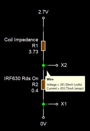

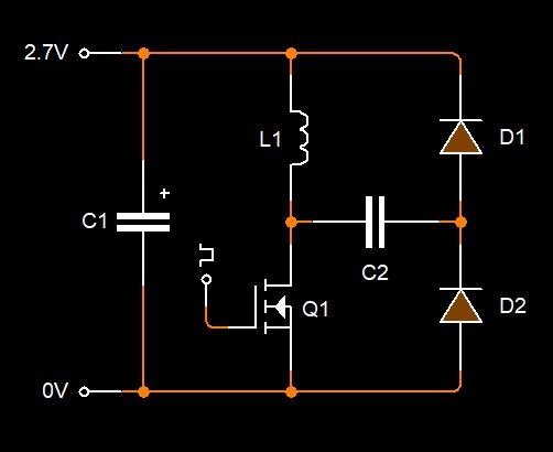

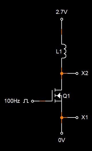

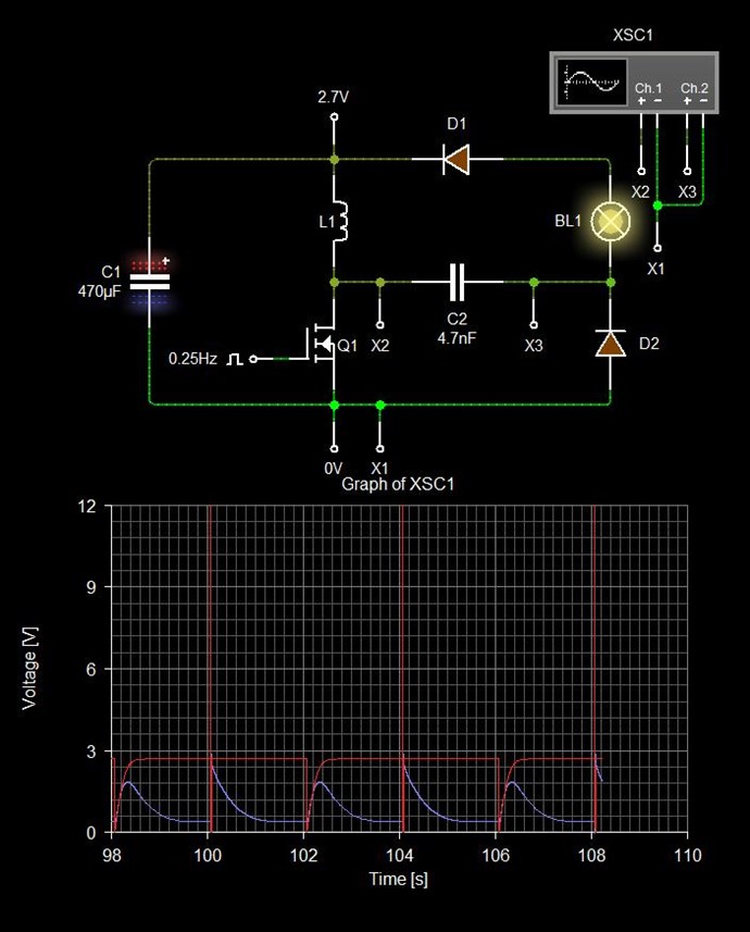

Circuit analysis. I was thinking about the circuit of Avalon, particularly the Drain of the Mosfet:
This is easy for those here more advanced than myself in Electrical Engineering, however the difference between X1 and X2 when the Mosfet Q1 is on, is only the RdsOn of the Mosfet. This means, the Difference between X1 and X1 is not quite, but nearly, Zero Volts. This means, in the above Circuit, the Capacitor C2 is Grounded, the Charge is dumped to Ground, and as we have just recently learnt, we cant see this occurring because our scope Ground Reference point is Ground.
The equivalent circuit would look something like this:
Figures may vary drastically, this is just an example. The point is, the Drain of the Mosfet may not be Zero Volts. However, the voltage will be low enough to say its being Grounded and the lower the RdsOn the closer to Ground it will be.

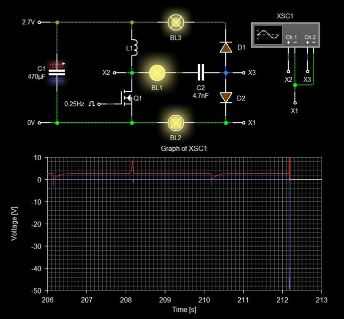

The Circuit does exhibit some unusual circumstances:
I must point out, YoElMiCrO and Vidura have already replicated this work and shown the same sort of waveform's I have shown here.

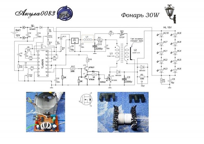

You will note the similarities to the work of Akula we studied sometime back:

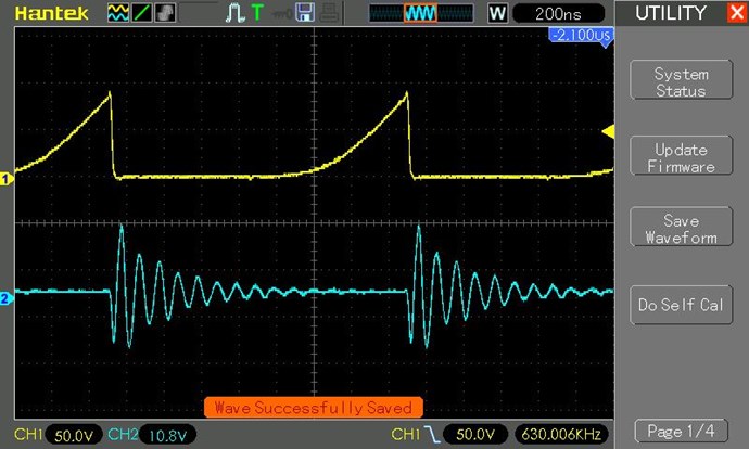

I've been waiting and waiting for anyone to come up with a ferroresonance pictures and so far, it seems, I have to do it myself.
Feast your eyes on the one attached.
The pulse's frequency is 630 kHz but the response is around 10 Mhz. (the core is a large (2") ferrite ring). Some other cores I've tested are from 600 kH to 1.5 mHz.
As a matter of interest I have ran spectrum analisys on the last one and it goes all the way to 5 Ghz. However, the ripples in the higher band are insignificant. Typically at the level of -27dB to -40dB.
~A

Very clearly shows the Interactions between the three Coils, 7 Turns, 13 Turns and 19 turns. I redrew this circuit many years ago, and shared it here: Akula0083 30 Watt Self Running Generator
