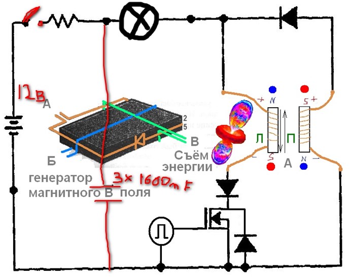

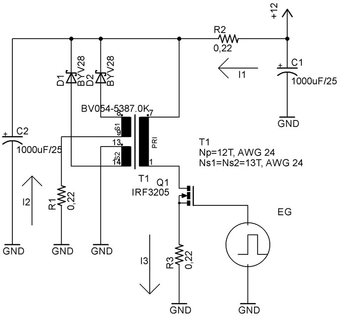

Without further ado, here is the circuit ...
I have drawn the meaning of the currents, if we analyze we will see that I3 = I1 + I2,
an inexplicable phenomenon, but let's continue.

Now, if we connect the secondary S1 in the way we see in the circuit, we will observe the following; by having induced in the forward direction a voltage equal to that of the primary plus the
drop voltage of the serial diode the voltage that supplies the power supply will be seen
negative in the resistor R1 and the current flowing in said path will be reflected in the
primary, being I1 + I2 for the same time of Ton, the curious thing here is the following.
This current should be supplied by the power source, but it is not, that source
it only feeds the current needed to magnetize the nucleus and S2 becomes a source
more food, this should extract its energy from the environment that surrounds us and what
shows by the temperature difference in the core.
On the other hand, the output power that we take in R3 is 0.5 (di / dt) ^ 2R3 (Ton / T), being the
new di / dt the slope for a Lp much smaller than the initial one, the lower the Lp
higher output power and is tightly bound to the ferromagnetic material that the shape,
specifically with the variation in its permeability.

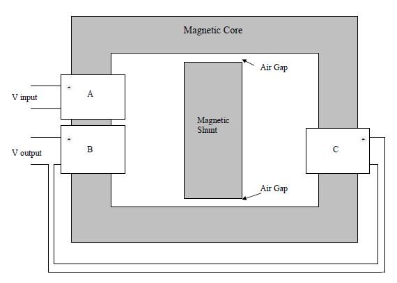

  • Atti
Chris posted this 30 January 2019
Thanks for sharing Zanzal!
S1 and S2 must have sufficient interactions, both equal and opposite for Current, Voltage is not the case, same as The Mr Preva Experiment.
I tend to agree, we are not yet at the stage where running machines would benefit the community, we don't have sufficient momentum yet. It would just create division, as some do not yet have sufficient knowledge of what we are doing!
  • Atti

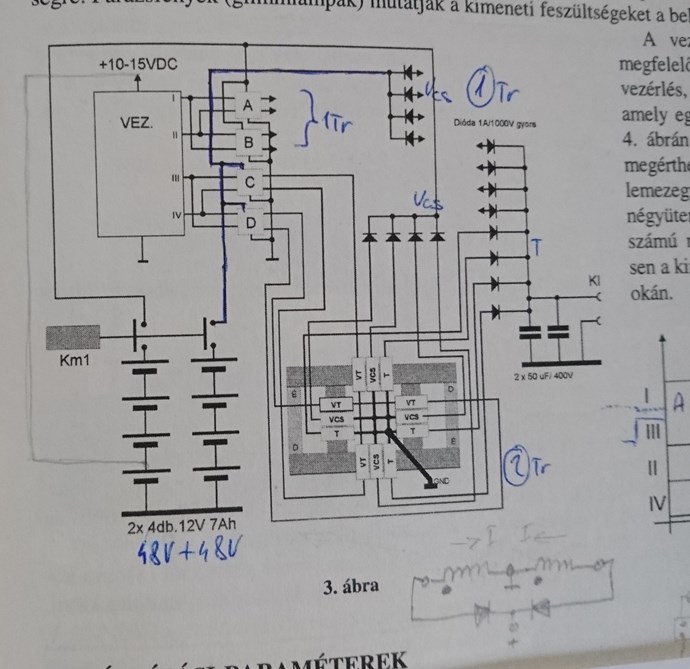

Atti posted this 30 January 2019
Can be replaced according to the two drawings above: S1-T, S2-VCS. VT is the control coil.  The VT coil is twice the coil T. So there is a noticeable similarity in other works. It is also worth using performance measurement for a better understanding.

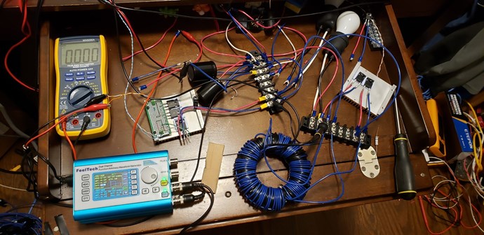

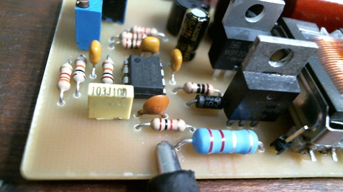

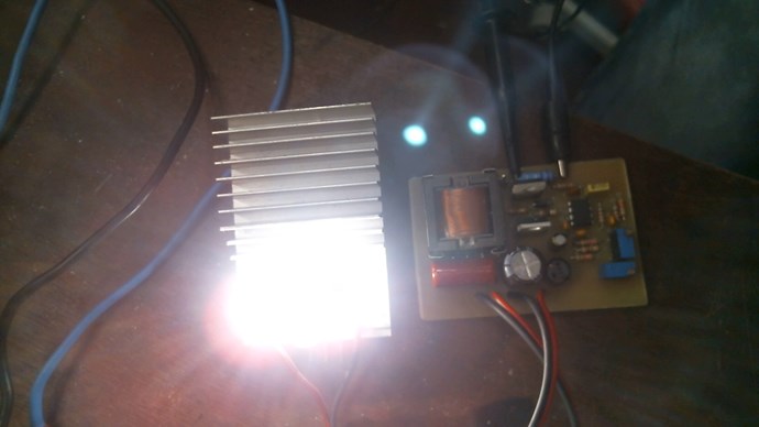

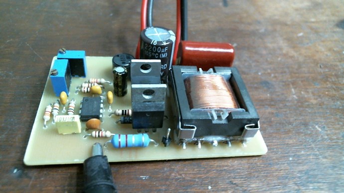

YoElMiCrO posted this 01 February 2019
Hi all.
Here some images of the circuit assembled.
I still do not have the 3W led, when I do
tests post oscillograms and powers.

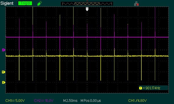

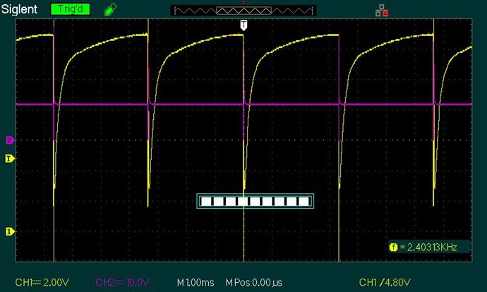

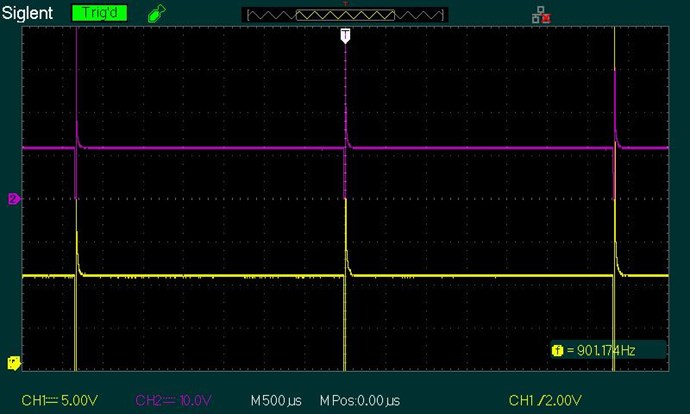

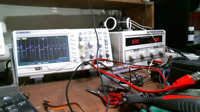

YoElMiCrO posted this 07 February 2019
Hi all.
I have already done tests.
Yes !, Chris is right when he says that this phenomenon obeys the experiment of
current made by Mr Preva, only that in this circuit the point of operation is in the first quadrant of the hysteresis cycle, not as in the case of MrPreva which are the two quadrants of the cycle, the first and third.

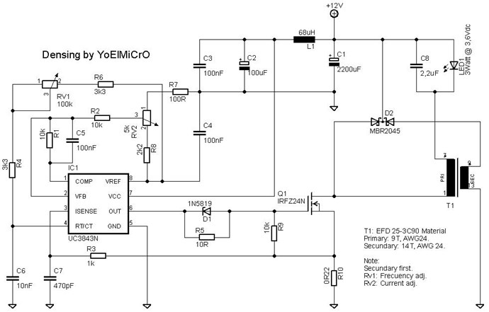

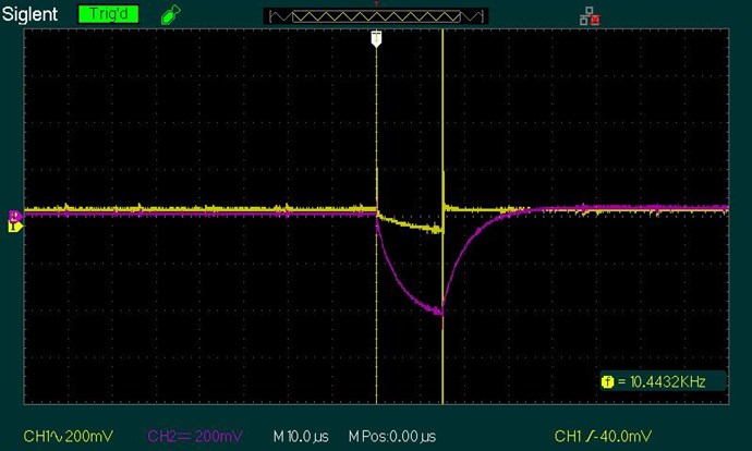

The circuit in question is this ...

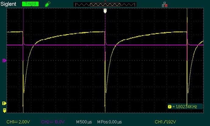

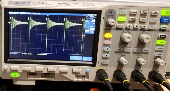

Let's look at this oscillogram ...
The two di / dt are appreciated, the one with the lowest slope is the one that sees the source of supply
and the one with the steepest slope is the one that circulates through the load, I1 and I3.
Analyzing the situation we observed that the inductance fell in value for the load, because
It is the same TonVdc and its slope is greater.
For this circuit to work, the primary voltage must be constant, that is, the
sum of the individual tensions will be the supply.
In this circuit, the output voltage will always be lower than the supply voltage, as
a Buck converter would do it, however the relation VdcTon / T = Vout does not apply and its point of operation will be at the discontinuous / continuous boundary.
For this particular case the LED is ~3.6V@830mA and the 12Vdc supply source,
as the average current of the led is 0.83A, the peak current should be 2 * 0.83 = 1.66A and we will adjust Rv2 until the voltage in resistor R10 has a greater peak equal to 365mV in the ramp, the frequency should be more low while adjusting this current, note that this current is the sum of the two individual I1 and I2.
Then we can adjust Rv1 to finally set the point of operation in the border continuously, if necessary we can change C6, to readjust Rv1 again.
The calculation of the transformer is as follows ...
Edc = Vled + Vp + Vsat + Vr10, if we ignore the voltage drops Vsat + Vr10 we will remain
that Vp = Edc-Vled and we can calculate the number of turns for the primary.
Suppose FSw = 55KHz, Ae = 58mm², Bm = 0.25T and Ton = 85% T = 0.85 * 18uS = 15uS.
These data are for the EFD25 that you use, this saturates ~ 0.330T and we will have to be
below this value, also how it works on a fordward basis should not have a gap
the core used.
We calculate then ...
Np = VpTon / (BmAe) = (12-3.6) * 15 / (0.25 * 58) = 8.6 ~ 9Turns for the primary.
As the voltage that is induced in the secondary must be Edc + Vfd, then ...
Ns = VsNp / Vp = (12 + 1) * 9 / (12-3.6) = 13.9 ~ 14Turns for the secondary.
And these will be the data of the transformer, as they see the energy stored in the
primary is also added to the load during the demagnetization cycle through
of the half of the diode D2, not being so in the circuit proposed above.

I may be interpreting the Scope incorrectly, if so ignore my post:
Perhaps the Coils may have the wrong polarity? The Sawtooth waveform is should look like this:
Very nice build! Thanks for sharing!

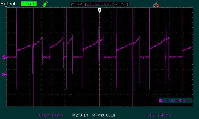

Jagau posted this 13 February 2019
Hy Yo
your scope look like have 2 beat frequency with 2 high peak, like Akula?
YoElMiCrO posted this 13 February 2019
jagau, it's a single oscillator.
Just as it is in current, when you adjust the frequency
a second frequency appears, that is normal because
the current in the primary takes more time than the period of
oscillation.
Very interesting
Could you show me a picture closer to your oscilloscope, if you do not mind?
thank you YoEIiCRo
Here it is, jagau.
Chris, that saw tooth is inverted, if that were the case, it would refer to a negative inductor.
In the case of my image, it is the primary current.
Chris posted this 13 February 2019
Hey YoElMiCrO,
I thought that might be the case. Thanks for pointing me in the right direction!
Thank you Yo
This is well channel 2 at output?
Atti posted this 16 February 2019
Greetings. Excuse me if you know, but I find it interesting. Maybe you have to keep in mind your theory to see if it comes to something else. Excuse me once again if you already know. https://www.semanticscholar.org/paper/Integrated-magnetics-for-current-doubler-rectifiers-Sun-Webb/aaf51cdc13e06e32b20e04263a00674855d2f4b2
Chris posted this 16 February 2019
@Atti,
Nice example! Another example is A Novel Transformer with Compensating Coil
I Quote:
The inducted voltage in coil B must be larger than that of coil C, otherwise the transformer will require more input power than the output power.
Ref: Xiaodong Liu, Qichang Liang, Yu Liang - Department of Nuclear Physics, China Institute of Atomic Energy.
The pdf is attached.

Jagau, channel 2 is measuring the current in the primary, exactly at the junction of the sourse of the mosfet and R10, at that point
the magnetizing current plus the reflected current of the secondary (i3), that is the sum of (i1 + i2).

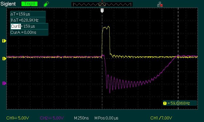

YoElMiCrO posted this 17 February 2019
Hi all.
Today I have been doing analysis and testing
to determine whether or not there is energy gain.
I have tested the method described by N.E. Zaev and yes is right, as soon as I finish trying the circuit.
I post it to check the observed.
Look at this oscillogram ...
The yellow trace is the pulse of the Mosfet Gate.
The purple trace is the one observed in his Drain.
If you look well, you will see that time expands.

alohalaoha posted this 10 April 2019
Self oscillating circuit at partnered topology, made by Russian guy alias "Osbourne". What is extremely interesting, this circuit has self oscillating behaviour, several minutes after power was turned off. Marking Л is CCW winding, while П is CW winding. Colored structure is Ether form buily by two partnered coils. Center toroidal vortex is vector magnetic field, while two blobs are scalar magnetic field of opposite sign. One is relative minus, other plus, or precise, one has righ hand spin, other left hand spin. Leading blob has left chirality. These data are results of preliminary Ether research of opposite coil configuration, known from Chris Sykes terminology as "partnered coils". Next experiments with barium ferrite, with 3 orthogonal coils. One is in same config as shown on pic, other is input for steady B field, and 3rd for output. Output could be again in partnered, or tesla bifilar, or caduceus conf, or combination of them. Very promising configuration for Ether's power extraction.
Cxema:
Tuned parameters were:
Frequency = 1500 Hz, Skvaznost = 4% {or reciprocial of Duty cycle; S= T/ τau or S = 1/D.D=25}.
All diodes schottky, 3 capacitors 1600uF/25V, infineon mosfet transistor with turn off delay 15nS, two partnered coils 23mH each, ferrite data on pic.
Author continue work. His goal is house heating system for cold Russian winters.

YoElMiCrO posted this 23 April 2019
Hi all...
Aloha, that circuit obeys the phenomenon observed in the
Fordward topology, now called by my (NLCC) No Loss Clamp Circuit.
The duration of work without feeding is due to the fact that only
consumes an infima part of the supply source (I1)
in this case the energy stored in the three input capacitors,
but there is another energy comes from the own core (I2) of the secondary side,
in this case it is better to put the serial charge to the primary and remove turns to it.
YoElMiCrO
