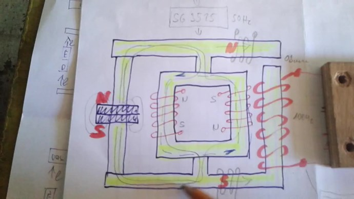

Recently after I saw one of Chris' post about someone asking in private for Tom Bearden's "Energy from the Vacuum" DVDs Collection I became curious and wanted to see what those DVDs contain.
For now I only saw the first DVD from that collection and I already found out there are hidden gems on those DVDs. Really important stuff !
One of them is what I post here and it's Bearden explanation on how MEG really works. It's a paradigm-shifting video segment and I'd wish I'd saw it few years ago when I was trying to replicate MEG.
This is the video segment I'm talking about:
There are a few paradigm-changing conclusions:
  1. J.L. Naudin's explanation on how MEG works is totally wrong. So this simulation is wrong:
The role of the permanent magnet is not to have his magnetic field switched to left and right core sections by the small command coils.
2. Seems that when a permanent magnet is placed inside of the core without gap so the entire magnetic flux of the permanent magnet is "sucked" inside of the core and become trapped there are two effects:
  • the permanent magnet become almost inert so it stops emitting magnetic field around it or (depending of how close to 0 mm is the gap between it and the core) it's emitting a very small magnetic field compared to its original magnetic field;
  • when the previous conditions are happening and almost all the magnetic field of the permanent magnet is trapped inside the core something new happens: outside of the core a zero-point/quantum/aether (however you call it) field is formed containing additional energy ready to be captured by our device.
3. The practical way of capturing additional energy from that new zero-point/quantum/aether field formed outside of the core is to "shake" that field by pulsing the small command coils on top of the MEG. That will make the output coils capture the additional energy contained in that field therefore zero-point energy is added to the device's output.
4. Tom says MEG's output actually contains multiple and very complex signals which our actual instruments (including the oscilloscopes) are unable or have major difficulties to analyze; he says that because of this there is very difficult to calculate the real energy from the output and expensive specialists and specialized instruments are required for calculating MEG's COP.
5. Seems COP 5 is not the limit for MEG, it can go higher but in the prototype trying to go higher would burn the output coils.
6. He's talking about "nano-crystalline material, there's 2-3 types which would do it"; Metglas AMCC core is actually amorphous metal alloy, not nano-crystalline, so I'm not sure it's one of those 2-3 types Bearden is talking about. What if it's not, what if when placing a permanent magnet inside a AMCC core the magnetic field is not "sucked" and trapped inside the core or what if that zero-point field is not forming around the core ? In my experiments I used AMCC-200 but what if, to really have that zero-point field forming around the core, a nano-crystalline core like Hitachi F3CC0125 is required ? Since seems that zero-point field forming outside of the core cannot be detected directly is difficult to verify if amorphous metal cores are able to have that effect or not. If not then I experimented for years with a wrong core so this is a important question which I have no answer for it right now.

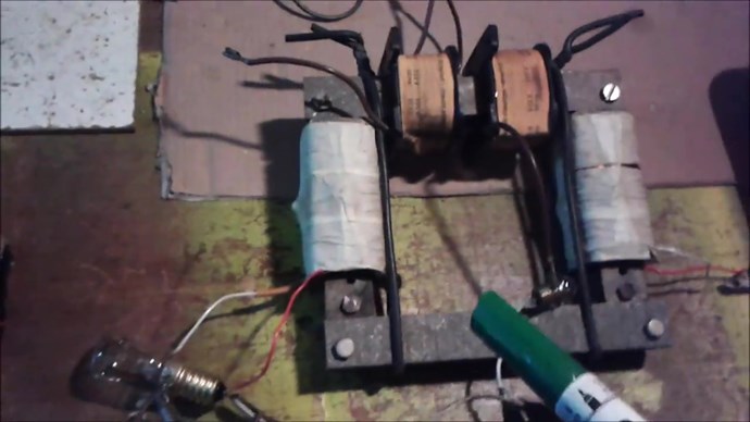

Some updates. Preparing for experiments doesn't work according to my plan, I'll explain below.
First, I'm posting the characteristics of the coils as measured by my LCR, here you can see only the left coil but right coil is almost the same, there is just a difference of +/- 10 turns (link to larger image here):
I've built assembled 3 of measurement blocks made by Chris and I've built a flexible circuit with connectors and wires so I can easily attach loads (12V/5W light bulbs) and easily insert measurement blocks in the circuit when required (link to larger image here):
Also I received the two 20x20x25mm ferrite magnets I bought from local market. The small 7x7x25mm ferrite magnets I ordered from UK just entered in country, seems they are transported on ground by truck so probably I'll receive them someday in the incoming week.
So the plan with these two similar coils was to make first a standard 1:1 transformer and then to experiment with different magnetic force and to observe eventually a increase in the power on the secondary coil (the coil on the right side).
Well, seems like the 250 turns using 0.6 mm copper wire are not okay for a 1:1 transformer with this core. The 12V/5W light bulb on the secondary (right-side) coil is not working at all when powering with pulsed 12V the primary (left-side) coil no matter what frequency or duty-cycle I use. I had a conversation with Cd_Sharp and seems the 250 turns are too much for the coils.
The light bulb start to shine only when I use pulsed 25V with 500Hz and 50% duty-cycle (link to larger image here):
But what I found out in this configuration is, even if the light bulb on the secondary (right-side coil) is shining very weak, I have high voltage back-EMF on the primary (left-side coil), if I put the 220V/70W light bulb in parallel on the primary coil I have it shining, it's weak but still it's a 220V/70W light bulb ! (link to larger image here):
Notice the consumption seen by the DC source (not sure how accurate it is) is just about 100mA higher.
And a note: the primary coil starts to warm up slowly in this configuration.
So right now I have a problem with a standard 1:1 transformer which is not working as expected but which unexpectedly creates a pretty strong back-EMF in the primary.
I'll need to figure out and fix the 1:1 functionality issue and to figure out what;s with that back-EMF.
I'll need to try to calculate properly coils for a 1:1 transformer for this core. I'm not that good at transformer calculations, I'll try to figure out how to use Chris's calculator.
So as I said the preparation for experiments don't work as I planned for now.
I'll post updates when I'll figure out these issues and fix them.

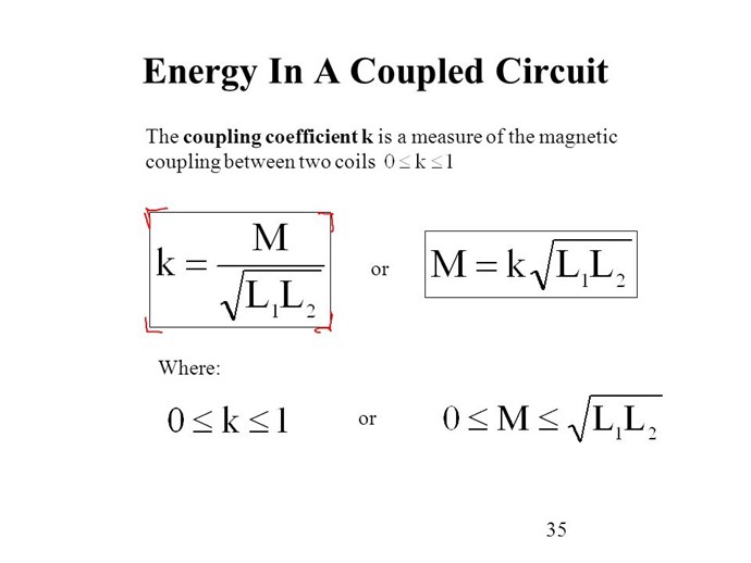

Chris posted this 05 July 2020
Hey Fighter,
Awesome update, Thank You for Sharing!
Coupling Factor is a big problem, as Coils are further away from each other, the Coupling falls off sharply. Unity Coupling, where one coil is wound on top of the other, normally Secondary wound on top of the Primary, achieves this Unity Coupling.
Unity Coupling in most cases is modeled as 1 when in reality it may be 0.95 or something. 1 is max, 0 is min. I am sure others here can elaborate further on this if you need more info, Jagau, Vidura or YoElMiCrO or someone. I believe YoElMiCrO was pointing towards this Here.
Of course, you already know about Magnetic Field Symmetry and Asymmetry and how we need Asymmetry for Energy "Generation" in excess of the Unity Boundary, and how this cant be achieved using Symmetry.
Great work, thanks for sharing, this is important stuff to experiment with and important to know about!

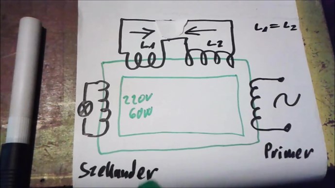

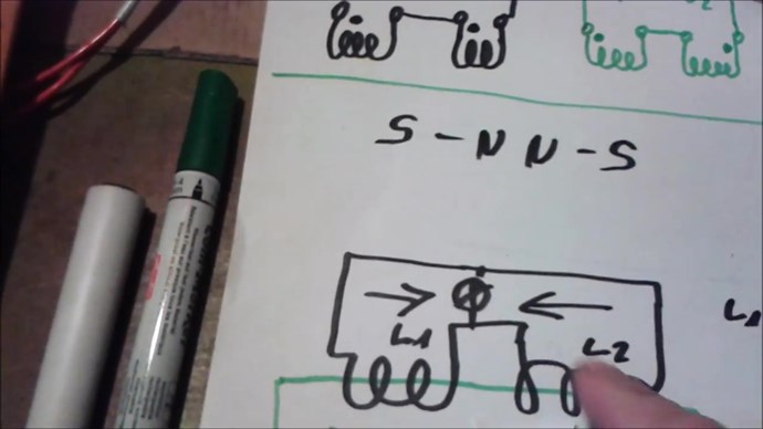

We all know how a transformer is made. What happens if we have a coil which is not around the core like this ?
Will it receive any voltage or current on it ?
The question could be seen as stupid but it's not, the reason I'm asking this is because I'm looking for a way to detect/measure a electric field formed outside of the core.
The hypothesis is the scenario described by Bearden: outside the core is present a uncurled A potential (Aharonov-Bohm effect) but in order to detect it we need to disturb it by applying sharp pulses in the primary so it starts producing electric (not magnetic !) fields.
So the coil from the figure above will "ignore" what's going on in the standard transformer and "see" only the electric fields formed outside the core ?
I need something like this in order to find the right magnetic field (from permanent magnets) required for the core to have the Aharonov-Bohm effect manifesting and producing uncurled A potential outside of the core. Without this I have no way of knowing if the Aharonov-Bohm effect is actually manifesting or not in my experiment (the magnetic field from the permanent magnets could be too weak or too strong).
Do you think this could work as intended ? Any other ideas are more than welcome !
raivope posted this 12 July 2020
It is always worth to try (intuition tells you may not see much), but I would suggest (as according to Hector's teaching) to wrap coil(s) fully around the core to detect radiant pulses. You will see peaks on scope. When this happens have LC around the core to tap.
Fighter posted this 12 July 2020
Hi Raivope,
The idea is to have a coil (detector) which ignores what the classical transformer does. Wrapping this coil around the core will make it sense everything including the magnetic field pulsing in the core. I would like to avoid sensing the magnetic field inside the core. I just want to see only the electric field (not magnetic) forming around the core when the uncurled A potential is disturbed by the pulses coming from the primary. Maybe I didn't understood correctly your idea ?

Chris posted this 12 July 2020
Hey Fighter,
Regarding your question:
This is a case of Coupling, if there is Flux that Couples the Coil you mention, to "Generate" a E.M.F or Voltage, because E.M.F is measured in Units of Volts, then a Current will Flow.
Normally, very little flux is outside the Core, but with Bucking Coils, we can have more Flux compared to normal, especially in loose coupled situations, E.G: Not Unity Coupled.

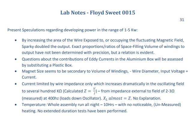

Of course, Floyd Sweets Lab Notes are well worth studding! What is contained here is very important start!

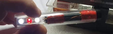

Meanwhile as you know I was looking for a way to find out what's happening around this device while it's powered so I did some experiments (link to larger image here):
So I come up with a very simple but extremely helpful tool not only for this device but for all our devices.
I'm using a ferrite rod I have from a radio, a coil on it and 3 LEDs connected to the coil: two having the same polarity and one having opposite polarity. The red LED have higher voltage (12V) so it's less sensitive but can indicate the strength of the pulsing magnetic field. The other two white LEDs have lower voltage (4.5V, I have them from some Chinese lighters) so they're very sensitive and can indicate magnetic polarity. Also because the core of the coil is a ferrite rod it can indicate the direction of the pulsing magnetic field. I tested it within 50Hz - 100KHz range and it works.
So if around a device there is a pulsing magnetic the tool is able to show that magnetic field's strength, direction and polarity.
It also can be very useful to see if your device is spilling magnetic field in space like in my case where the coils I've made seems to be too powerful for this core (I'll need to rebuild them).
This is how I've built this tool (link to larger image here):
Here is indicating the magnetic North and South poles, for North indicating also the strength - the red LED:
And here it shows how much magnetic field my current configuration is spilling into space, so I'm sure now the A-B effect is not present with this configuration, I'll definitively need to rebuild the coils (link to larger image here):
So if you need to check what's happening outside of your device a tool like this could be very useful, if you have questions about it please let me know.
Now the interesting part will be would be to have something similar to detect a electric field which should form around the core when the A-B field is present. I was thinking about a coil made using aluminum coil and air core, not sure if that would work as a electric field detector, I need to think more and make some research.
Both tools are required to find the correct configuration of coils and permanent magnet strength for the testing scenario.

Hello Jagau,
Sure, this is the schema of the tester:
The details can be found on my post above made on 16th July 2020.
For the coil I used 0.2 mm copper wire but I didn't counted the number of turns, I just used some wire left from other experiments.
Looking at the photo I took at that time could be a few hundreds of turns I guess (link to larger image here):
The "normal LED" (red color) is an 12V LED, the other two LEDs (while color) are more sensitive (I suppose they have very low voltage) and I took them from some Chinese lighters like this (link to larger image here):
And this is a photo of how the LEDs are connected inside the tester (in parallel) just the top white LED which indicates BEMF have inverted polarity than the other two LEDs (link to larger image here):
Before soldering the LEDs to the coil output you must test their polarity to make sure they are indicating correctly, meaning the top white LED is indicating BEMF (magnetic south pole) even if it's weak and the other two LEDs below it (red and white) are indicating EMF (magnetic north pole). The 12V red LED is actually indicating how powerful the pulsing N field is while the white LED below indicates just the presence of the pulsing N field even if it's weak. If it's a weak pulsing N field the red LED's light is weak too or even off.
I've made this process using the ZPM, knowing that on top of ZPM are two pulsing and opposing magnetic N fields and at the bottom of the ZPM are two pulsing and magnetic opposing S fields.
This is the description of the tool, if I didn't explained too well something please feel free to ask and I'll answer to your questions.
