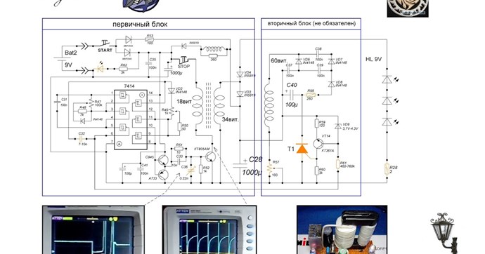

Hi, Chris! Can you please take a look at this circuit? Is this the right circuit you have in mind for finding the resonant frequencies? Did I understand correctly that we should be comparing current pulses from the input vs current pulses at the output? Or should we compare voltage pulses on the input vs voltage pulses on the output? Thanks
Hi Cd_Sharp, if you dont mind me saying, youre diverging from what the Circuit and original device was doing.
I recommend a look back at the thread: Akula's 30 W lantern - I posted more data there the other day, of another replication.
You will see the LC Time constant in the Scopeshots as the Curve, the Resonance, you already achieved with the MrPreva Replication, the Currents will be opposing, the same, but carefully look at the Videos, look at what they are tuning for.
This is not LC Resonance.
Hi Cd_Sharp - That's just what I would do.
The Coils are where we need to concentrate, looking at the Current Directions at the same time. Ensuring we have met the requirements needed to "Generate" the excess Energy we are looking for.
It may be the Core may need to be changed? I have found some cores better than others?
Just trying to help, hope you don't mind me pointing out these things.
I posted this toMy Replication.
All the best
Edit: Sorry, your question on the Capacitor, normally:f = 1 / 2 PI Sqt(L C)
But in this situation, you will find, this is not so important, the capacitor is just acting as a Reservoir and the Resistor's R1 & R3 is used to take the square edges off the DC Switching.

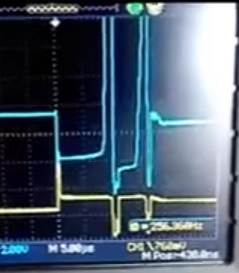

Hi again Cd_Sharp,
Please remember a Mosfet is a DC Switch, designed to Chop a DC Source into Pulses.
The Gate signal shown in the Videos is a series of small, very narrow DC Pulses. The Gate Signal being inverted to the Drain Signal, but also some other signal effects in the Drain Signal that we are looking for.
M = 5.0 μs
P1 = 1.75μs (571.42857 KiloCycles) duration, but 10μs (100 KiloCyckes) after on.
P2 = 5μs (200 KiloCycles) approx after P1, 1μs (1 MegaCycles) width approx
Please note: Cycles is Cycles per second, which this is not, because its not repetitive, but this is to give an idea of the Frequency, or Cycles per-second. All easily obtainable with equipment today.
