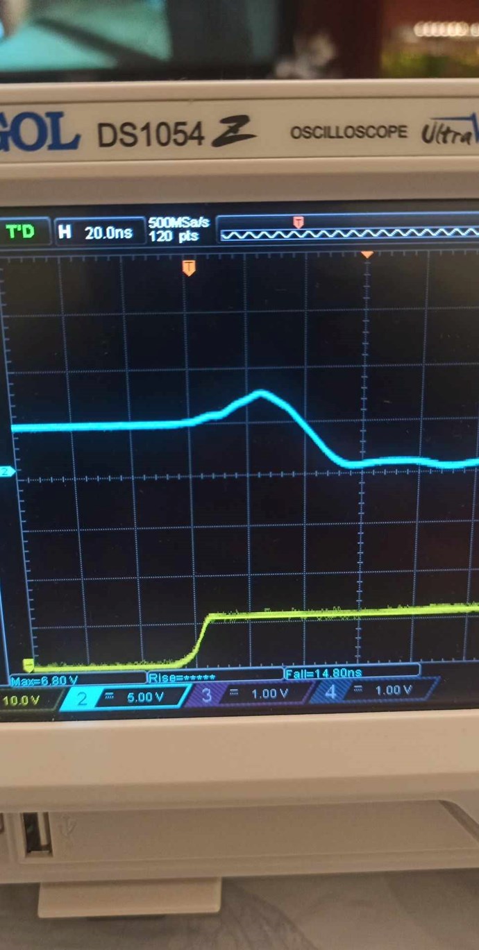

I have a question, why is this waveform only visible on the 2V range of the oscilloscope?
getza posted this 17 October 2023
this is how look the first front of impulse ( colector - in my case Drain) blue trace.
Chris posted this 17 October 2023
Hello Getza,
Excellent work there!
Primary and Secondary are Wound and Wired as a Conventional Transformer, ensuring the Diode is of the correct polarity.
That's it, then you should have a self runner, if not adjust as you have for Resonance.
