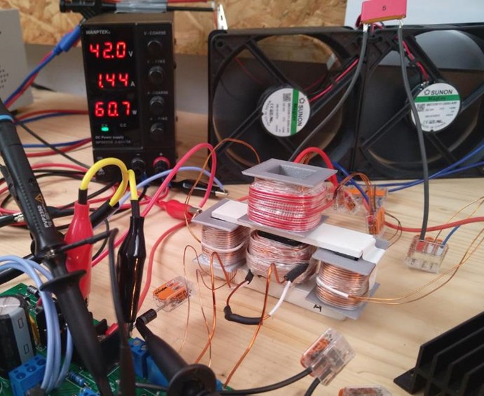

For some reason i tried to replicate what Andrey Melnichenko showed us some time ago.
The effect of having a copy from a magnetic field which is present in an e-core which did not influence the source dipole is a beautiful thing to have.
This is how it looks on the bench..
Video-URL: https://odysee.com/@tankcircuit:a/VID_20230109_132111:c?r=CJW48GgFtfBZfXWVGutqkoeKuXmTFBQq

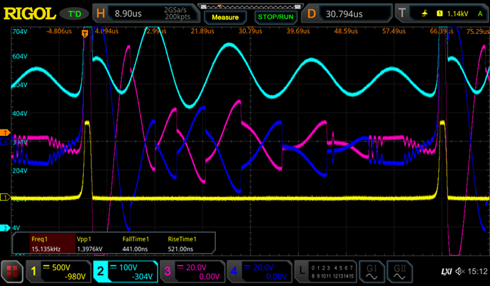

this is how it looks on oscilloscope..
CH1 (yellow): pulse on primary coil
CH2 (cyan): secondary E-core (additional tank)
CH3, CH4: secondary coil signal
13
the pulse creates a magnetic field in first e-core. the second e-core duplicates what happens in the first one (physical phenomena). this additional field creates a perfect condition for the secondary winding.
when we take energy from a coil which is in resonance - we have to do it right! when you use a diode-plug you can create this condition easily. Or you simply use POC on secondary e-core.
the potential difference between CH3 and CH4 is what the load recieves. it is a dc-vector-source. not the same as dc from a battery!
have a nice day!

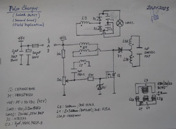

baerndorfer posted this 20 January 2023
this is the circuit,,,
this is the whole circuit.
hava a nice day!

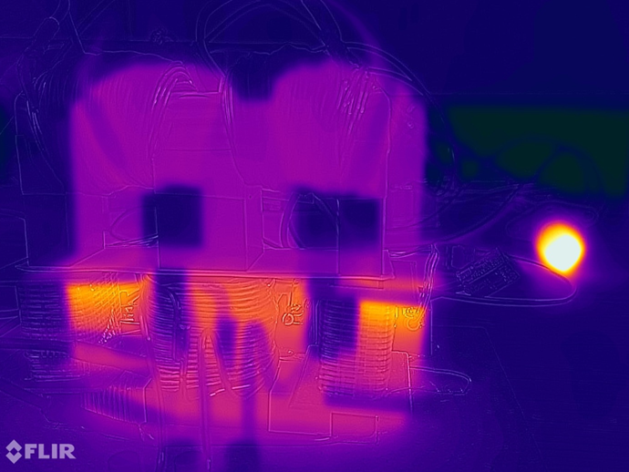

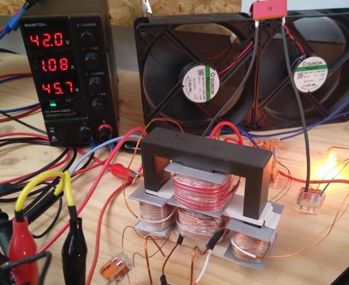

baerndorfer posted this 02 February 2023
on top you can see the second e-core with distance to primary. the coil on second e-core is POC style. the load on this coil is a 25W  bulp.
Screenshot from 2023-02-02 20-46-31
on the secon image you can see the magnetic circuit in operation. we can see heat on primary e-core but not on secondary. the coils which delivering energy to lightbulp did not get hot as we would expect. but we have heat on lightbulp which can be seen on right side of image.
Screenshot from 2023-02-02 20-47-12
have a nice day!
