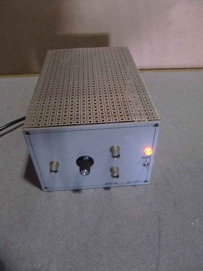

I found a high-voltage amplifier for sale. It's an old one, but it's specifically designed for function generator input.
There doesn't appear to be any manufacturer shown on the chassis, it's just got "M606A HV-AMP" printed on the front panel.
Has anyone heard of or does anyone know about this function generator amplifier's specs?
Chris posted this 11 November 2018
Hey Prometheus,
Anything like this:
There is a few on e-bay and other sites for sale, but specs and models, not sure. I saw one details entry where it said the manufacturer was: HV
I guess trying to contact them may help if they are still around.

Prometheus posted this 11 November 2018
Chris, yes, that's the one I'm talking about.
Hey Prometheus,
Apologies, I was unable to find more data on this. Pictures, I have a few, but I have no specs.
