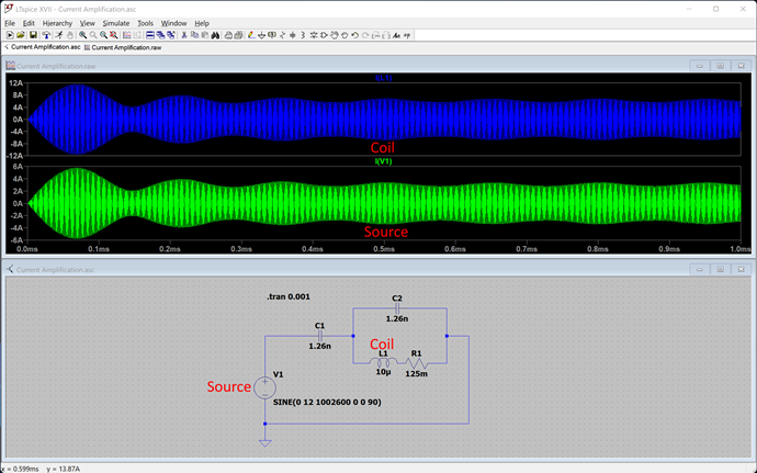

I came across this interesting circuit which amplifies current by 2x.
I wonder what it'd take to increase it further beyond 2x?
Current Amplification 2x

yes I know this design, I already made a thread, I put you the pdf encopier if you want more information.
The only problem with this circuit is that, thus the parallel resonant circuit amplifies the source current at resonance. As you will see, this lowers the resonance frequency but it offers the possibility of magnetic reinforcement when researching with Helmotz coils. With all the calculations and mathematical formula which I do not want to repeat here, are included in the pdf
However, due to high impedance at resonance, the coil current is generally small even with the current amplification effect.

It is a so called impedance matching circuit.
Just divide the circuit into 2 things: Source + C1 versus LOAD (C2 + L1 + R1).
Source impedance is X(C1) + R, where R = 0.
Output impedance is more complex, but we want to optimize where either we get maximum or optimal energy transfer.
Lets say you have 50ohm frequency generator and you want to series resonate (Don Smith) coils having 1 ohm impedance and a capacitor in series. It is logically the mismatch.
It is logical to use your circuit where you change source impedance and put the coils to resonate in a higher current in parallel LC.
BTW: the freq will be lower and a formula is: w = 1 / sqrt(L *(C1 + C2)). As you can see if you have C1=C2 you will have sqrt(2) times frequency lower than normal w=1/sqrt(LC).
