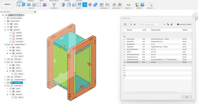

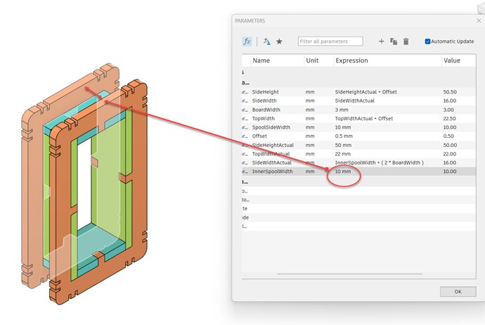

I found this thread and thought I'd share. I have a Snapmaker (3 in 1 - 3D print, Laser and CNC). I've seen a lot of spools being printed in PLA (3D printer) and although these work out great the long print times are a bit of a pain.  Today I tried Chris's CNC approach but instead of CNC router I used the laser cutter on 3mm MDF (can also use non-clear acrylic).  I created a parametric model in Fusion360 which basically means I can use variables to automatically generate a new square/rectangular spool size, very cool and saves heaps of time. The other benefit is that the laser can cut spools in minutes, not hours and is super accurate for a precise fit.  Here's some photos of the process. Happy to share the Fusion360 file or if people have some requests based on core specs and spool size I can post the vector file for you to source cutting yourself.
Fusion360 model and parameters:
Smaller spool in Fusion360

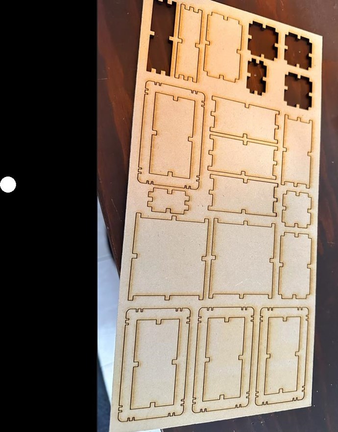

Sample of some cut out of 3mm MDF - approx 15mins  - one pass with 10W laser
Laser cut sample

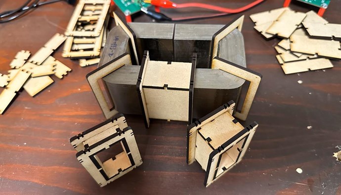

A couple of samples and one on C core. Even without wood glue they are extremelly ridgid. I also cut a few core legs.
On C core
