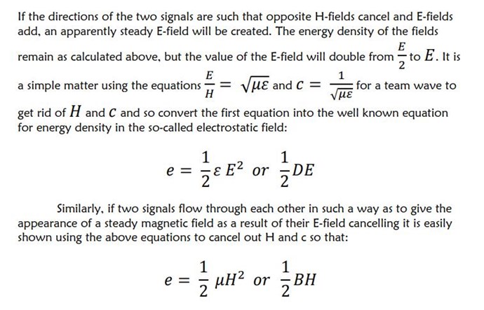

Floyd Sweet made some important statements about this:
Now of course, the reference to a "Team Wave", is a Standing Wave! But there are two different manifestations, the second starting from the paragraph starting with "Similarly".
Voltage Standing Waves have nothing to do with the Magnetic Field, Voltage is already present.

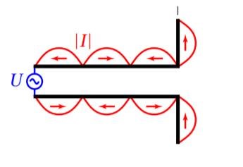

In an Antenna, Standing Waves are well known to be damaging to the transmitted / receiving Signal:
The Feed Cable has standing waves all down the cable, but the Antenna's active element itself is in perfect resonance. If the Antenna's Active Element was not in perfect Resonance, and Standing waves were present, then the Antenna would not Transmit / Receive the signal. Floyd Sweeet said this very well also:
Resonance frequencies may be maintained quite constant at high power levels so long as the load remains constant. We are all familiar with AM and FM propagation, where in the case as AM, the voltage amplitude varies, and with FM, the frequency is modulated.
However, the output power sees a constant load impedance, that of the matched antenna system. If this changes, the input to the antenna is mismatched, and standing waves are generated resulting in a loss of power. The frequency is a forced response and remains constant. Power is lost and efficiency becomes less and less, depending on the degree of mismatch.
Ref: Floyd Sweet - Magnetic Resonance.

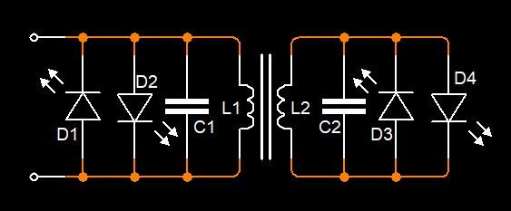

George is using LCR Resonance and therefore Voltage Standing Waves, that's what the LED's are indicating, Capacitor Voltage, but at the same time, there is a Magnetic Component because of the Transformer, so there could be both Voltage and also Current Standing Waves present in this machine. Magnetic Resonance can not exist in this machine.
George's basic Circuit is:
I hope you don't mind me pointing this out, as it is very easy for people to get these differences confused.

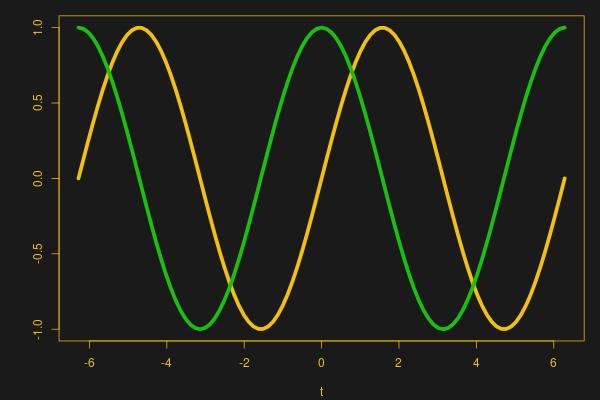

Interesting debate! Yes, George's video is somewhat difficult to understand initially. I agree with Fighter that this is occurring:
Jagau is also correct, LCR Resonance specifies the Phase Shift to be up to 90 Degrees between Voltage and Current. This means we can have Voltage when there is no Current present and also Current when there is no Voltage present, but at a specific Time and a specific point in each Circuit.
The only time Voltage and also Current can be in Phase, is if the Inductor looses all of its Inductance! E.G: If the Core is Saturated.

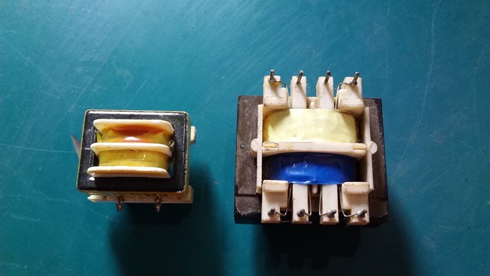

I have some similar Transformers, some are 1:1 and some are not 1:1:
The one on the left is 1:1 but its clear, the one on the right is not.
If George has a Transformer that is not 1:1 then this is very easily explained, if it is  1:1 Transformer then yes Standing Waves are the only explanation here.

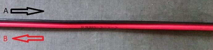

The goal, this must be bought about, at the right time. Remember this is how Current is amplified:
This very same Parallel Wire Scenario applies here and also in every Electromagnetic System. Difference is, its Symmetrical, we primarily work in the Asymmetrical.

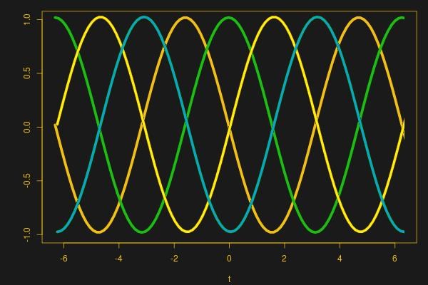

If we look at the Voltages and the Currents, and assume each Circuit has 90 Degrees difference between Voltage and Current then we get, on the Input:
and we get on the Output:
Question is, each Current Changing in Time, creates the other Coils Voltage, so there is not much Phase Shift in there between Input Current and Output Voltage. The only Phase Shift will be Magnetising Current Delay Time and its normally very small!
Problem is, what does this relationship look like?

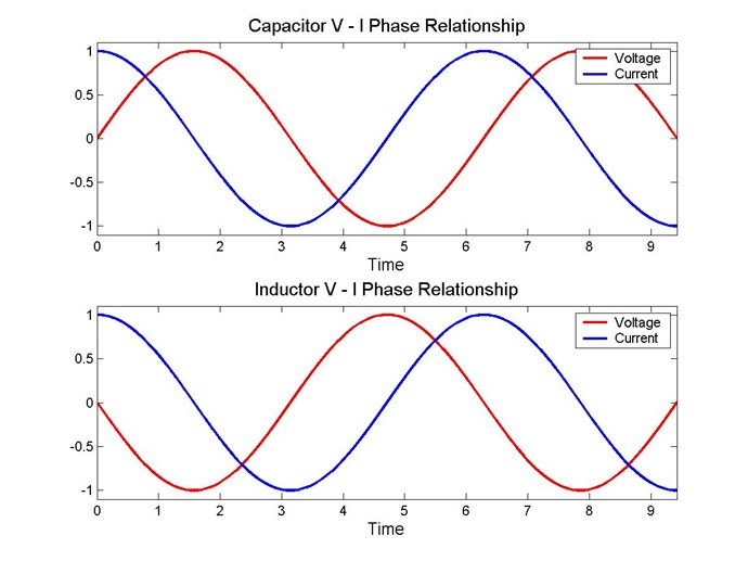

We know what the Capacitor / Inductor Voltage / Current Relationship is:
We will see a similar thing between Circuits, but Input Current, will be, almost in phase with Output Voltage instead.
  • Green is Input Voltage.
  • Orange is Input Current.
  • Yellow is Output Voltage.
  • Blue is Output Current.
I have given this a very small Magnetising Phase Shift, so there is not quite an exact 180 Degrees in there between Input Current and Output Voltage.
