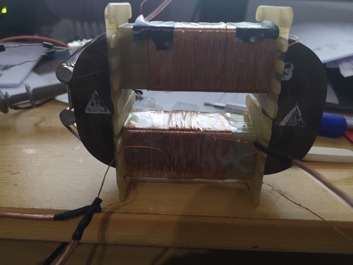

I will start this thread to document my progress with the Bucking Coils.
I want to say a big THANK YOU to Chris and Fighter for all the hard word and the advice's i received from them but nonetheless to all members that are experimenting here.
As Chris said...""Make it simple..do not over-complicate " ....well...DDS Signal Generator + Coils.
It is as simple as it gets.

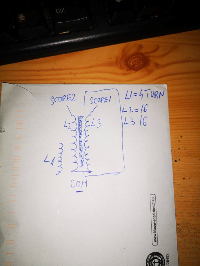

Here are the pictures:

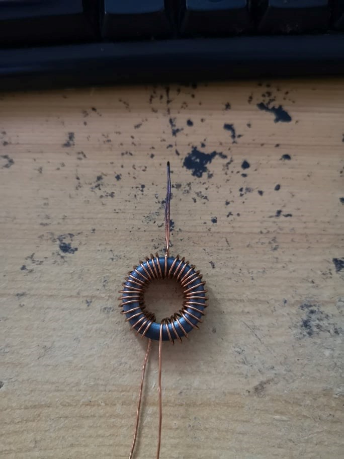

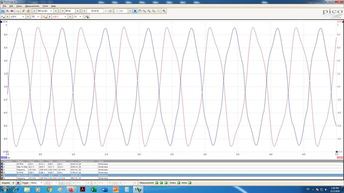

L1 (Trigger ) = 4 turns
L2 CW =16 turns
L3 CCW = 16 turns.
Square wave 5 V Peak to Peak.
At 1.54 MHZ I get a nice High Amplitude Sine wave on Both coils and a P to P voltage of 18 volts.
I have much thinner wire and I can get a lot more winds on that toroid,if this first step was good.
Will the same Bucking Coils procedure work with AIR CORE?...or it is a MUST to have a toroid,Iron core etc ?
Now,what will be step 2?....I want to light some LED's....Do you guys have a small Circuit I can try my BK Coil on?
I await your Thoughts Negative and Positive on my first BK Coil experiment.
Thank you very much and keep up the good work.

Hey Drago,
Nice work! Thank You for Sharing!
You have an Excellent example of Coil Symmetry there! Now all you need to do is aim for, and bring about, Asymmetry. Follow the Experiments I have shared here: Chris's Non-Inductive Coil Experiment
This link will also help: Builders Guide to Aboveunity Machines
In that link, I have given all the answers to get to the next step.
I do not recommend Air Core's, I have never recommended Air Cores, I have said in the past I have never had much luck with Air Cores. I find Air Cores far to Lossy and difficult to work with!
I wish others would stick to what I have shared and recommended, when things get changed, things don't work, there is a reason for everything I do. It is frustrating when others change things and it no longer works!
Good work and an excellent experiment to see the Symmetry between the two coils! Asymmetry now comes by following the link above, but remember, there are may roads that lead to Rome, many ways to achieve Above Unity!
Once you learn one method, you will see a world open up that is fantastic! One must follow the basic rules however, wandering off the path, will definitely lead to failure and frustration!
I was always taught: "Practice Makes Perfect", and Practicing, or Replication of others Successful Experiments, will quickly lead to, becoming an Expert in the Field! Learn as much as you can from My Work, Fighters work, CD's work, YoElMiCrO, Jagau and Vidura's work, and others here, as others here are very advanced! Way further ahead than others may think!
There is a little figuring things out, it takes a little work, but once you get to a certain stage, it very quickly becomes very easy!
Again: "Practice Makes Perfect", it is very true! Don't settle for one successful experiment that looks like others work, figure out exactly every aspect of the experiment! Look at every single detail with a thoroughness like never before, because learning the most simple thing, can be the greatest step forward, a path to understanding.
All here will help you where we can! Share your work and we can give you pointers and help, but if you don't follow the rules laid out, you must prepare for failure, like I have said. Success comes from understanding the basic rules, many here have succeeded! No other forum has ever shown this record!
Best wishes and again, Thank You for Sharing! Sorry for the long Ramble!
P.S: You now have the answer to what was said here:
Sweet used a center tapped coil, but never mentioned what he did with that center tap

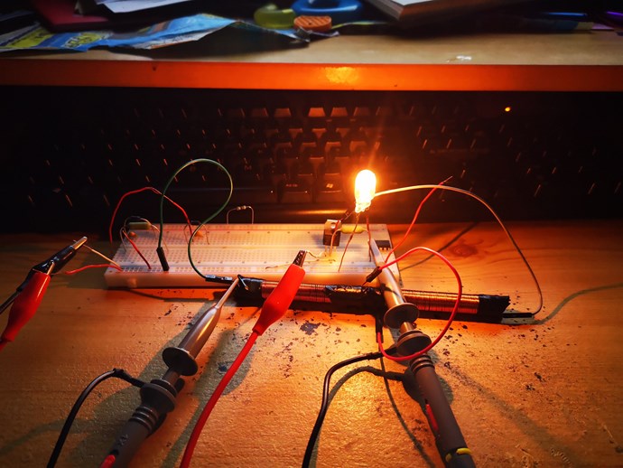

Hello Chris and Guys.
Sorry for the late reply,but as in Chris Advice not to use air core,I have ordered some Ferrite Rods + 0.1 Ohm resistors.
It took a little bit time to deliver.
I have replicated Chris / CaptainLoz video 9 Circuit ..and the results....well...were not that good.
I am making a mistake somewhere,and any suggestions from you guys are very welcomed.

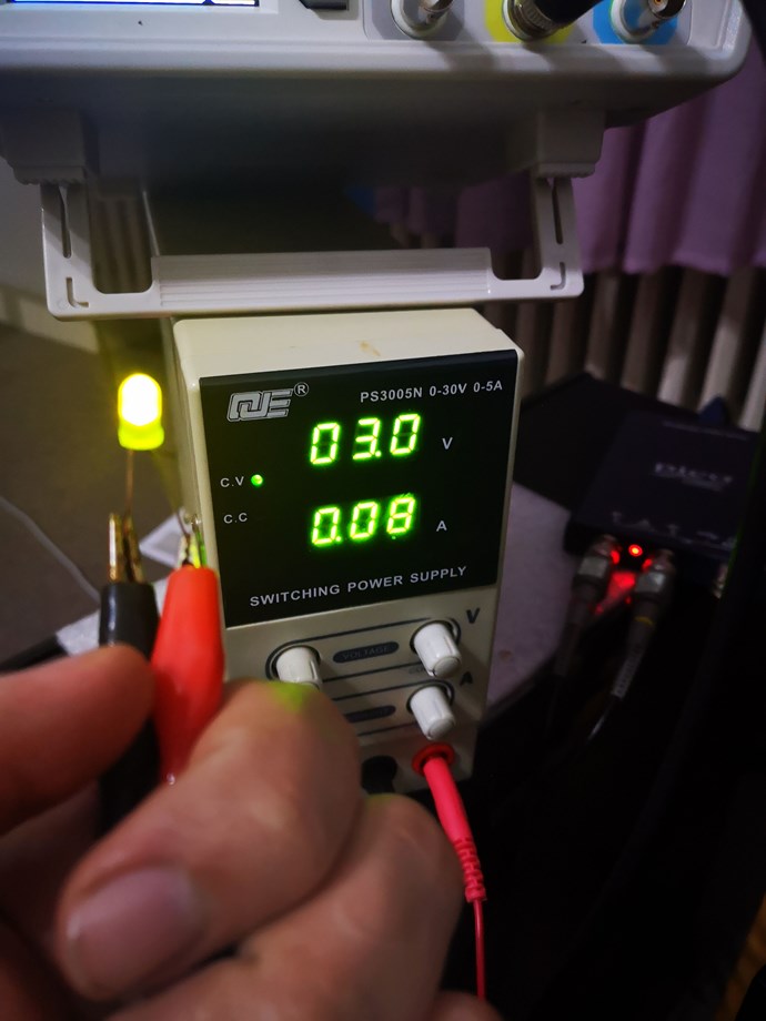

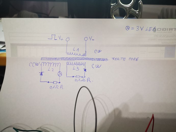

I just want to light 1 LED guys, nothing fancy....![]()
L1 = Trigger coil 79.5 mm CW / 0.5 OHM Resistance
L2 = Output Coil 2 , 318 mm CCW / 0.7 OHM
L3 = Output Coil 1 , 318 mm CW / 0.7 OHM
1 mm Gage copper wire wraped on 15 cm Ferite core.
L1 is Wraped above L3
Picture with the circuit Below:
The Load ( LED ) has a full brightness at 3 V and 0.08 A (Power that none of my coils can deliver to it )

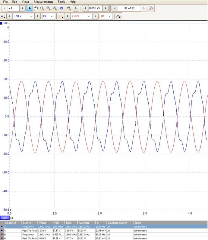

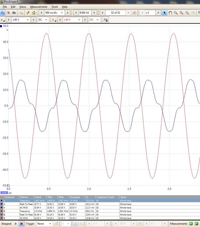

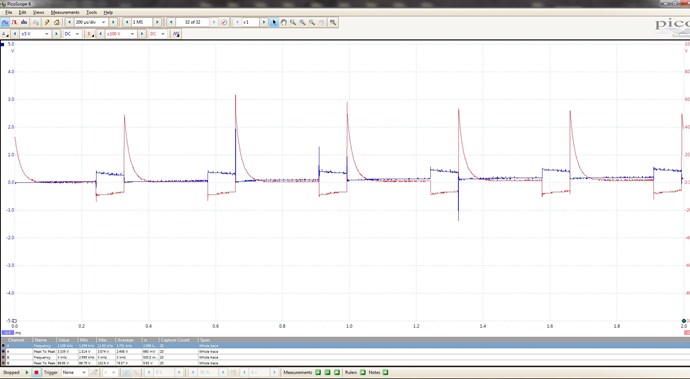

The Coils resonante bot at the same freq 1.661 Mhz and with an input from the DDS Signal generator of only 5 volts I get:
Peak to peak 38 V
If I ramp up the freq from 1.6 to 1.9 Mhz I get a very Dominant Sine wave from L2 ( Red Trace CCW output coil)
With 5 V square I get :
CCW Coil RED : P to P 91.36 V
AC RMS 32.19 V
CW Coil BLUE : P to P 32.77 V
AC RMS 10.24 V

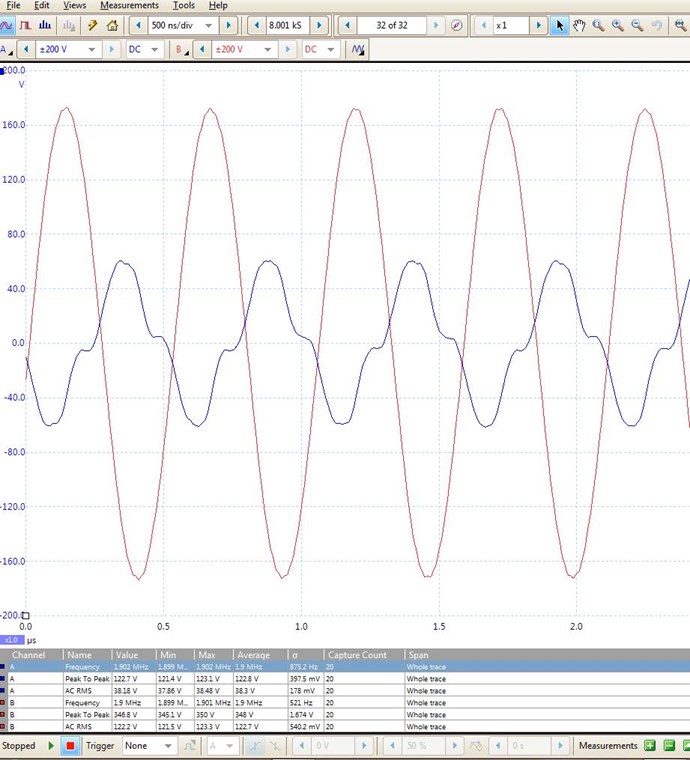

I ramped up the Signal generator to its maximum to see what I get from the coils.
Instead of 5 V square ,I pushed 20 v Square and got the following results:
CCW Coil RED : P to P 346.8 V
AC RMS 122.2 V
CW Coil BLUE : P to P 122.7 V
AC RMS 38.18 V

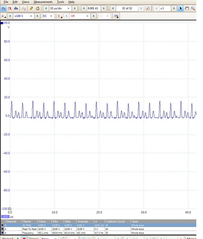

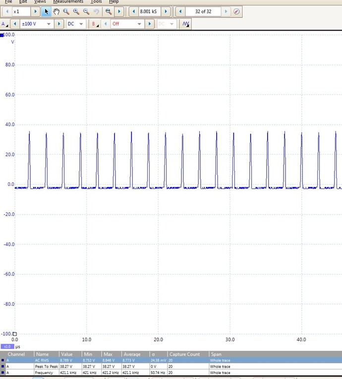

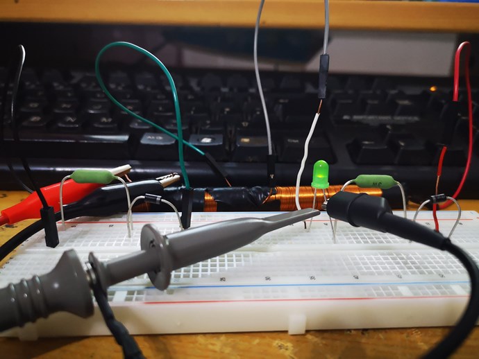

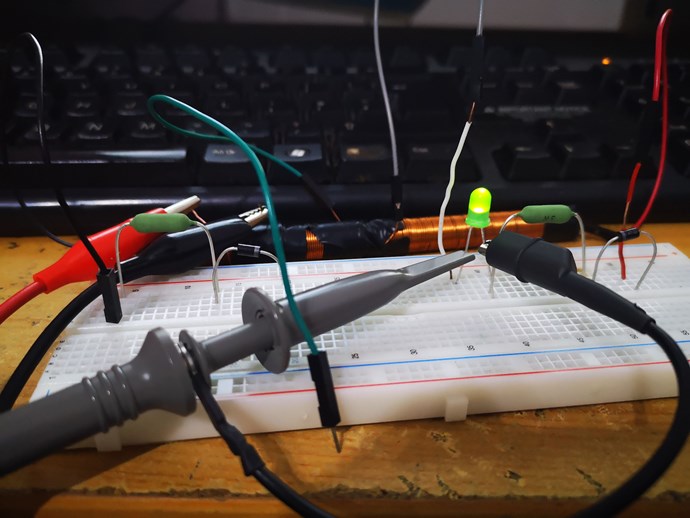

I have set up the circuit on a breadboard like the picture below,and at 20 V square wave ,I got around 1 V in the LED.
The LED is barely bright.
Osciloscope waveform:
AC RMS : 4.26 V
P to P : 18.69 V
Freq : 421 Khz
I have also tried to switch the diodes,load ( + - ) and wires.
I have noticed that if I disconnect one wire from L3 the Secondary CW coil...the LED doubles in brightness and I get the following waveform:
P to P = 38 V
AC RMS = 8.7 V
I suspect that now with 1 wire pulled out,the circuit is open and we have STANDARD Electromagnetic Induction betwen the Trigger coil CW and the Output Coil CCW. ( Correct me if I am wrong),
Also,
Although the resonance of both coils are at around 1.6 and 1.9 Mhz, now,with diodes,resistors and Load I have noticed that the only Frequency I can make the LED turn on is at 430 khz.
As a beginner I did not expect a COP above 1...however with a Peak to peak of 347 V and a RMS of 122 V to get 1 V in the LED...I think I failed miserably.

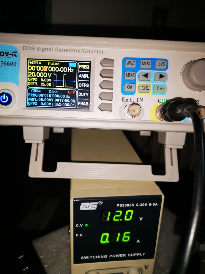

Also my DDS signal Generator can max an Vpp square of 20 v and 200 mA.
I know it is not much..but it should handle 1 single LED.
Guys,sometimes I noticed something strange,and that is...at 50% duty cycle the LED was ok.....but as I lowered the duty cycle towards 20% the LED got a little bit brighter....Gues he liked more time OFF than ON.

Hi drago,
good that you start experimenting! In order to get the POC working, you need to have current flowing, a small led won't be enough, preferable use a filament bulb. Also the frequency should be lower, for most ferrites a few hundreds of khz is abolute maximum, usually much less should work better. You might need some switch, and external power supply to start.
I hope this helps some.
Vidura.
Hi Drago,
An LED as a Load, is simply not suitable!
You need a Resistive Load, this means an Incandescent Light Bulb or similar. The Reason, you need a specific Current Flowing in the Partnered Output Coils, to make this work! This is important and covered in many threads on this forum!
You will need to match the load, use various different ratings. 3.6 watt, 5 watt and so on... Parallel them up as required.
It is the Current ( I ) through the Turns ( N ), that gives a Magnetic Field and if the Current is tiny, which it will be with a LED, then the Magnetic Field will also be Tiny! Tiny Energy will then be: "Generated" as a result. E.M.F = -n dPhi/dt.
By taking on this project, one has to be prepared to bite off a chunk of science that comes with this. One must follow ALL the guidance we have given, including the Loads we have used and shown.
Please see: Help with using the Forum for help uploading images.
I see Vidura has already answered with the same basic answer. Thank You Vidura!

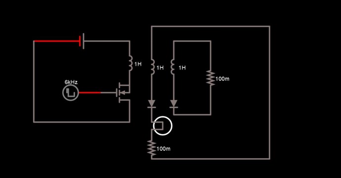

Hello Guys.
It is weekend and is Experimenting time again.
After I read all week here on forum,

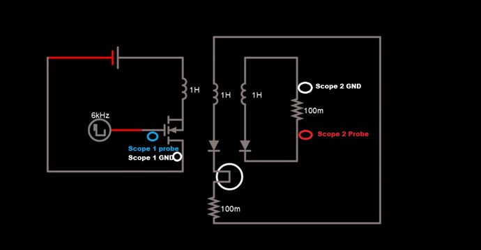

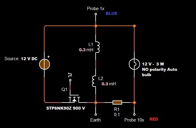

I have found a schematic from Fighter and I tried it out. ( picture below )
Also THANK YOU Chris and VIDURA for the tips.True,you guys use all Resistive loads,
I have bought 12 V 3W Car filament bulbs,and I tried to replicate the experiment that fighter Did,however the results were bad.
I tried to conenct the osciloscope as in the picture,but it is short circuit,if I connect the negative lead to the positive side of the mosfet / coil .
The output of the power suply was 12 v 0.2 A with the circuit same as I connect the bulb directly to DC power suply...12 V 0.2 A.
Am I missing something here?
Tks guys.

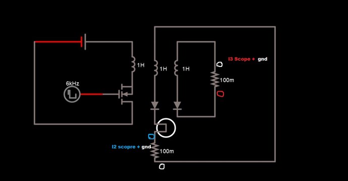

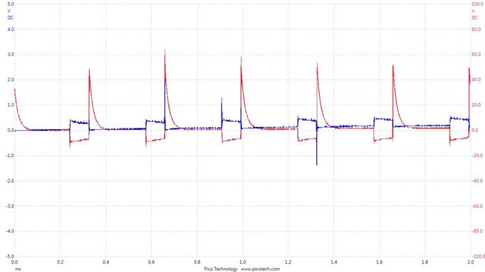

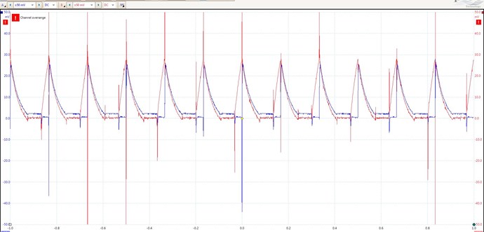

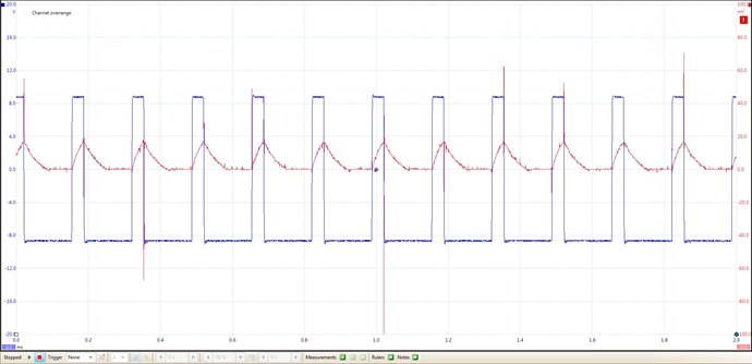

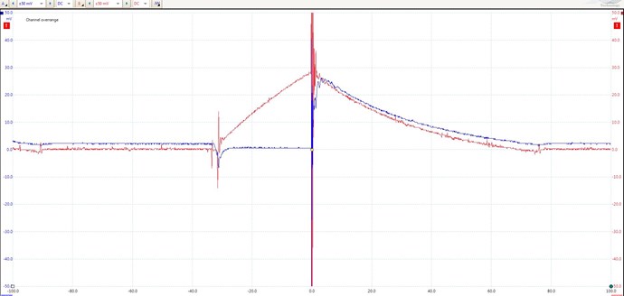

I have assembled the circuit and connected the probes as you told me. ""Keep it simple "" yes ?
Here is the circuit and specifications.
Scope shot :
Blue 1x input and Red 10 x Between the 0.1 Ohm resistor and the load.
When blue is OFF the red makes the triangle wave and collapses slowly as you showed us over and over again. ( Hope I got it Wright )
Image with the circuit :.jpg?width=690&upscale=false)
..jpg?width=690&upscale=false)

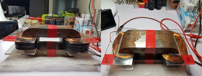

Hi Drago,
I appreciate you adding some images:

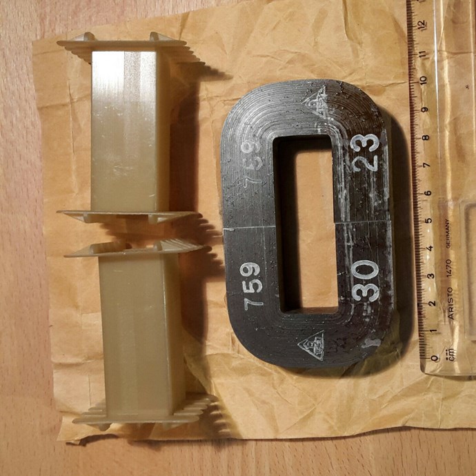

Immediately, I can see your Coils are not right. Fighter found a Quadratic Coil Configuration: See Here
In my current setup "L" coil has approx. 150 turns and "R" coil approx. 300 turns.
So, first, this needs to be realised.
Second, the Core Cross Sectional Area we have found to be important, when I say you need a bigger Core, please understand there are experiments on this Forum where we do use small Cores, so they do work, but one must realise, for Electromagnetic Induction, one of the main variables is Cross Sectional Area.
That's why we see Big Generators like this:
So, to achieve a replication, one must follow the original as close as possible, from Turns, to Wire Size, to Core Size, to frequency and Duty Cycle ( 25% Quadratic ).
With what you have already, you can replicate Wistiti's Work:
We will always try to help! Please understand we can only do this if you help us help you.
Many Members here are Geniuses! The rest are on their way! Learning has a steep curve! These Members and Readers in general that are learning, must follow closely what we share to be able to succeed.

Hi Drago,
We have a Category, on the right, under Categories: Amorphous Metal Core Suppliers, in there is a Thread: AMCC C Cores Suppliers, which we have contributed to to help Other Members.
Worth a read and if you have anything to add, feel free to post more Suppliers.

Hello friends.
My core is here and I have already started the experiments.
My circuit is like @Chris's with:
L1 Trigger CW 0.66mH ; 0.7 Ohm ; 204 cm wire of 0.55 mm 1/4
L2 Output CW 17.5 mH ; 1.3 Ohm ; 816 cm wire of 0.55 mm
L3 Output CCW 18.5 mH ; 1.3 Ohm ; 816 cm wire of 0.55 mm
*The mH measure is that in the first 3,4 seconds after its starts dropping and dropping and dropping.
Here is a picture with the device and the circuit :
I have only a 2 channel usb based oscilloscope .I apologize.
The DC pulsed voltage is :
5.1 V 6 Khz at 0.10 A 20% duty cycle.
I can go higher in Trigger voltage but I get the "" Channel overcharge"" errors, and for the moment i just want to see if the saw tooth is there and looking for the effects as @ Chris has taught us.
Setting 1 :
Blue is the TRIGGER waveform VOLTAGE
Red is the TRIANGLE L3 output coil CURRENT
Setting 2:
L2 CW Current BLUE
L3 CCW Current RED
Same circuit,no modification..jpg?width=690&upscale=false)
On the circuit diagram I forgot to change the Inductor settings, so the 1 H on all 3 is wrong.
The inductance and resistance are written in the first lines of the post.
The triangle wave form is with the polarity of the diode in one way.
If I change the polarity the triangle wave goes away and the current goes x 3 higher at the power suply.
Should I change the Trigger with ticker wire ? Is the resistance too high on the coils?
What do you think guys?
I would love to hear your Input.
Much love.
@drago
Hey Drago,
A bit hard to tell, but I think the Partnered Output Coils Polarity is not right.
Worth checking your Coils oppose, using the Right hand Grip Rule and the Diodes are set according to this polarity.
When you have this working, you will have Three Energy Sources of Energy, only One Source you have to put in, which, most of it, you get back!
Thanks for Sharing! Great work! Good to see!
Hi drago
Just to help you you should never leave a mosfet gate without a reset resistor, add to 10k this will help you not to have false triggering of the mosfet, as you know a mosfet is activated above the voltage threshold with almost no current unlike a BJT transistor which needs some current on the base.
Read the pdf that I have provided below to help you understand the
Basic MOSFET gate drive circuit.
jagau
