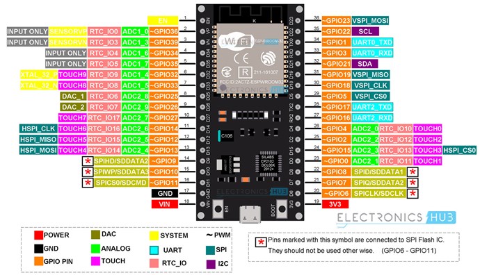

The ESP32 is a really nice, reasonable well priced Microcontroller!
Small and powerful!
