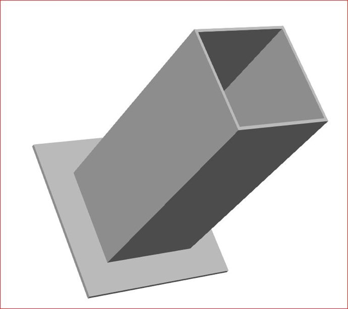

getreal156 posted this 13 July 2019
Hi Marathonman,
There are a few tricks you can try to reduce the amount of support material that you need.
  • Printing under an angle. Overhanging walls mostly need a lot of support beneath it.
    If you change the print angle you might be able to greatly reduce the amount of support that you need. (see image)
    Afbeeldingsresultaat voor printing angle 3d
    When you turn the bobbin print with 90 degrees the amount of support already decreases I guess. Play with this to find the most optimum result.
    Your slicer has a 'preview' button where you can see how it will look like and it will calculate the amount of material that it needs.
  • In the slicer you can change the feature overhang angle at which the printer will start to print supporting structures. Depending on several settings and the type of printer there is quite some variation possible that you can play with. Many settings play a role here. Layer height, Speed, Spacing between filament layers (horizontally), Print temp. , Material,  etc etc. It will take time and many experiments to learn. Slic3r is not the most easy tool to begin with.
  • Print the bobbin in 2 parts that you can glue together. This is a very easy and effective way to solve complicated printing issues. Also with this method there are a few printing orientations and angles to consider to get the best results.

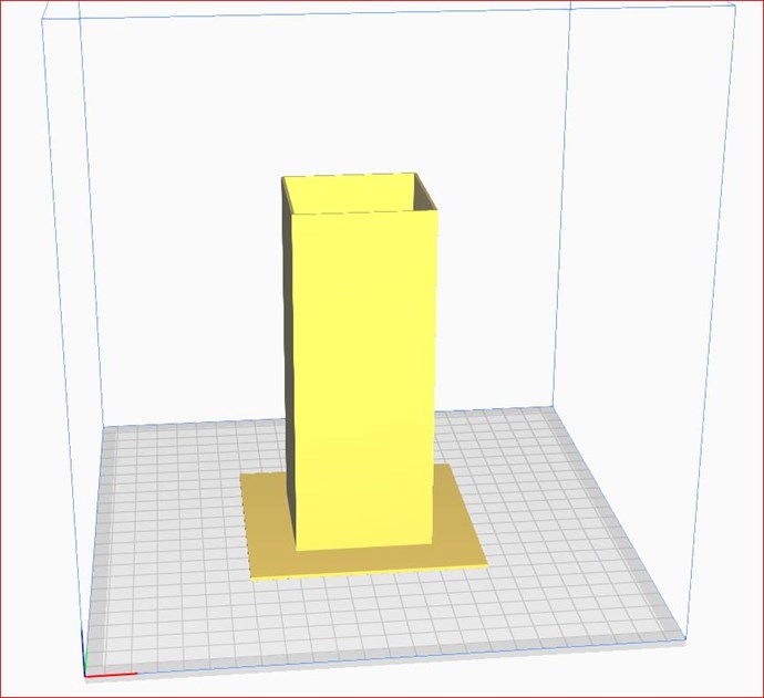

Marathonman posted this 13 July 2019
Thanks for the info very much and yes i realized Slic3r is rather complicated. i also downloaded Ultimaker Cura 4.1.0 which is again rather steep learning curve but nice. i am doing a ton of research and watch all the masters on youtube gathering a lot of insight.
the second pic is in Cura slicer which shows the print preview of a 6 inch primary bobbin. to avoid excessive filament waste i am just going to print the top end cap separate then glue into place with weldon  which works with PLA, PVC, ABS ..ect.. in independent tests it held over 100 lbs and even held longer than the material did so i am good with that.
bobbins designed in EMachinShop then exported in STL into Cura.
i will still watch with eager eyes and will gladly except all the info and insights you have.
Ps. Ultimaker Cura will export in 3MF,  Gcode,  STL ASCll,  STL Binary,  Ultimaker Format Package and last but not least  Wavefront OBJ.
PS. i guess i should of posted this on another thread and keep this one just an instructional thread.....YES !
