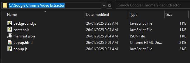

Inside a file: Google Chrome Video Extractor, create the file structure:

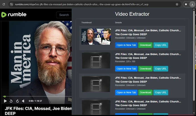

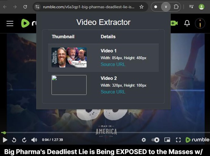

Once done, you will be able to access Video Extractor like so:
Enjoy!

A small update on this small but very useful project:

You need a Thumb Nail and a Icon for the project.
This is a lot better than it was before:
Enjoy My Friends...
