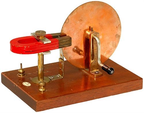

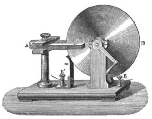

The Glass Rod and Cat Fur experiment comes to mind. Charge is distributed relative to construction, or geometry and Electromagnetic Forces exhibited on the Charge with a Changing Time Constant. Your videos show exactly this!
As far as I understand, the Faraday Homopolar Generator is quite different than what was shown in the first video?

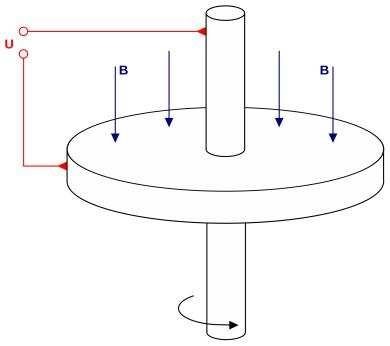

What is Faraday's Homopolar Disk "Generator"
A River, if the River itself ( Land Mass ) were to move with the same velocity and in the same direction as the force of Gravity, relative to the Water mass, then the Water would not move relative to the River, they would both move together.
The video shows an experiment that proves nothing in regard to the Faraday Homopolar "Generator" as the Magnetic Field is not positioned the same as Faradays original design!
The only thing the video proves, is that bad experiment can make one look foolish if proof is postulated!

We know from Experiment and from experiments of Michael Faraday, that Flux Cutting requires a difference, ideally, one half the Conductor is cut by one pole. Without going into this too much, Charge can not be separated if there is no separation done and this requires somewhere for the separated Charge to go. So we must see this in the Homopolar "Generator" and we do see this in Faraday's original design!
However, we do not see this in the video.
In Faraday's "Generator" the Magnet is situated almost exactly in the path of the Conductors. No where else on the Disk is there any Magnetic Field except of that of the Earth which would be negligible because the Disk is up on its edge.
As the dis is turned, part of the disk near the contacts is always turning into a Magnetic Field from an area of no magnetic Field.
Thus this region of the Disk is Cutting the Magnetic Field.
This does not ever occur in the fore mentioned video. The 2mV recorded could be a Centrifugal effect rather than anything else.

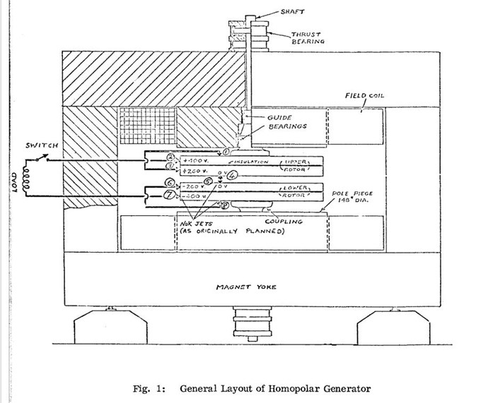

The homopolar generator which is being constructed at the Research School of Physical Sciences, Australian National University, Canberra, is a novel form of pulse generator in which energy is stored in a system of two contra-rotating steel flywheels, each 12 feet in diameter and weighing 40 tons. The flywheels rotate in an axial magnetic field so that they act as the armature of a homopolar generator, and are rapidly brought to rest when electrical energy is extracted in the form of a high current pulse. The machine was designed to power the orbital field coils of a 10 GeV proton synchrotron. However, with the development of alternative methods of accelerating protons to this energy the allied synchrotron project was abandoned, and it is now proposed to use the generator for other purposes; e. g. the study of plasm as. In this role it would have a stored energy of 500 x 10e6 joules, which is greater than that available from any existing capacitor bank, and would be capable of delivering a pulse lasting two seconds and reaching a peak current of 1. 6 x 10e6 amps. The open circuit voltage was 600 volts.
Source:
THE DESIGN OF BRUSHES FOR THE HOMOPOLAR
GENERATOR AT THE AUSTRALIAN NATIONAL UNIVERSITY
by
A. STEBBENS
H. WARD
(Morganite Carbon, Limited)
(Consultants to The Australian National University)
F irst Published: March, 1964 Re-issued: September, 1967
Publication EP-RR 18
Department of Engineering Physics Research School of Physical Sciences
Canberra, A.C.T. Australia
Vidura posted this 15 August 2019
This post I made regarding the title of the thread, it seems to be myth that homopolar generators can only produce low voltage, evidently at high angular speed it rise to high levels. The other thing is that a strong drag slows down the 40ton rotors from 900to 200rpm in less than a second, so the statement of some research that no drag is produced is not true at least in this configuration, testing could be don if this changes when disk and magnets rotat together. Vidura.
