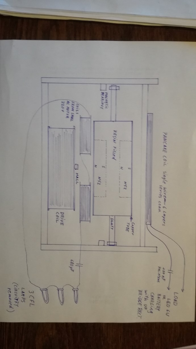

He is using a high speed pulsmotor with magnetic bearings and two N52 neodymium magnets inside the rotor, one N and one S pole. The motor runs on a 12 volts power supply with a hall sensor circuitry.
In another experiment he used stacked single wire pancake coils with an auto oscillating driving circuit in resonant condition. With this solid-state setup, he is able to lite many 12v 3,5W LEDs with a very small input power. There are six pancake coils series connected in each unit and various of these stacked up, up to 72 coils.
In one method he uses this flat pancake coil, and as you can see in the video when he put it at a 90° angle position to the magnet pole there is virtually no Lenz effect, when he turns around the coil to the conventional axial position the rotor slows down immediately.

here some more info about the pancake coils:  they are wound single wire with SWG 30 magnetic wire , he used phi ratio between inner and outer diameter, the bigger ones have 45 Ohm and the smaller 21 Ohm, they are made of six layers stacked up and connected in series, this units have given a output for 12V led devices or battery charging, this type of coils can also be directly connected to the load when in right angle position to the rotor, and no Lenz drag is produced. For the CFL he used a pair of standard coils from a small AC motor for mains , one beside the other and series connected, with the 680pF capacitor between coils and load.
The 40w fluorescent tube was connected with 4 of this coils, two below the rotor and two abouth, with a 100nF hi voltage capacitor in between the two coilsets connected and the 680pF cap between coils and load. additionally he mounted a pancakecoil with a 6w Led and he stated that all lamps where brightly lit , the 40w tube about 80% of brightness . The inputpower was 12v and 0.6A

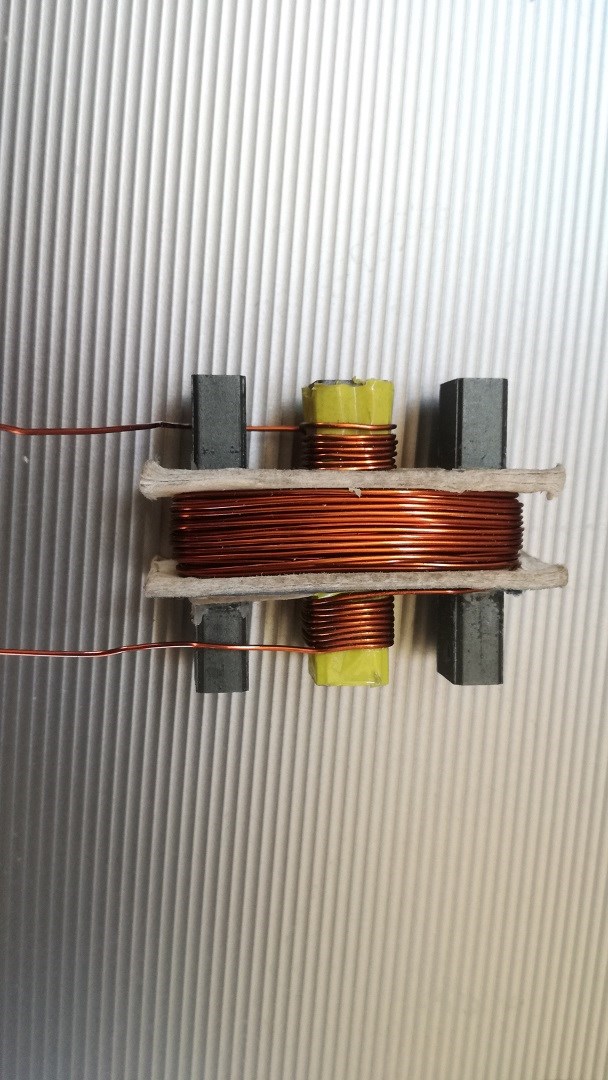

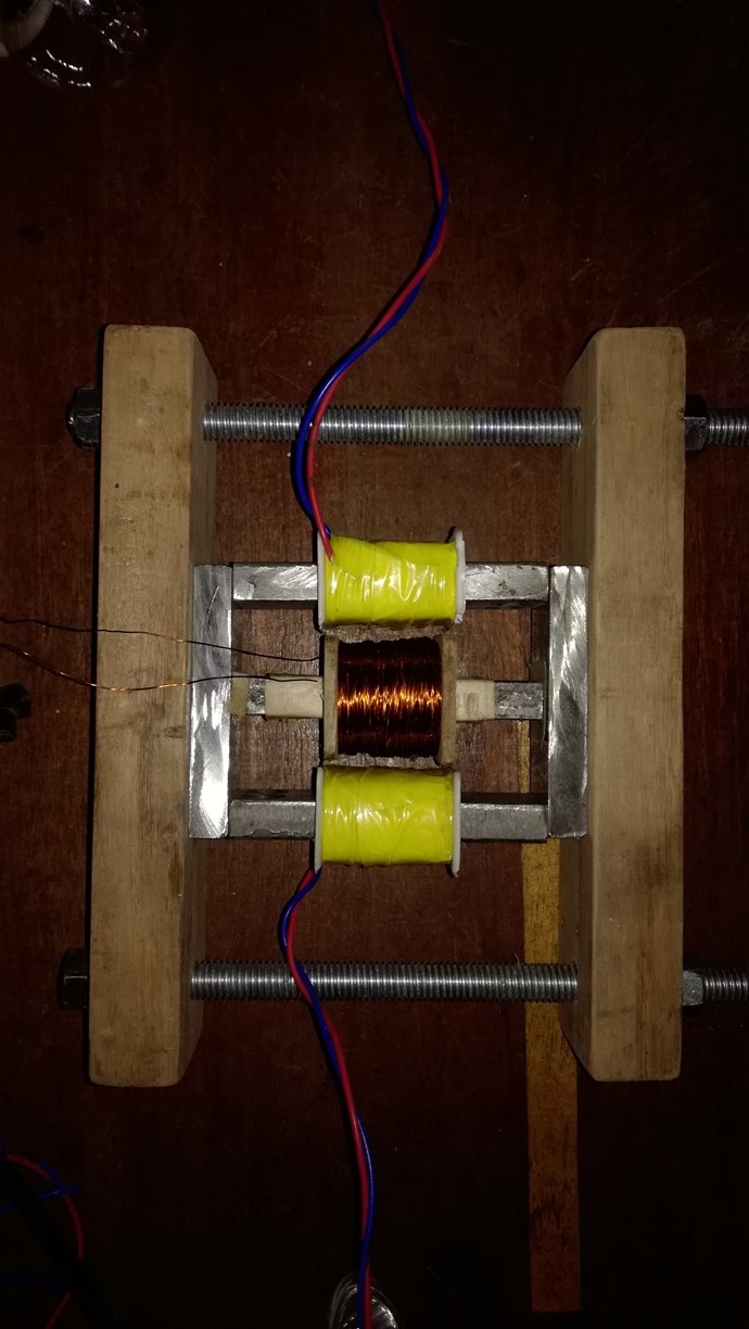

Here i would like to post some tests that i will perform with a simple transformer setup.Basically i want to make a proof of concept if this method works for bypassing partially the CMMF. The setup is basically very similar to the Φ transformer from Alexander Frolov:
I have made this setup with easily changeable coils:
it is reciently finished and i have made onlu a short test with a 60v ac source and a 220v bulb on each outputcoil and it could be noted that the output with two loads increases compared when only one coil is loaded, with very small influence on the input.Soon i will post further testing results.

Hello, here some results of testing the posted setup. I have tried various different configurations, the transformer has not a good efficiency,as expected due to the solid iron core, the primary core becomes quiet warm.I have connected a 45v 50hz ac source, which drew  280mA. The output on the two secondaries first i used two 220v 40w incandescent bulbs, as there was only a faint glowing ,i changed to 30W 33v led arrays, to see better the reaction.the output with two leds connected was 4mA each, when i disconnected one ,the remaining diminish to 1mA. when i shorted one coil the other raised to 30mA ,the input also increased about 30mA.
I also tested without rectifying ,using the led as diode, swapped polarity,to get a circulating flux, a diode on primary.
also i used a square wave input of 12V, when a strong flyback effect could be noted, almost the same values as with 45V ac. the TVS on the mosfet become hot from the HV spikes.
when i clamped a BEMF diode to the positive supply,there was virtually no output at all.Basically the same behaviour as with the sine wave source.
Maybe there can be done more testing,but it seems to me that the CMMF is not behaving like claimed by mr.Frolov.
I will do a few more tests with modified setup, perhaps bucking inputcoils and see what happens.

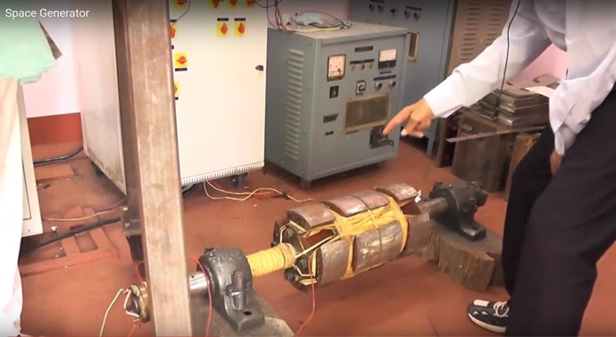

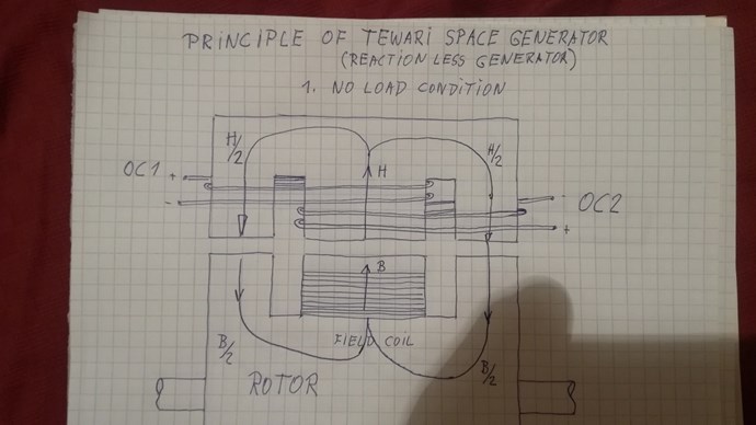

As i was thinking a lot about the Tewari Space Generator, i decided to do some more investigation on it,If we can understand the principals behind, it should be possible to reproduce and maybe improve the method. Searching again for more details of the Tewari Space Generator I found some interesting parts on the video demonstration:
The rotor has the electromagnets in the center, and not on the outer sides as stated in the patent(US Patent Application 2015/0084467 A1). Altough in one of the rotors shown the outer segments for the CMMF return path have a few windings as well.
In the next Image mr.Tewari explains that the magnetic path circulate from the center of the rotor to the Stator segment and back to the outer segment of the rotor magnet, but it is not at all clear if he is refering to the main magnetic path or the CMMF.
There should be also a magnetic path thru the outer stator casing, so possibly the CMMF takes the short path back to the rotor thru the outer weekly magnetized segments. This are only assumptions for the moment , so i was thinking about how to test this possibility.

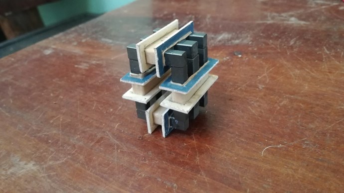

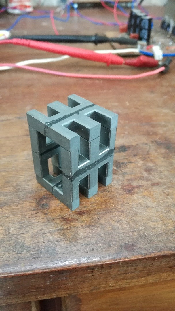

As the construction of a rotary dynamo machine is intense effort, expensive and takes a lot of time , maybe with a transformer with similar magnetic paths as the generator can proof if it is or not possible to bypass the CMMF by this means.
The transformer which i made to o the next tests has this shape:
a core made frome 8 E ferrites
two primaries on opposite sides and two secondaries at 90ª , assuming that there will be a slight difference of flux density between the outer and the central legs of the core it should be possible to bypass a part of the CMMF backwards to the primary without opposing the original field
this setup can be tested with forward or bucking coil connections, and will work at higher frequency as well.
i have to wrap the windings still and find some spare time for testinglaughing

One more important detail regards the Tewari generator, in one part of the video mr Tewari states that for this sistem more magnets are needed than for a conventional generator, for example for a two pole machine are needed four magnets. Might they have N-N S-S configuration, with two bucking fields?

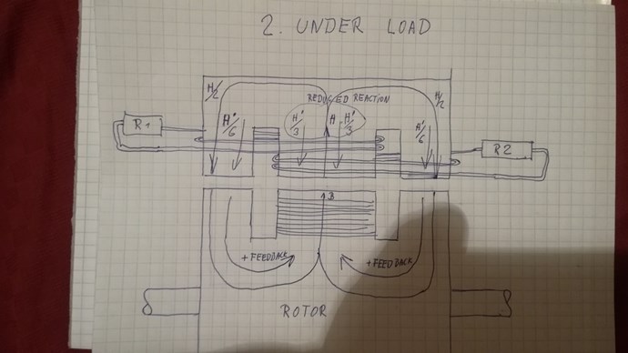

Hello Team, When I was looking to perform tests for finding the principles of the Tewari space generator, I was seeking erroneously on the wrong side of the system, not on the field coil ,but on the output coils is the key.Like mr. Tewari stated the e-magnets in the rotor works like in a conventional generator, also the flux paths are like he showed in the video, only the comment about the quantities of magnets he seems to reference to the output coils,not the field coils, this way everything is straightforward. On a 13 hours flight I was thinking about many different possible configurations how this could work, and came to the conclusion(for the moment theoretic) that it works this way:
Tewari Space Generator, Magnetic flux analysis and explanation: 1. No load condition: In the central core segment the field coil induces the  field B on the rotor.The resulting field H is Induced in the central stator segment. It is divided proportional to the cross area sections in the two outer segment flux paths H/2 and the magnetic loop close via the outer rotor segments back to the field coil.A potential is induced in both output coils, which are wound  interleaved around the central stator segment and ONE outer segment each coil. 2.Load connected on both output coils: (It should be possible to connect them together as well) As a current is now flowing through the output coils, each coil generate a CMMF in opposed direction to H, which is distributed proportional to the cross area sections of the associated core segments as follows: The central stator segment opposed to the H flux will induce a counter MMF of H'/3 from each coil, wich adds to 2/3H'. The restant counter MMF of 1/3H' will be induced on both outer legs , H'/6 each side in the SAME direction as H/2 and thus summing to the outer returning paths as positive feedbacks to the original B-Field. At the same time the CMMF on the central stator segment is REDUCED by the value of H'/3 wich have been bypassed. The total H flux in each output coil is H - H/2 = H/2 , so the sum of both coils output should be corresponding to the induced current by flux H. This calculations are made assuming E shaped cores with the sum of  cross area sections of the outer legs equal to the central leg cross area section, and that the flux will be devided in proportion to the corresponding cross area sections. For the instance this is theory and has to be proofed by practical testing. It should be applicable for equivalent transformer devices as well.
Chris posted this 23 June 2018
Awesome work!
Your theory sound solid and correct. In a Transformer or a "Generator" the input is acted upon by the Output, so it is the Output we must work with to reduce this Reaction back on the Primary Action, what we need is a Counter-Reaction.
This is part of Newtons Laws of Motion: "For every Action there is an equal and opposite Reaction"
Great Work and thank you very much for sharing your excellent results!

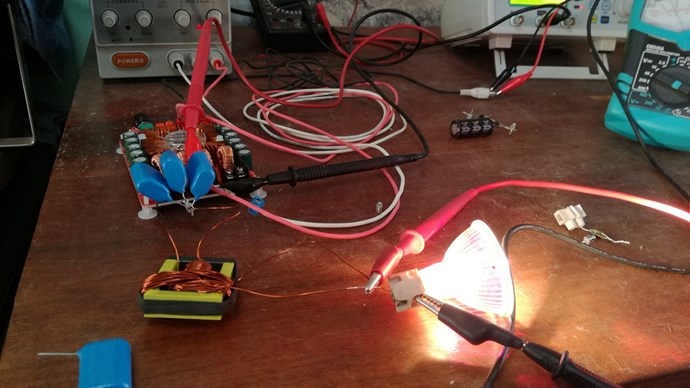

Hello Team,
As i've been on a jorney i had this idea about the Tewari space generator, now back at home i could make a first test . here i will paste the images from the theory :

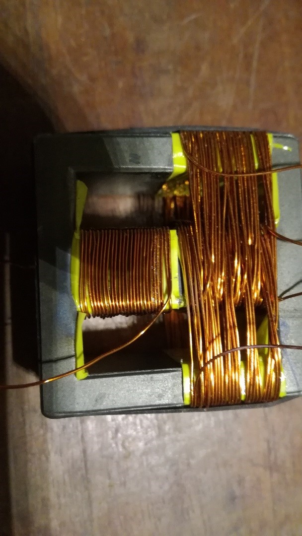

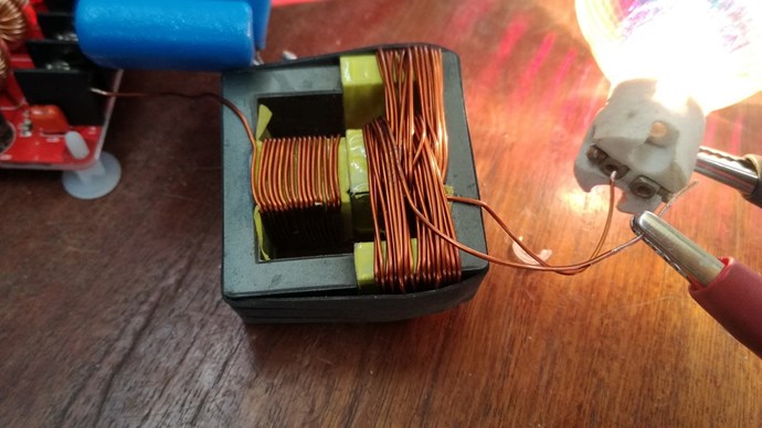

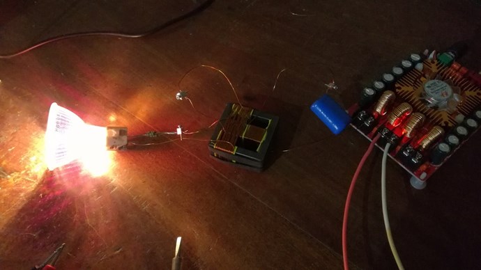

This is the Setup , en equivalent transformer model:
After the first tests i was certainly dissapointed, the theory was quite straightforward, but when i connected the load there was a notably CEMF reaction. I could not understand why it did not work like expected. I tried many different configurations, then with this setup there seems to happen something, quite subtile the result, but measurements give values of a COP slightly >1.

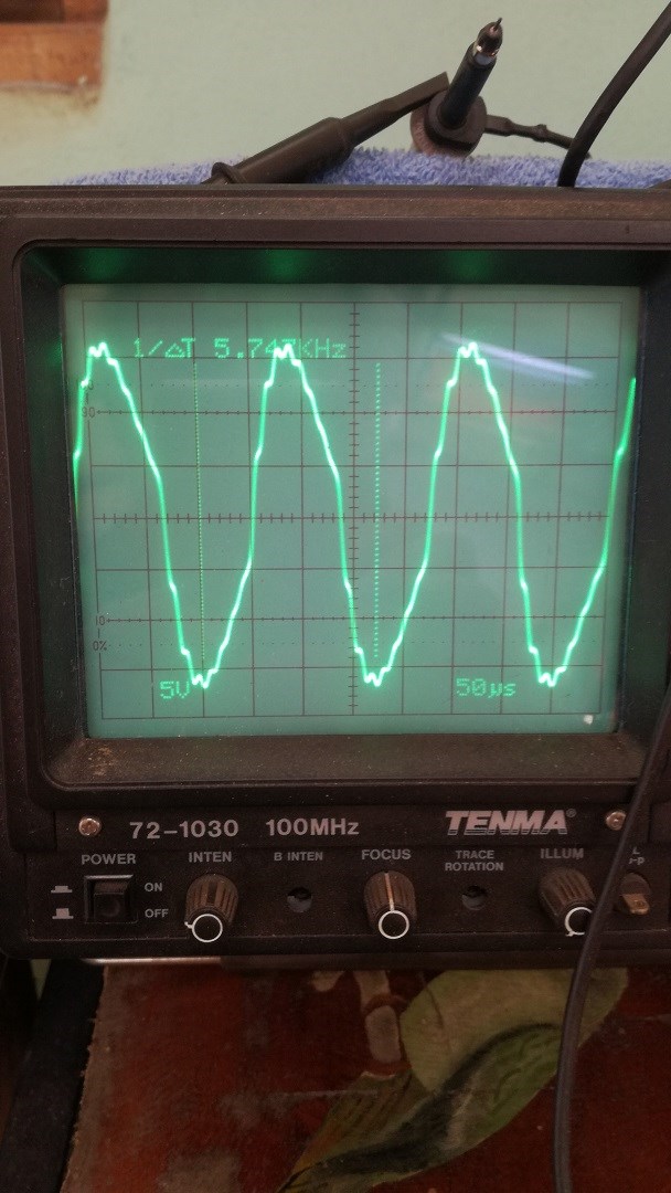

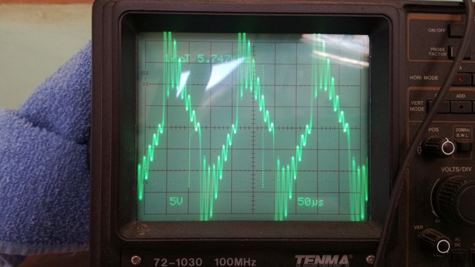

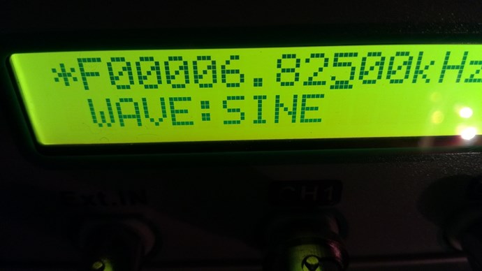

the setup uses a serial LC  circuit , at about 6khz  it got resonant. the audio amplifier is feed with 12V, on the output a 20w 12w halogen bulb.
Inputvoltage and current
Output current across 0.11Ohm resistor
output voltage on transformer.
I have made varios measurements with different input voltages and got the same relation , the output power slightly higher than the input, overcoming the losses from the audio amplifier and transformer, which was getting warm both.
Vidura posted this 08 July 2018

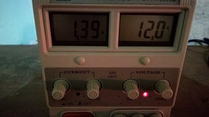

when i repeated the measurement with different meters i noted there was some interference on the output measurement, using the analog meter gave a value below unity, but when i adjusted some parameters and used more capacitance i came very close to unity or slightly above, while there was a notably warming of the audio  amplifier and transformer, in one test the output showed 1 w more than the input. This is not enough still to be 100% sure, as we know the measurements can be tricky sometimes, the only way to be sure would be to back loop to the input, but there is still very little difference for this, so i'll go on looking how to improve further, testing different windings and cores.
Vidura posted this 11 July 2018

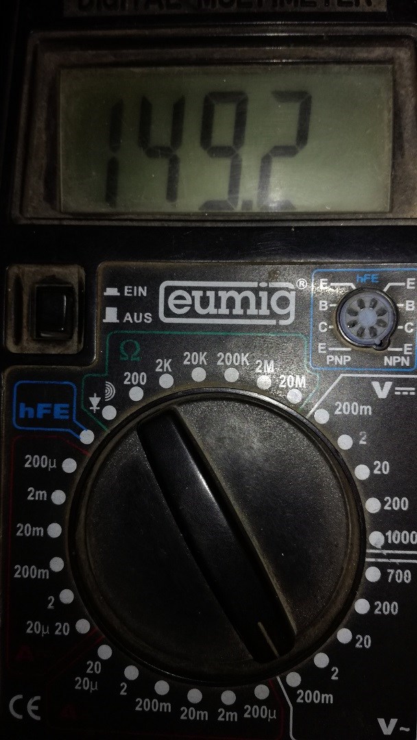

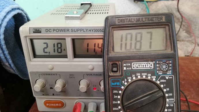

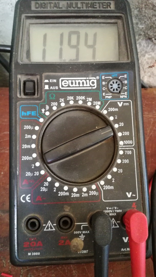

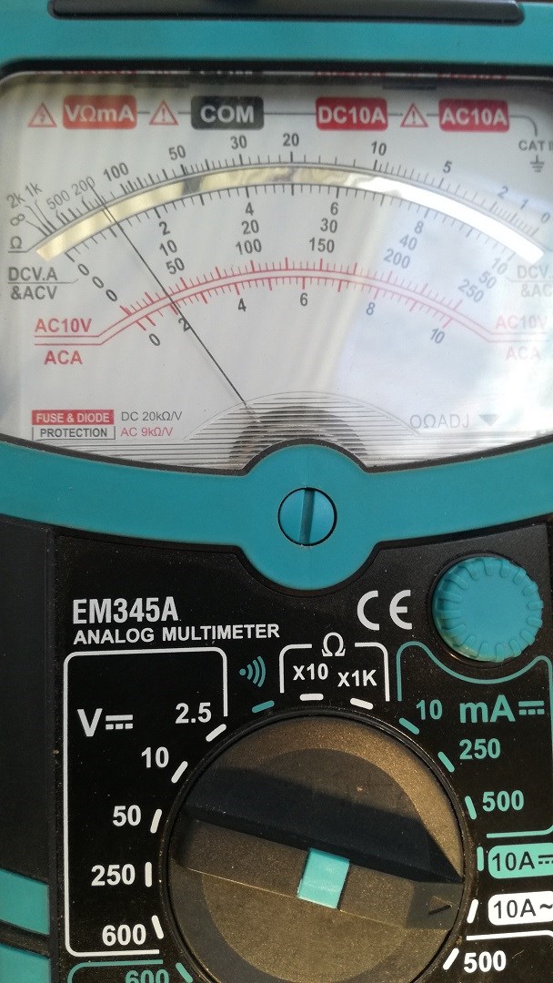

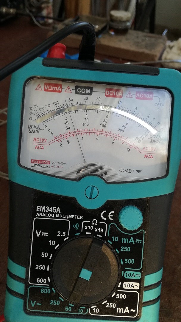

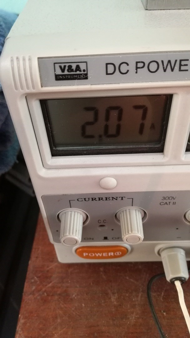

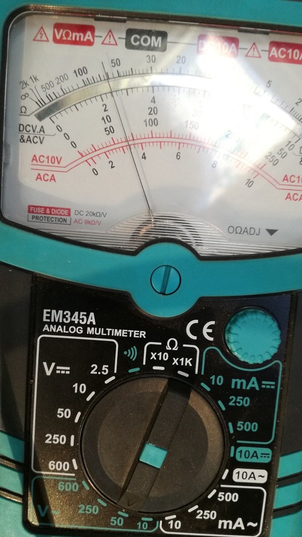

With another core and windings i have tested again, with very similar results, I have noted that in resonant condition on input (series LC) the output is around 30% higher. The input voltage  shown on the power supply reads a little bit too high, so i clamped a voltmeter to the audio amplifiers input, the current reading is accurate. As the audio amplifier is wasting a good deal of energy as heat when working with sine wave signal, a unity output is already a surprising result.
Here a short video, and some pictures from the meters readings:
Chris posted this 11 July 2018
Your work is superb! Awesome!
Input: 11.92 x 2.12 = 25.2704
Output: 12.1 x 2.1 = 25.41
This is not including the losses in the Audio Amp. I left a message on your video and gave it thumbs up!
Very well done, you have shown how easy and cheap this can be. Just a little work and learning, can show amazing results!

Please can you tell me how is the asymmetrical coil wound? I Can see the schema you drew bellow but in the video there are just two connections coming from the coil are the two coils connected together? Or is it just single coil?
The best would be if you could draw how you winded the coil.
Again thank you very much and all of you for the awesome work you are doing.
Hi Deny, The Windings are like this: Primary: 36turns in 2 layers Secondary 18 turns from central leg to one side, 36turns from central leg to the other side, and again 18 turns on the first side, all the same wire. I have Tried different winding patterns and found the best results with many turns together on each side, not interleaved.The wires are 0.7mm and the 3 capacitors on primary are 2.2uF.Later I will post a complete schematic.

Hi Team!
here i add some updates for the transformer device:
in the testing I have tried various different windings and patterns, there are a couple of observations that i want to share: in one test where i used the setup like in the first test i posted i did a interleaved winding pattern on the secondary, each turn i changed to the oposite side , there was a effect that when i rised the voltage at one point the output jumped suddenly to 2x the power, when i lowered the voltage with some hysteresis it jumped back to the previous value , i did not continue searching as the input also had increased, there was no excess energy, any way i found it interesting. The other observation was some instability with the transformer which gave the excess energy. eventually i wanted to repeat and found a different resonant frequency, and not as good values as before, also when i connected the capacitors with a wire of 20cm length it did not work well.
for this reason i wound another transformer with  exactly 1 m wire on primary and 4 meters on secondary keeping the connections short.this device seems to be stable, here the images:
here a scopeshot from the output:
and the primary :
Chris posted this 12 July 2018
Thanks again for sharing! Excellent work!
My Friend, I would like to point out something that is very important for all to see! In my work on Electromagnetic Induction, I discovered that the Flux Difference relative to the Coil over time had a relationship.
This relationship was at optimum when 1/2 the length of wire was Cur by Positive Flux and 1/2 the Wire cut by Negative Flux, in other words  If all the wire was cut by the same Magnetic Field, no E.M.F would be induced.
This greatly increases the total E.M.F induced. This is what you have done and it is done Asymmetrically using opposing fields, an excellent design and application!
Well done, excellent work!

Here some more tests, I guess the stability issues where due to the low temperatures in my working place, the last days only about 5°c .Today the weather became warmer and both transformers performed well. Here a video with more testing, I had excess power in all tests today.Also I noted when the device runs 10minutes the performance gets a little bit better which seem to be consistent with the temperature issues.
Vidura posted this 13 July 2018
Measurement error! When I made some calculations based on the scope readings I noted a lower current then the readings on the analog meter. So I made a comparison without the transformer in between and noted the meter was reading the current to high when the frequency goes above 1khz. So there is no excess energy with the transformer. I'm really sorry about that, the above unity tag should be removed.
Vidura posted this 18 July 2018

Hello , Team!
Regarding the reduced reaction transformer i might have been wrong stating that there is no OU in this device, the test methods might not have been adequate and measurement methods also. Anyway i am going on testing and have found some interesting facts, also i asked a forum member for help with a theoretical analysis, so in a few days i'll post some news.
