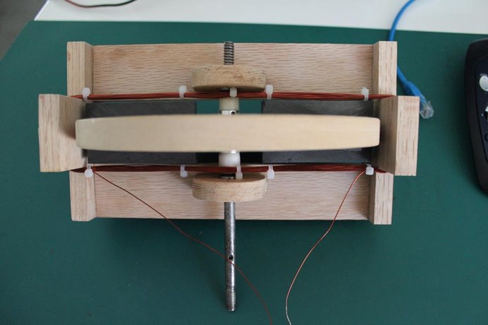

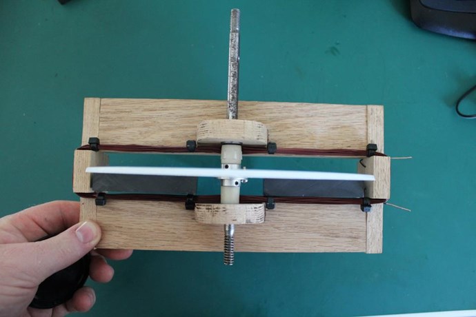

Some years back I did a simple experiment, to test my knowledge on Electromagnetic Induction.
I had done a lot of study, I had read many papers, the best being George I. Cohn. I was using the EMF = Bvl equation, which is Flux Cutting.
I learnt a lot!! This version worked well:

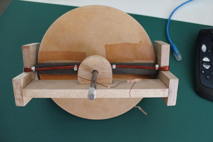

But, the next version, did not work:

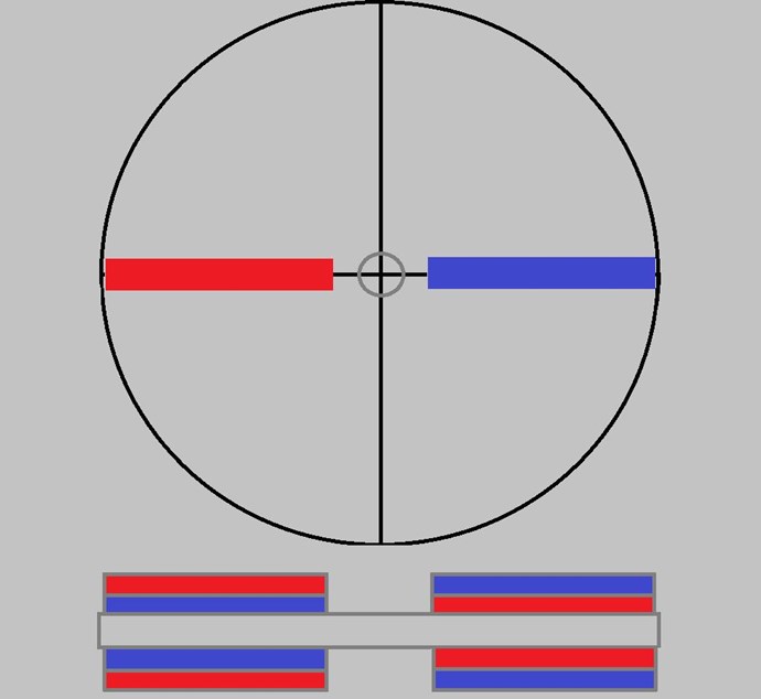

The reason it did not work, was because I had the Magnets on both sides in the same polarity. So, the Charge being Separated in the Wire, was being pushed toward each other, effectively cancelling each other out.

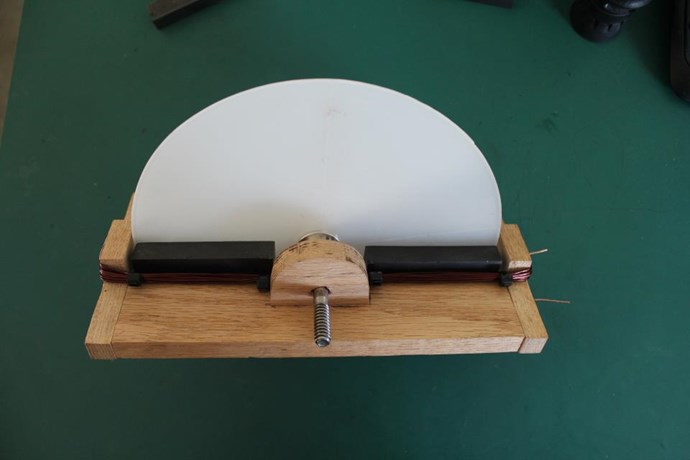

Hi CD_Sharp - Yeah its  just a simple Magnet on the Rotor, The Magnetic Field B passes the Coil Conductor at Velocity V and the Coil/Magnet has a Length L
Electromagnetic Induction states that E.M.F = BVL
Faster the Disk rotates, the more E.M.F, stronger the Magnetic Field the more the E.M.F
Very simple, but very effecting at learning the simplicity of Electromagnetic Induction.
