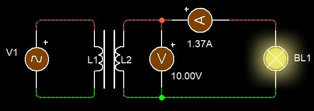

Now, Suppose we have a Circuit, it is active, its operational, running, and we need to calculate the E.M.F, how do we go about this? Well its very simple! Very simple!
Ohms Law gives us the Solution, V = IR and some may like to see the equation slightly rewritten: E = IR;
In this Circuit, we have two components, a Coil and a Light (Lamp). The Coil has an E.M.F Induced in it via Faradays Law of Electromagnetic Induction. We all know this off by heart by now.
We need to calculate the E.M.F, and this is really simple!
E.M.F ( ε ) = I x ( RCoil + RLamp ) = 1.36986 x ( 0.3 + 7 ) = 10 Volts.
So we see here, we have an Internal Resistance in the Coil, normally Impedance, and the Load, the Light or Lamp has a Resistance also! So we can see, we now have  a voltage that is measured and calculated, as an Open Circuit Voltage.
So, what's the difference between E.M.F and Voltage? Nothing, we Measure the E.M.F as the Open Circuit Voltage, that's all.

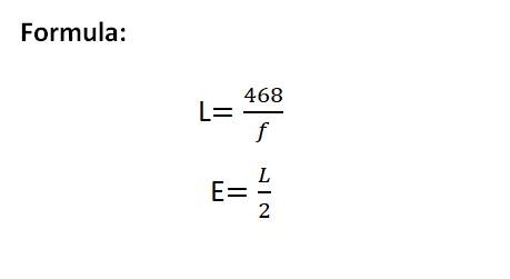

Here is a short calculation to show the speed in an Antenna:
At Antenna Resonance, we can calculate the Velocity of the very same Charge Carriers: Electrons, by using the simple math of Antenna Theory:
Of course, the Velocity is stated as 468, so a 1 Meter Dipole Antenna at 1MHz, we have a length of 468 feet. Or in Meters: 142.65 meters. This is at MHz and Per Second.
Calculating this out, if we use: 299.792458 MHz, we get, Total length of dipole:
  • 1 foot, 6.7 inches
  • 0.48 meters
Length of each element:
  • 0 feet, 9.4 inches
  • 0.24 meters
Of course, using Wavelength Equations, we can get Velocity also: v = f x λ = 299792458 x (2 x 0.48 meters) = 287,800,759.68 Meters per second. Slightly slower than the speed of light, 0.96, or 96% of the Speed of Light.
