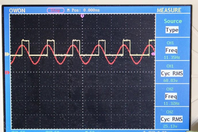

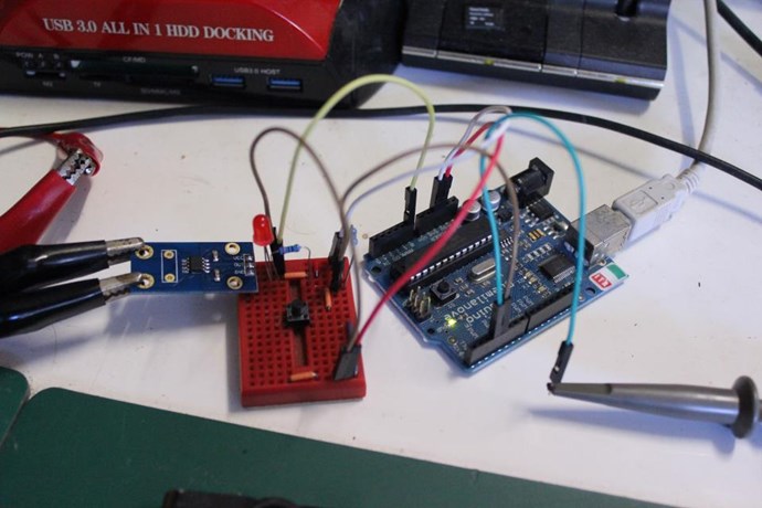

Hey Zanzal - I have been working on a similar thing, not PWM as such, but what I call:
"***   Arduino Uni-Polar Parametric Switch V 1.0   ***"
I am using a few simple and very cheap components to detect peak current and trigger an On Pulse with in this time frame.
Early tests show some progress:
Of course, from our Parametric Research, we know why we are switching here:
There will be limits to my work, Read Time on the Analog Sensor will restrict the upper most frequency.
Arduino is a great platform to experiment with, it is powerful and it is cheap. One could do what we have done for only a few dollars!

Hey Zanzal - Keep Currents low and voltage within the analog port threshold all should be good.
