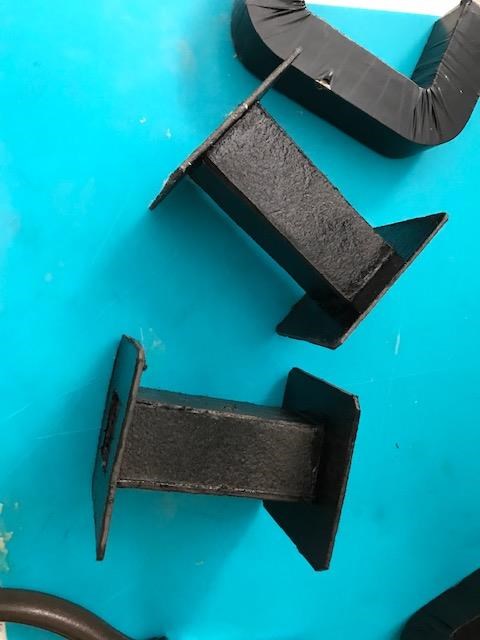

The coil bobbins will be finished tomorrow.
Dimensions of the bobbin is 80x30x30mm, i will use the wire that i already have 1mm.
What do you guys think of winding L1 2 layers ( 1 layer 80T) all together 160 turns.
On L1 coil then L3 winding with 40 turn, to use 1:4 ratio.

The coil bobbins are made and painted. Today i I will wind some copper.

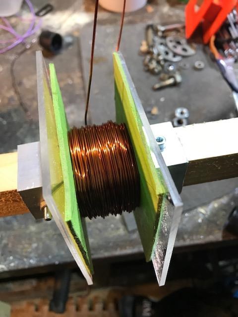

editor posted this 05 January 2022

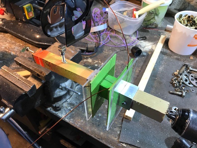

i small update, as you can see on the photos how i manage to get the wooden shaft with the Plexiglas holders to secure the paper bubin so they can get lose during the process. Sorry about the mess.
I did't count the turns, but as you can see I have a neodymium magnet on the shaft to trigger the phone and
count the turns ( Turns counter app). I took the 1mm wire and measure 20m long 2 times for L3 and L2.
L1 will be 1/4 lambda so 5m. Still waiting for some current shunt and then  i will wire all together with the
gate driver IXD614.
by

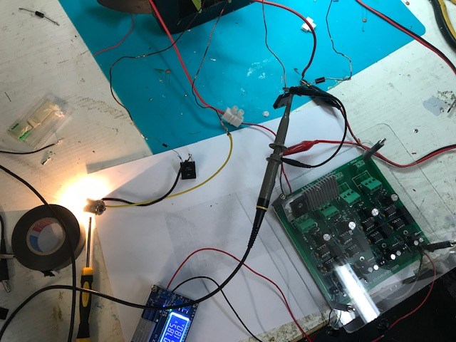

editor posted this 09 January 2022
Hi all.
Connecting the experiment, and play a bit with the device, before connecting to the scope.
have a nice weekend.
br

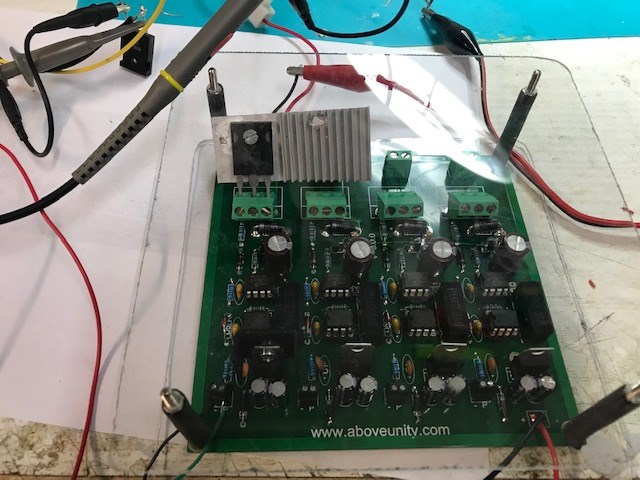

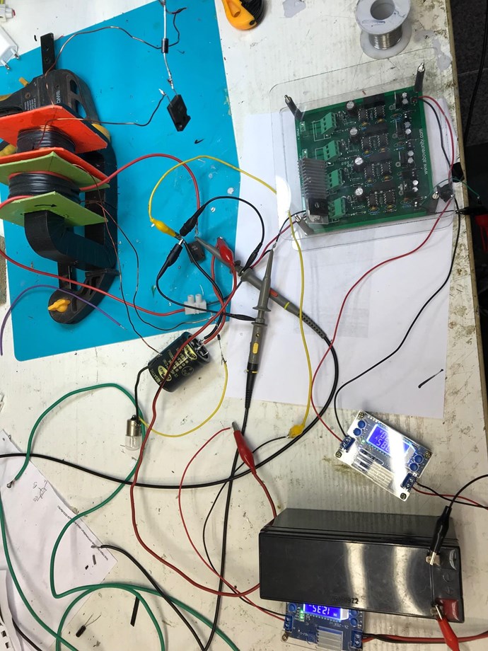

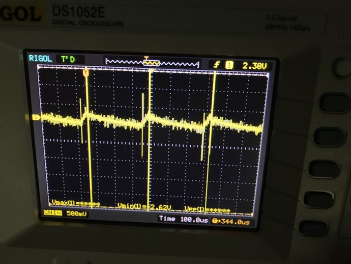

editor posted this 22 March 2022
some new progress in between of other projects. I can tell you it is not fun when F16 are flying over your head few times a day.
Some people here are preparing for Mad Max scenario, buying gens, solar, long term food... and some live their lives like usual.
Nobody knows what is the best, but the realty is, that we went from one business to another in one day and the prices go up.
In the last post you can notice that I have big noise on the scope shot. After a little reading I added the 33000uf and put the ground. out, except from the scope. Happy with the result, now I just to figure it out how to get the triangle.
The small dry battery is for the driver and the big one ( not in the picture) is for the L1.

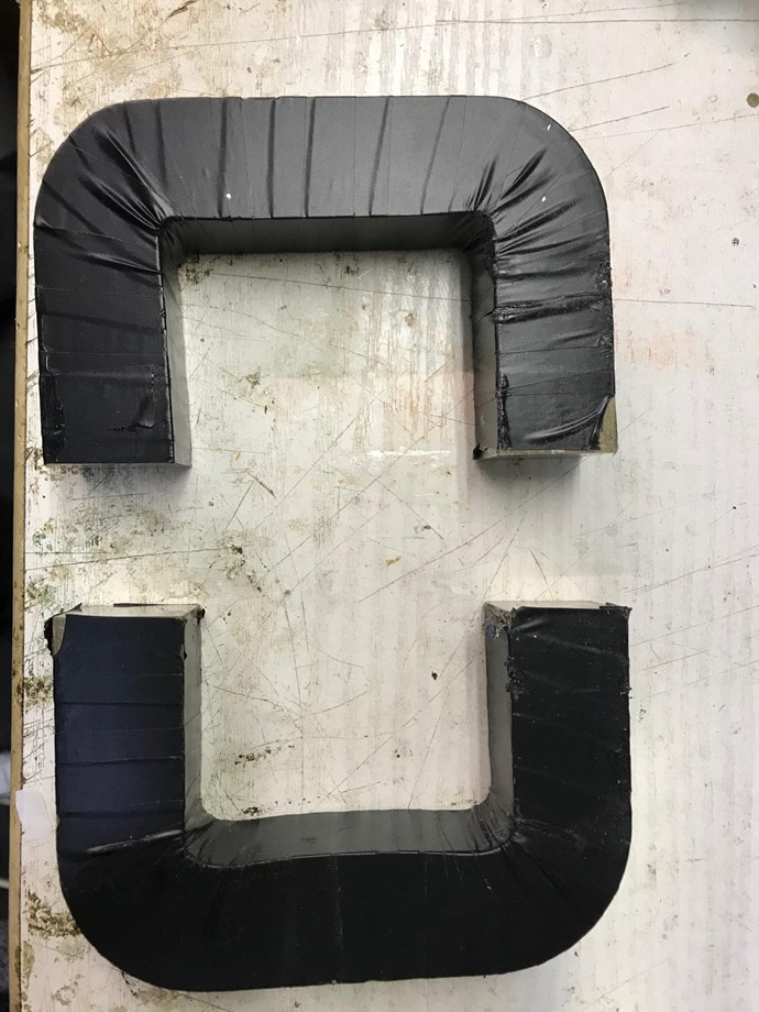

Time flies and some new progress. Finally got the core so the next step is to build the cores,for me one of the worst jobs is to build a nice coil former. I managed to draw and print one coil.The other one is still in the printing process. It takes about 4h for one pair.The two halves go nicely together since this is my first print and sketch.I needs just a bit of grinding, and it fits perfectly, will see how I will manage to wind the 1 mm wire and not to break something.
For some reason I cant add a photo... it is attached.

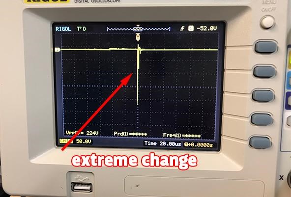

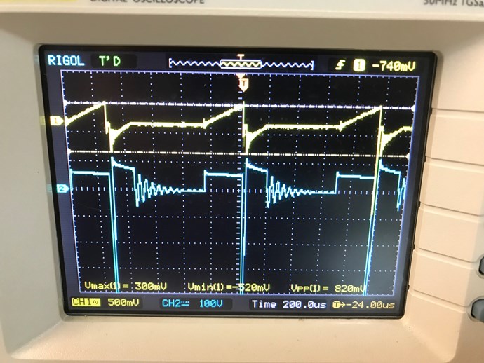

editor posted this 19 May 2022
Hello!

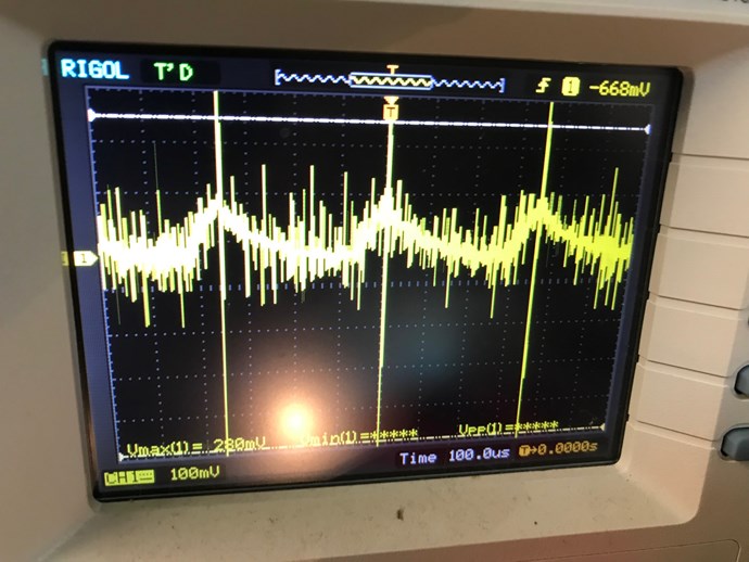

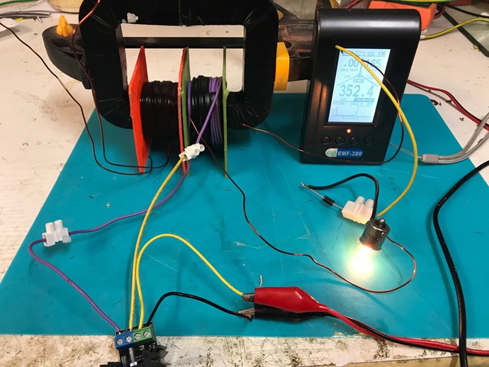

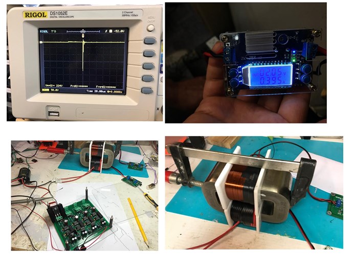

It looks like i finally finished the the device and now the first test.
As you can see on the photo, measuring the L1 the spike looks good but it is very height.
I'm putting in 2V and i got the the voltage on the coil 280v-300v. For IRFP250 this is the max voltage.
I have to limit the spike with 1nF capacitor attached to the coil to lower the spike to 230V (not on the photo). So guys what mosfets are you using?
My power to for the driver and the coil is from the battery but the scope is on the mains. Are you also using the battery to power the scope, regarding the ground?
have a nice day, e
Chris posted this 19 May 2022
Hello Editor,

editor posted this 22 May 2022
Hello!
It is nice that you guys are taking the time and wrote here on my thread, thanks again.
Today I have again a few hours available to work on the 100 W challenge. I will see what can I do,
honestly I'm not sure what exactly to do.
Malendor, tnx, for explaining your ground system I have the same, regarding the large spikes I hope I have to plug in the 1000x probe.
Well see.
Nobody commented on the Mosfet that you are using!!
It is possible that I already blow up my mosfets and I even don't know it, or the diodes. It is possible that they are working fine on lower frequencies or if you measure one with the meter, but on high frequency they are not working us they should.
After spending some time in the lab some small progress.
I measure the L2 and L3 inductance at 10khz and the resonance frequency is at 10khz.
After changing the diodes at the measuring block and direction of L3
The current went from 0.7A to 0.33A and I have a little light
br, e
Chris posted this 22 May 2022
Hey Editor.,
To start with, I recommend starting Input Voltage between 3 and 10 volts. Anything more than that, you're just putting yourself and your equipment at risk unnecessarily!
If the Mosfet is switched properly, and with the right protection circuitry, then blowing mosfets can easily be avoided! Threads here on this forum show exactly what's required to achieve this task.
As is already pointed out, observing Effects first, will yield Results. Not pushing the machine and Circuitry beyond their operational limits.
editor posted this 24 May 2022
Hello!
After 2 days of intensive work some progress. For now i just burn 2 bulbs.
I did loft of experimenting with the device, make one big mistake that  took me some time to figure it out.
Measuring problem, but i fix that.
Later on i was playing with the device with:
  • different loads, 2w, 5w, and 20w bulb
  • different voltage on L1 from 3 to 12V
  • different turns on L1
  • gap or no gap on the core
  • measuring the natural frequency of the coils ( 11khz, 31khz, 130- 150khz)
  • polarity of diodes and L1 current flow direction
I can get the triangle waveform measuring the current on L2 ( bulb) but I'm far from 10v and 10A.
When the light is nicely bright!
Any ideas how to increase the triangle?
b,re
Chris posted this 24 May 2022
Hey Editor,
Very Nice Work! Well Done!
To answer your question, one needs to know what we are looking at.
The Oscilloscope reads this Amplitude on the scope is the Voltage Difference between Ground and Positive on the Probe Tip.
We know from Threads here on this forum, that Voltage is "Generated" in a Conductor when:
  1. Magnetic Field Density B - From initial to Max.
  2. Time Rate of Change of this same Magnetic Field - Time in Seconds.
  3. Number of Turns N - That are exposed to this same Magnetic Field.
Of course Lenz's Law gives us the Sine, or polarity, of the "Generated" Voltage, which will be opposite, if one applies the Right Hand Grip Rule.
Now, one needs to figure out what the exact process are to Induce this Voltage Amplitude.
Of course, as B increases as does V, so making your Coils Voltage Higher means increasing your Magnetic Field or Turns.
Some years ago, I came to the conclusion that, we must do this for ourselves to help ourselves! No one is ever going to help us!

editor posted this 28 May 2022
Hi Chris!
I was playing again with coils, and also change the primary with 2.5mm wire.
Here are the results, measuring the voltage and current on the DC-DC inverter at the battery.
Poc2 OPEN TERMINALS
8.2V
0.405A
Poc2 diode connected (measuring block)
8.2V
0.455A
Poc2 change the polarity of diode
8.2V
0.450A
Poc1 (load) changing the diode polarity
8.2V
1.325A
I don't get it, the lowest current is when the Poc2 is not  working ( open terminals)!!
Still thinking about it, I got the triangle effect, but from the input current it looks like my Poc2 is not helping
the primary at all.
br, e
Chris posted this 28 May 2022
Hi Editor,
Wistiti's video shows how its done. You need to fix your Polarity's, you have it backwards.
editor posted this 09 June 2022
Some new progress. I print a couple of new coil former's and make new version of it.
Basically I started from the beginning, ending up with some new pair of coils and use all of my 5 kg copper wire.
The last pair is nicely wound with the natural frequency of 266 Khz on the spot for both coils.
Today I just wound the primary and check the switching. The scope shot is taken on primary with the open L2/L3,
to me it looks good!
br, e
Chris posted this 09 June 2022
Hey Editor,
Excellent Work! Thank You for sharing!
As is shown in the Thread: The Input Coil, you have a very nice and Ideal waveform!
The mean Input Power to your Input Coil is greatly reduced due to Power being sent back to your Power Supply:
Marked in Red, is Negative Power, where Voltage V x -Current I = -Watts. Negative Current, in this situation, is Current going back to the Power Supply, which is only possible under very well defined situations when one has a Pure DC Source, which is incapable of providing a Negative Current as Conventional DC Current is always Positive.
This Negative Power, can be amplified by techniques already shown.
By the way: You have by definition, a: "Non-Linear Load", your Input Coil is a Non-Linear Load on your DC Power Supply! That's why you have Power Coming Back the opposite way!
Well done! Thanks for Sharing!
editor posted this 11 June 2022
Hi!
the forum was down for the last day at my location, try it from 3 different ip-s, with no luck.
But today is another day and it is working, great. I got electrocuted yesterday, and that shock bring
the smile on my face. As I can see i got my voltage up, with 6v and 0.6A at the L1. I did quickly try the diode and the bulb
but no juice, yet...
Here is a short video, till now i was just reading that is possible to get such a high voltage, but no video or photo.
Chris posted this 11 June 2022
Hey Editor,
I have fixed the issue. Video now plays and poster is default. An odd problem on the Folder Naming, believe it or not, the difference between e and E appeared to solve the issue.
The Video Tag can be edited for a custom Poster by using the following code:
<video controls="controls" poster="PATH TO YOUR POSTER IMAGE HERE">
<source src="../../Path to your.mp4" type="video/mp4">
Your browser does not support the video tag.
</video>
On your Video, Partnered Output Coils require a Load, a Current must flow, to make them work as intended. The reason for this is a Current in each Coil, makes for a Magnetic Field and it is the Magnetic Field Interactions that "Generate" Energy which can be in Excess of your Input when enough Energy is "Generated".
In "Generating" Energy, one must have a specific change in value of Magnetic Field B, which is di/dt, in proximity to a specific number of Turns N, which is Electromagnetic Induction, to achieve a Voltage V. However, if no Load is applied, then no Magnetic Field is produced from this Coil, which is necessary.
Your Build is impressive! Very Nice! Well Done!
