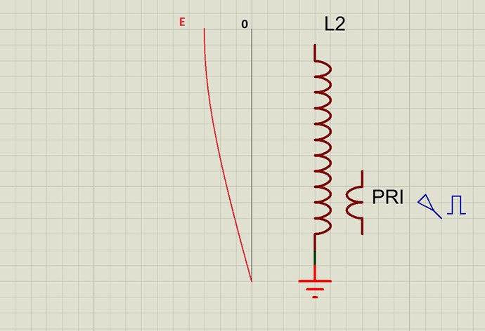

In the next image you can see a schematic of a typical grounded λ/4 Teslacoil, which is much the same, except that the feeding is done by transformer coupling and a primary coil. By the way some radio transmitters use similar technique:
The red graph shows the distribution of the E-field, the B-field would be inverted with the maximum at the bottom.

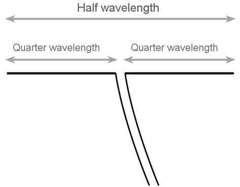

Now imagine what would happen if we remove the ground connection from this teslacoil. The pattern of the E-field would change completely, and provided that the same L2 wirelength remains, the resonant frequency will double. Or we can use an L2 of twice the length, maintaining the same resonant frequency. But now we have a λ/2 TC.
And an antenna corresponding to this wave pattern would look like this:

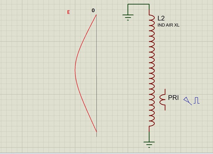

So, a half-wave TC can not be grounded? It can, of course. We could add to this very same layout a centre-tap to L2 and connect it to ground without changing the field pattern.

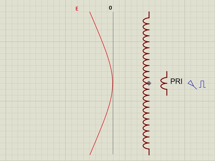

Or we can connect the two open ends to ground, which would invert the pattern of the E-field, like illustrated in the next image:
This is by the way an example of a closed loop E-field antenna. If needed an aerial could be connected to a centre-tap, where the maximum of the E-field appears.
