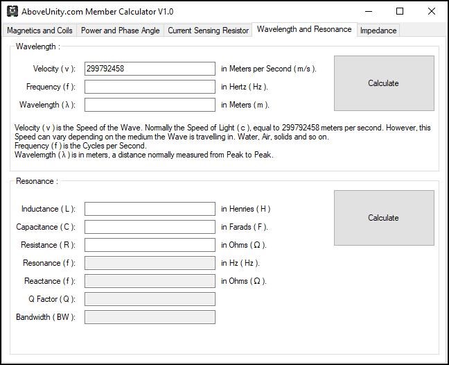

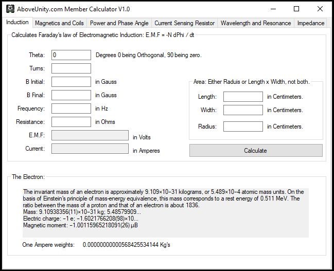

I have built a small calculator to help all members here at Aboverunity.com.
If you want to use it, its attached below in .Net 4.5 Format. There are a few Developers here, so please add feed back if you wish.
First file is the Code, second is the EXE File, the calculator.
Best Wishes

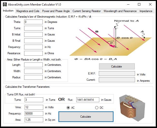

I have added some new Calculators to the Aboveunity Member Calculator:
If you wish, you can test the EMF Calculator here. Remember, one Tesla is 10000 Gauss.
Chris posted this 11 March 2020
A small update, a request by CD_Sharp, I have added the Transformer Calculator, to obtain Turns or Flux:
I should explain, the AC and DC Radio Buttons change the Form Factor value, 4.0 for DC to 4.44 for AC. Please remember to select the right option of the value given will not be correct. This value comes from: The average emf per turn = 1.11, RMS value of emf per turn = 4.44. So in an AC Transformer, Sinusoidal, FormFactor = 4.44.
Now you can calculate Transformer Turns or Flux. Sorry this took so long! I have been busy with everything.

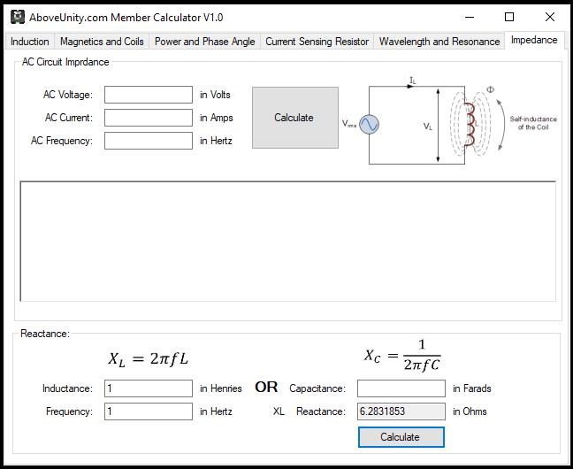

Chris posted this 13 March 2020
Another small addition, Reactance by itself:
Attached below.

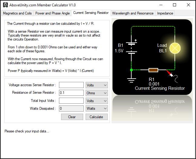

Jagau posted this 22 March 2020
Yes it is helpfull
AS AN EXAMPLE IN the sensing resistor section we have to change the 0.1 which is already programmed with a dot
to a comma 0,1 and it works fine,  again thanks.
It’s just to help other members.
thanks
Chris posted this 22 March 2020
I can change, so it is already 0,1 if you like? Just for you and others that have the same problem?
I did automatically program that, so its easy to change! Fixed formatting is attached below.
I have added the following code:
// Use CurrentCulture NumberFormat to set the Format:
if (NumberFormatInfo.CurrentInfo.CurrencyDecimalSeparator == ",")
    srRTextBox.Text = "0,1";
else
    srRTextBox.Text = "0.1";

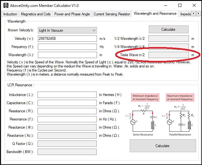

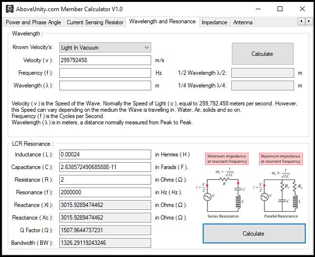

Chris posted this 09 August 2020
Today a small improvement on the Above Unity Member Calculator:
I have added some of the well known Wave Velocity's. Shown above is I think 14 Velocities, well known in Science. Not that most of them will ever be needed? I have made our most common Velocity default, the Speed of Light in a Vacuum:  299792458 meters per second, so this wont change, unless you change it. You can also set your own Velocity if required, its up to you to type that in if you need to?
Also, I have added Half and Quarter Wave calculation.
The updated Calculator is attached below, enjoy!

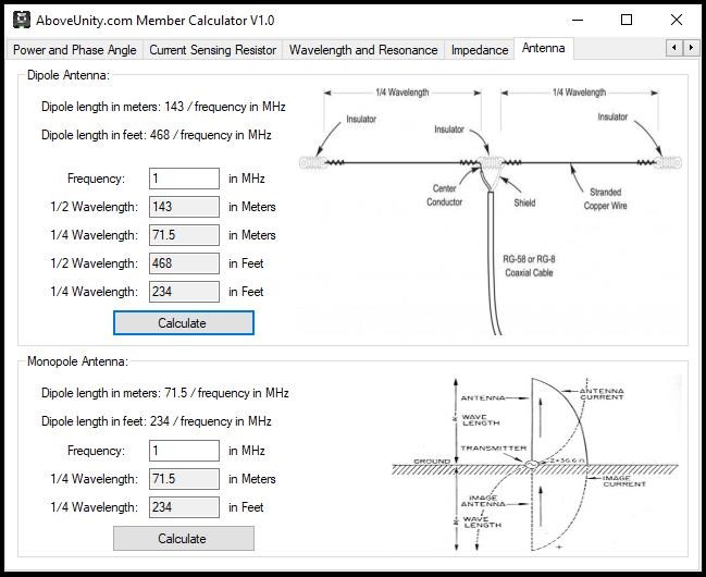

@Jagau, sorry My Friend, I just made another small change.
I have added some Antenna Calculations, for a Dipole Antenna and Monopole Antenna:
I have also changed and improved the RLC Resonance Calculator, now allowing for C to be calculated and an bug fix on the Q Factor:
Attached below as always, enjoy My Friends:

Chris posted this 10 August 2020

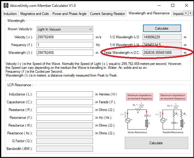

To clear up my confusion, you want Wavelength λ from π/2 C. is this right?
In other words, another textbox with the equation for Wavelength of Tesla Wave:
So, the Math from this page: https://drnikolatesla.tumblr.com/post/612603462700646400/nikola-tesla-aka-mr-pi2c
v = (π/2)c
v = average velocity of Tesla’s electrical current around earth in miles per second
(you can plug in any metric and get same results)
c = speed of light in miles per second
v = (π / 2)186,300
v = (1.57)186,300
v = 292,491
That’s 324 mps lower than Tesla’s mean average recorded in Colorado.
Jagau posted this 10 August 2020
It was just a suggestion. Don't feel obligated by this.
Tesla contradicted Einstein's theory of relativity with his patent
787412, as irrefutable proof that there are faster than lambda.
Thas why we call this Tesla wave.
Do you want a complete Calculator for this? Or just Wavelength?
Its no problem, its easy, just want to make sure I am adding something that will be of use.
just wavelenght Chris
Let me know if you need changes:
Currently, the calculation is: Velocity = Pi / 2 * 186300 / Frequency = Wavelength. Wavelength λ = V / f.
Not sure I should be using Miles per second? Kilometres per second might be better option? Make sure the Units are right?
