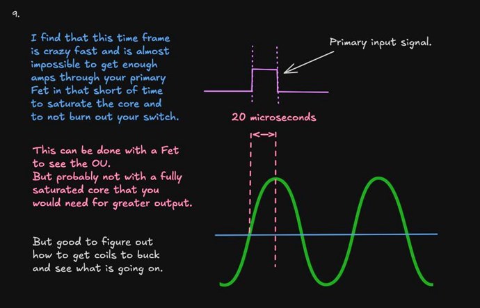

I tried to zoom into your scope shots to analyze them a bit more, but I cant quite make the numbers out.
Its good to see you are having some success, hope the Numbers are looking goo also! I am sure they are, its not super hard.

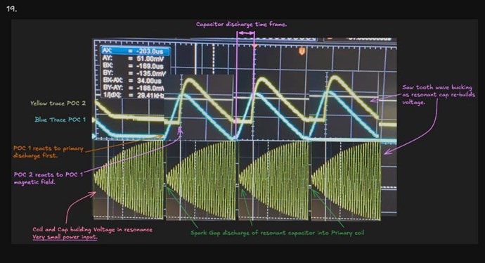

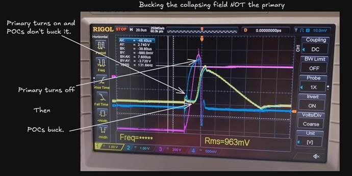

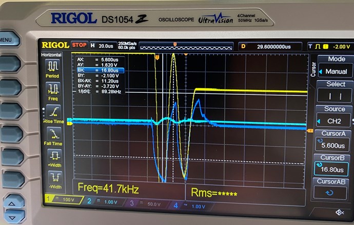

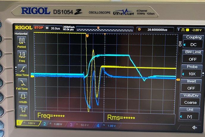

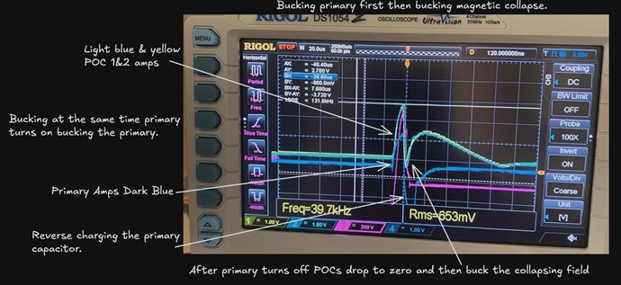

Chris,

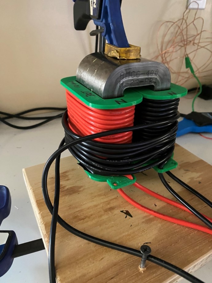

On this particular device with the primary around both the COP coils.
I see two ways of making this work:
1. The two POCs buck the primary first then when the primary turns off they buck each other ( and or collapsing field).
2. The primary first creates the magnetic field without the POCs bucking it and then they buck the collapsing field.
(by just turning the diodes around)
 #1.
 #2.
I have had the best luck with #2 not bucking the primary but just bucking the collapsing field.

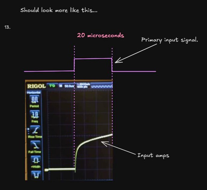

It’s several times output at this point without collecting the revers energy recharging the primary capacitor. As you can see in the scope shot the reverse charge into the primary cap volts in yellow goes down past zero almost recharges the cap to full before reverberating back and forth.
I may be missing something on #1 POCs bucking the primary field first but I am unable to get a good output with this so far.
It would make sense to me that Don Smith did it with #2 not bucking the primary since he used a small neon flyback transformer that has very low power output and no primary capacitor to discharge. He just made the magnetic field in the core that the primary is wrapped on with no push back and then let them buck the magnetic field collapse, I think. Which is what I’m doing.
What has been your experience with this device, did you have better success with using #1 or #2 or something I’m not seeing?
Thanks.
Adam.
Chris posted this 24 September 2024
Hey Adam,
Most all of your Scope Traces are on the Positive side of the Zero Graticule Line on each Trace. Very little going onto the Negative side.
Great work, Thanks for Sharing!

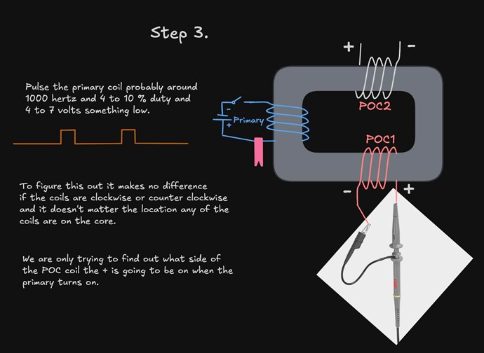

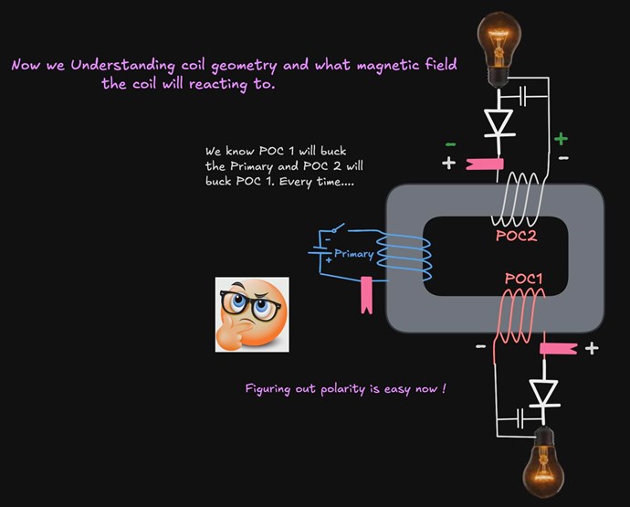

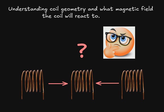

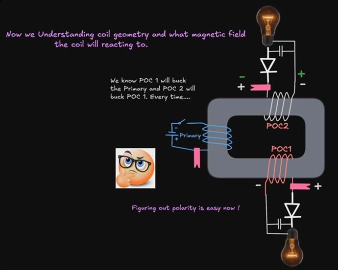

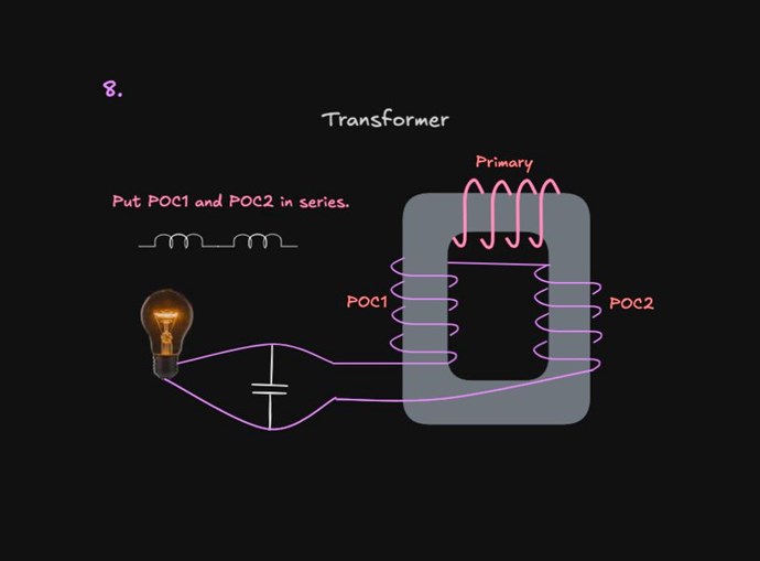

Adam posted this 15 October 2024

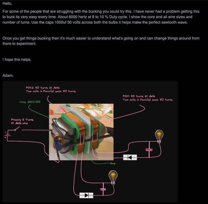

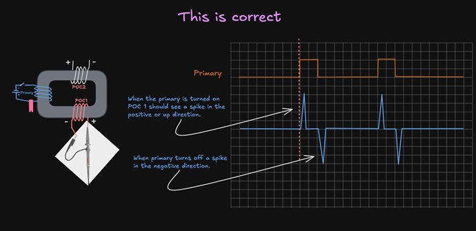

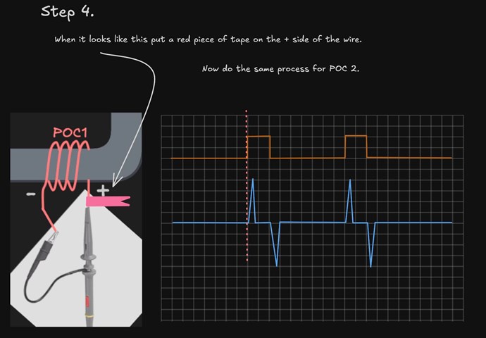

Hello all,
I thought I would give it a go and try to see if I can help others figure out some of the polarity issues or geometry of the coils and how to figure out what magnetic field your coil is going to buck.
It’s actually very simple if you look at it like this.
Hope this helps…
Adam.
leonel posted this 21 October 2024
Excellent work Adam, this is one of the best threads I have seen. The simple and graphic explanation that you have presented cannot go unrecognized.
And also many thanks to Chris, who, like a father who takes care of his children, strives so that this forum continues to shed light in this world immersed in darkness.

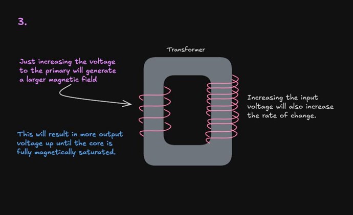

Adam posted this 24 October 2024

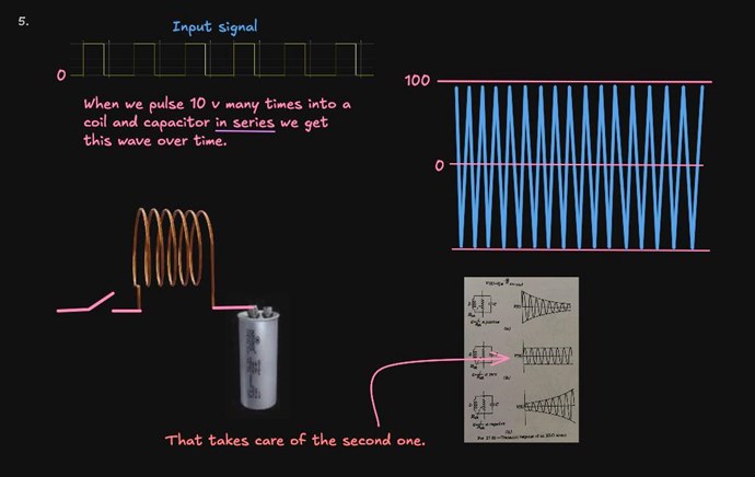

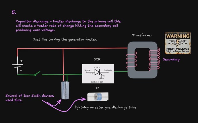

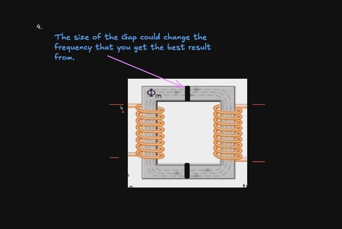

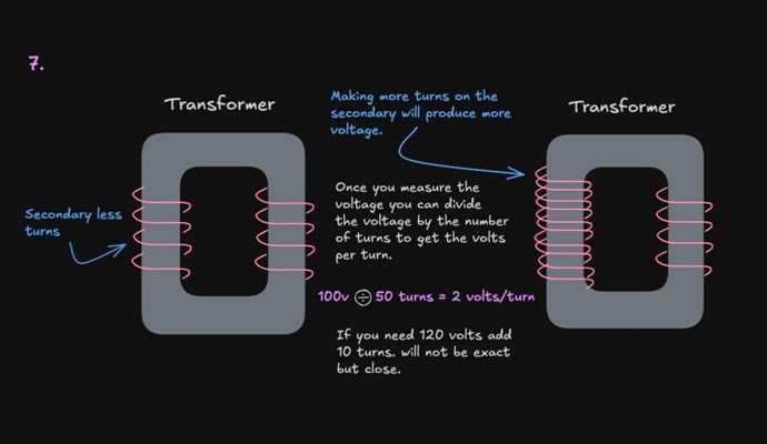

Hello,

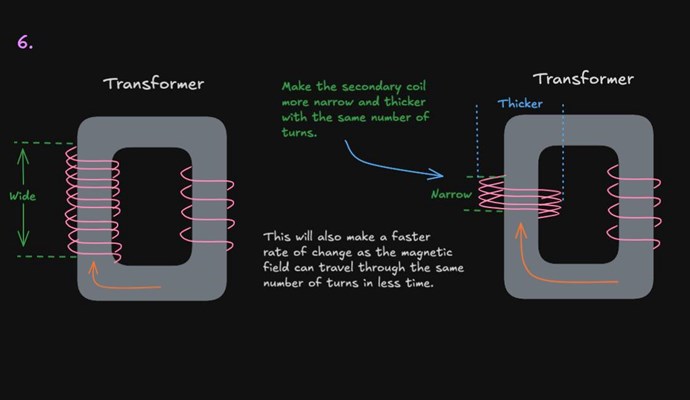

I have attempted to make a small list of ways to increase the output voltage of the secondary coils. Now this is not all of the ways but it is most of the known standard ways to increase the Rate of change .
Remember just changing how fast the magnet swings past a coil (Rate of change) will change the output voltage!
There may be a few more ways with just different winding techniques and coil configurations.
If you can think of any more configuration or disagree with what I am presenting, please comment.
Hope this helps.
Adam.

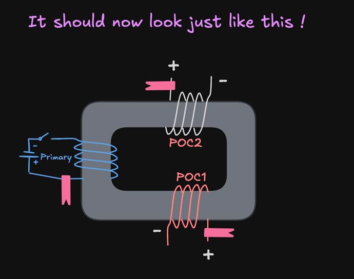

Hi Adam, just want to express my appreciation for your detailed drawings and summary of guidelines and key points in implementation. This is so helpful and so valuable!
Btw, in your point 8 above the POC2 coils is wrongly wound. It would be really helpful if you can ensure correct winding directions (CW/CCW and opposing fields) for all the coils, otherwise it may be confusing for newbies who may try to replicate just from the images.
Thank you again for sharing these!

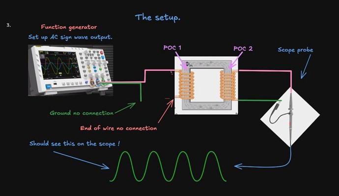

Adam posted this 03 November 2024
ISLab,
This will work CW / CW or CCW / CCW or CW / CCW.
You can get them to buck in any of these configurations.
I understand what you are saying but don’t focus on it. Take a Look at Don Smith CW / CW he made it work... also Tin Man….
I personally wouldn’t focus so much on CW / CCW right now. I would focus more on making sure the coils are reacting to the correct opposing coil.  This I have shown above with red tags.
In my opinion, I would work on just getting any two coils to buck with the same output on each. Like this…
Remember, you should have the same size load on each coil, bigger the load bigger magnetic field it creates and a cap across the load will help.
Hope this helps
Adam.

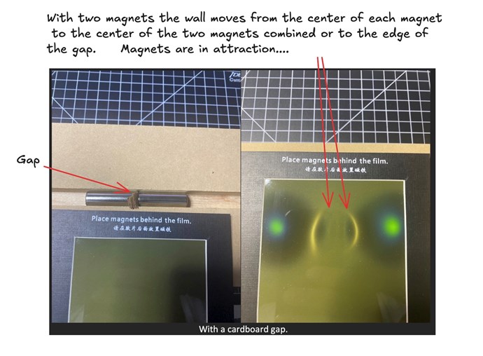

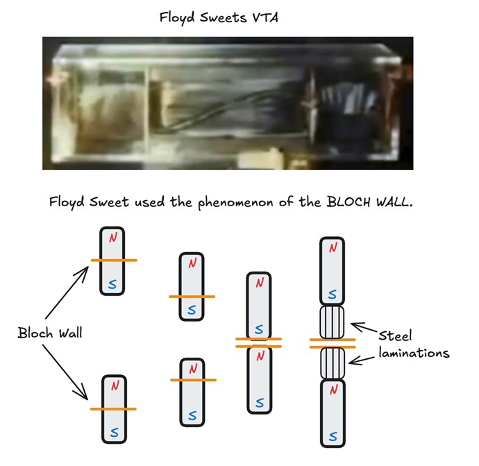

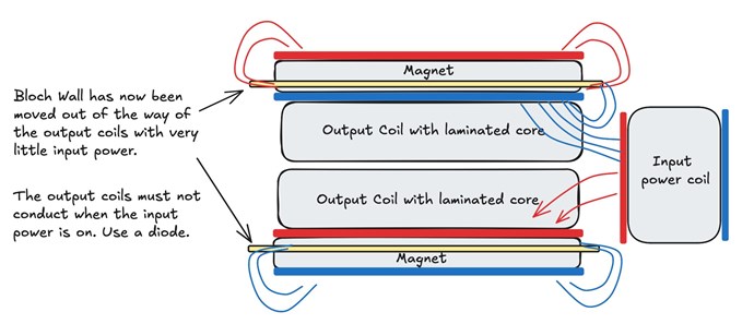

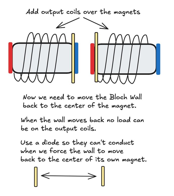

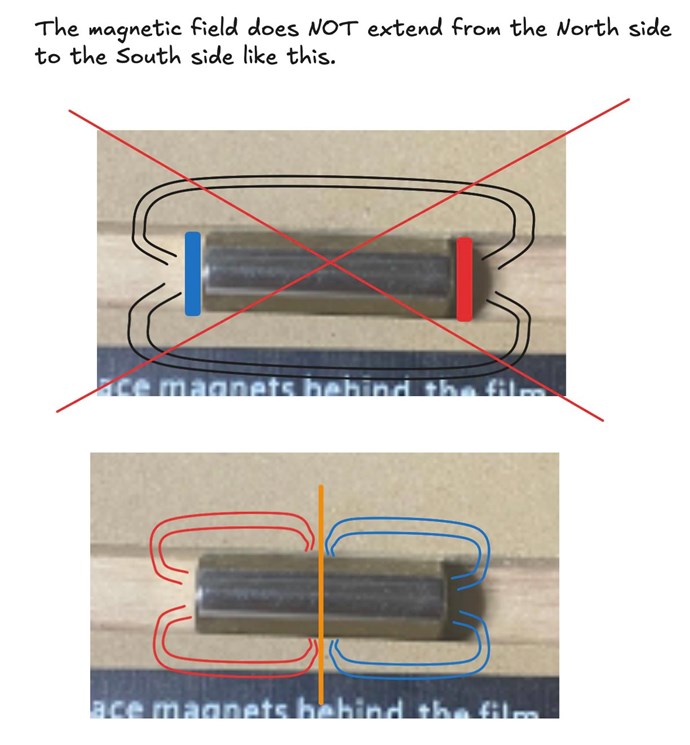

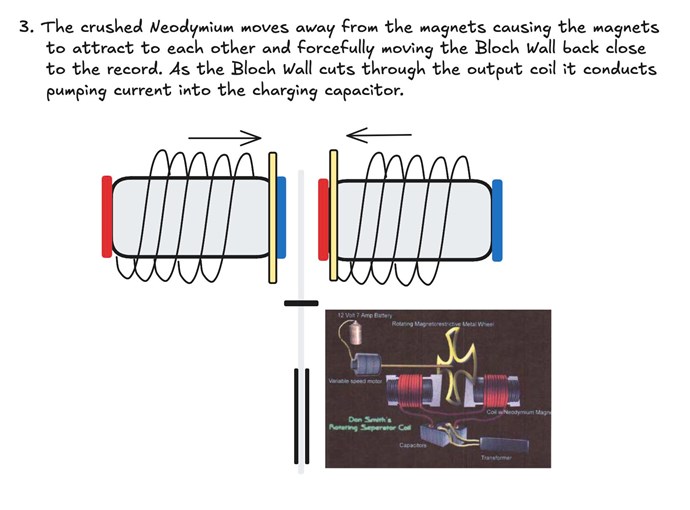

This is posted on another thread. I’m just posting again here for my own reference.

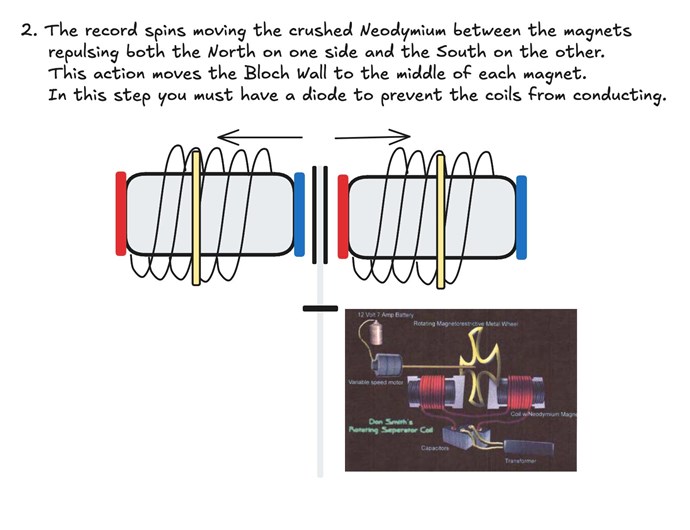

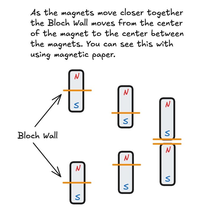

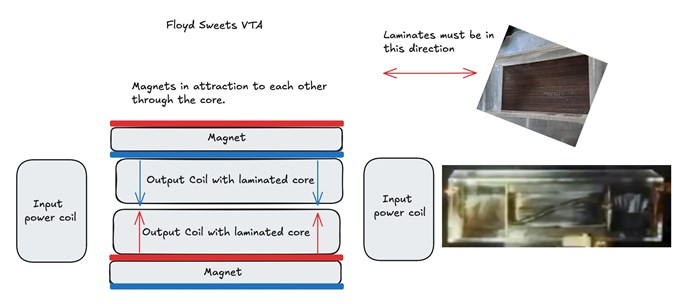

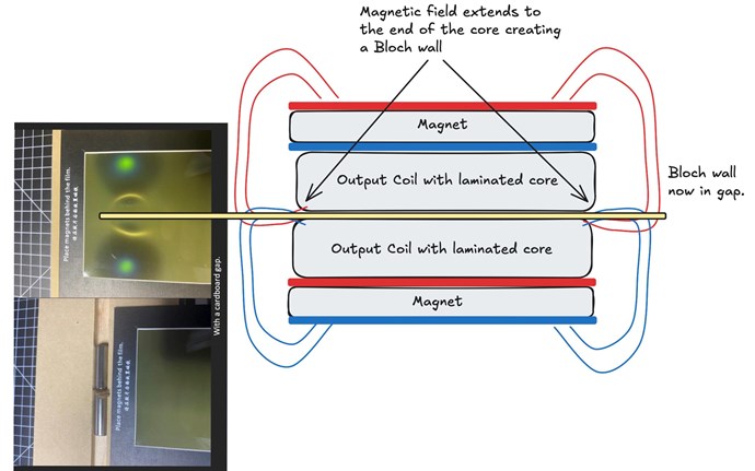

This is just my total speculation and guess on how Floyd Sweets VTA works or the principles behind it. Not sure how close I am to the correct answer but take a look. My hole theory works on moving (with very low input) the Bloch wall that all magnets have in the center of them or maybe something similar to this.

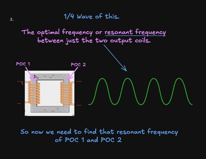

Hello,
I was thinking I would revisit this.

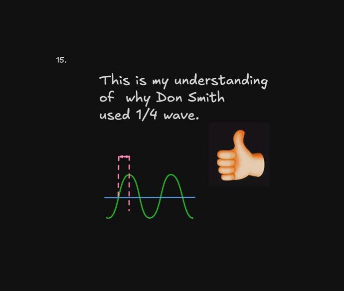

This is my understanding of why Don Smith stated that the coils need to talk to each other and that the primary should be about ¼ wave.
But ¼ wave of what?
Chris did a good video of this:
The Secret Revealed - Resonance Magnetically
Thanks.
Adam.

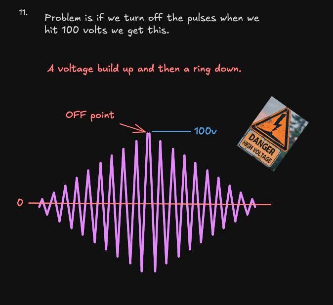

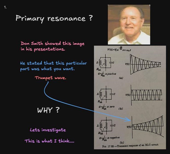

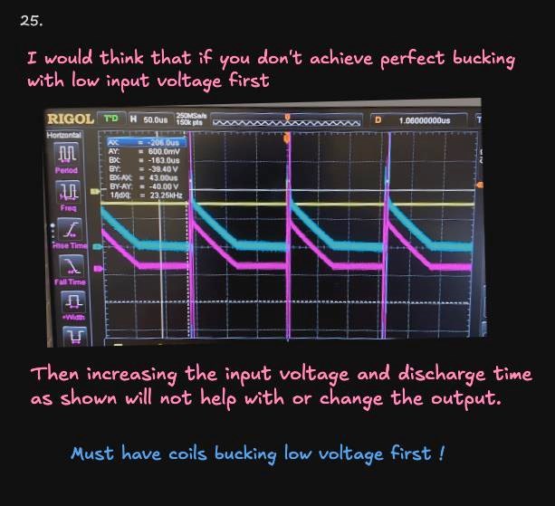

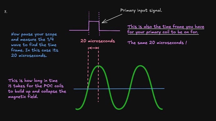

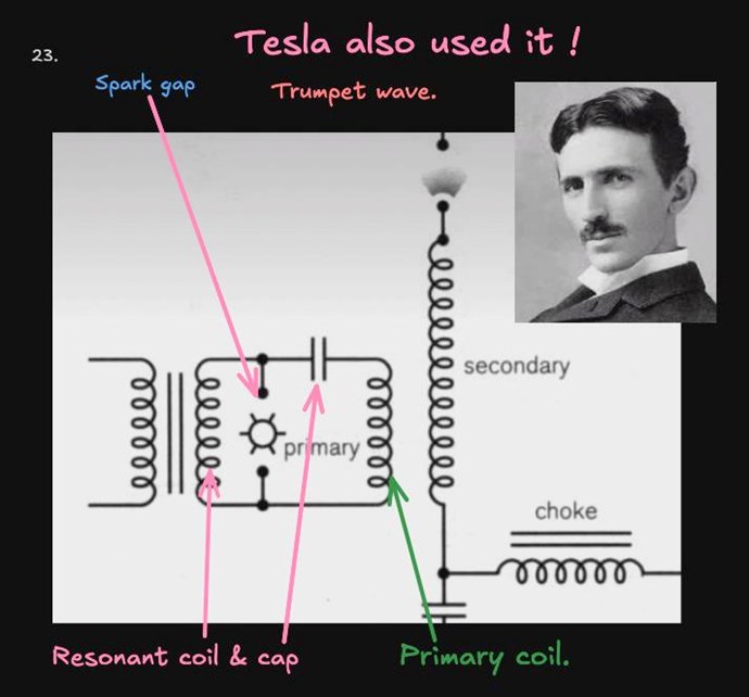

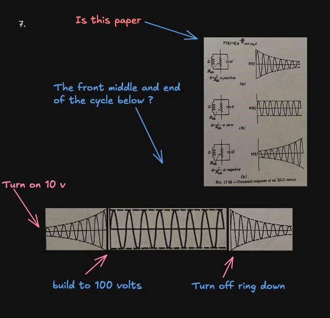

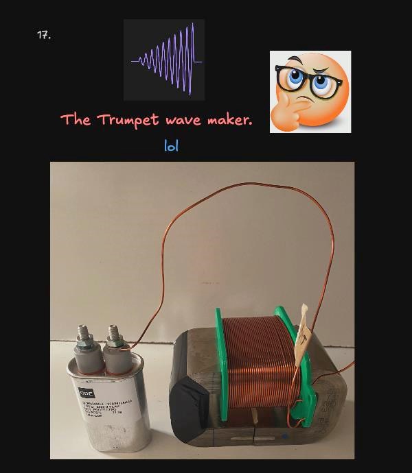

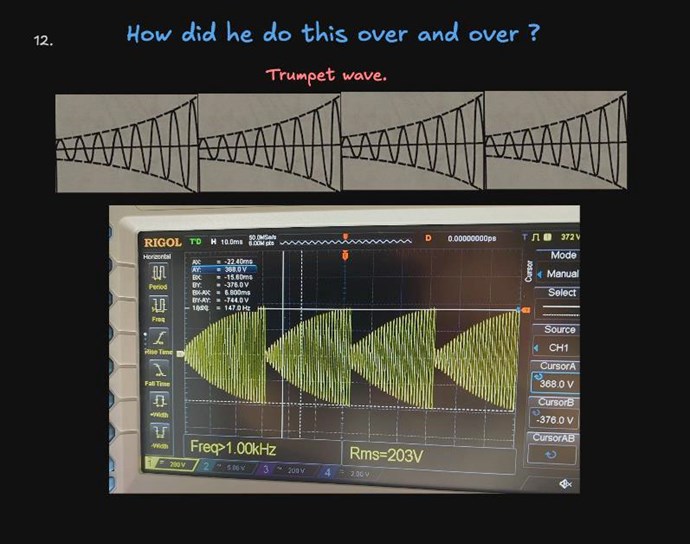

Adam posted this 10 November 2024
Hello,

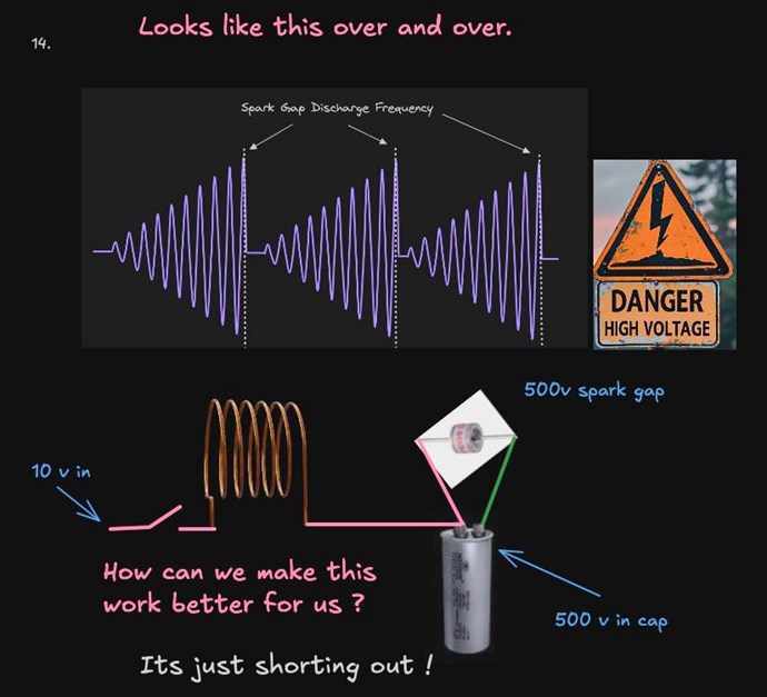

I thought I would bring up something I don’t think I have ever seen anyone talk about in detail.
In my opinion this is very important!
Don Smith talks about the Trumpet wave.
What is it and how does it work?
We must have the coils bucking with low power input first!
Because
High voltage is  DANGEROUS….
Yup, Its another slide show.  lol
Since everyone is using it and not telling us why it must be important !
Have fun
Adam.

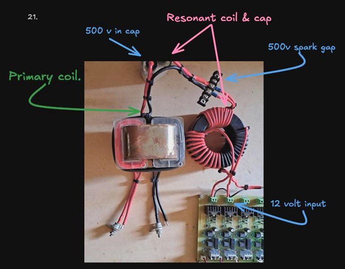

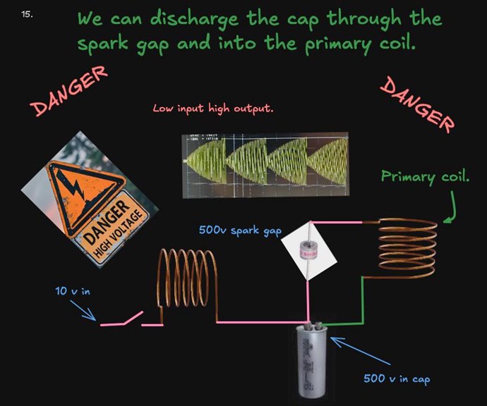

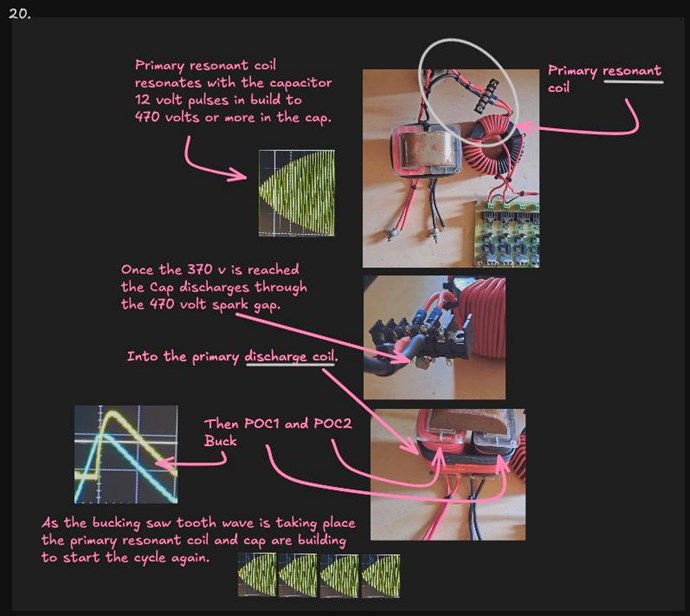

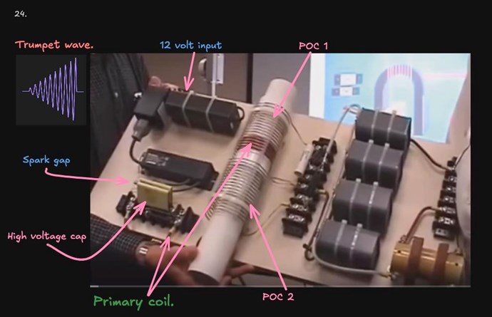

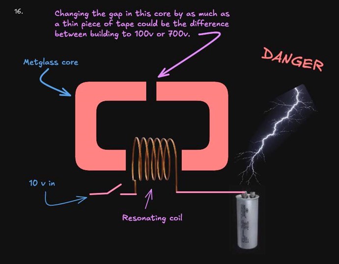

Adam posted this 23 June 2025
Just placing this here for reference as it is on another thread.

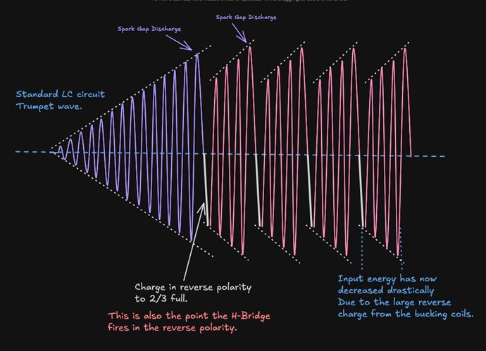

Hello,

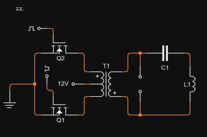

Remember you have two separate cores the first core is resonating your voltage up until the spark gap jumps. Now on the second core the primary fires and the two POC coils buck but as soon as the two coils buck they are also sort of bucking the primary which reverse charges the capacitor. Remember at the same time your first core is still resonating and wants to charge the shared capacitor at the same moment the primary on the second core wants to reverse charge that same capacitor. So we have a bit of a conundrum here, how do we get both cores to charge the shared capacitor in the same polarity at the same moment in time on the first pulse after the spark gap discharge?
If we don’t get this to happen then each core will try to charge the same capacitor in reverse polarity and basically buck each other’s input charge resulting in huge input power consumption and disaster.
But if we do get this to happen correctly then the primary over the POC coils will reverse charge the capacitor 2/3 of the way full and your first core can finish the 1/3 charge in resonance very easily and cheaply with almost no input.
Both cores have to charge the same capacitor at the same moment in time in the same polarity on the first pulse after the spark gap discharge. This is the key !
Chris, how do you feel about this explanation please feel free to chime in.
