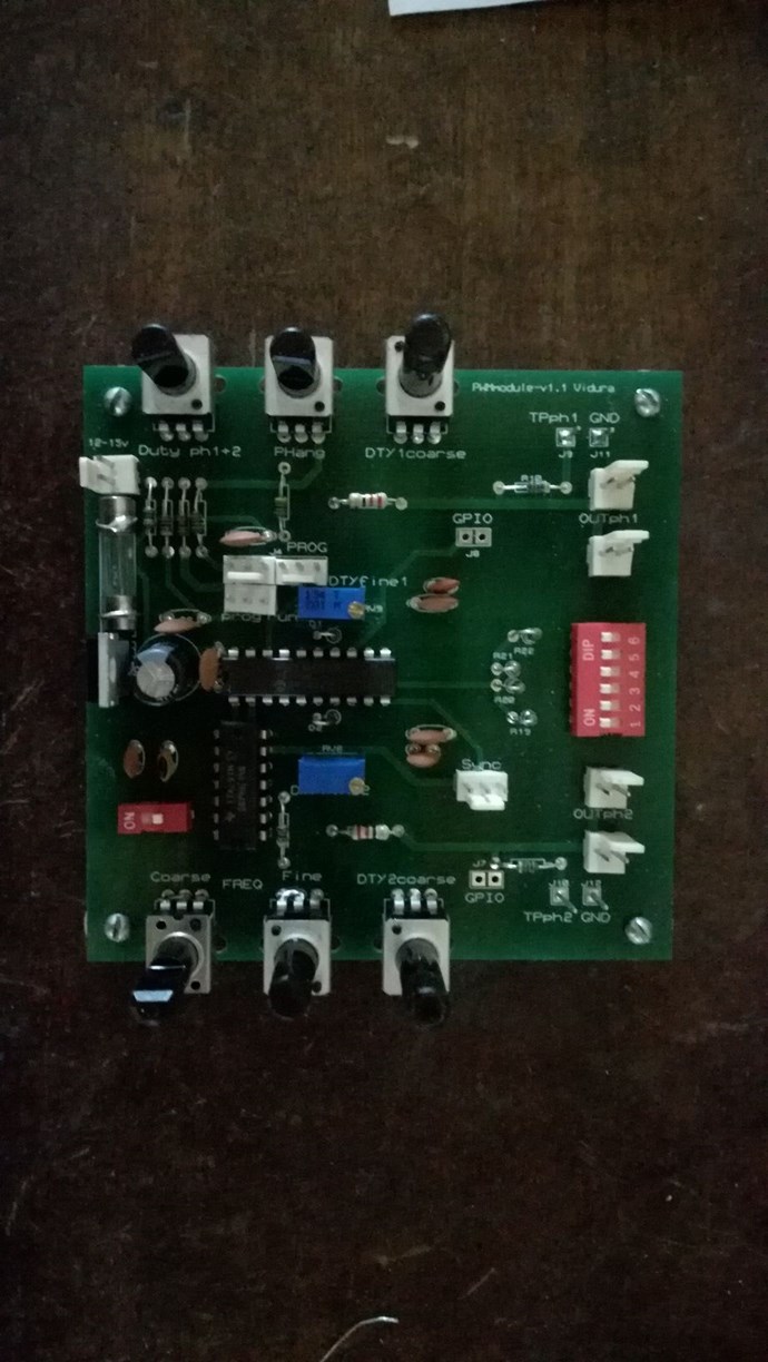

Vidura posted this 03 August 2019
Today I've assembled the first PWM module with the new PCB's. Tomorrow I will test again, how the oscillator is performing with the logarithmic potentiometers, and continue with the other modules for a final design check.

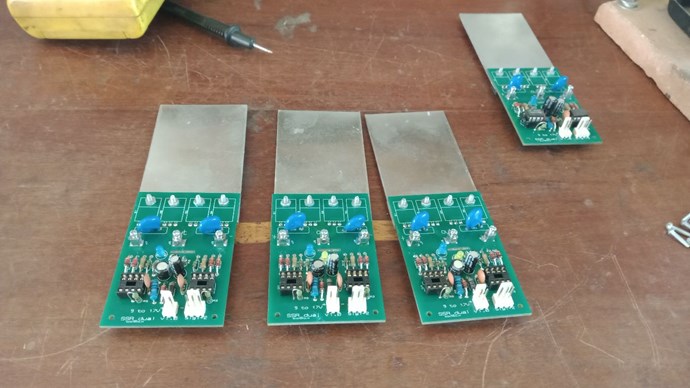

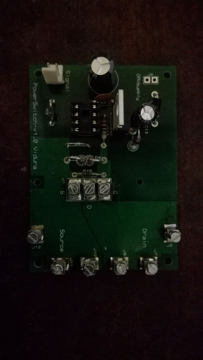

Vidura posted this 14 August 2019
Hello All,
Although the two phase PWM module is still not perfect it turned out quite usable, also the interference from the driver power supply is resolved and the switching modules are performing excellent, floating, very versatile and clean switching performance. So I felt that it is time to release the tool for order , with the PWM module as beta version still. I will make a short video where I will show the weak point that is still on the design, regarding the sensibility of the frequency adjustment. Today I began mounting some switching boards and driver power supplies, as these parts can be perfectly used with a signal generators or other signal source , I thought that it could be helpful for many experiments already, so I'll release this modules for sale. Anyone who's interested just PM me please.
The Switching modules will be supplied with IGBT's H25R1203, which are revers conducting, 1200V and 25A rated ,really tough devices from Infineon, and with the HCPL3120 Optoisolated Gate Driver.
The Switch is easily exchangable with screwconnectors.
Some pic's of assembly progress:
Regards Vidura.

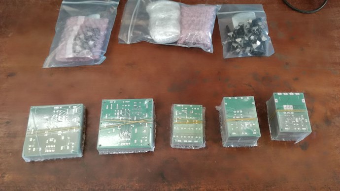

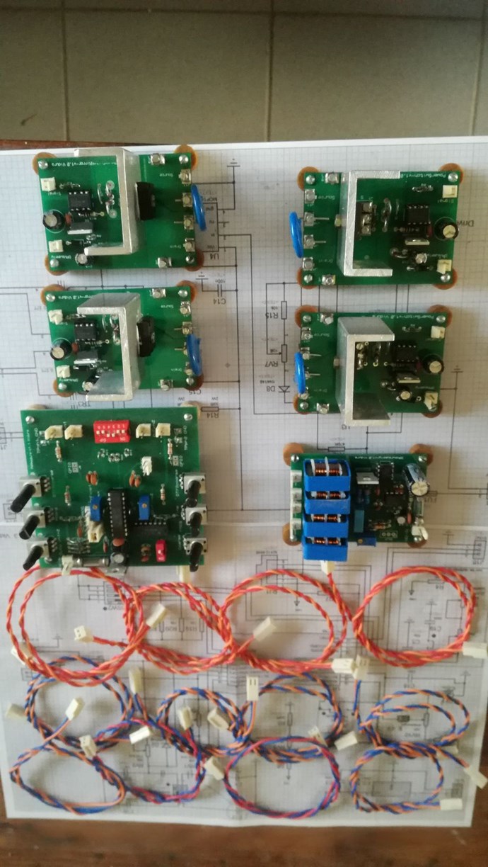

Vidura posted this 20 August 2019
A short update, the Switching tool is now released for ordering, the issue of sensibility on the coarse frequency adjustment is quite good solved with a multiturn potentiometer. Here some images of ta basic Full bridge set:
The slave module I am building some units with the new PCB's, and what's still pending is the users guide(work on progress) and tutorial videos will follow as well.

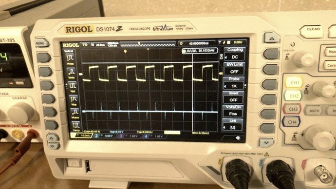

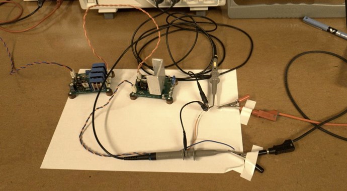

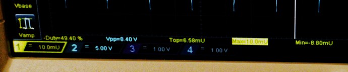

Every now and then I find some odd things going on: I was checking the signal parameters when I drive the Power Switch Modules with the Signal Generator, and compared with the signals from the PWM module. So I measured the voltage and current of the signal fed into the input of the Driver IC. With the PWM Module it was strait forwards, 4.5 V as expected for a 5V processor, and an emitter current set to 10 mA, everything  o k. But when I connected the module to the SG. it hardly reached the threshold current of 3mA for the Driver, although the output was set to the same voltage of 5V and controlled with the scope it was 5V !! To get the correct current for the driver I had to rise the voltage of the SG to 10V. The only explication I have is that the signal of the SG is composed digitally at much higher frequencies(above the capabilities of my scope), and that this high frequency components have a major influence on the impedance of the circuit. As I'm not sure if all SGs perform the same way with this type of Drivers, or if it might be a general property of Digital SGs, I would ask those who have ordered Power Switch Modules to check this with a 1Ohm resistor in series with the signal connection and measure with the scope. The voltage drop  across the 1 Ohm resistor should be 10-15mV for good switching performance, In my case I need to set the SG output to 10-12V.

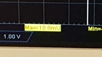

Mimo posted this 15 September 2019
Hello Vidura,
and to all.
This is my first post, but I have been with you since the forum was created. I am located in France.

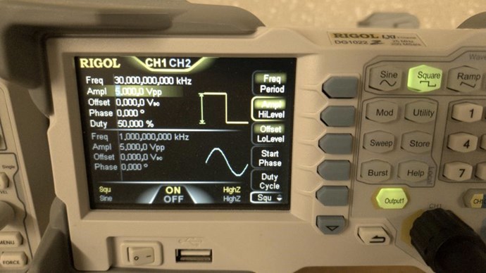

I did the test with my SG Rigol DG1022 with Ampl 5 volts.
I get a VMax of 10 mv, with the resistance of 1 Ohm that I received with the modules.
Note : VTop: 6,58mV and VMin: 8,80mV
It does not seem necessary to increase the Ampl of the SG, is'nt it.
Mimo
Vidura posted this 15 September 2019
Hello Mimo, If I see correctly the scope is on 10mv /division so it would be around 15 mv , which is perfect. Your SG seems to be better quality than mine. Thanks for sharing. Vidura
Mimo posted this 16 September 2019
Hello Vidura,
here is a better picture of the measurements. The division is effectively on 10.0mv.
Mimo
Vidura posted this 16 September 2019
Hello Mimo, This looks good, it is in the recommended operation range 10-16mA, so you can use your SG with this voltage. Vidura

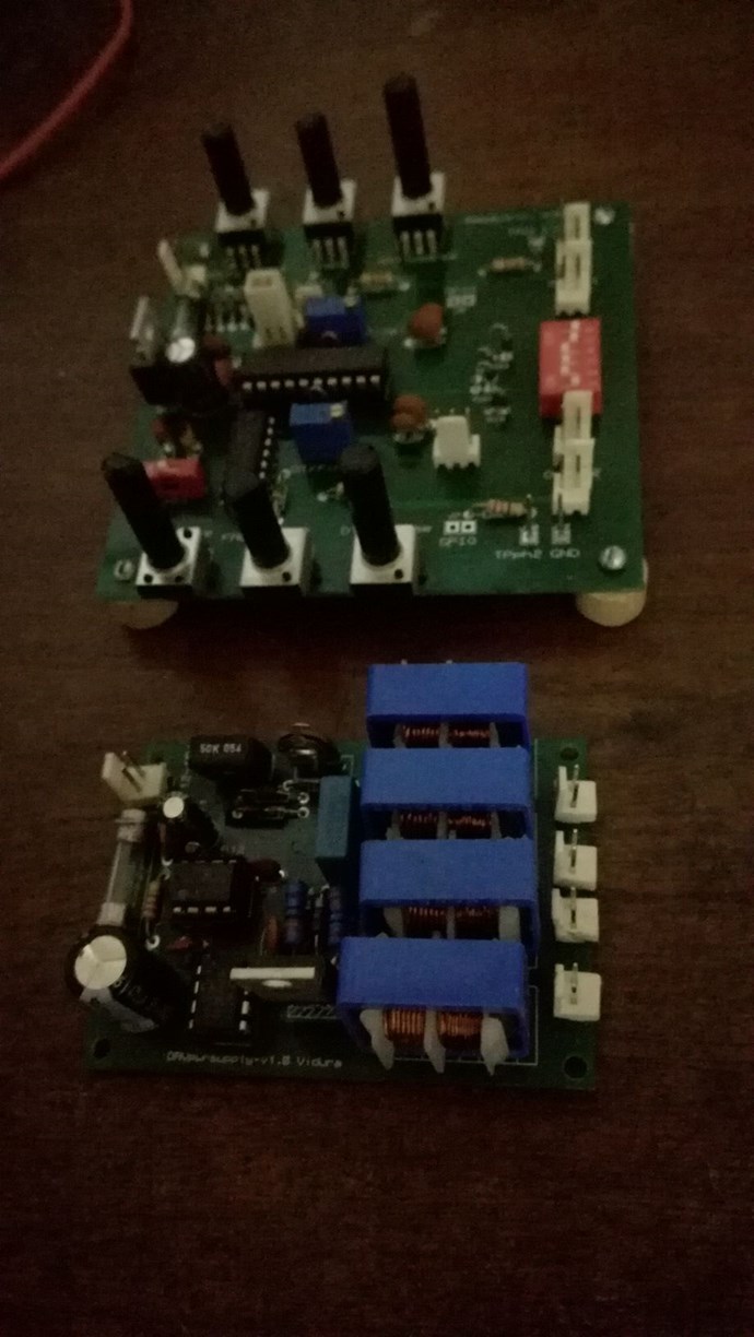

Vidura posted this 16 November 2019
Hello All,
Now with the new version of the PWM module , which came out really nice, the development will be considered concluded. there might come some minor improvements still on some of the modules , but now we can already say that they are fully operative with excellent performance. For this reason I have removed the donation bottom from this thread, and put it to the  thread " Towards a more complete understanding of EM" where some components and equipment's would be very helpful.
Here a short presentation of the new  PWM module:
What I wanted to add is that I have still a few PCBs from the first version, which will be adapted to the new oscillator, and they will be available with a discount, due to the small details in the physical presentation, but fully operational like the one shown in the video. The new PCBs have been shipped already, but this might take some time due to the Argentine Post. My metglass core is now in transit since beginning of September, and still no notification from customsyell.
Regards Vidura

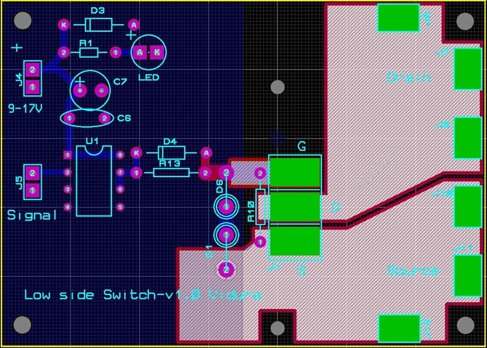

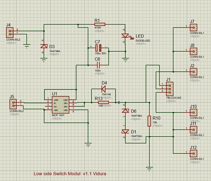

As there are several new members starting to make experiments, I will post the files for a simple  modular Low side switch board. It is not isolated, indented for simple low side switching applications, and has the same features of easy change of mosfet and driver IC, gate protection and additional connectors to place TVS or MOV as overvoltage protection. The driver can be powered from a 12v battery , a PS or similar source and the MCP1407 driver can be fed with most signal sources as SG, Arduino, PWM generators, or custom made circuits. It is open source of course, the production file is attached below. A BOM will be added later. Anyone can order this boards for a few$ from a PCB manufacturer.
Hopefully it will be useful for some.

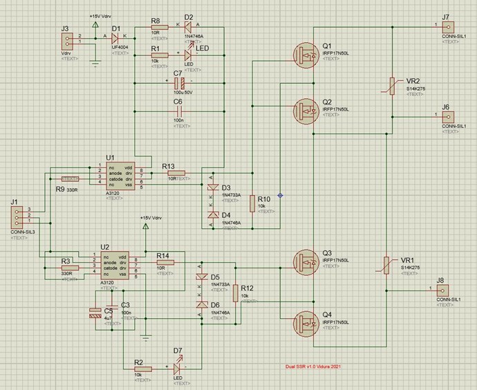

Vidura posted this 24 October 2021
Hello All,

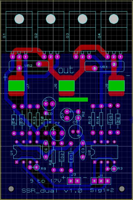

Here I will share a design that has been developed to substitute electromechanical switches with equivalent semiconductor devices.
Solid state relay half bridge:
It could be especially useful for devices like the Tesla switch, or solid state versions of Figueras generator or similar devices, where likely a specific property of mechanical switches is required: conductivity in two directions in on state, and blocking in two directions in off state. The design that I will show you is built as a half bridge module, two units can resemble a H bride. It uses four mosfet(TO220) per module, two pairs connected back to back. A driver supply source oof 12-17 volts is required, the Hi side driver works in bootstrap operation up to 400v, selecting appropriated components(mosfet, bootstrap diode). The Low side switch can be used alone, but the high side switch will only work when the low side has a minimum duty cycle of 5% approximately. The schematic and layout below:
Note : For low voltage applications change the MOSFETs for the required range, and substitute the varistors for protective components matching the properties of the switches, for example TVS, GDTs.
R1,R2 can be 4k7 for better brightness of the led indicators. D1 is the bootstrap diode, and has to withstand the maximal bus voltage.
Note the mounting position of the MOSFETS pin1=gate
