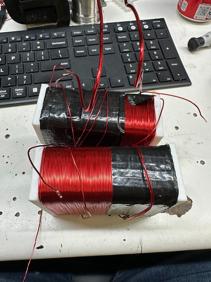

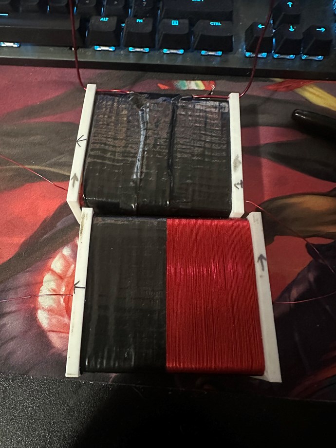

I don't have anything connected right now and I don't have time to run a test, but here is at least, Also I just saw something... I wound one of my POC coils "incorrectly" Its technically fine, but based on all the other replicas I should definitely flip the direction I wound it for better results.
Sorry for the cluttered mess, I will make it look pretty when I send progress photos. Also For the coils Ignore the arrows they are not correct ATM.

FringeIdeas posted this 16 March 2024
Hey yeah nice pics, thanks for sharing!
That core you have looks just fine to me, and honestly I think I'd rather have that one My core is nice but it's soft inside, so if I took the plastic it would probably fall apart. And it is one piece, not cut in half. So winding is a pain.
And the core I would not worry about too much. Looking back I never realized some of the greats didn't even have ferrite or nanocrystalline. Ferrite came about around 1930, nanocrystalline around 1984 or so. So technically not even necessary. A lot didn't even use cores. But for this experiment, I think what you have looks easy to work with, so I'd say just stick with that.
But yeah looking nice. Thanks again for the pics, it's nice to see. And don't worry about the mess, it's the mark of an artist some say.

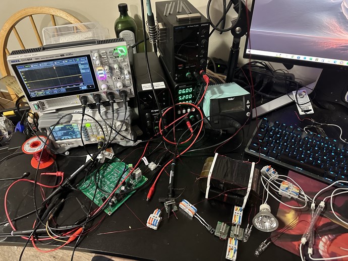

So I was able to find time to test a coil I had initially made with 0.8mm wire for POC coils. Heres the setup
The POCs have ~270 turns of 20AWG wire and the input has 10 turns of 16AWG wire, Heres a picture of what it looks like.

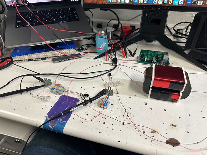

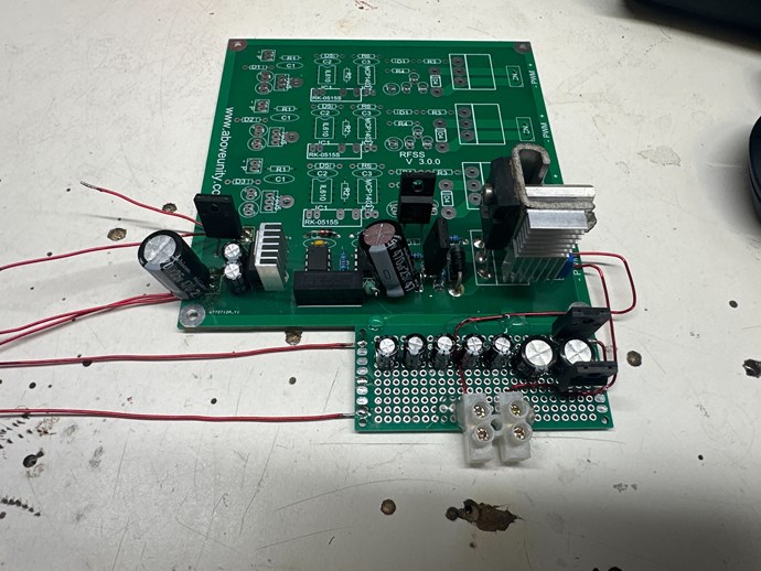

So I did change one thing about my set up that has helped tremendously. I was having a Massive amount of noise in my circuit and it was mostly because of my power supplies. So in order to remove the noise I added a 470uF 25v capacitor on the input of the 9V powering the switching part of the h-bridge circuit from the reliable switching system thread, I might increase that but for now it has definitely helped. I also put 7 - 100uF 50V caps in parallel with the input voltage that goes to my coil along with 2 diodes just like how Chris has in his videos except I don’t have the money to buy a big bus capacitor at the moment. I did however purchase 12 - 2200uF 63V electrolytic caps to replace the 7, all so I can reduce the noise completely from my input voltage to my coil.
Here it is, its janky but it does the job. I don't get the new caps in for another few days or so. Ill also post a pick of that when I get it all soldered in.

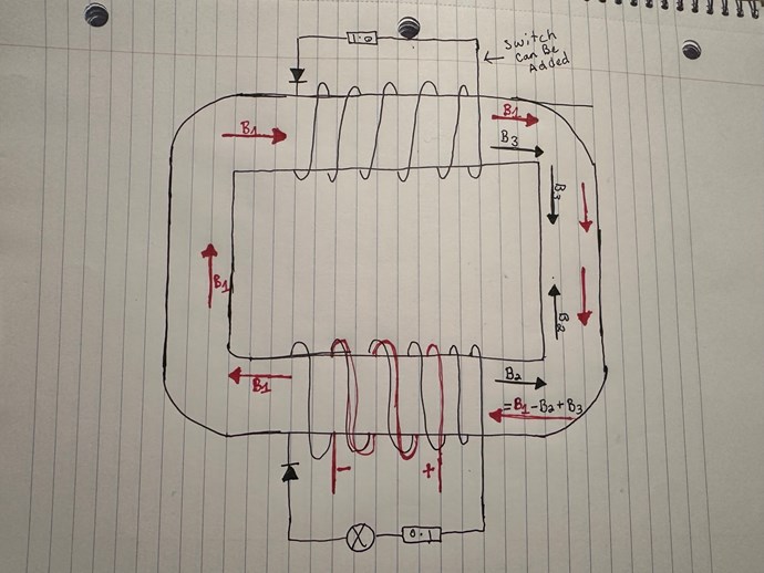

Hey guys,
Sorry I haven't posted in a while, I have been struggling with life and haven't given any time to figuring out why I have been so confused with how to set up the coils. The biggest issue I have been having is visualizing how to wind the coils.

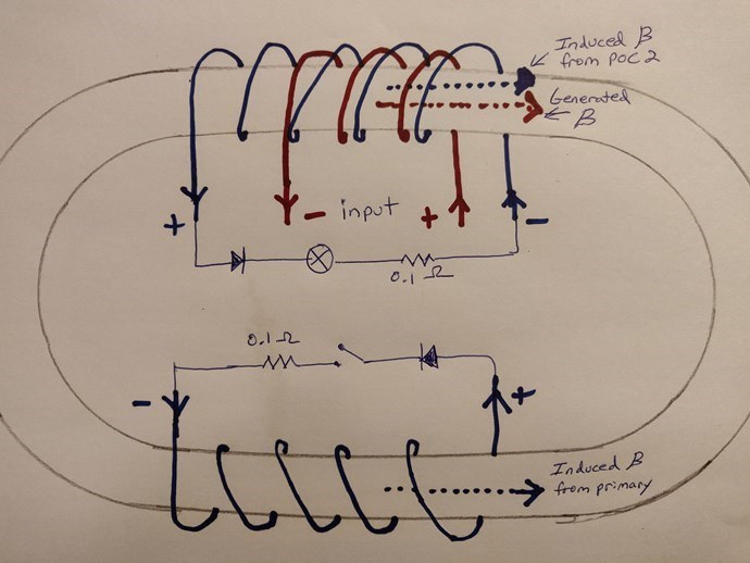

So here is my attempt, please let me know if I am correct in my understanding.
I was reading a bit of the other threads to make sure I have this right but I believe it might be slightly off. So as I have it now this is what I believe is happening. L1 and POC1 are wired in the same direction, and then POC2 is wound counter to POC1 (If POC1 is wound clockwise POC2 is wound counter-clockwise).
When L1 is pulsed on a magnetic field is produced which induces a voltage on L2 that is in the opposite direction of L1 and current starts to flow because of the Load and in turn L3 has a voltage that is induced because of the change in magnetic field on L2.
So here's where I think my image might be wrong.
The current that is produced in L2 is reflected on to L1 and when L3 induces its magnetic field vector into the core it adds additional magnetic field potential to when L1 is pulsed again. Thus L3 "adds" more "current" or EMF to the system. So L1 + L2 + L3 = L3, and with normal transformers L1 + L2 = 0.
The diodes are what help to keep the coils EMF going in the correct direction and the Load is needed for the circuit to work properly.
I have coils wound already and I reduced the cross-sectional area of the coil to get the voltage and magnetic field up. I just want to verify that my understanding of how to wind the coils is correct before I continue. For me this is fundamental to understanding how to proceed.
I am not even worrying about resonance and tuning right now, I just want to get this part down.

FringeIdeas posted this 03 July 2024
Hey, glad to hear you are still poking around, and I hope all is well.
It sounds like you are pretty much spot on. If I'm correct though, I think your diode on POC2 is backwards. Someone correct me if I'm wrong of course. Everything else looks/sounds great. To my understanding anyway.

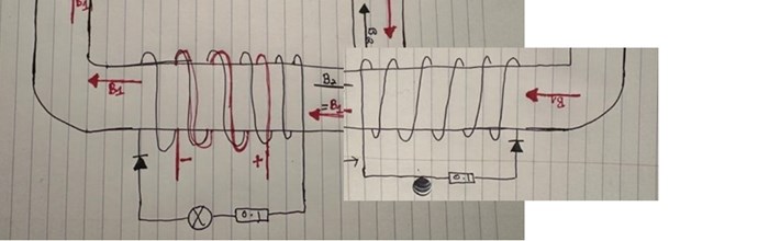

Alex ⋐˙⋮⋮˙⊃ posted this 03 July 2024
hey guys,
I made the same mistake with the diodes and also with the L3 winding direction. You should imagine / picture the L3 setup as a copy of L2, but diagonally opposed, not mirrored like it currently is in your diagram.
Regards, Alex
Hey akoteles!
I believe his winding directions are just fine. If you were to straighten out the core, you would have the traditional POC coil setup that Chris always shares.
And the picture above with POC2 rotated around, as if the core was straightened out.
But again, I believe the diode on POC2 (the right side coil in this picture) is backwards.

Chris posted this 03 July 2024
Yes Marcel is correct! Apply the Right Hand Grip Rule and yes one of the Diodes is incorrect.
POCOne must have a Voltage Generated in it! POCTwo must have a Voltage Generated in it! The Voltage Generated depends entirely on Faradays Law of Electromagnetic Induction! Each POC is the Source for the Other! Just like an Electrical Generator has a Moving Permanent Magnet, usually on the Rotor, which is the Source for the Output, usually on the Stator, in the same way, POC uses the same principles but in a Solid State, a bit like a Transformer, that's why most of these machines seem to originate from some sort of Transformer Theory / Work.
Experiment will give you the correct Polarity, it only works properly one of two ways.
