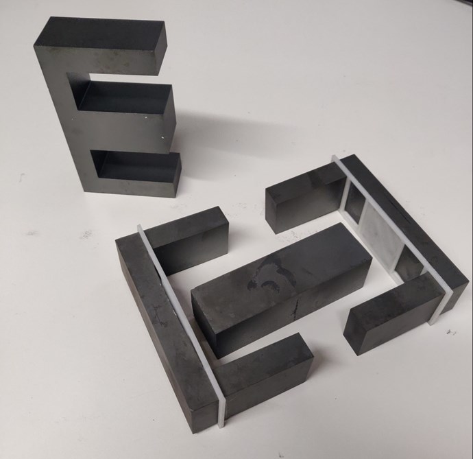

So I will start with Melnichenko's E core setup and investigate that as much as I can, then move on to the air core coil surrounding the cored coil. Should be fun!

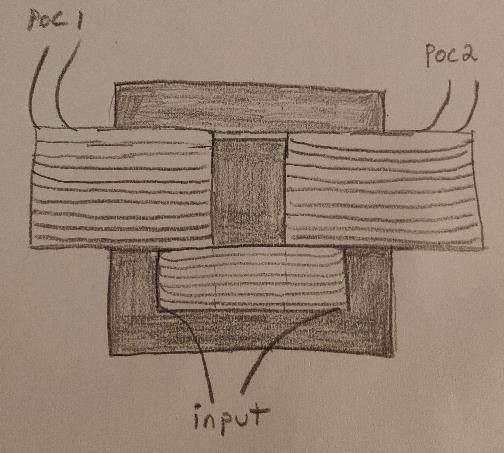

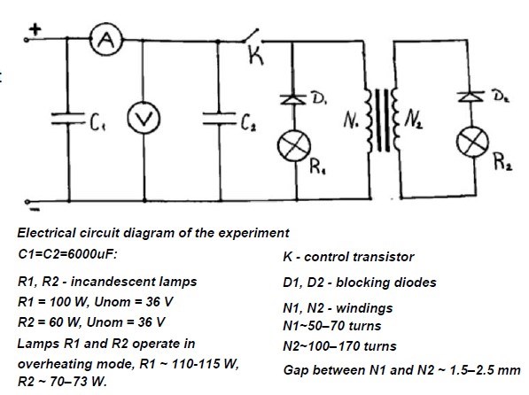

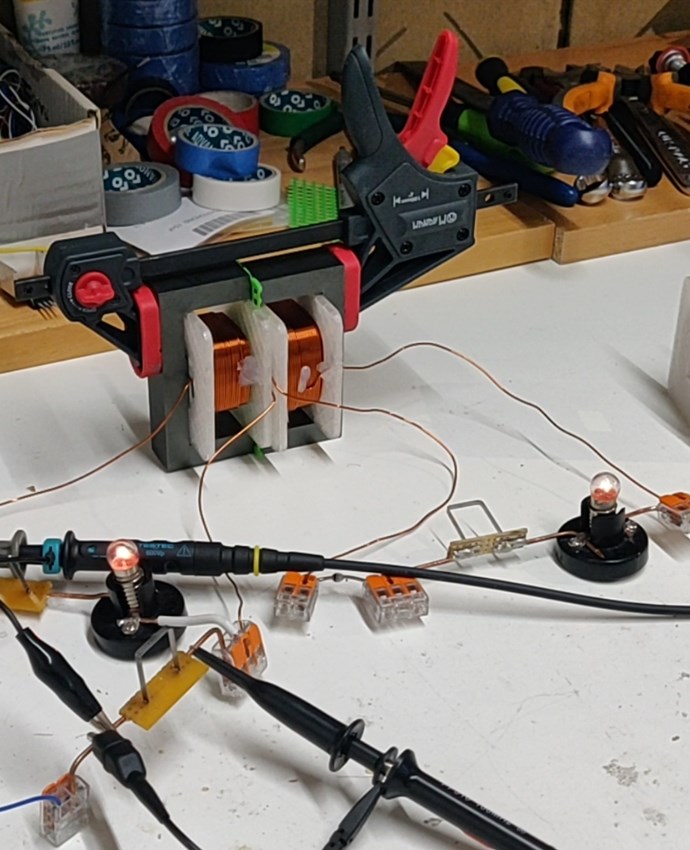

So this first experiment, what I believe to be the first experiment Melnichenko wanted others to replicate, is heavy on the idea of separation of fields. Watch the two videos on hyiq.org linked in the post above. Here is the schematic and parts list that Jagau so kindly put together for others.
  • IRF9610 mosfet, not a power transistor, highside switch.
  • 200 Hz, 7% duty cycle.
  • E cores gapped with plastic, 1.5.mm.
  • Input is 15V.
  • Lamps are normal 12v bulbs.
  • L1 is 65 turns 0.8 mm wire.
  • L2 is 150 turns 0.8 mm wire.

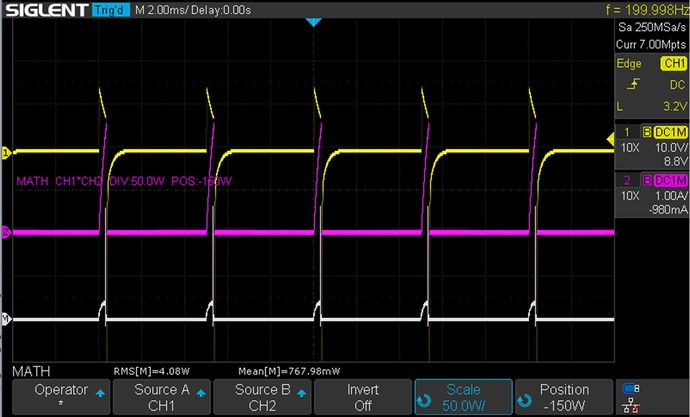

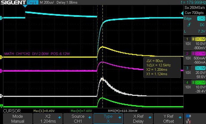

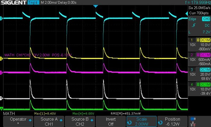

Input, Mean reading on input is around 760 mW. This is energy spent on magnetization of the core only, no bulbs are lit during this time.
Output on L2, RMS shows about 1.4 W. Mosfet is off at this time, this is the de-magnitization phase.
I'm sure there is an error somewhere 😉 but even if the bulbs were only at about 1W each, which I'm sure they were around there somewhere, it would still be a COP of 2.6.

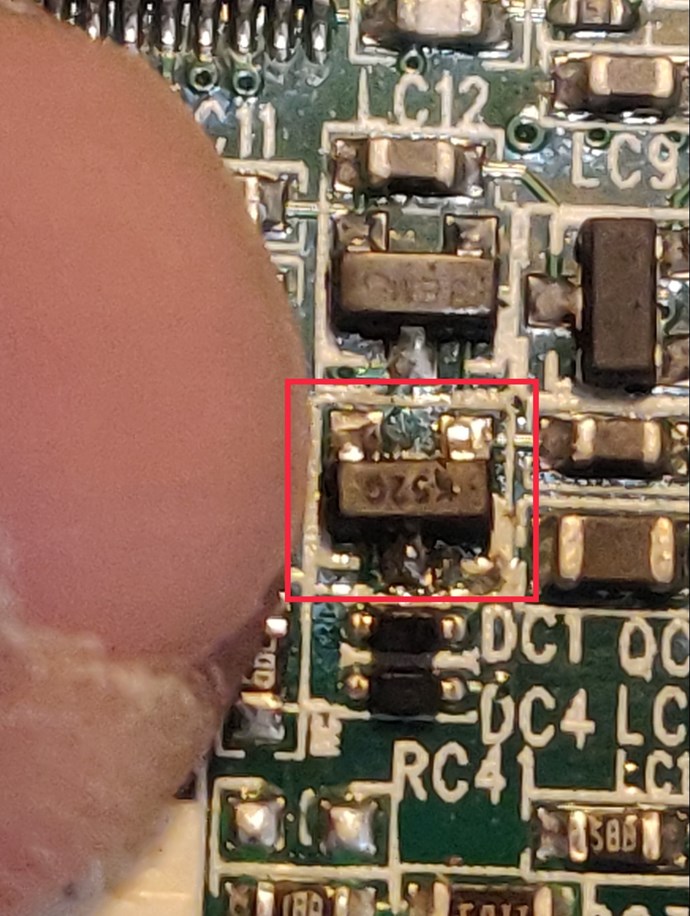

Interesting side story, I had blown one of the channels in my scope. I luckily found some forum with some guy that had the same scope same problem, and he found out it was a jfet on the front end, and he even gave a link for a replacement part. I figured I'd take a shot in the dark, ordered the part, and somehow manage to hand solder something the size of a grain of rice.
That's my fingernail next to the fet! And it worked, got my scope channel back 😎
Anyhoo, interestingly enough with this E core setup, when the gap is closed and the L1 bulb is removed, everything dies off and the COP drops to about 0.95 or so. I guess in the range of a typical flyback transformer.

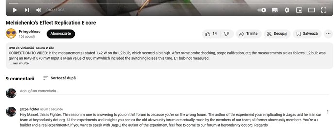

FringeIdeas posted this 07 December 2024
CORRECTION TO MEASUREMENTS:
Hey! I wanted to correct my measurements that were given in the video. I had mentioned, and showed on the scope, that the output on the L2 bulb was 1.42 W. This did seem a bit high to me to be honest. The light output did seem a bit more around 1 W to me. So, I fought for a little bench time and played around with different probes, recalibrated the the scope, etc. And came out with measurements that I'm a bit more comfortable with.
Input: measured this time near the caps by the power supply, to get a more stable reading. Came out to be 880 mW, Mean value. This would include the switching losses this time. So not much of a change here, before I had said 760 mW.
Output L2 bulb, measured this time to be 870 mW RMS, not 1.42 mW. Big difference.
Output L1 bulb, not measured. But it was as bright as, if not a little brighter than, the L2 bulb, so we can assume around 870 mW there as well.
So this still leaves the COP to be around 1.9 for this setup, which seems more reasonable. And having the gap at about 1.5 mm gives the best results.

So no comments at all from anyone? 🤔 I was hoping for a little discussion. After next week I get a whopping 3 weeks of vacation. Most of which will be dedicated to the bench. A bit of discussion or a few comments would help me come up with ideas of what to study or experiment with, so as to not waste good vacation/bench time. 🙂

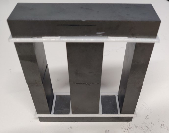

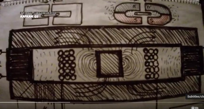

Next Melnichenko setup, three cores!
Not much to really report here. I'm still plugging along with these Melnichenko videos. So many different setups he goes over. Too bad the YouTube auto-translate is so bad. Good enough I guess. Learning the Russian language would probably be the best thing to do 😂
This next setup here comes from this video.
Here is a screenshot of the cores he is showing, and the separation of fields with the gap.

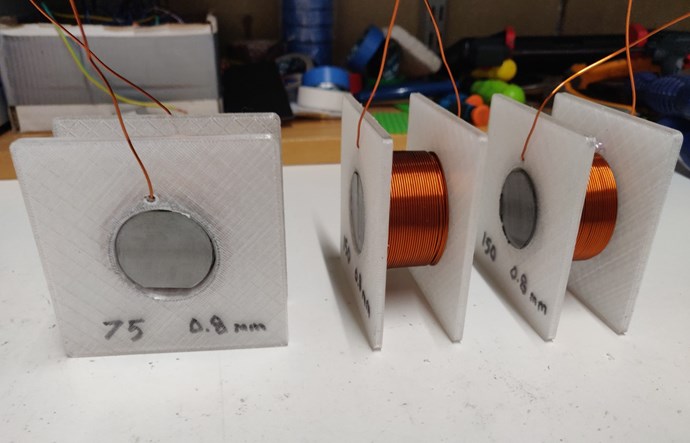

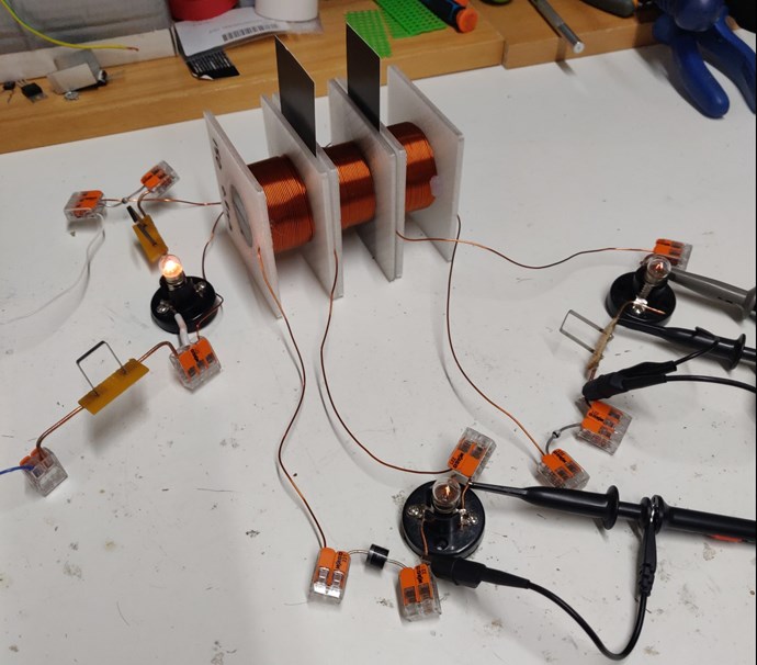

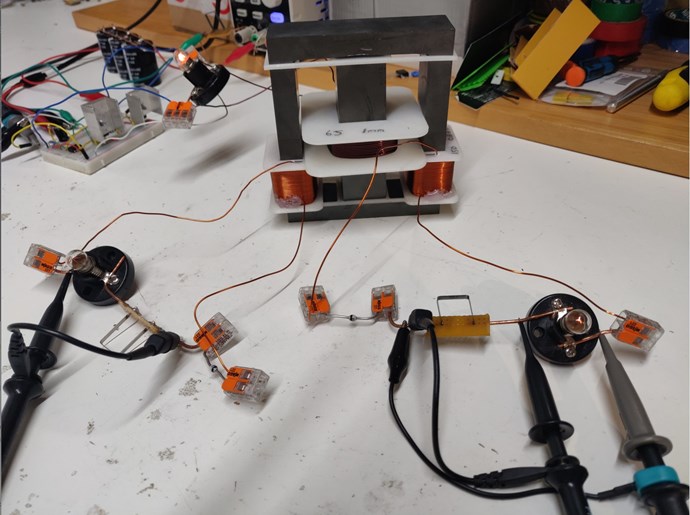

Here are the cores and coils that I threw together. The core is a pressed steel toroid, which was more like a square almost, which i cut sections out of. Note, in the video the cores do wrap around the end coils. Mine do not. I have a few more core pieces that I need to try that will be more like the original experiment shown. But for now this has been suffiecient.
  • IRF9610 mosfet, highside switch.
  • 500 Hz, 9% duty cycle.
  • Cores gapped with cardboard, 0.5 to 1 mm or so.
  • Input is 17V.
  • L1 is 75 turns 0.8 mm wire.
  • L3 is 150 turns 0.8 mm wire.
The results were about the same, not too much exciting.

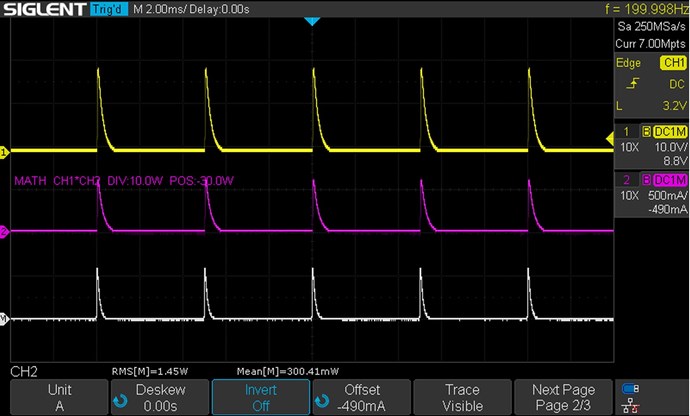

  • Input about 1.41 W mean.
  • L1 bulb roughly 1.05 W rms
  • L2 and L3 bulbs were about 0.54 W rms each.
This was also the same as the E core setup, in that one can remove the L2 and L3 bulbs and the input does not go up.
There does seem to still be some relationship between coils though, also pointed out by Melnichenko. For example, when removing the L2 and L3 bulbs the L1 bulb does get brighter. However, pulling L2 and L3 bulbs is a loss of output, of around 1.08 W. The brightness increase on the L1 bulb is only something like 0.1 or 0.2 W increase. This is also pointed out by Melnichenko in the videos.

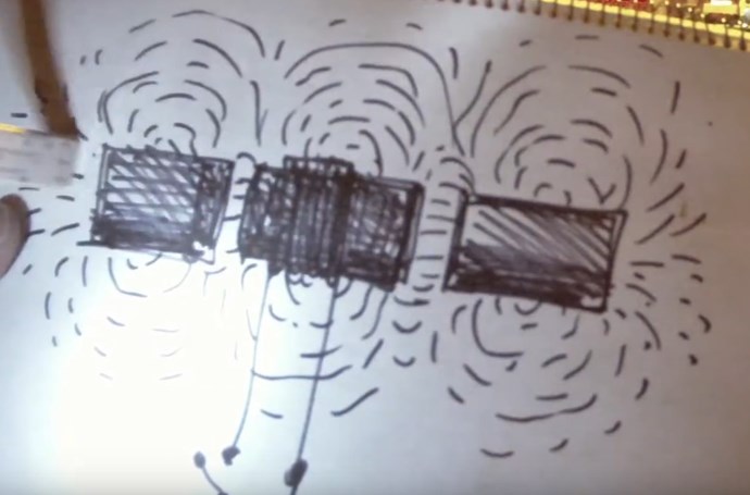

Did you get all three cores to oppose each other like the image shows:
Its the idea as you know and as AM shows.
Cheers My Friend
FringeIdeas posted this 18 December 2024
No recent friendly concerns from complete strangers about me being in the wrong place. The post is still new though, so let's be patient. 😁
In regards to the cores opposing each other, in this specific setup I believe they do not. I have seen a bit of what you might be referring too, going through some of Melnichenko's papers, etc. But in the video list I'm still back in the 8 year old section. A few more dozen to go. And I'm still kind of focused on this field separation at the moment.
So as I understand it, during Ton the outer cores/coils try to oppose but diodes do not allow it. Toff the magnetic fields in the outer cores switch, if I'm not mistaken, and so the whole group of cores during Toff would be N-S, N-S, N-S during de-magnitization. Standard flyback if I'm not confused. I'll add, I have not really tried tying together any of the coils yet. So far each coil has been it's own isolated circuit.
Though looking at some of Melnichenko's more elaborate circuits, where these coils might be connected and/or switched in and out from each other, I can see how they could be made to oppose at certain parts of the cycle. Is this what you are referring to?
We all know, Lenz's Law is Sine Opposite, so every time any Electromagnetic Induction occurs, we have a Sine Negative component from Source to Target.
In the Coils:
The Fields curling back in toward the Cores, where there are small gaps, show an opposition of Magnetic Fields, as you know, for the most part, lines will join and become larger if we have a N S N S N S, the Field will grow and become one large field.
If we have S N N S S N then we get curl ins to the Gaps.

I figured I would work on the topology of the coils for now. In one Melnichenko's more recent videos he was using two T cores, which I was planning on trying. Bu then in a different video this layout caught my interest.
And at the same time I had been re-reading a bit about Paul Raymond Jensen and the UDT. There seemed to be some similarities. Amazing how much Jensen said in so little words.
Anyway, so I went and got a few more E cores, a bit bigger than my last ones. https://eu.mouser.com/ProductDetail/871-B66894GX197
The CSA is obviously not the greatest, but at 27 euros a pop it will have to do for experiments.
I got a little time today while kids were napping, and cut the middle leg out of two of the E cores. Then glued the inner pieces together with ceramic glue. Then printed a few spacers. The middle core has a gap on the top and the bottom, both gaps around 1 mm.
So this week I will try to find time to print some bobbins and get some coils wound. I ordered 1 mm wire, but I might do this in 0.8 mm just to save space. And I think I will do it this way, to get shorter length coils. Rough drawing, my apologies.
I'll post a few more pics once I get it all together and play around with it.

Do you have a scope shot of this latest setup? Did you check closely the turn On time and turn Off time of the mosfet? You can improve there too to get a faster dI/dT and increase voltage. Try to find the natural resonnance frequency of the coils first  and match the rise time with a fraction of this frequency.

Hey! Sorry, I have been ridiculously busy with work. I have however managed to 3d print some bobbins and wind a few coils. Little experimentation time though.
@Chris, sorry, I somehow missed your last post there.
Yes, the small CSA is always on my mind. 14x28 mm on the output coils. Currently I have 150 turns of 0.8 on them, and I'm not seeing much of anything. They do seem to be bucking in this coil configuration, but getting the desired interactions between them really isn't happening. I was trying to decide how to get a bigger CSA without throwing much more money at it. Maybe for now I can up the turns to 250 and see if that helps. Otherwise I'll try to find a place to source a bit of strip metal I can cut for bigger cores, assuming that is cheaper than these ferrite pieces. And of course criticism is never a downer if it leads to learning. Much appreciated.
@AETHERIC_MIND hey, thank you.
I do need to get around to tuning these things when I experiment. That is something I've always kind of neglected. I'll add that to the to-do list with this one, I appreciate the reminder! I have a few scope shots for you coming up.
So.. here is a pic of the setup coils wound and in action.
The output coils are 150 turns 0.8 mm. The input is 65 turns 1 mm. I also have a wider coil for the input, meaning wider inner diameter spaced from the center core about 10 mm, which is also 65 turns of 1 mm wire. The center leg of this is gapped on both the top and the bottom. Roughly 0.5-1 mm each gap. 10 V on the input, pulsed DC only so far. Most experimentation happened roughly around the 200 Hz, 10-20% duty cycle. The power supply says roughly 2 watts. Output coil diodes are set to fire on the de-magnetization.
The purpose for this experiment was really just to play with getting the input coil away from the interactions of the output coils. And to be honest, I'm not seeing the results I was hoping for.
Of course this acts like the other Melnichenko configurations, as I can remove a light bulb from the output, or both, and the input power is not affected. But there are still noticeable interactions with the bulb on the input. Also the voltages on the output are only around 5 V, which is not enough really.
I do notice that when I remove one bulb on the output, the sounds change quite a bit. So it's wanting to buck, but I think it's just not physically optimized to do so.
Ok a few scope shots just for fun.
  • Blue is the input voltage.
  • Yellow is the POC2 voltage.
  • Purple is the POC2 current.
  • White is the MATH function, V*I for POC2, RMS
  • Green is POC1 Voltage.

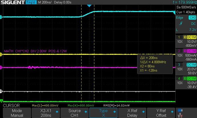

Here is rise time for the input coil, V. The blue trace. 208 nS
Here is the rise time for the output coils, both V and I, all other color traces.
So, yeah, I would have liked to experiment with a few feedback ideas. But first it seems that optimizing these coils is completely necessary. Otherwise, I'd say I kind of like this coil and core layout. Crazy thought I had.. It kind of resembles an inside-out VTA.. use the imagination! 😀
I'll see about getting these output coils up to 250 turns, or more if it will fit on the core area. And then see if I can get any traditional partnered output coil effects out of them. Then and only then, I might start playing with feedback ideas.
