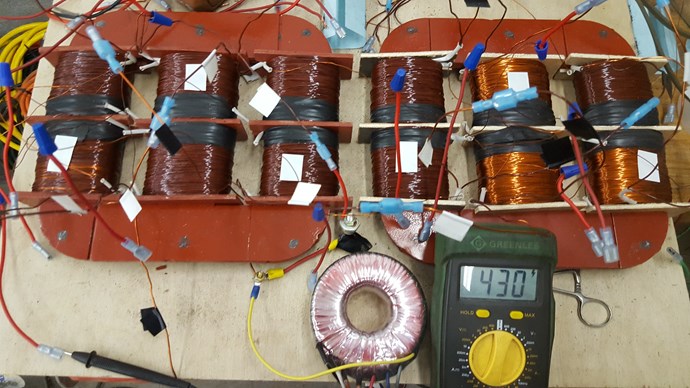

A different way to wind the coils and their arrangment.
The attached photo of the coil layout is powered from a 12 volt battery which powers a 750 watt inverter giving a 120 volt AC output. This powers a Hammond 1182 L 30 toroidal transformer with a center tap and (2) 30 volt AC outputs. These out puts are180 degrees inverted and are changed to DC voltage at about 12 volts and 4 amps using heavy duty diodes . Each of these powers the primary coils that are bifilar wound with 136 turns of 16 guage magnet wire. Over these primaries is wound the paired output coils that are wound with 900 turns of 22 guage magnet wire. These are wound in series in such a way that their outputs add to give 2 out puts of 200 volts that are 180 degrees inverted. I plan to add about 70 more turns to each secondary coil to give 220 volts to each leg.
When the coils are powered up without a load the the readout of the inverter is zero. When a load of (2) 100 watt light bulbs is added to one of the output coil sets, the wattage on the inverter reads 174 watts. I am still getting additional test equipment to get an exact power reading of what happens with the light bulbs. The secondary paired output coils are wound in the fashion of Don L. Smith's device that is a high frequency device. I am planning to wind one set in the pattern of Chris's paired output coils to see if I can get better output with higher amperage.

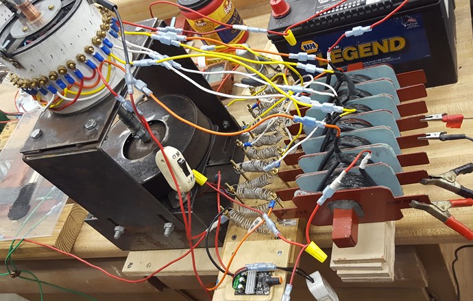

I have gone back to using the part G commutator that I built several years ago so that I can slow down the 60 hertz to a level that I can see what is happening with the changing flux. About 3 to 4 cycles per second gives good results. I use a 1/8 inch plexiglass and iron shavings over the coils in as close contact as possible. You can actually SEE the flux change in the coils as the particles dance on the plexiglass. I am charging the primaries with 24 volts from the commutator so that the pulsing DC voltage ranges from about 20 volts down to about 2 volts. It is very difficult to get an exact measurement because the voltage when the commutator is turning is vastly different than when it is stopped and measurements can be taken at each stage of the resistance. I am anxious to share photos but they are on my phone and the files are too big to load properly. I am trying to get them down in size but have to load them to my computer first.

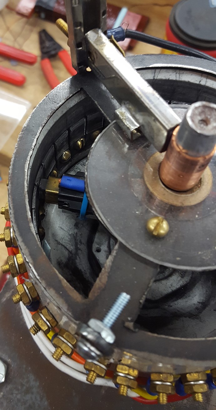

My commutator is made from a 4 inch schedule 40 PVC plastic pipe collar. I used 1 inch wide by 1/8 inch thick aluminium flat bar rolled around a 3 inch plastic pipe. The spring back after the bar is released creates a circle very near 4 inches inside. I cut these into segments that are 1/36th of the INSIDE circumference of the 4 inch collar. These were carefully drilled so that they could be evenly spaced INSIDE the 4 inch pipe collar with 1/64th in clearance between. The 4 inch pipe collar is drilled to match the spacing and location of each of these commutator contact plates. They are held in place with brass pan head bolts that are 3/4 inch long and 5/32nds in diameter. This work needs to be VERY precise so that there is uniformity in the spacing and that the edges of each contact plate is smooth to the ones on either side of it. If they are not smooth, the carbon brushes that are used will either hang up or bounce as they move from plate to plate.

The brush assembly is mounted on a 1/2 steel shaft using steel collars with set screws. I used a segment of a welders soapstone holder and drilled a 1/2in hole in the center. I soldered this to the collar so it could be adjusted up or down on the shaft as necessary.

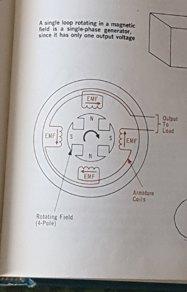

Greywolf47 posted this 16 December 2020
This is a page from the book I mentioned earlier that shows the direction of winding on
N and S  coils and how they are arranged in series to get maximum output.

Here is a photo of my commutator.
Greywolf47 posted this 17 December 2020
The current from a 12 volt battery comes in at the carbon brush in contact with the copper sleeve. This takes the current down to the brush holder. There are two carbon brushes running 180 degrees opposed. Where the small blue connecter is in the photo you can see the brass holder and the black carbon brush in contact with the aluminium contact plates on the inside circumference of the 4 inch plastic pipe collar that is the body of the commutator.
The ring of brass screws and nuts hold the aluminium contact plates in place as well as connecting the wiring that connects to the resister bank to vary the current to the coils.
The brushes I am using are made for use in a vaccuum cleaner motor and have a plastic housing with a brass sleeve that holds the carbon brush. It is very important that the aluminium contact plates be spaced without touching and so that their edges are even so the carbon brushes move smoothly from plate to plate without resistance or bouncing.
here is an overview of the complete commutatorcommutator
In the photo above you can see the different colors of paired wires that go from the outside circumferance of the pipe collar housing of the commutator down to the resistor coil set. Red wires carry full current, orange wires carry 80% current, yellow wires carry 60%, and white 40%. The current to the opposite pole of the primary coil is increasing so that the second white is carrying 40%, as the other decreases to 20%, etc. I started by using the heater coil out of a home furnace but found that it caused too much energy loss as heat that was not recoverable. I built a 7 coil inductor setup that would change the energy flow like the heater coil, but without the heat loss because as the coils are de energized, their energy is not lost.
I put the old heater coil in the picture as reference so you can see how it was built but I no longer use it. The induction coil setup is much better.
Behind the cream colored on/off switch is the fan housing of a cooling fan connected to the DC motor mounted beneath that turns the fan and commutator. In the foreground is a variable speed controller so I can slow down the cycles per second so that I can study what is happening with the magnetic flux.
Just below the speed control is a white on/off switch that turns the motor on and off. The cream colored switch controls the current from the battery to the commutator. It is VERY IMPORTANT that the motor is turned on before the current to the commutator so as to not damage the carbon brushes and contacts. The damage will be arcing, and depending on the position of the carbon brushes, may even melt the aluminium contact such that it would be necessary to replace them due to damage.
Rather than having a solid top on the commutator, I have elected to have a metal plate that is slotted with cutouts. This makes it self cooling as well as allowing me to see what is going on with the contacts and how much sparking is going on. Sparking is bad and indicates that something is probably not wired correctly.
