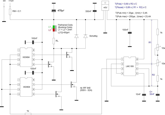

The partnered output coils could do the job alone. We have two inductances on one core. Each coil hast the same induction as the other: L1 = L2. So we put both on the same core, electrically in series, magnetical bucking. We get the over all Inductance of this series circuit L(12). My coil has L1=2mH = L2. L(12) is 0.08mH. Now I use the coil L(12) and load it with a current. The coil L(12) is loaded with energy E = 1/2 L(12) * I^2. When we shoot off the current, we get back this energy. In my experiment I took this back- EMF out with a Schottky diode and powered loads as resistors, light bulbs and lead- batteries. This back- EMF produces very high currents oscillating, in the partnered coils with frequences of about 25 MHz. Forward oscillating goes into the load, backwards it goes to the voltage- source via the internal Mosfet- diode. The results were delighting: Cop of about 90%.
Now I will build a new pulser, which is always powering the load. In my above description I only used the Back- EMF. Now I will additionally power the load during switching on the current.  When I switch on the current, I get a voltage against my supplying voltage, which is very much higher then the supply voltage. It comes as a sharp peak at the beginning. After that peaks (oszillating) , the current rises as expected in a 0.08mH coil. The benefit of this configuration is, that the partnered output coils produce the flowing current and voltage in the same direction, at the same time and very strong, but very short...Now I have to make the impedances fitting, with this all done OU could be possible.
I hope this experiences and thougts could give some ideas for simple OU- configuations with partnered output coils, powering themselves through L(12) charging. Thank you Chris for sharing of your experiments. It is essential to understand the basics, before success, your videos are very helpful here. My problem is, when I use a L3 for triggering the output coils, it is easy to get a strong changing magnetic field in the core, but the voltages in the output coils are always in opposite directions against each other. All tries to make it "asymmetrical" are a little bit difficult, because of the principle: A changing field induces opposed voltages in opposed coils. I am very intersted in opinions on this.

Andreas posted this 14 April 2022
This will produce sharp pulses in the load. The IRF 840  500V is only experimental. The on resistance should be 0.85 / 4 Ohm. Maybe it is possible to us one IRF 3205 for example, with an on resistance of about 20mOhm,  55V only. I suggest to prefer low impedance, maybe a conventional transformer as the load, powering RL, if wanted or / and neccessary. Impedance matching seems to be very important, With low on resistances, very high cops, nearly 1 should be possible. Even without any "bucking effect" of L(12) in series. The goal is, to bring the coils L1 and L2 to produce flowing current in the same direction. Because in the switching moment the volage comes in series, in the same direction, supporting the current. A very strong current in "Bucking Mode" can flow throu the Coils and will hopefully produce a stong current amplifying effect.
A simple pulser for coils
