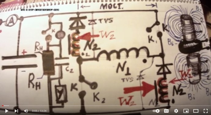

And the third claim, very important. but more complex to reproduce:
3. A method /../ supplied with alternating current of any form, /../ the use of an active capacitive type of load /../

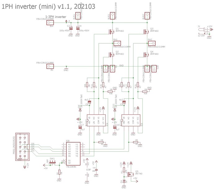

What I can tell is how to make a 1PH inverter, which I use for many project - you need to input the frequency from the 2 ch frequency generator or dedicated SG3525 chip.
3. A method of generating electricity in which, in a system with separation of magnetic fields, the inductance coil is supplied with alternating current of any form, and the alternating current in the removable winding as the secondary current of the transformer does not have a nearly demagnetizing component due to the use of an active capacitive type of load with a weak biasing or demagnetizing effect, which is achieved by sequentially adding a special capacitor with a higher capacitance than the active resistor of the load, but at the same time, due to the separation of the magnetic fields, the magnetic coupling of the reverse transformer and the active power of the inductor are lower than the energy and power received from the cores.
As you can see Melnichenko in his video does not show all the circuits used but in his patents he describes them very well.

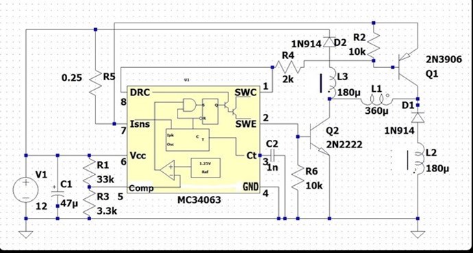

Here is the circuit in development that I was telling you about. Interesting phenomena develop there when you take the time to realize and study it.
here the original circuit
and here the proposed similar circuit to study with simple switch
as it is more miniaturized it will therefore be easier to study the effcet with simple ferrite or what you have on hands.
The most important in this configuration for those who are observers, yes there are 3 coils but
only two are in a ferromagnetic material the third (L1) is not.
And yes Chris you will notice that there is similarities with the effect of Akula I believe.

Jagau posted this 12 December 2022
Hi E2matriz
First of all welcome to this discussion forum.
Regarding your first question, where to attach an LED or load.
This circuit has been miniaturized with the simplest switches available so that anyone can build it.
The main purpose of this circuit above is be able to study the Melnichenko effect without burning your fingers and to recharge the rechargeable battery which is at the start of the circuit. On the schematic it is represented by source V1 , for the moment there is no load only a self runner circuit.
I have used these little switches which can be implemented as your study of the circuit allows.
I hope this answers your questions and good experiences with us.
