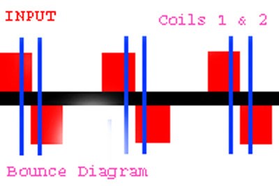

  1. use short input dc pulses too the primary, so-as not too burn power. and
  2. 2 reflect the resultant flux between the secondaries in various physical geometries.     ...  globes and scope too monitor power output. = so far one thing remains constant. - using more of the flux, on one side, - means less light on the other side.

patrick1 posted this 03 May 2019
so the magnetic flux wants too collapse and reverse. but is not allowed too..
but in the case of puled dc. ( positive offset only ) . - does the negative spike play any part ?. or just let it do its thing ?
Patrick,

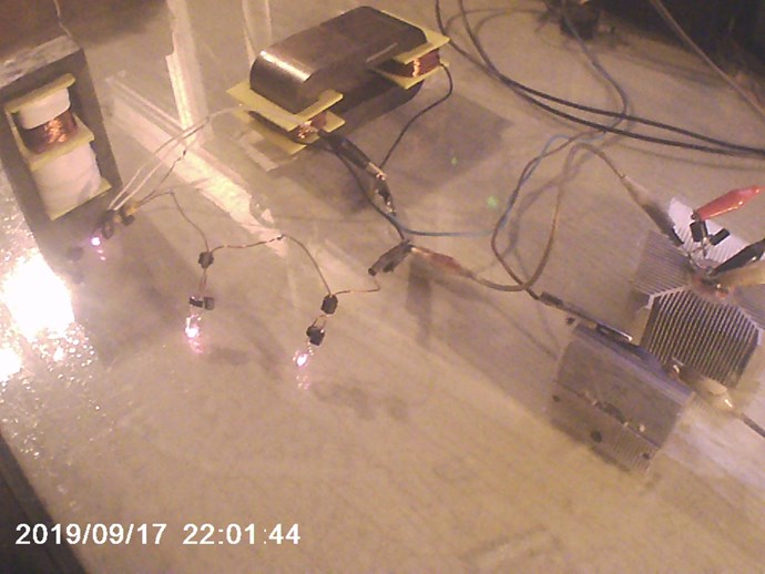

wow ive had much inspiration tonight, cant wait too do some more building, but its already 3am... arrrgg.     i am thinking in terms of positive offset only, square wave input,   (atm)
and the first output coil. conducts immediately before the second.  - however because they are wound apposing, the rebound from the first, acts too assist the second.
although it sounds simple, its something i have yet too try.  - but i dont know if there is any greater gains from a particular frequency.  ... yet,  - i have done a napkin circuit, - i think i can trigger all 3 pulses off a sine wave, - AKA trigger each of the 3 pulses from the varying amplitude of a sine wave.

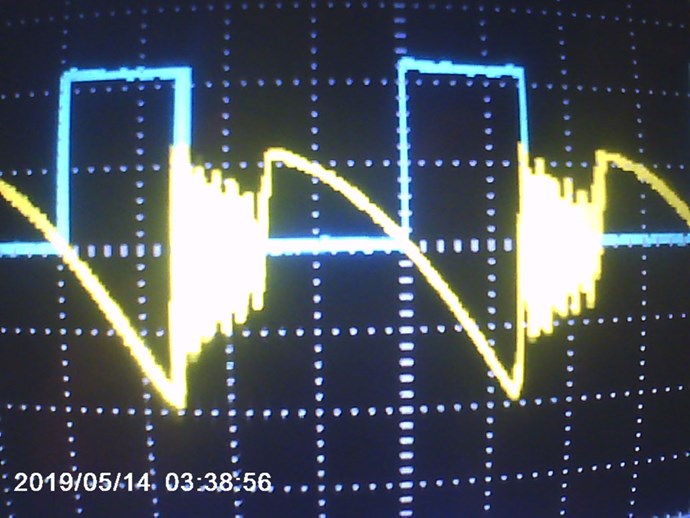

patrick1 posted this 05 May 2019
interesting results, - i have the frequency @ about 10hz,
what i see, on the scope, is 2 positive offset square waves, that are each, 15 % duty cycle., - and they are touching eachother, - so basically a single 30% duty block with a color divide. ....     they are the output coil.s   , - and i have a third wave, positioned exactly between and overlapping the first two, - this is the input coil.  ..    and when the input coil, is smack in the middle ,  the transformer makes almost a cracking sound @ 10hz, but does not generate much light on either output globe,  - however as a rotate a pot, and move the input coil backwards and forwards on the scope,  from  within the 1'st output coils trigger period, too the middle, and finally too fully within the second output coils trigger period,  the sound alternates too a normal 10hz transformer.   and produces plenty of light on each globe alternatively ,
but in the middle, where i was hoping the action would be,  - is a very distinctive noise, and about 2v per globe,, so bad that it seems like the output coils are out of phase, - so i switched one of the terminals, electrically, and its twice as good as terrible, -   -
btw the outputs are counter wound of course, - and fack me,  i have never managed too blow a big transistor like this on 10watts, - let alone, a darlington pair, and the opto isolator via a 1k resistor    - w - t - f...   and the input coil isnt scary at all - its about 250turns at a few ohms.
i have improved it by inserting a 4;th transtor, irf840 into the darlington, -   ive upped the voltage, and still playing,    -  kind of scared of what the future holds,  - chris;s idea about playing with arduino seems very good indeed, especially at the thought of cascading more ICS  too give me negative offset pulses also, - already using 4 opamps, and 3   555's in my circuit.

patrick1 posted this 13 May 2019
Yes i agree,  i have ovoided large transformers for all of your reasons, - especially  because they are time consumers, and because the high power drive requirements are more troublesome....   however after putting afew days into tuning my circuit for ferrite torroids.  - too remove inefficiencys of poory constructed iron transformers... - it was harder than i expected. - but now that its finished. the waves look u-beut. - 2 of them anyway....
yellow is primary. , blue is trigger period of the 1st secondary. which is currently charging capacitors..  - sitll working on it,

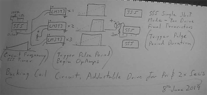

patrick1 posted this 11 June 2019
this is my circuit for iron, - apparently its too complicated, but i think its perfect,  thx chris.  we willl see my friend ;-D
ok finally i have some idea wtf is going on,  usful experiment,  - giggles thankyou chris, - i am removing my "learnid" posts.
finally somthing works woop woop

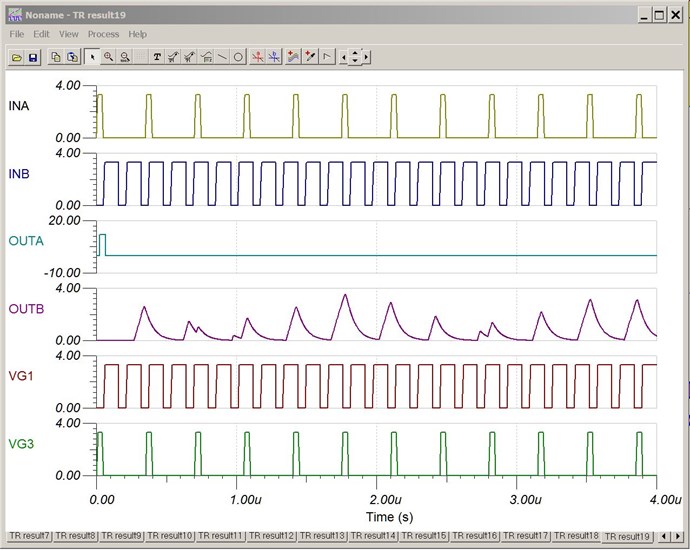

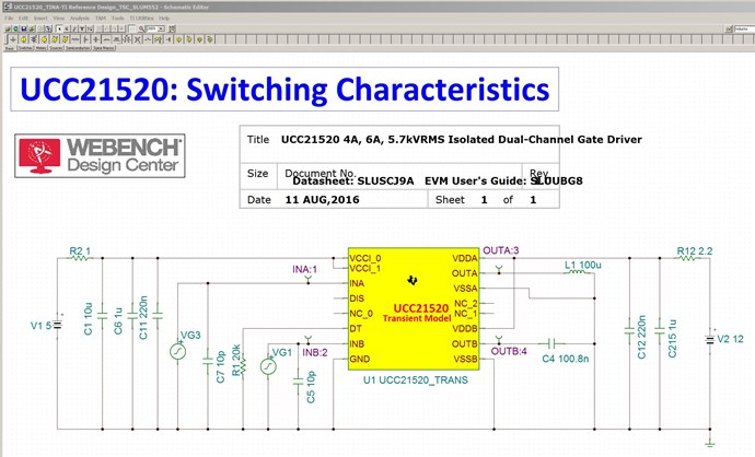

solarlab posted this 10 September 2019
Hi Patrick,
Just an FYI re: transistors. Maybe review this combination (I will not recommend anything here - but we're evaluating these at the moment):
UCC21530EVM-286 [Mouser # 595-UCC21530EVM-286] - Texas Instruments FET SiC MOSFET driver evaluation board (20MHz) {driver part # UCC21530} about $50.00US;
LSIC1MO120E0080 [Mouser # 576-LSIC1MO120E0080 - Littlefuse SiC MOSFET {1200V, tr ~ 10nS tf ~ 6nS, CMOS level 3.3V drive} about $16.00US;
LSIC1MO170E1000 [Mouser # 576-LSIC1MO170E1000 - Littlefuse SiC MOSFET {1700V, tr ~ 15nS tf ~ 50nS, CMOS level 3.3V drive} about $6.50US.
Reasonable prices condisering the performance. TI's eval board is also a good deal all things considered.
Recall - dv/dt (rise/fall) can be key parameters when searching for "excess energy," no such thing, IMHO, as "too fast!"  laughing
SL

Thought this might be of interest:
Attached a blurb about using a free simulators with an evaluation board to better understand circuit behaviour.
Example Schematic (SiC MOSFET Driver Evaluation Board ONLY):
Schematic
NOTE the two different loads - L1 {100uH} on OUTA and C4 {100.8nF} on OUTB...
Example Results (Eval Brd only [6A max] driving L and C loads):
Simulation results
SL

Thanks again guys,  checkout the metglas, - it sure looks the part,
currently my transistors are not up too the job however, - im using an IRF840, more suited too dc motor control
i thought i would run a frequency sweep anyway and see what happens. -  even though they are not good for much over 50khz.  - as tested with a resistive load anyway. - but with the metglas. - the sweep run all the way up too 650khz. at which point the IRF 840, for reasons that are not clear. - went closes circuit, and my C Cores slammed together. - no damage, but i got lucky this timecores
also note the ferrite in the background,  660ohms and 230ohms coils.  - process of elimination for sure.
Fighter posted this 17 September 2019
Hi Patrick,
Try to get some IRFP250N MOSFETs if possible, they worked well in harsh conditions and high frequencies on my side.
If you can't find these IRFP250N anymore (like it happened in my case) then find any MOSFET from IRFP250x series, I replaced the old ones with IRFP250:
Also if your Metglas cores slammed together at some point that means the magnetic fields of the coils are not opposing, they are actually attracting.
You should check if both coils are producing North magnetic polarity on their upper sides and South magnetic polarity on their lower sides like this:
Before connecting the two coils in series I wanted to make sure the magnetic fields produced by the two coils are opposing so I powered each coil separately and checked the polarity of its magnetic field (link to larger image here) :
Then I connected the coils in series and checked again that their magnetic fields are opposing (link to larger image here):
Also, the two coils have 1:2 turns ratio ? I may be wrong but from the photo the coils seem kind of having the same number of turns ?...
You Metglas core is looking good
patrick1 posted this 17 September 2019
lols, thanks but my cores seem too ignore your sence of humor ?. - they want too attact irrespective of the wire direction ;=)
umm ?.   am i missing something ?.  - btw.
https://www.aliexpress.com/item/32820322815.html?spm=a2g0s.9042311.0.0.40ba4c4d25WqU3
i skimped on my cores, - and you should know, i have always had a good run with cheap transistors from ebay and ali express. without any observable problems  ( i heard stories of FAKE RF transisitors,years ago, - but ive never personally had any problems, --   so i ordered some of these 250N's a last week, il let you know how they go ;=)
No, I'm not kidding, you should check the wire connecting the two coils, in order to have opposing magnetic fields it should connect the wire end from the outside of one coil with the wire end from the inside of the other coil, like this (link to larger image here):
I don't know the winding directions of the two coils there but you should try to change how that wire is connecting the two coils while checking with a compass or something similar (like I shown in the previous post) to make sure at the top of the Metglas you have two North poles opposing each other and at the bottom of the Metglas two South poles opposing each other.
'Cause from what you described right now the two magnetic fields seems to be attracting not opposing.
That MOSFET seems okay.
