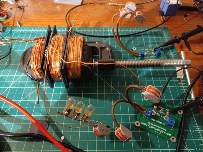

This is my current setup, my primary is 45 turns of #15, both POCs are 180 turns of #18 and are 284mH and 281mH for POC1 and 2 respectively.
My coil and output circuit: setup
Plasmonic's coils and output circuit

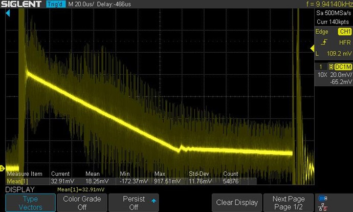

POC1 is loaded by 3 flashlight bulbs in parallel making 1.7ohms when cold.  In the following trace the bulbs are not illuminated so I assume it should still be near that 1.7ohm value.
POC2 is a short circuit thru the diode and .1 ohm current sense resistor.

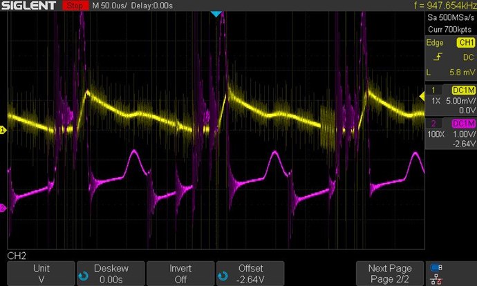

Operating frequency is 4,240hz @ 46% duty cycle.
Power input is 4.6V and 170mA
I made a small mistake with the POC 1 yellow trace, the scope is set to 1x by mistake but my probe was 10x.  The purple trace is a 100x probe and without the ground connected.  I do not trust its numbers, I was just using it to see the waveforms together the best I knew how.
Scope trace of my current progress:
Yellow POC1 Purple POC2
Yellow is POC 1
Purple is POC 2
I'm not sure how to interpret my POC2 (purple) trace but one thing I think is on the down slope of POC1 there looks to be a positive feedback that is coming from the POC2 waveform and the inverted ramp seems to be changing the rate of decrease in current of POC1.

Hey Matt,
Thanks for sharing!

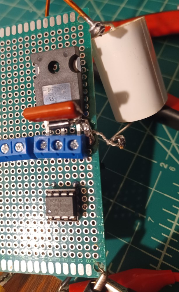

Can you please post an image of your Input/Drive Circuitry?
There is a fair bit of visible noise in there, so maybe we can look to that first, try to improve that, and the rest will look better.
It is best to have your Input on top of POCOne also, you get a much better coupling, you can wind your Input over both POCOne and also POCTwo if you wish! That way you get a better Isolation. Also twisting your wires together can give you a dead short if the insulation gives...
Also, 945KHz is way too high, go way back down to around 3KHz and a 10% Duty Cycle. Its much easier to work at low frequency, later we can increase if you need to.
Your waveform, other than the noise, is pretty good, you're on the way!

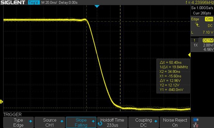

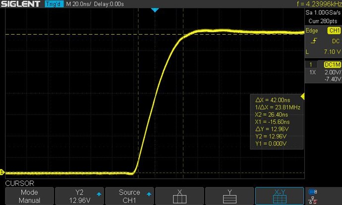

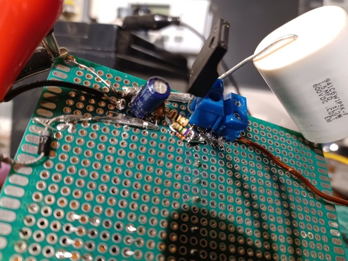

While reading what you said I realized I may have an idea of where most of the noise is from and it's probably my PSU, it hisses at low amps but it's the best one I got atm, I'll for sure look into it and see what I can do though.  The driver looks like crap but it keeps quite a nice waveform when driving the coil.
Rising edge
Falling edge
plasmonic driver top
plasmonic driver bottom
My driving frequency is only 4.2KHz my scope is reading some part of the wave (noise) on the frequency counter.  The noise is bad for sure, I should point out the scope mimics a phosphor screen scope so some of those spikes are from previous cycles.  So inside my switching waveform you can kinda see it fluctuates a little if you look closely at the falling edge trace.
I will go back and look at a little lower frequency now that I have both probes on it, I did see something similar to what I have now but it had a very long flat between the 2 sections of down slopes and I have not seen it before so it just confused me at that time.
I can't fit any more turns over the coils they just about take up all the space between the core legs.  The coils are glued so if I break up the bobbins I think I can manage to get one of the coils to slide around the bend of the core so I can fill the space from that direction with the coil 90 degrees from where it is.  Do you think the distance between POC1 and 2 that would come from that change would negate the benefit?  Otherwise I have to rewind the coils in some way.

Mosfet Hard Switching has been covered on this forum many times, and removing those capacitors is a good idea!

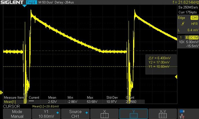

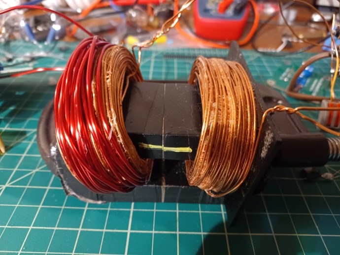

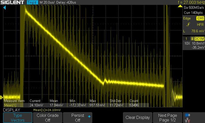

I managed to get a new primary around the secondary and was able to get it somewhat back into position so I could vary the primary to secondary distance.  It seems to run best with some distance between them rather than closer to one another.  It's a small difference but it is noticeable.  The new test primary is 13 turns of #14 over POC 1
I also removed the capacitor across the drain-source pins of the mosfet.  It seems to be handling it okay but it's not quite as resilient as it was yet so I'm still looking into it so I can increase the power input.
I also need to find a new load that works for POC1 since I can push it till the bulbs burn out, I lost one of the 3 in the last test.  A 12V automotive lamp, (GE 1156) doesn't seem to work as well, I get the waveform but I cant push it into incandescence and it seems to weigh down the circuit too much to get any appreciable voltage drop across the sense resistor.
Plasmonic, new primary test
2500KHz @ 8% duty cycle
Plasmonic, POC1 scope with low impedance primary.  The cursor lines can be ignored, I just forgot to turn them off.
POC2 looks nearly the same but lower amplitude, still just the current sense resistor and diode in it's circuit.
For some reason the flat at the bottom of the ramp never quite reaches the zero line even at a much lower frequency and a lower duty cycle to keep the pulse short.  I'm still digesting what's going on here as it's got me a little puzzled. So I'm going to go back and do some more reading in the builders guide while I try to figure things out.

Chris posted this 17 October 2023
Hey Matt,
Looking good mate! Well done!
Peak Voltage, the Amplitude at which your Coils get to, is a function of how much Power Output can be obtained. In other words, Increasing the Amplitude, increases the Output Power.
Turn your Input up some, and study intently, you're on the right track! Nice straight lines there! Don't change anything, keep it all the same! Study and understand what you have.
Can you explain where the Voltage on POCTwo comes from?
See what I mean, here in lays the principle of the machine, its very simple, and once understood, its easier to Scale up.
Good Job Mate!!! Well done!

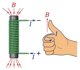

Double Check, using the Right Hand Grip Rule and Conventional Current, that all Coils have the correct Polarity, from here, it looks like you do, but worth checking anyway.
Polarity should be:
  • POCOne Opposes your Input Coil.
  • POCTwo Opposes POCOne.
  • POCTwo Assists your Input Coil.

I have been trying anything I can think of to get the current reduction effect when connecting POC2 and I cannot seem to get it with my current setup.  I have seen it before under certain conditions but I dont think I had the linear decay in current from the POC coils whenever I witnessed it.
My primary is wound over POC1, both coils are wound in the same direction with respect to the core, making the POC1 output 180 degrees out of phase so the diode is connected as thus to allow current during power input.
I have tried POC2 in both orientations, wound the same as Primary and POC1 as well as flipped and flipping the diode to match the phase change, it's oriented to only allow current that is not from the primary induction during the input phase.  As you can see I do get waveforms of linear decay but my POC2 tends to increase the current rather than decrease the current.
I'm going to keep trying, maybe revert back to my old primary until I get the effect again.
