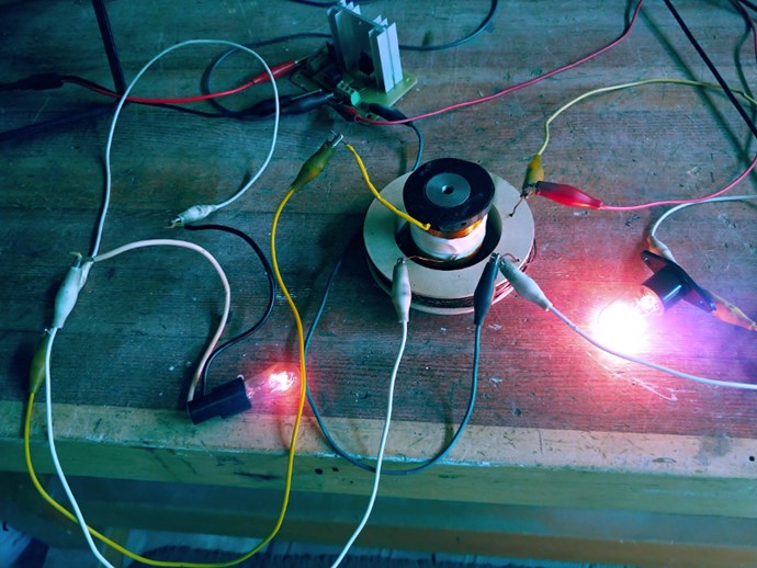

I am waiting to see replications before going further and continuing to explain.
Will this qualify?
This is with a 12 volt battery, the bulbs are 25 watt 125 volt mot bulbs, secondary on left.
Ron

Hello Ronee,
Well done, nice replication, however, your Secondary Voltage is a bit low from what I can see.
If you could post scope shots of your Input Power, no need for Output Power, we may be able to help further.
Perhaps Jagau can comment further on your replication when he gets time?
P.S: A Solid Steel Core will have a lot higher Eddy Current Losses, a Laminated Core may give you a better result with a better efficiency.

Hi Ronee
Welcome to the site I believe this is the first experience I see of you.
It's very good, like Chris said well done, your lamps are well lit,
As you know it's all a question of power at the input compared to the output.
When you have time, take your time, show me your voltage and current measurements, like i did on thread above.
As you can see there is nothing complicated and sorcery in this very simple circuit to do. Yet Andrey Melnichenko explains it extensively in all these videos and not many pay attention. Do you believe that he is right to give everything like that. This is what we will check here. The crowd is not huge but many watch without speaking, as usual.
Thank you for sharing.

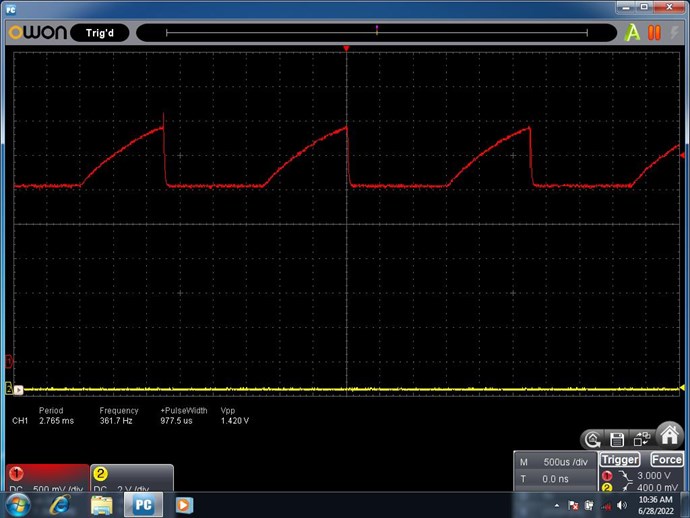

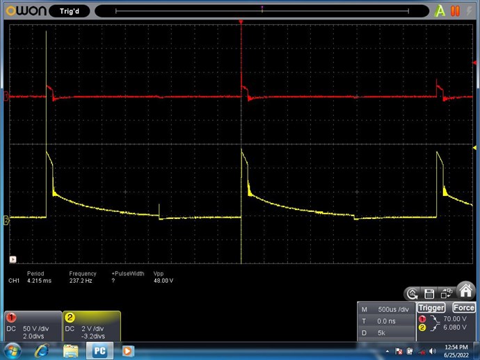

In my material testing I took a piece of steel tubing and a block of laminations, wrapped 10 turns around each and the result looked like this... first the steel tube (anywhere near the primary coil would crash the poor Qwon so the red trace is just a wire near the primary, the yellow trace's flat step is the trigger pulse, 50%)
and the laminations

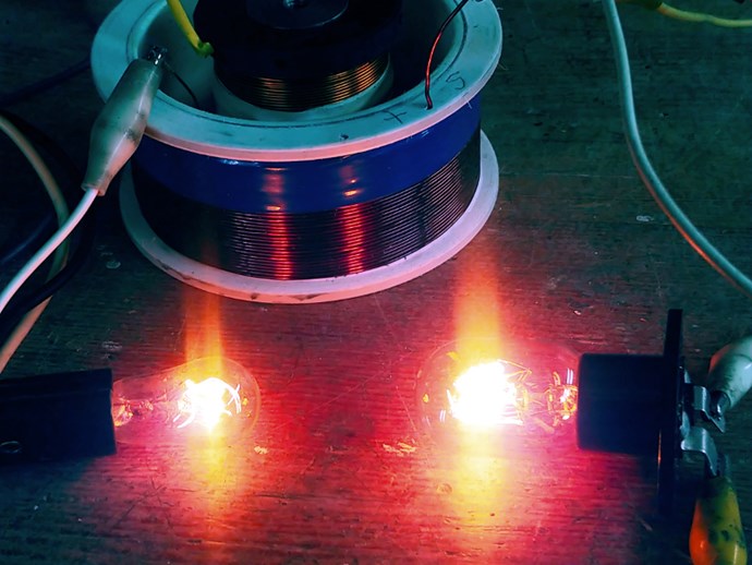

Here is the new primary coil with the old junk box secondary for a "change one thing at a time" approach.
The voltage input is 12.2 volts and the amps on a DMM are 1.24 amps.

Hey Ronee,
Very Nice! You have very high Build Quality! Thanks for Sharing!
I was expecting to see a Reverse Current on the Input. I am not seeing any there at the moment.
In the thread: The Input Coil we see that Current gets sent back to the DC Input, so the total Input is bought right down by a factor of magnitude, or more, to reduce the Input Power.
