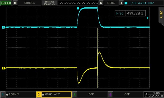

So, we start with pre-experiment "0.1 - what does electromagnetic induction look like?"
Purpose: to see on-scope the input and output waves, and to see what I can learn from that.
I put together the basic outline of the Tinman experiment as follows:
  • 12V PSU feeding a..
  • 12v PWM set to 500Hz, duty cycle 10% i think (I adjusted this to the minimum), feeding a..
  • 12V20W light bulb to reduce circuit power (my power resistors haven't arrived yet), feeding one of... (My input scope connections were set across this.)
  • the 3 air coils of an equal 3 metres of wire each, zero resistance per my meters,  arranged basically as per Tinman.
  • My secondary coil was connected to another 12V20W bulb as load. (My output scope connections were set across this)
My test used the input coil and only one of the output coils.

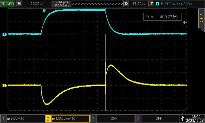

The scope showed me the following situation, blue IN, yellow OUT.
scope 1
I concluded that, for the first time, I was seeing electromagnetic induction taking place!!  What am I seeing? I think I see a smaller induced voltage in the second coil in opposition (reaction)  to the input voltage seen in the feed coil, when the voltage in the feed coil is rising. When the voltage decreases in the feed coil, I again see a smaller induced voltage in the second coil in opposition to the feed coil. In both cases, I see the time the second coil takes to 'fade' the voltage is greater than that seen in the feed coil. I decided to zoom in..
scope 2

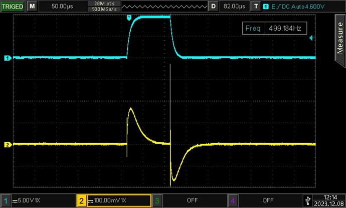

From this I concluded that there is much more of a 'spike' when the transistor turns OFF the power than when it turns it on.
The final aspect of my pre-experiment involved turning round the feed coil:
scope 4
Now  I see that the induced voltage is in the same direction as the feed coil.

  • Increasing the distance between the 2 air coils reduces the induced voltage in the secondary, changes nothing in the feed coil.
  • The induced voltages are very much smaller than the feed voltages. Probably caused by a lack of turns?
  • Inserting a metal bar through the air coils slows things down, takes more time to dissipate in the secondary. Also changes the shape of the curves.
  • an LED connected across the feed coil lights up in both directions, against my expectations. I cannot understand this.
  • An LED connected across the second coil does not light up, I assume insufficient voltage to drive it?

Chris posted this 08 December 2023
Hello and welcome Marcus!
Let me ask, Adam under a different name? Looks like the same work and the same approach?
Anyway, you're in good hands here, we will look after you! You have chosen to make the most advanced forum energy research site in the world, your home, so you chose well!
We will look after you!
I wanted to ask, what is the Circuit you have for the above experiment? You are quite right, it is the Change in Magnetic Flux that creates a Voltage in the Secondary, which is what you see, and the change can be Negative or Positive, the polarity of the Primary determines the polarity of the Secondary. Lenz's Law, always Opposite, thus the Negative Sign. Sign sensitive, and thus the Diodes attached to our Circuits will require this same polarity to be able to conduct in the specified direction.
Please Note: I think this line of research is Important and Valuable! You're doing good work! If you're Not Adam, then Adam is also doing good work! In my opinion, we have only had a small difference of Opinion here, which results in fundamental difference in Approach, that's why this is important! I like Adam, he is doing Valuable Work! As are you!
The Flux's do NOT Add here, because the Flux in the Primary is gone by the time there is a Voltage. So many people try to push this idea! The Sign, still Opposes as I have shown!

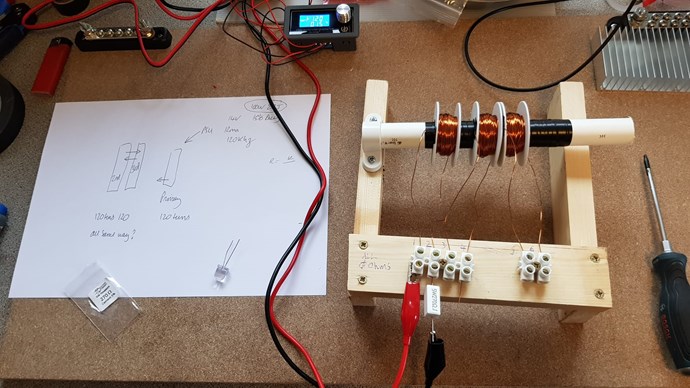

I decided to have another go at my Tinman replication this morning, by starting completely afresh. I rewound my 3 coils (all clockwise) with 0.5mm wire with the suggested 120 turns each, set the 14VDC (later reduced to 12V) pulsing to 120khz and 15% duty. The setup appears as below.
tm rep1
At first I applied the input power directly, without the resistor you see in the photo. Under this circumstance I am very pleased to report that connecting a LED between (1) and (2) only works with the LED in one polarity! However, with the resistor in place, the same LED will light up whichever polarity you connect it between (1) and (2). I also tried using a 12V21W bulb in place of the resistor, and in this case the LED also lights up in both polarities! I am beginning to think that the resistor or bulb, each being a coil of sorts, is doing something...
However, never was I able to get an LED to light up between (3)+(4) or (5)+(6), in either polarity, so the experiment was an outright failure!
I am getting something very basic very wrong I think. Please could somebody maybe tell me what that is?
Cheers, M.

Don't use the resistor, The input pulse must be very fast!
Probably about  5% duty cycle.
You must keep hunting for the correct frequency and duty.
Start with small duty and higher volts then sweep through the frequency.
Don't make big jumps in frequency you may jump past the correct one!
Adam.

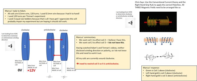

Use the Conventional Current theory and the Right Hand Grip Rule to apply the correct Polarities. All THREE Magnetic Fields need to be arranged like so:

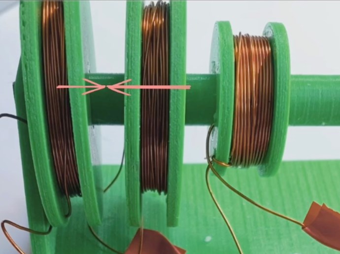

Do your coils look like this?
With the Same shapes or sizes?
Tinman stated in his video the primary was half as tall and twice as wide.
Are you using the same size wire 21 AWG or 0.7229mm I used ?
Are you using 250 turns on each?
That is what I used, I also did it with 125 Turns same size wire 21 awg.

Thank you both very much for your comments and advice. I am making a real meal of this, sorry! I am the type of person that either understands something fully, or I do not understand it at all.  I have had another morning of fiddling about, unsuccessfully, and I believe my understanding is at the lowest possible level now!!
Currently, since the LEDs connected to coils 2 and 3 react only to coil 1, my conclusion is that I need to re-wind coil 3 in the other direction, and set up my experiment from scratch again, per the picture below.
Am I likely to be right? I promise you I am not deliberately wasting your time here, I will keep going until I get the result I want.
Cheers, M.

My coils are all wound in the same direction on this device. Your LEDs my not use enough amps.
Remember amps are what make the magnetic field in the coils!
So if you put more LEDs in parallel on each coil the coils will make a bigger magnetic field that will go farther to hit the other coil.

What you say resonates (pardon the pun)... I was thinking to myself that my setup may be working but I cannot see it working!
I did rewind one coil, made no difference, but pleased to hear all yours are wound in the same direction. That is one mystery finished.
Specifically, I want to be able to change the polarity of the LED on the middle coil (#3), and have it light up in both directions as per Tinman, preventing or permitting the coil 2 LED to light (it does do the latter). Of course, it will not be able to do this if there is insufficient drive force back from what I have labelled as coil 2 onto coil 3. I think my small coil diameter is likely to be a contributor to this too as you have already noted, but my search continues for some bigger bobbins (having none to hand obviously). I could make some if I had a lathe (should come off wishlist next year), may yet have to have a go with my milling machine instead if I get desperate.
I am going to try your current increasing strategies with multi-LEDs too, makes good sense.
I will get there in the end, but it should not be this painful (for you guys, less so me!).
My last observation is that my allen key 'core' is now quite significantly magnetic lol...
Thank you for your ongoing help!
Cheers, M.

Hey Marcus,
Realistically, in a perfect world, it is best to wind the Primary on top of POCOne, as I have shown, then your Coupling will be sufficient to overcome any distance issues, this I have shown:
Your Image:
It is very nicely presented! Well done! You should employ a third Red Arrow, one going in the same direction as the Input Coil, from POCTwo back to POCOne. This would correct this diagram.
Your query:
No, the Polarity of the Diodes is the key here, the Coils do Work on each other, and you need to get them to work in the correct polarity.
If the Polarity is wrong, then you get the same issue you are reporting.
Winding direction does help, but its not critical to make this work! It will work no matter how the windings are wound, but the beat configuration is as I have shown.

Use your Thumb to give you a Direction, this direction indicates the North Pole of the Coil as a Current starts to flow.
POCOne Opposes your Input Coil, POCTwo opposes POCOne but Assists your Input Coil.
For a Current to flow, one must break Conduction Voltage, normally around 0.5 of a Volt. This Voltage must be "Generated" in the Coil and related Circuit, as we have three different Circuits, we need to think in terms of Action, Reaction and Counter-Reaction.
