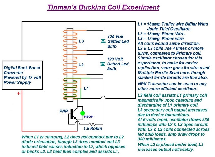

Hi all, been working on one of tinman's devices and have very similar results.
Here is a circuit drawing.
Comments welcome

OriginalSkywatcher posted this 03 January 2024
Hi Chris, thanks for the reply. Yes, i am the same skywatcher123 from the now closed down overunity.com.
I haven't been focussing on experiments much in the recent past, though i do like the way this tinman setup is easy to visualize its functioning in the mind.
No opposite wound coils, which may lessen confusion and trigger more light bulbs in onlookers minds.
Never meant to cause a proprietary debate over who discovered or stumbled upon 'ancient' technologies.
I am fiddling with this setup and it is showing interesting characteristics for sure.
At some point, i will try and boost the output by repeaters or more efficient design using same layout principles.
Experiments shall continue.

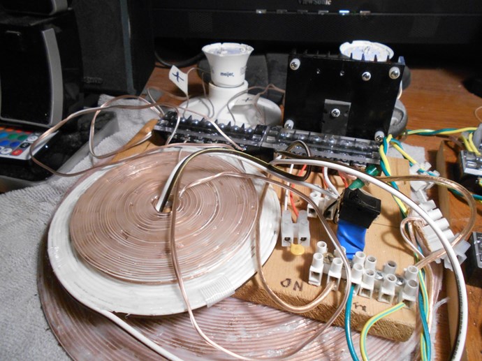

Hi fringeideas, i felt that, which is probably why i was scrambling to find another camera and i did.
The trailer wire 16awg. white and 18awg. black wire pancake coil is the oscillator, the bottom black wire is the feedback wire, white is primary.
The speaker wire POC coil, i think is 24awg., might be 22awg. been awhile since i bought it.
The bottom coil of speaker wire is L2, top coil is L3.
The very large 18awg. speaker wire pancake coil underneath, is not in use, it's from another project.

https://i.postimg.cc/rmJThkmk/pancake-coil-tinman-bucking-coil-setup.jpg

Hope you don't mind, I added your image to your post.
