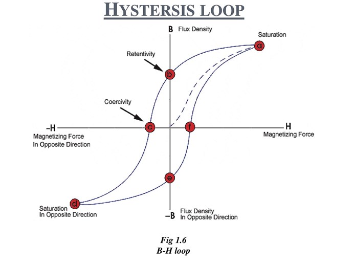

Guys, if I may,
I see you are using the Knee of the BH Curve to reach this objective. This means, if I am right in assuming, that the Coils add in their Magnetic Field Polarity. Do I understand this right?
So one Magnetic Field is a DC Bias of sorts, the other Magnetic Field is pushing up past the knee and falling back down again?
I see why Vidura made the comment some time back, questioning the Polarity of the Magnetic Fields. It is very possible we see another method of Energy Gains here that is not directly using Bucking Magnetic Fields, but instead, this Non-Linear Inductance from Material Effects instead.
I am still thinking, there must be an opposition in there still, perhaps from Core to Coil instead of Coil to Coil Magnetic Field Opposition? I am a little confused, I need to think on this more!
Thanks for sharing guys, I very much enjoy learning new things! I did some similar work here. My waveform's are similar.

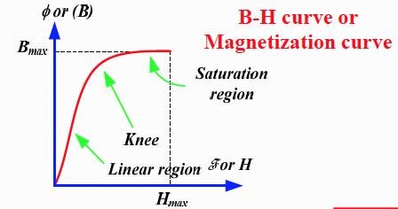

Vidura posted this 28 February 2020
Jagau, If you look at the second graph you can see that the relative permeability in the linear region increase from mu init to mu max. This region is used in conventional EE. Then from mu max. to mu sat. There's the negative slope. When the external field continue increasing, the permeability falls. Now at or near saturation we switch off the external field and the flux in the core start decreasing, while the permeability is now increasing, just the opposite way as in the linear region. Then we let it decrease, but only until reaching mu max. Then we energize the input again, starting the next cycle. Due to the cuadratic hysteresis we have to apply only a small amount of input power to bring the core again into the saturation region, less than the energy which can be extracted during the work cycle. I hope this helps for clarifying. Vidura.
Maybe I should add that we are using DC pulses, so the left half of the hysteresis loop will not apply, we will not change the sign of the magnetic field, so Hc will not be reached. the core remaining magnetised in the positive half cycle only.

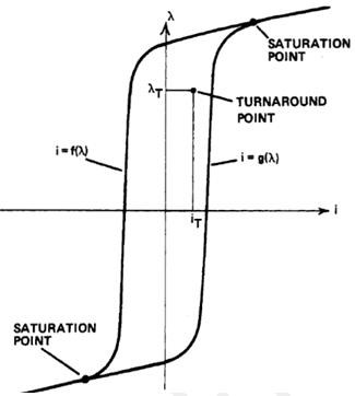

@YoElMiCrO - Is this your theory? Do we understand this correctly?
The BH Curve, or the Hysteresis Curve is typically an Alternating Current Concept, the Magnetic Field pushes through a full cycle. We know the Magnetic Field is Current I through N Turns, which is M.M.F. There are Losses just in the BH Curve without loading the Transformer.
Of course, if the BH Curve is Non-Linear. B is Flux in Gauss, and H is Strength, so this Graph is Density vs Strength:
The Knee of the BH Curve, marked as b and e, is where we see the most Non-Linearity, but what is Non Linear? The Inductance of the Coil is lost at saturation, so this point is where the Coil is moving into Non Inductive and Inductive again. This is a material Effect, the Core itself is moving in and out of saturation at the knee, which is marked as b and e.
Some time ago, I published a document: What's it going to take to get OU? in that paper I gave some examples of this Inductance change and what it would mean achieving the Energy Gain. I looked at this from the point of Energy Stored in an inductor:  0.5 LI2
Looking back, I got my math wrong, squaring the Inductance, not the Current. However, a simple review:
  • L = 2.
  • I = 3.
We get: 0.5 x 2 x 32 = 9.
  • L = 7.
  • I = 3.
We get: 0.5 x 7 x 32 = 31.5.
The truth of the matter is, I does not stay constant, as L changes, I is forced to change also. So my math is not valid and does not take into account these changes. Of course, the definition of Inductance defines how Current travels through an Inductor. So more work is required in this area.
To make the Inductance change, then the Knee is where one should work:
One Coil getting you up to the "Turnaround Point", where a normal transformer is at maximum Magnetising force, and the other Coil pushing up over the knee and back again. Of Course this down hill is where one may see an energy gain.

Looking at this image will be clearer.
The relationship between Br/Bs also dictates the negative slope of a
given material The closer to the unit the greater the slope
and therefore greater amplification thereof.
Regarding the experiment you did, I can say the following.
If you look after turning off the Sw, the drain voltage of the mosfet rises sharply,
but the time that remains is extremely small.
That indicates that now the series inductance is very low and is discharged through
of that new time constant SQR(LC)=t, during this new semi cycle
the mosfet's parasitic diode enters conduction returning energy to the capacitor
of the source and the time that remains negative increases because now you will have to
leave the first quadrant to the third and saturate the nucleus in that quadrant.
And so while there is energy left in the capacitor.
Explain why so low current.
Good demonstration of nonlinearity in inductance.
Thank you.
YoElMiCrO.
