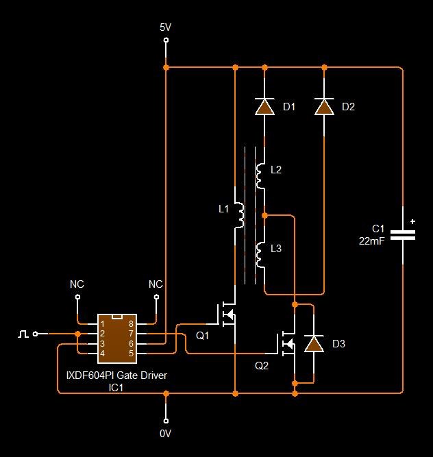

Note: This circuit appears to suffer from a problem where power is fed into the input pin leading to false conclusions about its performance.
I had some trouble getting YoElMiCrO's circuit to work for me as described. Initially I had thought I got it working, but it turns out I had made a mistake in my circuitry and ended up discovering a whole new oddity which may or may not get described in a future post.
So why didn't YoElMiCrO's circuit work for me when it works for Chris and possibly others? I have no idea, maybe my core is too picky or my windings too shabby, or whatever. However, I was not discouraged. I devised some changes which I think make it easier to work with. I've named it the Easy BCFT (Bucking Coils in a Forward Topology). For me these changes took a 99% efficient magnetic resonance setup (which is easy to get) and kicked up a notch.
The circuit has two enhancements, first it uses an efficient IXDF604PI gate driver (or you can just use two separate efficient gate drivers one inverting and one non-inverting) or any other method that achieves the same outcome. The second enhancement is that the single mosfet has been replaced with two IGBTs that do not have anti-parallel diodes. This did fix some of the issues I was having and I was able to get a little bit power out of it (signs of life), but reverting back to the 1 to 3 ratio with more turns did work better than the original ratio at lower turns for me.
Easy BCFT - 02/05/19:
Duty cycle will likely be very low with on-times around 2-7uS and a wide range of frequencies that will result in successful operation. No special core gapping was needed.
Powered only by the signal generator charging the tiny capacitors in the gate driver to 5V 65k times per second the circuit self-charges a 22mF capacitor to 8.1V (YMMV) and powers a small load of 3 series ultrabright LEDs. Sorry no specifics, yes its AU (Edited to clarify this was a false conclusion), no further numbers will be forthcoming, this is eternal lantern level stuff for those who are looking for kW. If you are successful in replicating feel free to share your opinion or results if you wish. Proven enhancements always welcome here, or better yet, create a thread to show off your improvements. Enjoy.

The tuning for this circuit is fairly easy, use a voltmeter on the capacitor to monitor the rise and fall of power on the capacitor. The capacitor should maintain a charge at some level if working and if it falls quickly then its not producing enough power and needs adjustment. If you have the ability to adjust the pulse width using time rather than % you may have quicker success. A decent "on time" will probably be proportional to the number of turns in the primary. The greater the turns the greater the on time. For mine this was 3uS at 12 turns and 7.5uS at 36 turns. Once a decent on time is found a wide range of frequencies should work at that on time.
One observation that may just be coincidental, is that I found that at the natural resonant frequency, the on time was roughly 50%. If you know how to quickly spot the natural resonance on an oscilloscope you may be able to quickly tune your device that way. Not sure if that was just my core or if that is something useful, more observations are needed.

Hey Zanzal, I'm happy about your success! And certainly I like the simplicity of your circuit, the employed principles are clear and easy to understand.and also credits should be given to Yoelmicro for sharing the basic idea.Great work!

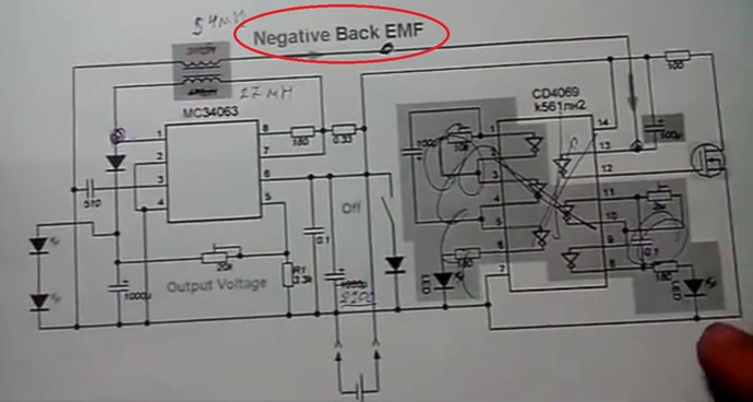

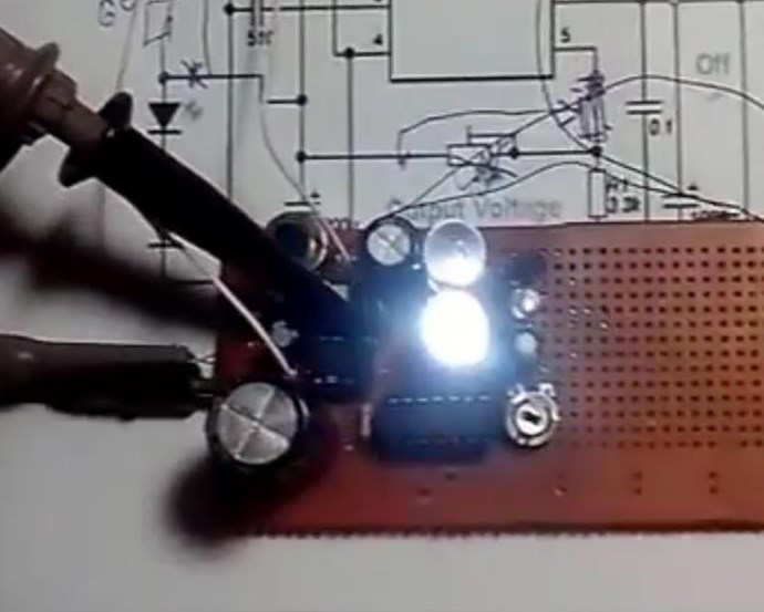

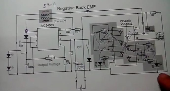

YoElMiCrO posted this 05 February 2019
Perfect zanzal.
I'm glad it works.
If the time of Ton is linked to the number of turns.
The relation is Ton = NpBmAe / Vp.
The load should be in constant tension, as the fordward voltage of a led, which is kept constant for a certain variation of current.
It is important to note that it is only possible to extract energy during the fordward cycle, also remember that Q = CV = it.
I already have the 3W Led in my hands, but it's late, tomorrow I'll try to test the circuit I designed with the controller.

I think there may be a problem with this circuit. The signal generator appears to be feeding power in through the input pin. This was not expected, and is disappointing. Feels like another huge fail on my part.
Just thought I should give you all a heads up. Looks like I am going to have to eliminate the signal generator from all future tests. Confirmation bias strikes again. I'll keep working on it....

Yes, this is a consideration! Leakage is mostly extremely small, in the nanoamps and normally indicated on the datasheet somewhere:
This is a matter I also experienced some years back replicating a Cap Coil setup that seemed to be running by itself at the resonance frequency, not powering any load.
I must urge, don't be discouraged, this small problem is not enough to light 3 LED's and run the System all at the same time. So a small issue like this most definitely is not where all Above Unity Machines get their excess power from, obviously!

considering the issue with the signal generator in my opinion there is no leakage to be considered regarding the IGBTs (or MOSFETs) as the driver is powered by the circuit rail in your schematic. If there is  leakage it could be only thru the driver IC, and only if the voltage of the SG output is exceeding the railvoltage. you could try to lower the output voltage of the SG or use the TTL output.
I hope this helps some.
Zanzal posted this 06 February 2019
Vidura/Chris, I agree, the circuit is still promising and leakage current through the gate is an insignificant consideration for what we do. Which is why I did not question the results.
I verified my concerns using a tester that there is a diode in the gate driver between in and Vcc. Voltage drop was 773mV. Also, part of what I noticed last night that made me realize there was an issue was that I noticed my input voltage was set to 10V on my signal generator, I had recalled setting it to 5V, but I must have changed it at some point. Setting it back to 5V caused a dramatic loss of power.
Inspite of this mistake the circuit itself has potential because the switching and the efficiency of the gate driver is good. I just have to make sure that future tests use self-contained switching. As long as the signal voltage never exceeds Vcc then a signal generator can be used, but I don't like repeating the same mistakes over and over again, so my next priority is an ultra low power square wave generator.

Your choice of current driver IXDF604PI is good. As you already know you can put in parallel as many as you wish same type drivers. On that way you will boost current source/sink capabilities over the single driver and also drastically drastically lower input time constant of MOSFET/IGBT transistor or simply, shorten gate/source(emitter) parasitic capacitor charge/discharge cycle.
I like your IGBT option because he has not parasitic intrinsic body diode between drain/source(emitter).
Also any good newest generation Silicon Carbide Power Mosfets could be used here, simply adding pair of antiparallel very fast recovery high voltage high current diodes to transistor's output to cut-off intrinsic diode.
ps: Maybe is time to put some isolation transformer between your function generator and test circuit. You can make one easy with small toroid ferrite ring and pair of primary/secondary winding in 1:1 ratio. Diametr of wire 0.3-0.5 mm.Number of windings 30-50 each coil. Also is useful to make small air-gap 0.5mm or smaller in the ferrite ring to avoid core saturation. Wind two coils in the same time (in parallel) and mark start and end of windings. This type of isolation transformer is preferable for HV test setups.

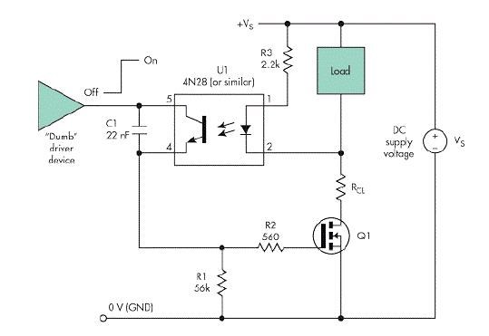

Jagau posted this 07 February 2019
Hello Zanzal
Yes I believe like you that your circuit has a lot of potential and for that,
if you want I can suggest you a very simple circuit which works even with a very low output TTl
and which protects us from the short circuit which could damage the DUT
This circuit I use it with almost all the experiments that I do, it uses an optocoupler and a mosfet.
Resistor R2 provides current limiting to prevent Q1’s gate-source capacitance
damaging the driver’s output at turn-on.
It may also be necessary to prevent the MOSFET from oscillating.
A value of a few hundred ohms is usually suitable.
This little circuit I avoided many bad surprises as you have recently lived

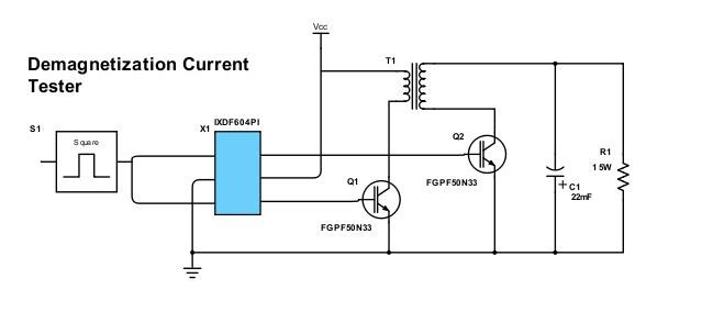

Zanzal posted this 12 February 2019
More to come on this, making tons of great progress. I think I am beginning to see where the problem with this circuit is. I don't have a redesign yet, but I definately can see where a bit of ignorance on my part has led to a fatal flaw. Perhaps it would have worked better with a different IGBT, but not with the ones I am using.
Here is the demagnetization test circuit that I'm having good success with.
Lots of great results, easy to use. It does rely on the fact that the IGBT doesn't seem to want to conduct in reverse (the ones I am using). I don't have a lot of experience with IGBTs but those with a body diode definately will not work for this circuit.
This circuit is easy to get good data from. Using a 1ohm resistor the capacitor charge level will tell you how much output power is in the demagnetization current. For an idea of what kind of power one might expect from a demagnetization current, I was able to get it up to 1.1A continuous over the 1ohm resistor (1.2W out for 2.6W in). Now while that might seem like bad efficiency, It is actually quite good, and it is very promising.
Initial tests had an efficiency of < 10%, and I was able to bring it up significantly, and I see signs that this can go much much higher. Interestingly I found that tapping the flyback on Q1 is still possible though I do not offer a practical circuit at this time to demonstrate this as I think the real value will be in realizing the original goal of asymmetric reguaging in a configuration that doesn't impede current flow (which is the flaw in the original circuit).

I think a DC to DC Converter is what you have in this Circuit, and by the description it sounds the same. The MC34063 is a DC to DC Converter IC, used in the above circuit layouts I shared.
While this is a part of the End Goal, it is not enough to get you Above Unity Efficiency.

With some fiddling, close observations, your first circuit will give you better results. Timing and Turns is all you need adjust.
If one expands the demagnetization test circuit to accommodate a third winding the workings of such a change will be evident in the results. To fully appreciate the results one should consider first studying a two winding version first.
Zanzal posted this 15 February 2019

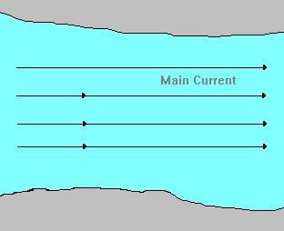

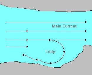

Lets look at an example. Water Current and Electrical Current are analogous to each other. This we already know, but for other readers, we need to be clear. We will use some imagination. In the following image:
We see Current of the River moving from left to right. However, we also see eddy currents created that turn and move the opposite direction, from left to right. I am sure we have seen this before and everyone knows how this works.
Imagine, we can add and remove the small point, marked in grey, we can add and remove this at will. Like so:
So you get the idea.
Our Coils do the same thing! We add and remove Conductivity with a timing to produce extra, otherwise not there, Currents. Nature shows us, they must always flow in the opposite direction, unless we have a function forcing the current to do otherwise, as in my thread: Parallel Wire or Bifilar Coil Experiment - the bifilar wound transformer, the Input forces the Current to flow in one direction at all times in the Secondary Coils.
So, we add and remove the Conductivity in the Coils at a specific time, individually, creating large Voltage Potentials on the Terminals, because the faster we add and remove the obstruction, the faster the currents are forced to change, and the Standing wave creates a potential that must decrease linearly over time if Conduction is held steady.

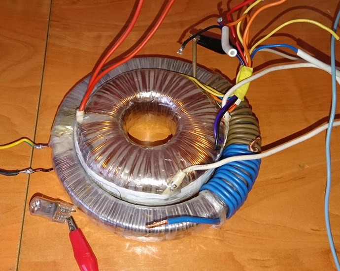

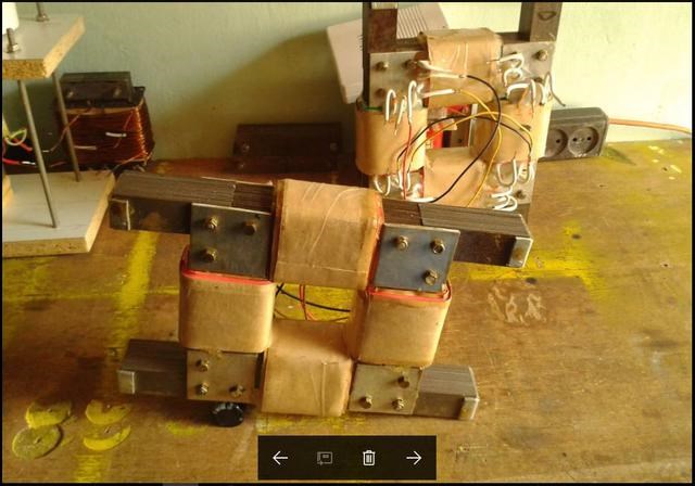

Atti posted this 16 February 2019
 I have pondered what would happen if you put a small toroid in the center of the large toroid and wondered how a winding around that toroid would respond to changes of current in the large toroid.
Hey Zanzal. I've been doing a similar experiment in the days.
Hey Zanzal and everyone.
What I am mentioning to others now is perhaps clear. That may not be a good idea. But you'll fix it if you need to.

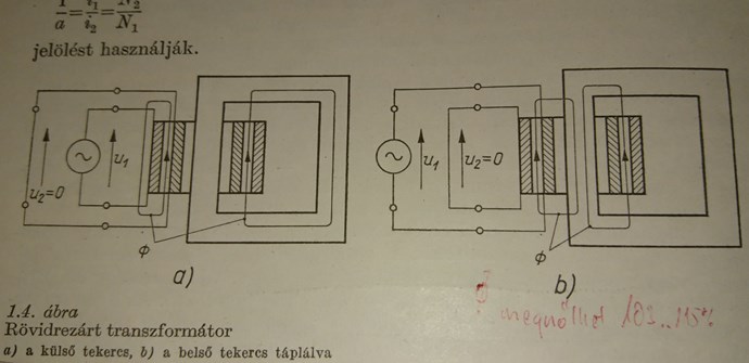

My whole initial investigation began with a cloak type (E I) transformer. I was wondering how the primary and secondary coils affect each other. When the power line comes out, where and when saturation. This is seen in the first half of the video. Here's an old MOT transformer with two identical rolls. The secondary is a 40y capacitor. It can be seen how at the right resonance the relationship of the two coil phases develops. At that time, berezona and the magnetic flux will exit the iron. Closes inside between primary and secondary coils. The iron plate near her is the best one here. So I had to measure just how much this value was for signaling. I took out a little ferrite cylinder, a few threads at the end of the thread with a 22 ohm resistance and a multimeter. I wanted to see the scattered flux route. The idle characteristic is that the flux closes only within the iron core. Therefore, both rolls are closed with the same flux. In the state of load or short circuit, the threads of the coils are connected by different fluxes.
That's why roll flux and iron flux. The flux image is also different if, for example, an external or internal winding is excited by a chain-type transformer. Alternatively, the secondary is short-circuited.
(The operating state of the load is between the idle state and the short-circuit condition.)
One picture about this:
a, external coil excitation
b, internal winding excitation
a, in the case of the column of the iron core, the flux may fall to 3 ... 5% of its idle value.
b, in the case of flux, may increase to 103 ... 115% of the idle value !!!
So the other thing is what we do with it or what are the options. Because the higher flux rate change results in more tension!
A video of a toroid in the video from 0:50.
In the video, a 2: 30 core type transformer is tested in two ways. Measured blank and then measured in tight or loose coupling.
At first, close coupling involves excitation and load.
Here, the measured measurable value decreases.
(values ​​are for information only)
In the second case, the value of the loose coupled secondary coil is increased. Larger flux exited.
Thus, the secondary flux has a greater influence. I am thinking of, for example, the MEG device. Or I deal with the device of Árpád Bóday. I've already written about this. It was only in such cases that he was willing to work the permanent magnet properly.In addition, the position of the permanent magnet should be between the two coils.
From my device image:
I'm sorry if it's long and incomprehensible.

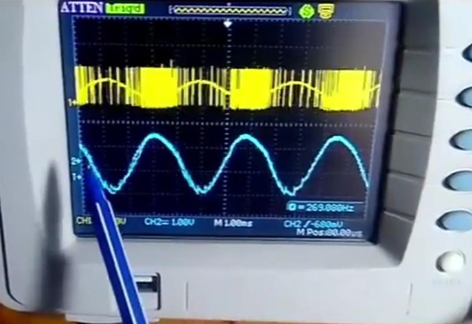

Forelle posted this 13 March 2019

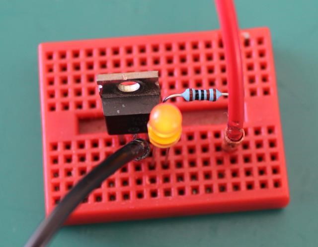

Hi all, I would like to give a short Update from my progress.I built Zanzalβ€˜s easy BCFT circuit,it works very good but i still dont have reached magnetic Resonance,you hear from me when i get it. Thank you for this Forum.πŸ‘πŸ€πŸ™
Zanzal posted this 13 March 2019
Hi all, I would like to give a short Update from my progress.I built Zanzal‘s easy BCFT circuit,it works very good but i still dont have reached magnetic Resonance,you hear from me when i get it. Thank you for this Forum.πŸ‘πŸ€πŸ™
Excellent, I am glad you found the circuit helpful. I learned a lot from it and variations of it. I came away with the impression that the circuit is hindered by losses and the forward topology makes it hard to avoid some of them. If you have improvements to share please feel free too.
If you have trouble, it may make sense to modify the circuit to run the primary RLC resonant and to experiment with variations that do not self-feed. Care may need to be taken to avoid damaging the IC if rlc resonance is used, but I think it is essential to maximize efficiency. You may also find that the diodes introduce losses. I found that I could reduce the effective Vf using diodes in parallel. I believe this is because there is a small series resistance component that makes up the Vf and that portion of the Vf can be mitigated but there are diminishing returns as the leakage current and capacitance of the diodes will also add in parallel.
Forelle posted this 14 March 2019
Hi Everyone So far it works best for me with a Fullbridge rectifier or without diodes,with only 2 diodes i have the badest Performance,i guess it has to do because i have Not the 180 degree phaseshift of the current and Not tuned to resonance.I am at the beginning and have to spend more time.The good thing is that from now on i know for what i am looking. Have a good day. Oliver
