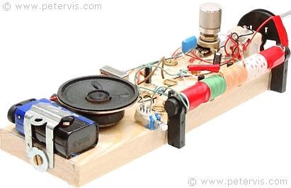

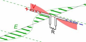

First up, I am still a novice when I talk antenna's, so what I say, I may not be right, its just my gut feeling.
Coil Antennas are used for Far Field Transverse Waves, one example:
Ref: www.petervis.com/
I am not sure about the Video, perhaps there may be Longitudinal Waves there, perhaps Transverse Waves. If one were to roll out the Coils, 1.8M and if they were still in the same plane, would one get the same effect at the same distance, no, the Inductance and Distributed Capacitance would change of course.
I am still thinking on this, I will remain on the fence. To be perfectly honest, this area I am having and have had problems with for a long time.
My very average calculations show this could still be in the Far Field, just something to think on:

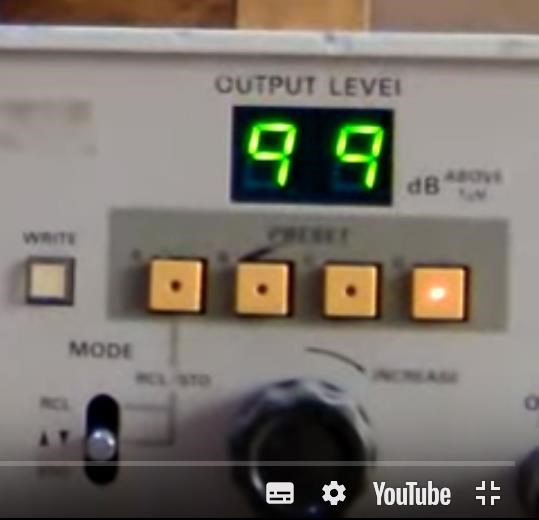

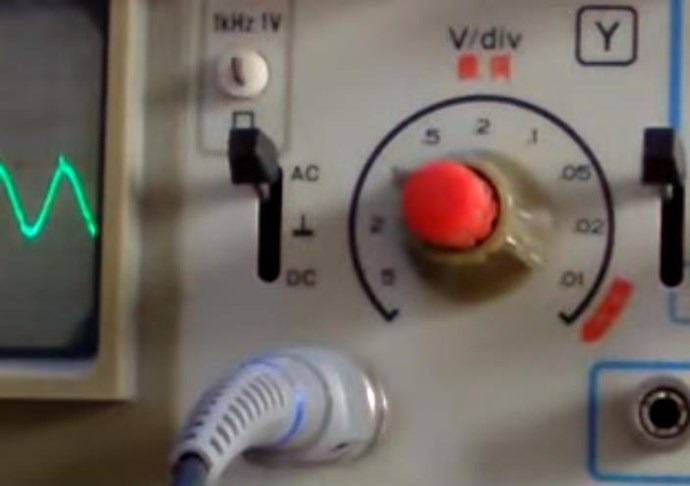

P.S: is the scope only at 1V / div? I would guess the output voltage is not as high as it should be according to the Function Generator?
Chris posted this 20 May 2018
Its a little hard to follow, the video is a little unclear.
I believe the 99 on the Function Generator is in db, decibels and I believe this is 0.99, I may be wrong. This would give an output Voltage of 1.12V.
I believe the Scope was set to either 0.01 Volts per division or 1 Volt per division.
Please point out any mistakes I have made guys. Been a long day and my observations are a little rusty around the edges.

I believe you are correct on the output level and I commented because I have done similar experiments and know others who have as well. The secondary ground terminals can also be replaced with top loads and produce similar results.

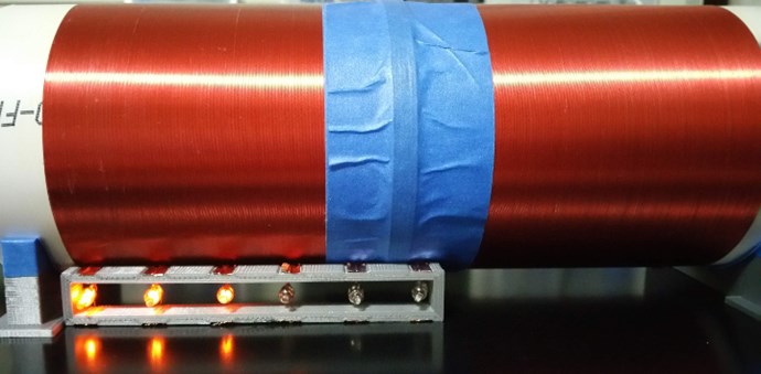

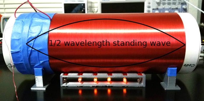

So I refined the experiment to better demonstrate longitudinal waves and In the process I also learned that my initial concepts of the wave were wrong. What I had envisioned was what would actually be called a 1/4 standing wave if such a thing could exist not a 1/2. Once I discovered my mistake I built a detector based on inspiration from perro555's electricians meter and Tesla's detector described in The True Wireless. My interpretation of Tesla's detector may be incorrect, but my results I think clearly demonstrate the idea better than I can describe them with words:
Wavelength is 426m (2x213) and frequency is 1.06MHz so wave velocity is around 1.5c. Detector shows wave is standing wave with 1/2 wavelength.

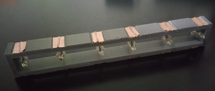

My detector is just a 3D printed piece of plastic with 6 neon bulbs spaced every 2cm, 1/4" copper tape is used as capacitance on both sides of each bulb and also to tape the neon bulb leads in place. Extremely simple. Center bulbs are lit demonstrating the standing wave at 1/2 wavelength. I'm going to consider this proven.
Fun trivia: When reading older writings the term detector can often mean diode or rectifier. But Tesla's detector just looks like a strange light bulb.
I'll attach the STL file to this post in case anyone wants to print one but I don't really recommend going out the way to do so. While this detector has its uses for visualizing the intensity of the field along the length of the coil, it has limitations mostly in that its really hard to get a good idea of intensity. Using an array of Avramenko plugs might be a better design since LED brightness seems to scale better.
The results seem conclusive to me, I can now move on to the more difficult aspect of this which is power transmission. More to come (might be a few weeks or more)...

How do you explain the lighting pattern on the neon bulbs? Why are the two end bulbs dark?
This is how I see this: The voltage potential in the area by those dark bulbs is insufficient to reach the intensity needed to conduct current. The experiment does nothing to explain how the ones that do light up actually light up. It matters not how they light but we do know why some are lit and some are not. We can prove the light pattern conforms to a wave at 1/2 wave length just by visual observation. We know its a standing wave if the wave were not standing we'd expect to see somewhat even lighting pattern. And we know that a standing wave results from cavity resonance where the distance traveled is at multiples of 1/2 wavelength. The first resonant will always be 1/2 then. Waves can be reflected and waves can travel in loops around the conductor (inferred by the fact that a shorted secondary is still resonant). I think it helps if we consider these waves to be waves of oscillating potential and the conductor is maybe a wave guide.
So if that is the right way to think of it then seems to me what this experiment proves is that the voltage potential propagates faster than the speed of light, even if the actual measured voltage due to electron flow does not. Either that or I'm just visualizing it incorrectly. Time will tell.

Am still thinking on this... What happens if you move the Primary into the centre as suggested by Enjoykin? Do you get the same pattern on the neons?
I have a feeling the pattern on the neons are Field related as you stated, but are showing Electric vs Magnetic rather than a Standing wave.
We know the Magnetic Field to be Orthogonal or at Right angles to the Electric Field, I am not sure how the Neon's are seeing such a difference in Potential, but I guess the fact that they are glowing shows that they are.
I personally believe the Neon's are showing the Gradient of the Electric Field around the Inductor:

Question: I am assuming your Neon Globes are all open circuit, essentially sitting in free space but in the proximity of the coil? There is no Electrical Connection?
Also, what plane are they sitting reference to the Coil? Rotation the Neon Globes 90 Degrees, does this change the glow?
Would you mind upping a close-up of the Neon's
Zanzal posted this 26 May 2018
Not with wires, but if you expand your idea of a circuit then yes they are part of the circuit drawing power from the coil even without wires. Really its just a matter of whether or not the voltage potential exceeds the neon voltage drop. So if the neon lights at 80V then it will need 80V of potential to be lit at all. Fall below this and nothing.
The angle is important. If they are oriented in a different direction they will light differently. They seem to work best with the capactive plate angled toward the coil but as you can see it may be a 45 degree angle or so and no issues. Both pictures they are each roughly the same linear distance from the coil and at approximately the same angle to the coil. I have them pushed up close to the coil to ensure that fact.
You can't have your hands anywhere near the coil (6-8 inches) though or you can't expect them to work right. Metal objects seem to act as reflectors with these setups same with the human body. Hands near the neons will cause visible lighting effects and touching the coil seems to prevent resonance, I already explored a lot of this before with the slayer exciter and it didn't prove all that interesting. This thing does an ok job of mapping out the field density though and when approaching or moving out of resonant frequency the bulbs will dim and the field will diminish in the same patterns as they appear.. So in the 1/2 resonance leaving resonance the outer neons will dim and turn off before the inner ones.. These things are not really surprising.

Hey Zanzal,
Fascinating, the Rotation of the globes in the plane of the EM Wave showing changes is absolutely fascinating. Obviously the Radiation is showing up as we would expect to see in an Antenna:
For me, this helps prove a lot of things I have been working on, suspecting and attempting to verbalise, but at the same time not fully grasping. I have tried to push the idea of thinking of Coils in resonance as an EM Wave:using the 1/4 and 1/2 Wavelength principles.
My Thread: Electromagnetic Waves, does cover a lot of stuff, and suggests Coils in resonance follow the same principles as Antenna's.
I find your experiments very valuable Zanzal
Thank You very much for sharing!.
Enjoykin2118 posted this 26 May 2018
Hi Zanzal
try one of these neon ligh tubes as standing wave indicator. There will be different Zebra-Effects (sequences of dark and light areas) which correspond to positions of nodes and antinodes over the coil.
Dont bias NST, they are auto biased.
Enjoykin
My guess would be that a single tube would not work as well as the neons for showing this. That the tube would become conductive and have its own resonant frequencies for standing waves, but it could show a running zebra pattern as can be seen in some other videos. It would probably work if one places many small tubes in parallel with spacing and placed the coil on top of a bed of parallel tubes.
If anyone wants to try creating a 1/2 wavelength standing wave in a florescent tube then we might wonder if the frequency that wave appears indicates a wave velocity faster than c, about c, or much slower than c. I'd be surprised if we see faster than c velocity inside one though, its not going to be nearly as conductive as copper.
Chris posted this 26 May 2018
Great to see these ideas being passed around.
The Neon's show something I think the Flouo's may not indicate so dramatically, but I agree the Flouo's would do a similar job.
My friends, I very much appreciate your sharing here! This has great value and all can learn from this!
