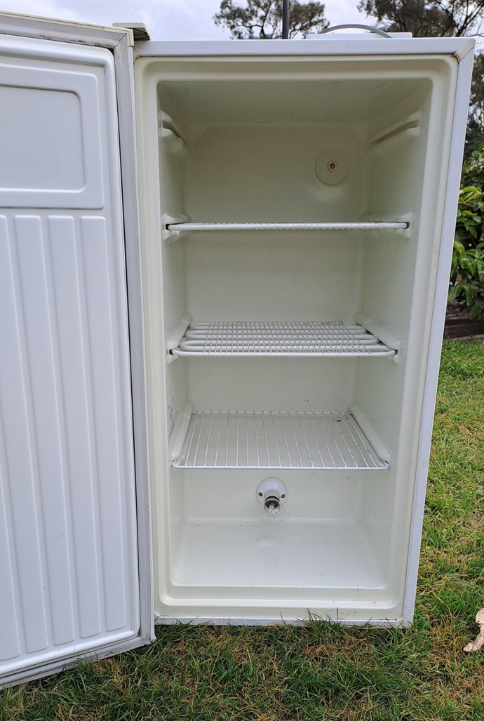

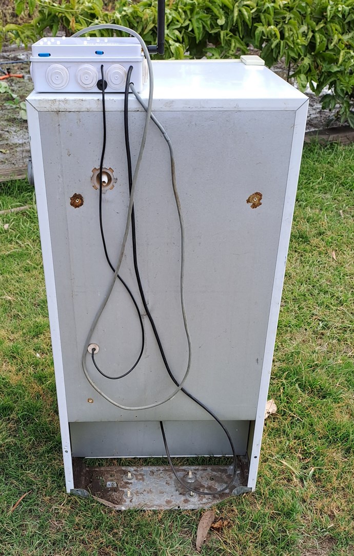

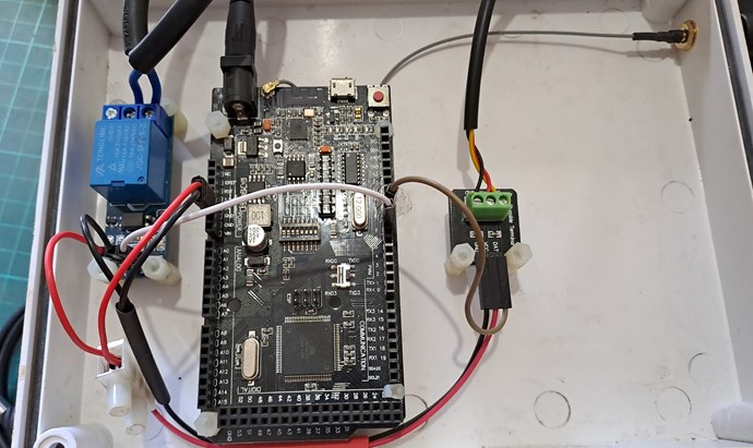

Recently I built a Small Incubator with My Kids, we want to raise our Chickens and Ducks in the Incubator because the Mums are not very dedicated to their Eggs, and they wanted to help, of course I had to make it complicated, and they quickly lost interest, but are very much enjoying seeing the  progress!

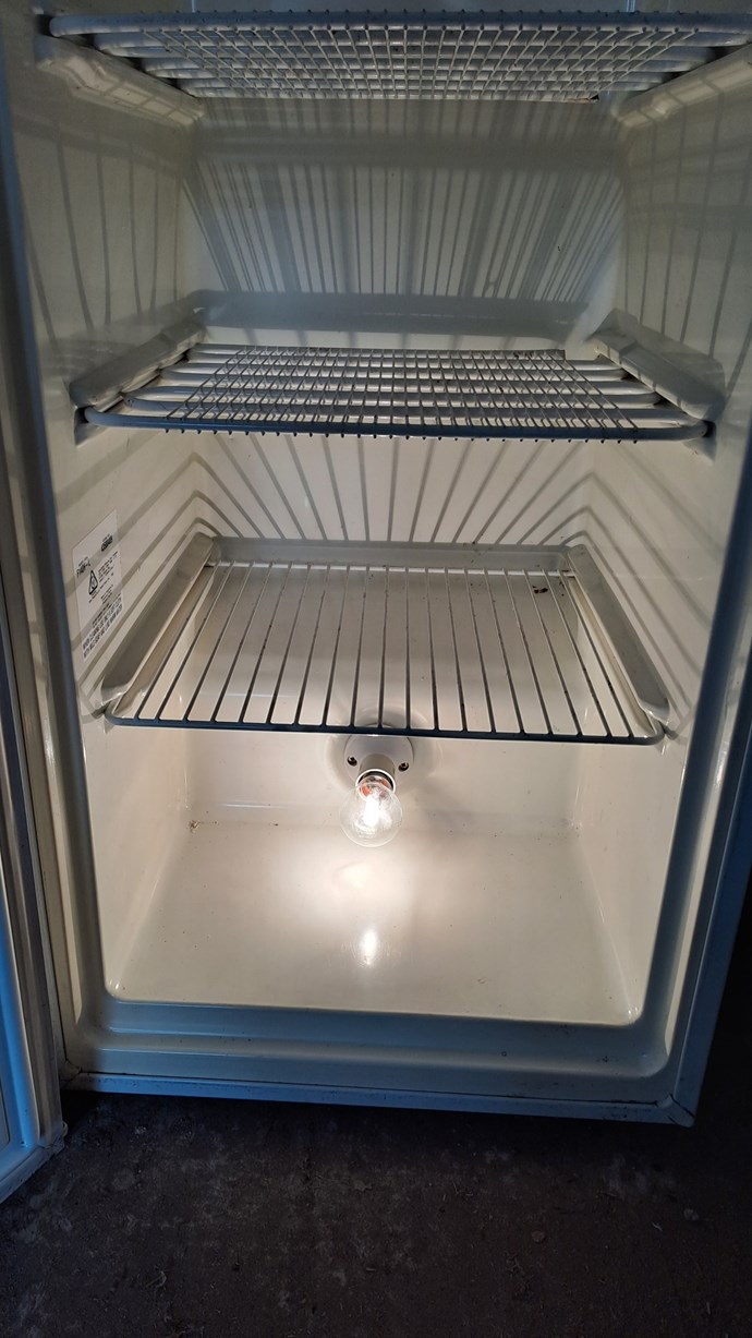

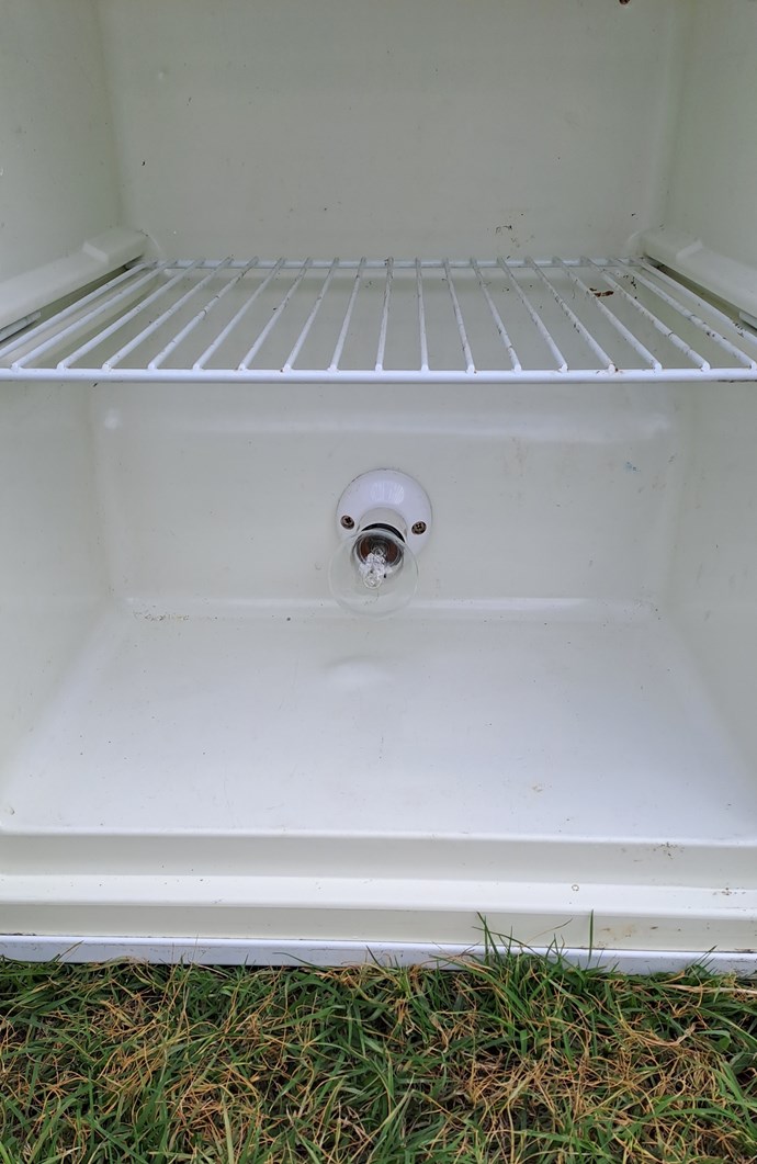

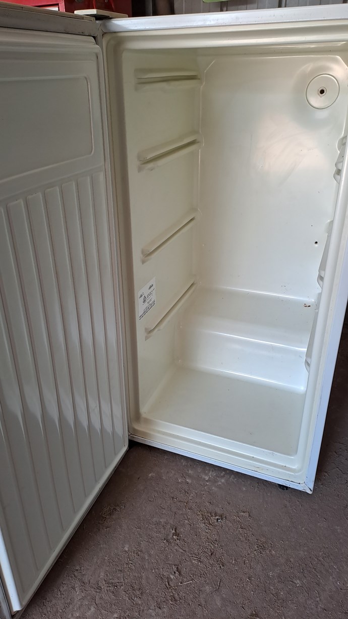

We are Re-Purposing a small Freezer, one that was still working, but was giving us a few problems, so re retired it, Stripped it out and cleaned it up a little:
The Shelves have been cleaned up and will go back in. We will have an Incandescent Light Bulb as a Heating Element, and a Temperature Sensor, controlling a small Relay:

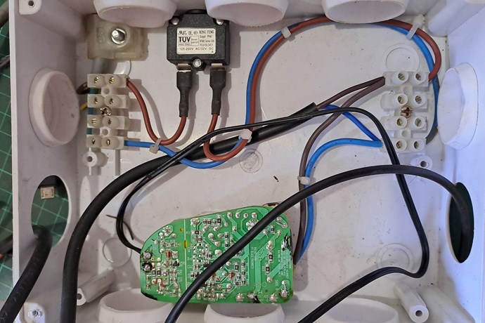

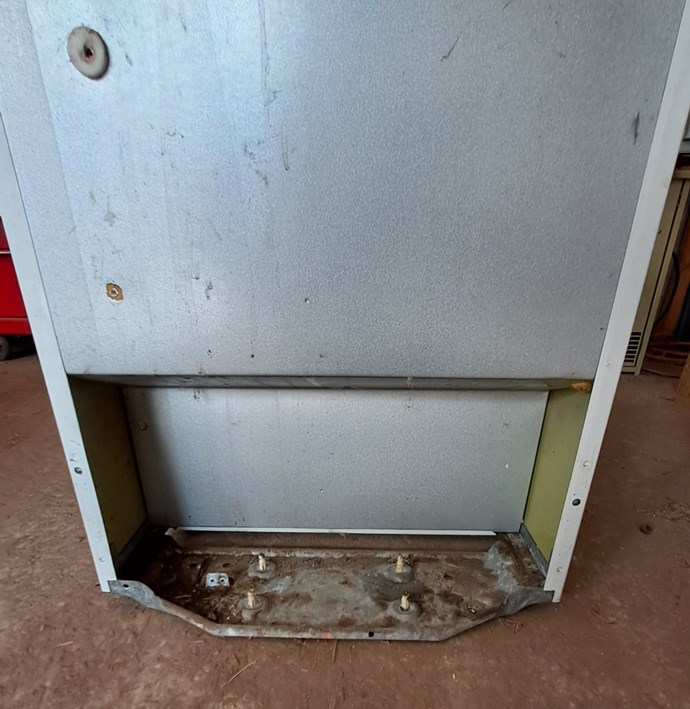

All this, the completed Controller Box will go in where the Compressor used to be, after a clean up:

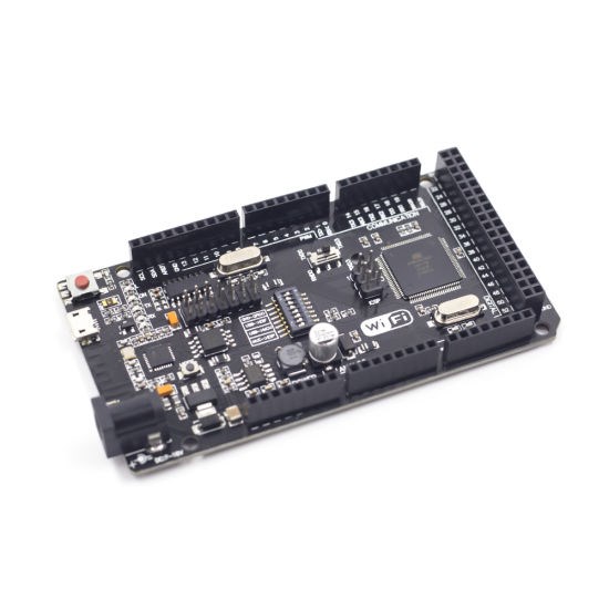

The Arduino Clone, Mega Wemos:
Is a fantastic Board, but it is a bit finicky to get going, 100% It takes some time, and some knowledge to figure out some of the problems associated with it.

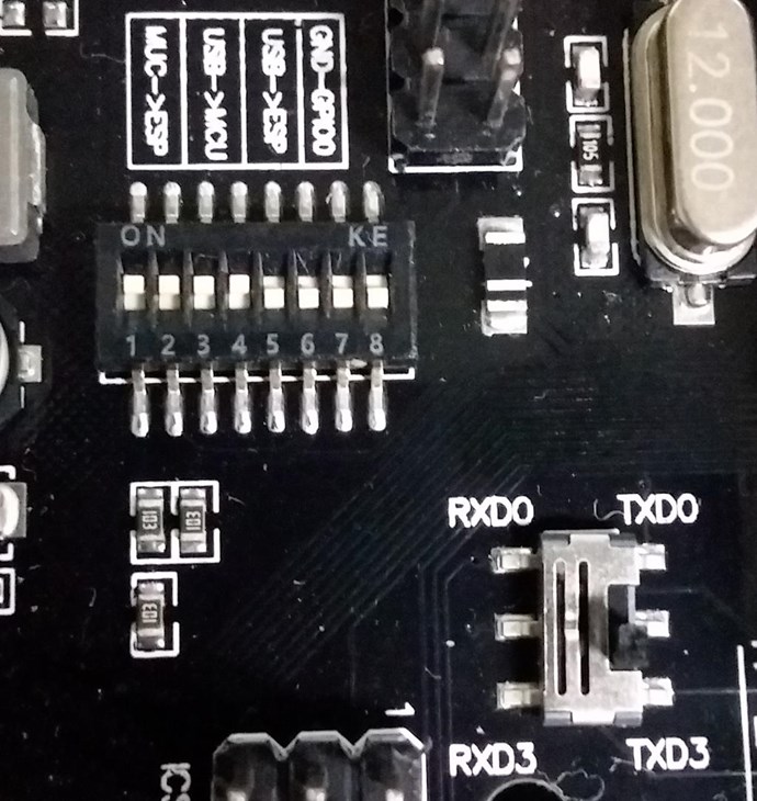

To do this, your "Mega +WiFi R3 Module ATmega2560+ESP8266 32Mb Memory USB-TTL CH340G Mega NodeMCU ESP8266" board, needs to have the Jumper buttons set:

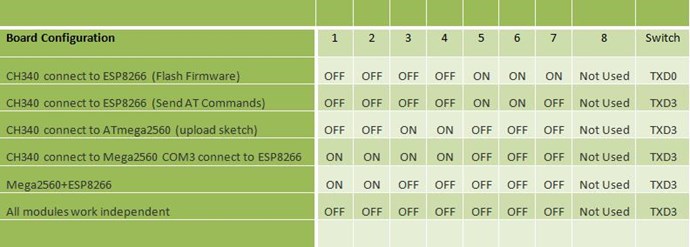

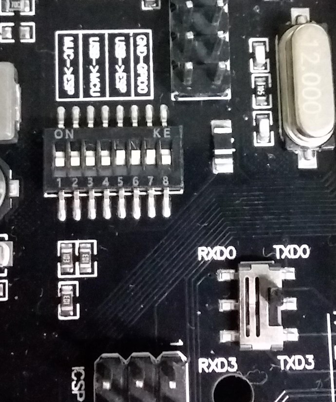

Switch your Jumper Buttons, and the RX/TX Switch, to:
Luckily this is very easy, the best method I found was following this video:

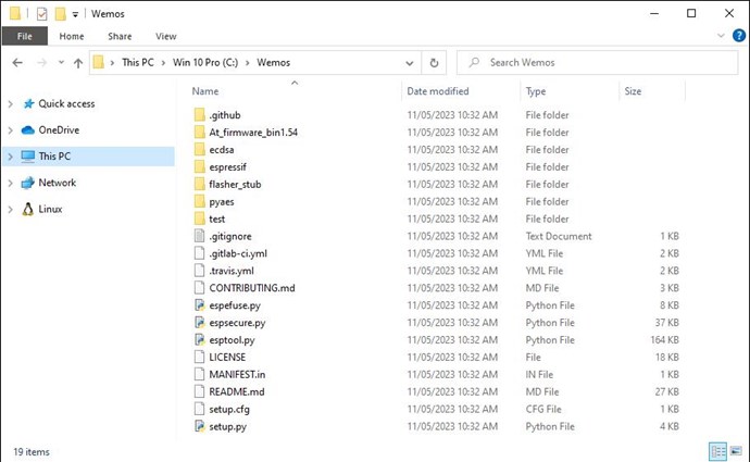

Extract all your Zip Contents to: 'C:\Wemos\' like this:

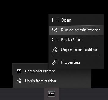

Open a Command Prompt as Administrator, Elevated Permissions:
  1. Right Click the Command Prompt.
  2. Go to Run as Administrator.
  3. Click Yes.

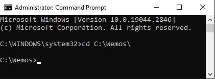

At the Command Prompt, type in: cd C:\Wemos\
As you can see, this changes the Directory to C:\Wemos\

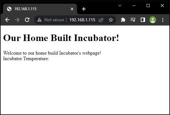

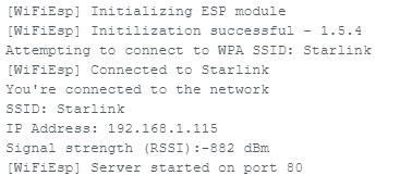

You should see:

When you're done, finished the firmware Flash, set your Jumper Switches back to: "CH340 connect to Mega2560 COM3 connect to ESP8266" mode, so you can use the ATMega and the ESP8266 like a normal Arduino.

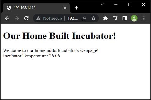

          "<h1>Our Home Built Incubator!</h1>\r\n"                                   //                                              //
          "<p>Welcome to our home built Incubator's webpage!</p>\r\n"                //                                              //
          "<br>\r\n"                                                                 //                                              //
          "<p>Incubator Temperature: "                                               //                                              //
          "<b>%Celsius%</b>"                                                         //                                              //
          "&#8451</p><br>\r\n"                                                       //                                              //
          "<p>Light is: "                                                            //                                              //
          "<b>%PinState%</b></p>"                                                    //                                              //

Your Arduino IDE Should give you a message in the Serail Monitor:
Of course, your details will be different, your IP Address and SSID will be different! No doubt.

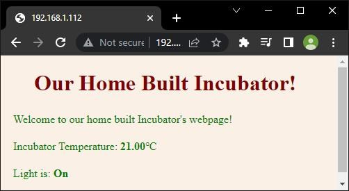

After a Reboot, and a little bit of Patience, you will get a Web Page:

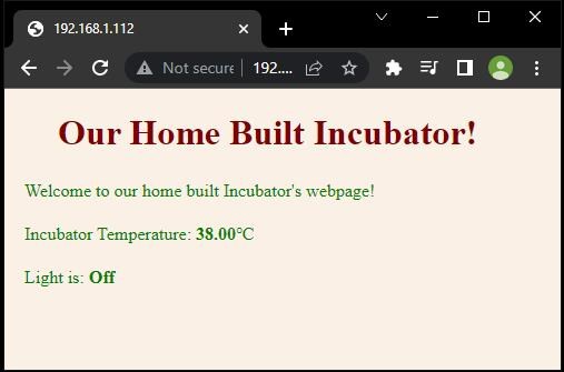

And of course, when I connect the Sensor:
Of course, this is a very simple start to our project, and more can be done to make this more stable, and much more exciting to use, setting a Fixed IP Address would be a start, maybe adding a camera to the inside of the Incubator at a later stage, to see any chicks hatch may be fun!

The Control Box is mostly Complete, the "Mega +WiFi R3 Module ATmega2560+ESP8266 32Mb Memory USB-TTL CH340G Mega NodeMCU ESP8266" is mostly Coded, to a Working state.
I think I will mount it on top of the Freezer Cabinet that we have re-purposed as an Incubator. This will give us better WiFi Signal and also better access to the control box if I decide to update the Code or add new features.

I think we are ready for Spring, 1st of September!
The Incubator is finished, for the most part. Its working and it get up to Temperature fine!
All done, maybe some more features added soon.
