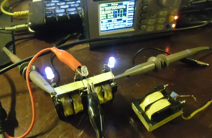

Yes it was connected directly to FG.. I did found several harmonic points..  offcourse I did decreased the amplitude for the best energy propagation was 5V max... above that the effect is gone.
The same effect can be done with a simple isolation transformer. If you want I can make a video with it, to see that is totally the same effect. I don't have differential probes, nor measuring non inductive resistors, but others have proved that and after all it is obvious that energy at receiver is more than what the transmitter use. That is probably the way of work of the led circuits of Akula. As for the grenade.. I think I got the idea of how it works.. One side of grenade is used as capacitor, the other side as a transformer. Only testing can prove that, but I think we are close!
I did download Chris files! I haven't finished the big book yet, but I already learned so much! Thank you again Chris!

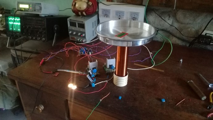

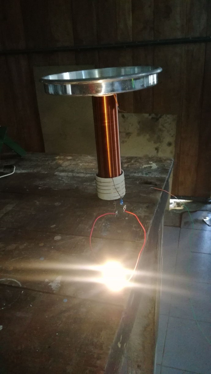

Here some images from my replication of the scalar transmission experiment:

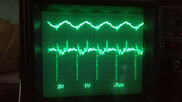

The setup: two identical tesla transformers aprox. 4T primary 500T secondary. Driven by a half bridge powered from power supply via capacitor voltage divider; in order to monitor the input power. The signal is fed from the SG, square wave 50% dty. As load two arrays of antiparallel LEDs are used TX side 30v 9w , RX side 33v 10w. On the scope the voltage o the TX primary is shown, and the other trace the E-field captured by the unconnected scope probe. At the point of resonance(LMD) the TX LEDs are dimely lit, while the RX side gives a quite bright output, despite of the higher foreward  voltage.
As suspected, at resonance the impedance of the circuit drops, and current increases, but there is a second resonant point, where the current goes up further, without the RX LED lit(perhaps the TEM radiation)
By approaching the hand on certain places, a kind of finetuning can be achived.

Few days before, I repeated the test setup, with two isolating transformers. To make sure power is doubled with two receivers. The same effect happen. Power on both receivers is not shared, is doubled. It is very fast and easy experiment to make in few minutes.
If someone want to replicate... Just get any 2 small identical 1:1 ferrite transformers. Usually these transformers are inside switching power supplies. I am sure most of you have them in your circuits boxes. Connect them back to back, connect leds to all 3 places, keep duty to 50% put amplitude to 5V and tune frequency to get RX leds on and TX led off.
