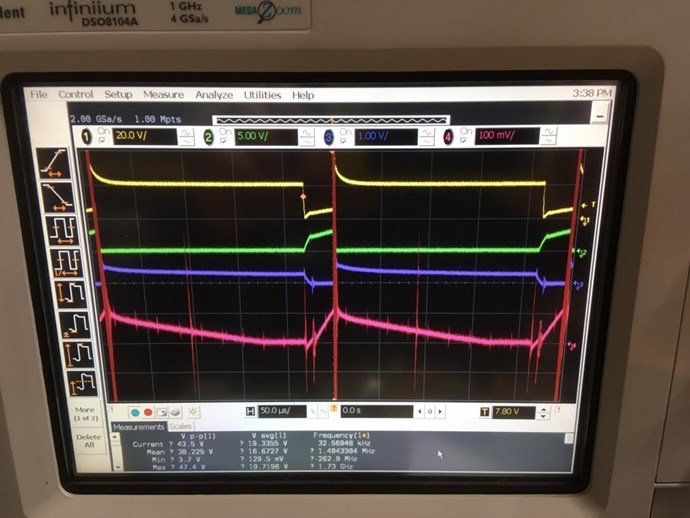

donovan posted this 25 December 2022
Merry Christmas!

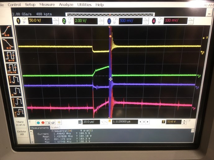

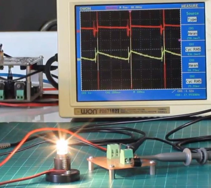

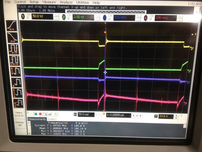

Here is what I have tried, am I headed in the right direction?

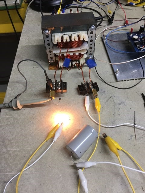

I think the most important thing in this experiment, is set up like this, when I disconnect the Bucking Coil Diode, the light goes to about 1/10 brightness.
I just built this with stuff laying around.
Things to try next for improvement:
1)  My signal generator won't put out a low duty cycle, so I just built one up real quick from a TL494, which seems to not be able to go to the lower frequencies.  Right now the scope shots are at .2ms/div, About 1kHz.  I would like to try lower frequencies.
2) Try different loads, maybe lamps in series to get the voltage up, with a higher resistance load.
3) Try Zener diodes, or Zener diode and MOSFET's on the bucking coil to get voltages up.
4) Maybe try smaller coils to learn more from.

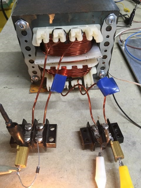

Transformer
Transformer

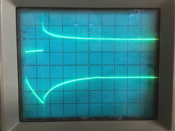

Input Voltage (top), and Input current
Input Voltage, Top, and input current
Input Voltage (top), and Lamp current
Input Voltage, top, and Lamp current
Transformer and Lamp Circuit
The Test setup

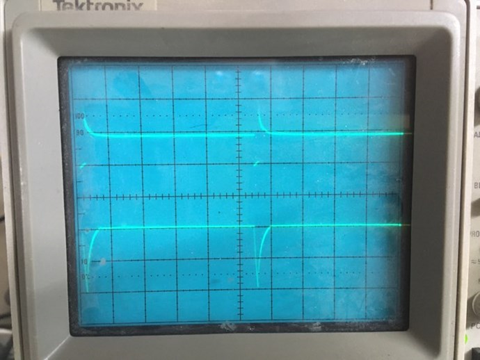

Input Voltage (top), and Buck Diode current
Input Voltage, Top, and Bucking Diode Current.
Any input is appreciated!
Donovan
Chris posted this 25 December 2022
Hey Donovan,
Nice work, thanks for sharing mate 😉

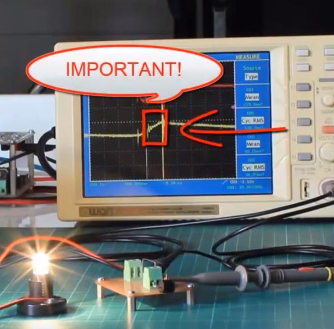

You're getting close! You can see a sort of Triangle Waveform. With a bit more work you can make this much better!
The Triangle Waveform you are after is much more Asymmetrical, and then a lot of study to learn what's actually occurring is required, and then a much greater understanding can be achieved as to how to improve this effect.
Where the Green Period is the On time and the Red Period is the Off Time.
Its the Effects that are important!
I have shown this in more detail in my video:
With Images I have shared:
This is Asymmetrical Regauging:
Asymmetrical Regauging is a very well defined concept now days, but it is very limited to its current form. It can be very much more broad in its current concept to include Phased Sinusoidal Waveforms.
The important thing to learn here is we are specifically using Asymmetrical Electromagnetic Induction, beyond Symmetrical Electromagnetic Induction.

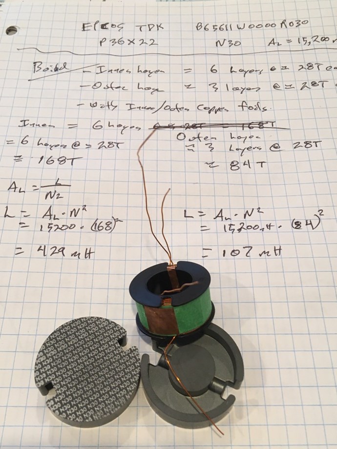

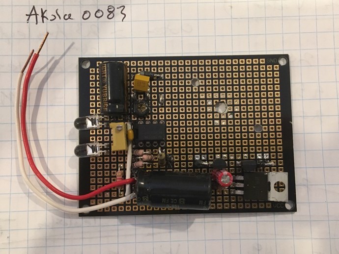

Here are some notes on my Akula0083 eternal flashlight replication.  There is a lot of info on this forum, so maybe this has been discussed before and I have not seen it.
My version of the Akula circuit.  Used a complimentary pair of MOSFETs instead of the Hex Inverter.
I picked the highest permeability core of an approximate size compared to the Akula video.  My inductance's ended up higher than Akula's, but I will go with that and see what happens.
I saw some comments on the 23/26 arms length of wire for the outer and inner coils.  I assumed an arms length to be 1 m.
I settled on my lengths to be 10.5/14 m, as a length that could be wound on the core while approximating the Akula ratio.  I placed a copper foil layer in the inside of the core, and one on the outside of the completed coils.  The inner coil of 14 m ended up being 168 turns, while the outer coil of 10.5 m  was 84 turns.  1:2 ratio, perfect!  I calculated the inductance's and the inner coil is 429 mH, while the outer coil is 107 mH.  1:4 ratio.  Quarter wavelength, anyone!  So, if Akula used a less permeable core, than I did, it would be easy to get the inductance he shows in the schematic, while confirming the amount of wire used in the video.  The only, glitch, is maybe, labeling L1 vs L2 inductance's.  Which one is the inner coil and which one is the outer coil.
Of course, getting to these numbers before the build, required a scratch pad and some trial and error with online calculators, to get in the ball park.
Excited to get back in the lab after the holidays and measure the actual inductance, and power it up and see what happens.
Donovan

Chris posted this 27 December 2022
Hi Donovan,
You make an interesting statement:
I am still thinking about the inductance ratio in the Akula0083 video as well..........

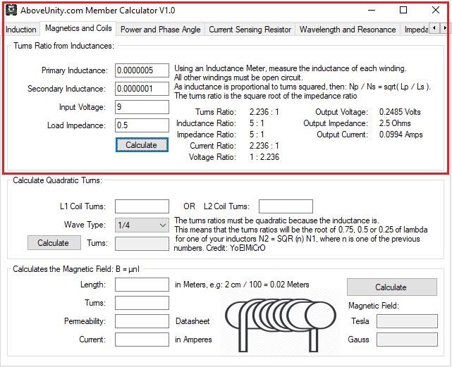

The Inductance Ratio is related directly to the Turns Ratio. I provide a  Calculator to show this:
I hope this helps some.

Yes, just trying to account for all the info in the Akula video where he disassembles the coils.  And how to get closer to his inductance values, with the given wire lengths and information.
With such variables as the wire gauge, tape insulation thickness, cross sectional area, and core dimensions there are enough uncertainties, that with a little more reverse engineering, we could probably come real close to Akula's wire lengths and schematic inductance values.
For the time being, though, I have built a nice coil, I will fly with it, and see what happens.

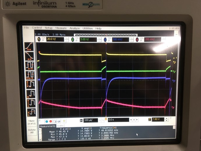

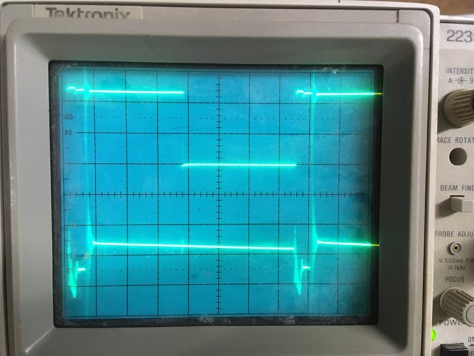

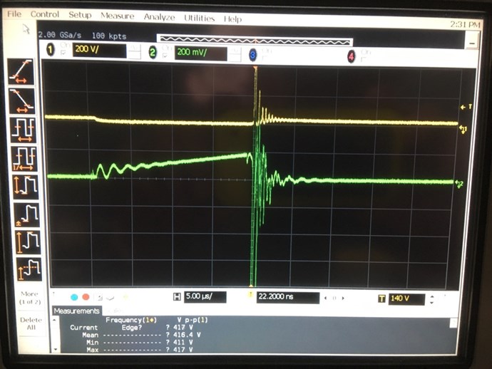

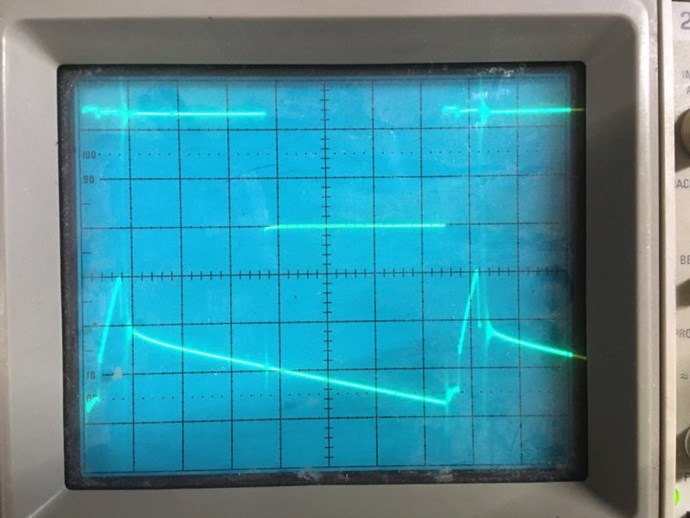

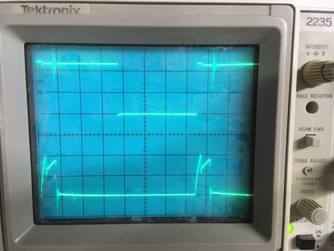

donovan posted this 02 January 2023
HI,
I see from the posts from Chris today, I have more videos to watch and learn from!

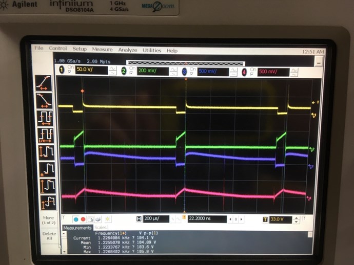

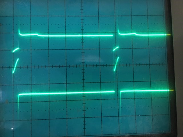

Here are some photos from my latest experiment with my POC setup.  All insight is appreciated.
The IP Voltage waveform is just a clock signal from my generator which I used to drive a PWM.  With this setup I could get a lower frequency and a stable PWM which I could not with just the generator.  I can now get a duty cycle anywhere from .5 to 50%.
Input clock with the Input Current.
Input clock and the Lamp Current.
Input clock and the Buck Diode Current.  The zero reference is on the second from the bottom graticule line.  Slight negative current indicated at the center vertical graticule.
My duty cycle is more than 10%.  I beefed up my load lamp from a "194" 12V 270 mA bulb to an "1157" 12V 590 mA/2.1 A bulb.  Lowered the frequency and increased the voltage and I was able to get this sawtooth waveform.  I was able to get lower duty cycles, easy enough, but the total lamp brillance was less than this test.  Here I tuned for max brightness.
"Tuning" involved, Load, Voltage, Frequency, and Duty cycle.
Tuning reminded me of when I did maintenance on the big, Tube radio and TV transmitters.  Max power out always occured at an input power minimum.  And there was always a stable "side" of tuning for max power, ie, (I don't remember which side) being slightly off resonance in one direction always resulted in the most stable configuration compared to tuning on or in the other direction from resonance.  I liked to tune for a slight (0.5-1%) power reduction, from max, to give me a "stable" transmitter.
I wish I had discovered this science when I had that job, and access to all sorts of useful test gear and big RF stuff!!!
Now I need to play and learn more and move towards "above unity"
Your insight is appreciated.
Donovan
Chris posted this 02 January 2023
Hey Donovan,
Waveforms are looking very good mate!

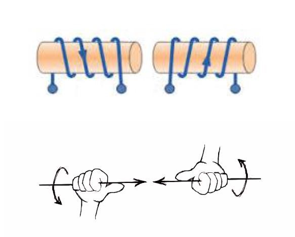

Double check via the Right Hand Grip Rule and Conventional Current each Partnered Output Coil is opposing, and I would say you're very close!

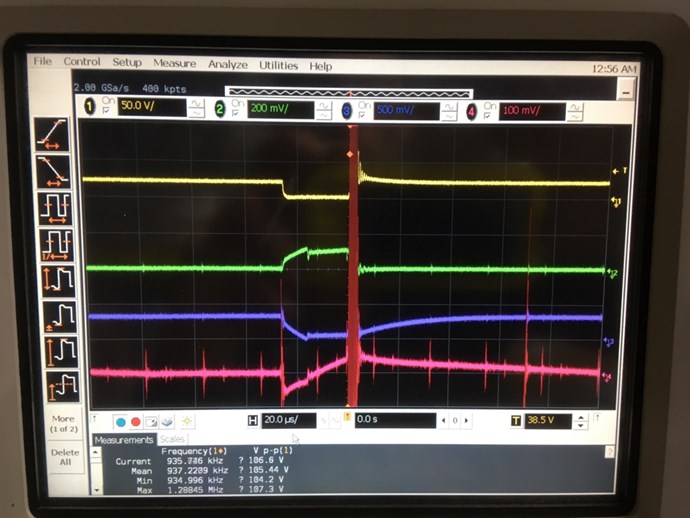

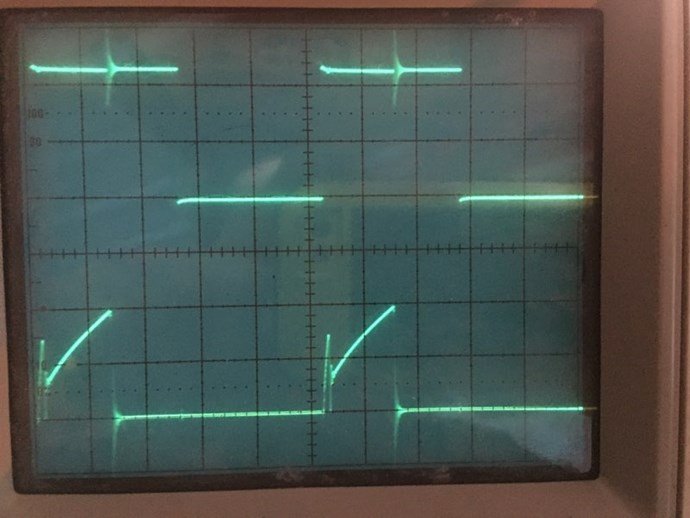

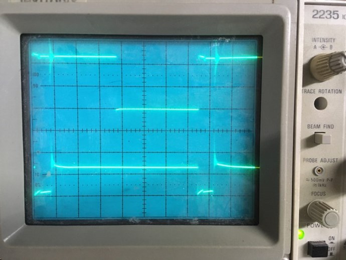

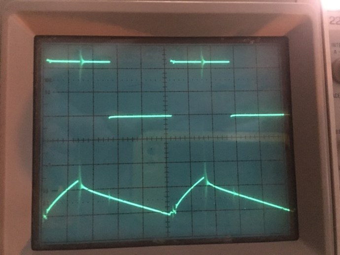

donovan posted this 05 January 2023
My latest experiment.  I re-wound the L1 coil so both L1 and L2 were both CW, as L1 is around L2.
Input Clock and L1 current.
Input clock and Lamp current
Input clock and Bucking Diode Current
Input clock and L1 Voltage.
I am using just a simple steel laminate transformer core.  Would I be smart to move to another core material?  I see the sawtooth current waveform, but I see no significant input power change when I disconnect the L3 bucking diode.  Am I headed in the right direction?  Any suggestions of
Donovan
Chris posted this 05 January 2023
Hey Donovan,
I recommend to Learn as much as possible from what you have before changing anything, document, video, and study intently the Mosfet On Time because no one has done this yet! No one has given an in depth study of the most important aspect of the POC, the Mosfet On Time, where the How's and Why's make this work!
That's why I marked this Important:
Why is this Important? I think we need to find out why? Don't you?
Laminated Silicon Steel Cores work just fine if there is a small gap incorporated! A Gap allows for the Residual Magnetic Flux to dissipate as much as a Silicon Steel Core can.

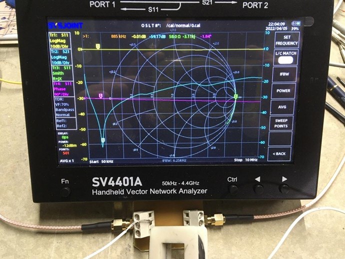

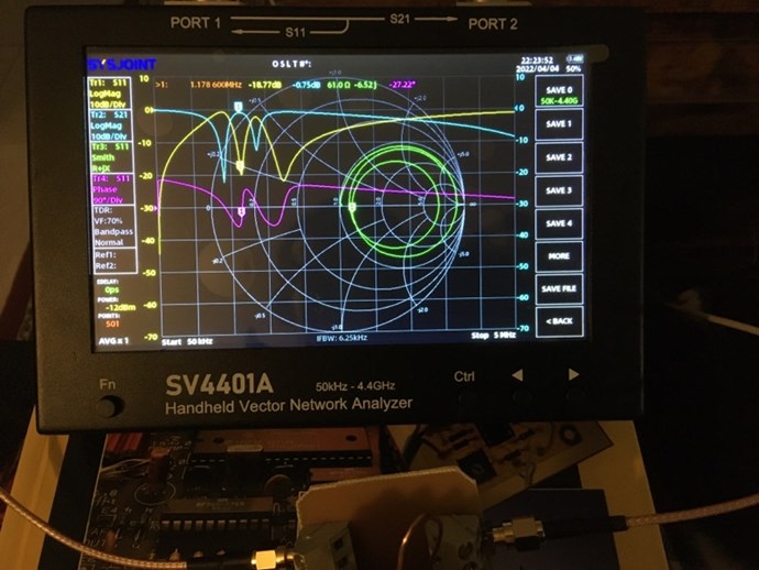

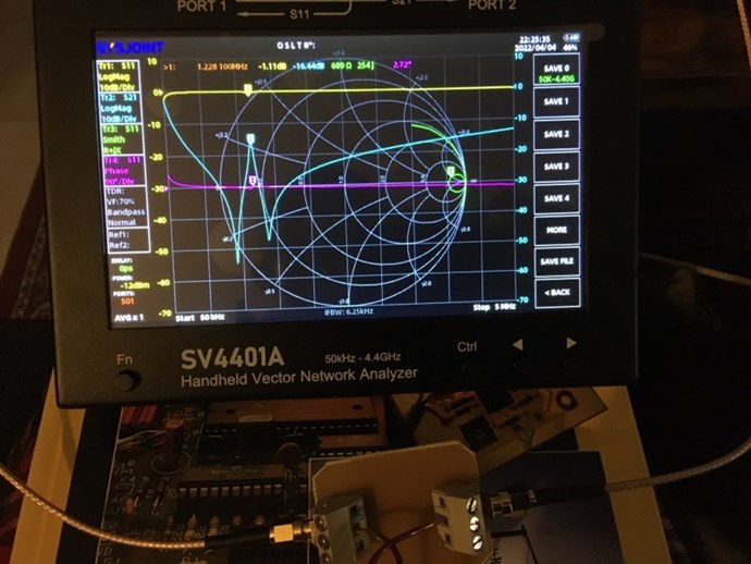

donovan posted this 07 January 2023

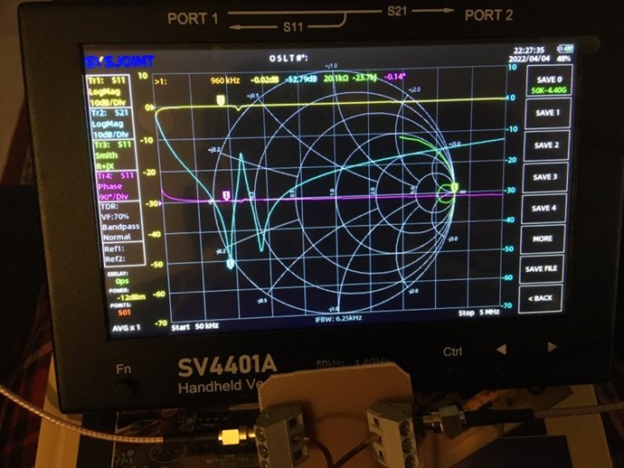

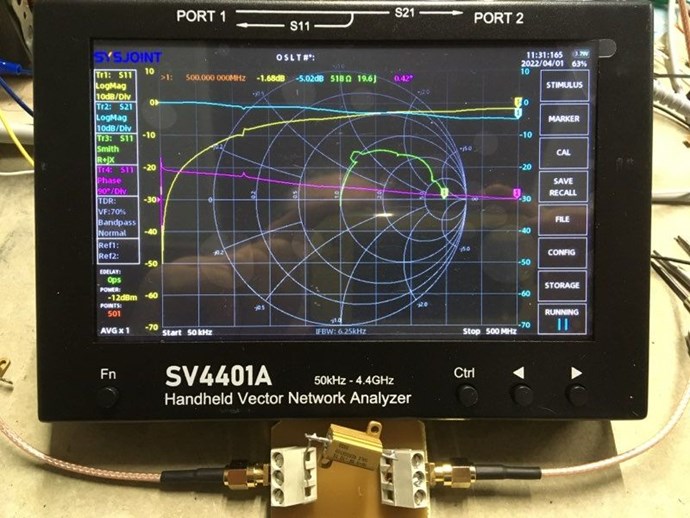

A Vector Network Analyzer (VNA) displays a plot of amplitude vs frequency.  Similar to a Spectrum analyzer, except, it displays, Insertion Loss, and Return Loss of an RF system, and usually both from the input and output of the system.  When I worked at the public broadcaster, we had one in the region......a $50,000 tool.......
But, China sells a generic, consumer unit, with limited sensitivity and bandwidth for a couple hundred dollars, on Ebay....no comparison really, but way better than nothing!!!  (just search VNA on Ebay and you will see it)
I have one, and I am building up a little test interface to measure components (transformers!) with.  When I get it set up, I will post some photos, and the info may be useful, in this effort.
The China VNA's, display;
Insertion Loss,
Return Loss,
Impedance,
and, and the phase angle of the impedance, (ie - inductive or capacitive)
Donovan

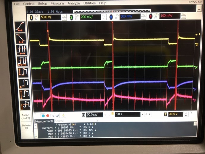

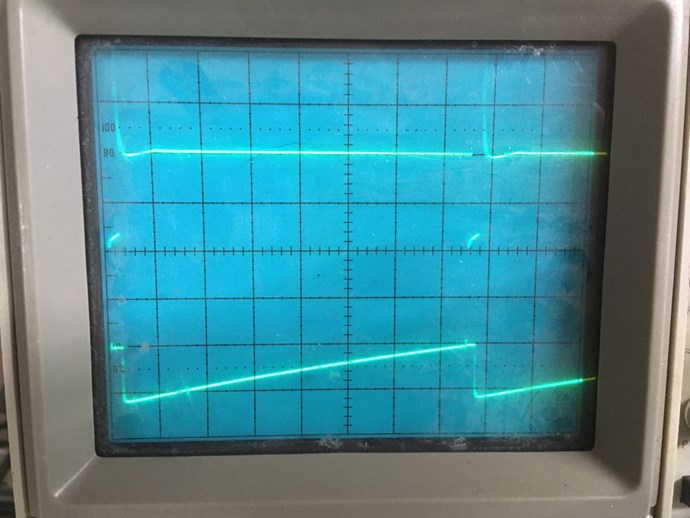

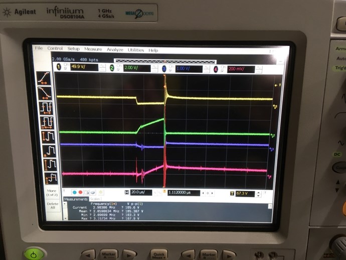

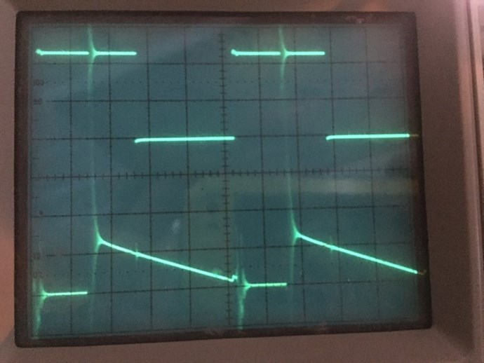

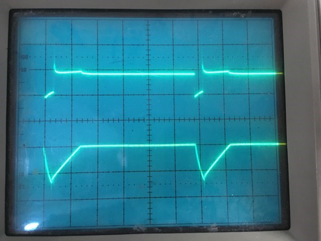

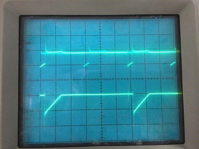

donovan posted this 08 January 2023
Today's learning,  Sometimes when we are doing lots of experiments, its easy to loose track of where you have been.  Any way.
To learn more, I lowered my frequency to about 1 kHz, and experimented with core gap a bit.  And, trying different coil/diode configurations to understand more on the POC system.  So here are a couple photos from today and what I think is happening in my systems.  Any comments are welcome.
Input Voltage and a L3 sawtooth waveform......when I disconnected L3/D3 there was no change in lamp brightness or input current.  So, I figured, coils are not bucking.......
Input Voltage and L3 sawtooth waveform after reversing the L1 polarity.  I checked the L2/L3 polarities with the right hand rule.  When I disconnected L3/D3, in this configuration, the lamp went to about half brightness with about a 20% drop in input current.  I am thinking with L3 affecting the circuit, it must be in the bucking mode.  In the previous configuration, where L3 had no effect, it would have been just a simple switching supply.
Input Voltage and L3 sawtooth current, expanded.  After looking at this for a while.......I thought the first 1.5 time divisions of the trace would be where the L1 current is ramping up, depending on the L1 inductance, when a DC voltage is applied.  The top trace is the MOSFET pulling the L1 coil to ground and supplying voltage to it.  The bottom trace is the L3 current.
Now, I started thinking about trace right after the input MOSFET is turned off, thinking the spike was from the quick turn off of L1.  But more than likely, it is a combination of L1's quick turn off, and the decaying current in L3, being reflected back towards L1.  Which is consistent with comparing the first photo to the second photo and paying close attention to the time right after L1 turnoff.....totally different waveform shapes.  A good indication of L3 supporting L1???
Any comments are appreciated.
Donovan
Chris posted this 08 January 2023
Hi Donovan,
Great experiments, thanks for sharing!
A question:
Do you know why Coils, under some configurations only, exhibit a Sawtooth waveform? What creates the Sawtooth waveform?
This video contains a visual clue:
The Sawtooth Waveform is quite a unique waveform!
So, yes, you're right to say:
Bucking will normally produce a Sawtooth Waveform!
In my mind...the sawtooth waveform....or the linear decay......results from two decaying but opposing forces......
......a single decaying force, decays exponentially as in a single capacitor or inductor....or acceleration from gravity for that matter.....

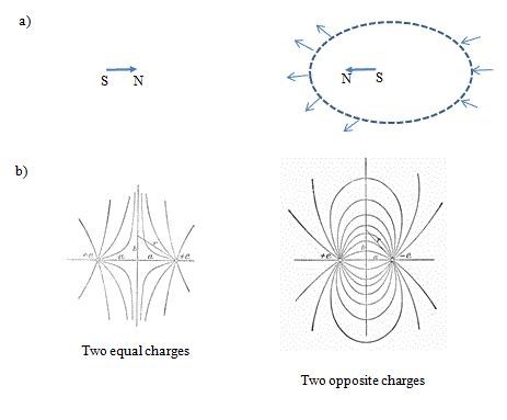

Maxwell's Stress Tensor is a really good place to see how this works!
Let me quote the above link:
Maxwell Stress Tensor
Maxwell Legacy Concepts
First, the words. 'Stress' is usually used to signify the force or combination of forces acting on a system: for example, the weight of a roof pressing on the rafters below. Stress can be transmitted. The rafters press on the walls which in turn press on the ground. 'Tensor' is a mathematical object that obeys specific rules - I suppose all mathematical objects do. Tensors are the appropriate concept to use for some theoretical physics. A matrix with rows and columns of numbers laid out in a square is a simple form of tensor. Tensors transform from one frame of reference to another in well-defined ways and are particularly useful in embodying properties that don't change when frames of reference change. Tensors were launched into the front line of theoretical physics when Einstein realised that they were just the mathematical tools needed to formulate his General Theory of Relativity in the second decade of the 20th century. This was over 30 years after Maxwell's death, so Maxwell himself did not conscientiously phrase his discoveries in tensor form. Indeed, tensor calculus hadn't been described when he was alive.
Einstein found that the stress-energy tensor was the key concept that controlled 'the geometry of space-time', allowing the forces on an object to be calculated in the most general circumstances. The Maxwell stress tensor is the electromagnetic part of the general stress-energy tensor. It's not only relevant, however, in circumstances where General Relativity is significant but in all problems where electric or magnetic force and related issues are important. In short, it is a mathematically concise and convenient way of expressing how electric and magnetic fields transmit force. The price to pay for this elegance is the requirement to know how to manipulate tensors.
The components of the Maxwell stress tensor as formulated in Wikimedia. Its elements form a square array labelled by i and j that each refer to x, y, z directions and are defined in terms of the components of the electric field E and magnetic field B.  ε0 and m0 are constants in Maxwell's electromagnetic theory, in modern units.
Technical detail
Maxwell has a chapter (no. XI) in volume II of his formative work A Treatise on Electricity and Magnetism entitled On energy and stress in the electromagnetic field. I suspect few people read the Treatise these days, just as few people read Newton's 'Principia', though Maxwell's work is full of insights. He writes the stress in long-winded form and succinctly in quaternion notation, another mathematical concept that needs background familiarity. He points out that stress in general has four consequences, which he quantifies. The first is a pressure in all directions (like that experienced below the surface of a liquid); the second is a directed tension (like stretched elastic - he gives more details); the third is a directed pressure (ditto); fourthly a couple tending to twist every element of the substance (ditto).
Near the close of the chapter he comments: In explaining the electromagnetic force by means of a state of stress in a medium, we are only following out the conception of Faraday, that the lines of magnetic force tend to shorten themselves, and that they repel each other when placed side by side. All that we have done is to express the value of the tension along the lines, and the pressure at right angles to them, in mathematical language, and to prove that the state of stress thus assumed to exist in the medium will actually produce the observed forces on the conductors which carry electric currents. ... We have merely shown that it is possible to conceive the mutual action of electric currents to depend on a particular kind of stress in the surrounding media, instead of being a direct and immediate action at a distance.
Maxwell tensor diagrams
Diagrams illustrating the use of the Maxwell stress tensor
This gets to the heart of Maxwell's vision. A current is passed through a wire and deflects a compass needle some distance away. Is this 'action at a distance' of the current in the wire? Well if you want to think so, you can, said Maxwell, but you will have a lot of trouble both visualising this and getting the right answer. Maxwell's view is that the wire creates a field everywhere around it (obeying his equations) and the field is stressed. Indeed the field transmits the stress between interacting sources, charges or currents. It gets more interesting. Fig. a in the diagram to the right shows another example: two magnets. Consider an arbitrary surface enclosing one magnet. The force it experiences can be calculated by summing the stress over the surface. Maxwell showed that it doesn't matter what surface you choose, which is a powerful result. (For the mathematical, this comes about by a smart application of Gauss's theorem that converts volume integrals to surface integrals). You can select one surface close to the body or one further away. In practice, the surface of choice is the one for which the mathematics is easiest. Not only that, the problem has been reduced from a problem in electricity and magnetism to one in mechanics. In Maxwell's day, the top physicists were probably better versed in mechanics than they are today, so it was 'problem solved'.
Another implied feature of the Maxwell view is once the field is known we needn't know any information about its sources. In the everyday context of radio reception, we're all extremely familiar with the idea now. Our radio or mobile phone has no idea where the sources of vibrating charge are in the transmitting aerial, only the strength of the electromagnetic field in their vicinity. For historical reasons I've taken the next two images from the great 'Abraham and Becker'. This book, or at least an early incarnation of it authored by Abraham and Föppl, published in 1904, is the one Einstein praised for the insight it had given him. Max Becker may not have been that pleased for he had several public arguments with Einstein over Relativity, which he did not like. The book ran to at least 14 editions under the title Theorie der Elektrizitat and had a lifetime of over half a century. The first image shows field lines coming from two equal charges on either side of the origin. Choosing a surface that is a very large hemisphere (b in the diagram itself) around one charge, the stress everywhere on the surface is a pure pressure (until it fades away in the far distance off the plane shown). Adding it up over the hemisphere the result is just the force expected from Coulomb's law. It is always encouraging to see a general idea give the right answer in special cases. The second figure is the case of equal and opposite charges. In this case the stress is pure tension and upon adding it up the answer is correct.
In many engineering applications, the stress created by magnetic fields is more important than the electrical counterpart. In a non-magnetic medium it consists of a tensile stress of B2/2μ0 along a line of force and a compressive stress of B2/2μ0 in every direction at right angles to the line of force. This is the stress Maxwell was discussing in relation to Faraday's work. Likewise the electric field causes two stresses. If D is proportional to E then these are a tensile stress of DE/2 along the line of force at each point and a compressive stress of DE/2 in every direction at right angles to the line of force at each point.
So powerful was Maxwell's idea of mathematically derived fields permeating all space that fields became the reality of 20th century physics. Einstein introduced the gravitational field characterised by its stress-energy tensor. Today's particle physics recognises a number of short-range fields, like the Higgs field. The characteristic of all fields is that anything that interacts with it, interacts with the field around it, not its source.
References: James Clerk Maxwell, A Treatise on Electricity and Magnetism, 3rd ed'n, Clarendon Press, Oxford, 1892. The 3rd edition is the most likely edition to come across and has been reprinted on at least 4 occasions. The original is out of copyright and a digital version can be obtained from several web-sites. There are 2 volumes.
Max Abraham revised by Richard Becker The Classical Theory of Electricity and Magnetism, 2nd edition 1950 (translation of the 14th German edition of vol. 1 by John Dougall), Blackie & Son, Ltd., London and Glasgow.
In this case, Bucking Magnetic Fields are a Stress Tensor, by definition, and as a result, the Stress creates a Force, a Magnetic Pressure Force, that gives rise to the Sawtooth waveform.
So we can shorten this us and say, Bucking Magnetic Fields creates the sawtooth waveform, so you're right.

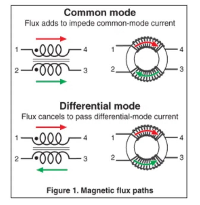

If POCOne and POCTwo both Oppose each other, then one MUST Assist the Input Coil Right! So, if we have Force A and Force B, both are Equal in Amplitude, but one is Negative, then the Vector Sum becomes Zero, no Net Negative Force can react back on your Input Coil because the Forces Cancel! Vectorially! Superposition!
Voltage is either: "Generated" or "Un-Generated", as in the case of the Common Mode Choke!
Voltage is "Un-Generated" by a controlled Impedance! Current through the Controlled Impedance, removes Common Mode Noise by "Un-Generating" the Noise.

Looking for guidance.....
Lately I have been making my test circuit a bit better, and improved my current sense setup.  My next area of investigation, is making power measurements to see what is going on.  I have been reading some of the threads on measurements.  I have everything dialed down while I am learning how to measure power.
A few months before I found AboveUnity, I was presented with the opportunity to purchase this DSO for a really reasonable price.  I always wished for one, but never worried about it.  And had no immediate use for it.  When I found AboveUnity, I knew what the scope was for!
I am thankful for being blessed.......

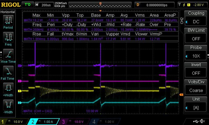

First real use of the DSO,
Yellow - L1 Voltage
Green - L1 Current (0.1 ohm)
Blue - L2 Lamp current
Pink - L3 Diode current

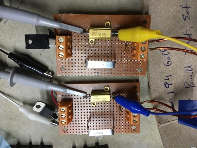

Current sense boards with 0.1 and 0.01 ohm resistors and a voltage test point.
Next step is to figure out the math on the scope for power measurements.
Any input is appreciated.
Donovan
Chris posted this 01 February 2023
Hi Donovan,
Where you show:
That's looking good, but you need more turns on your POC. This is to get your Voltage Up, as Voltage goes up, Current must also go up: I = V / R, if R stays the same.
Bucking Coils Pump Current from Source, the Atom, Electric Charge, being Electrons / Ions, and Current is the velocity of these 'Fundamental' Charges. As Voltage Potential goes up on your Partnered Output Coils, they work more efficiently.
Please Note: A shorter Sharper Input Pulse is also a way to get your POC Voltage Up! I have not yet covered this in great detail, only partially.
There may be a problem with polarity, the Blue Trace does not look right.
Also, The Input Coil is not quite right:
Try to improve there, because it should be sending power back to the Input. See the provided link.
donovan posted this 02 February 2023
Thanks for the input.  I will keep on it.  Tonight I re worked my transformer a bit, increased the turns on the POC.  I will test it tomorrow night.
I was looking at trace 3 as well, I was wondering if my diode speed is too low.  The trace is 100us per div.  I did notice in a previous experiment, the diode speed of L3/D3, did affect the rise time of the L1 current.

  • Why they have to Oppose using the Right Hand Grip Rule.
  • Why the Currents must create Opposing Magnetic Fields.
  • Why the Magnetic Fields Oppose.

donovan posted this 05 February 2023
Looking for comments.
This forum is handy for keeping track of experiments and progress!  This mornings experiments:
I added more turns to my POC, so 72T on each now with 12T in my L1.  I added the 15000 uf, 1uf, and .1uf bypass capacitors at the MOSFET/L1 circuit.
Analyzing this scope shot, I have some ideas come to mind for the next experiment.......
Yellow - MOSFET/L1 Voltage.
Green - L1 Current
Blue - L2/Lamp Current
Pink - L3/D3 Current
I am finding a process for getting things "tuned".......I start with a low frequency/ low duty cycle......(I can vary the on time and off time independently)......Adjust the on time for a maximum pulse width that allows for a continuous rise in current.....then raise the frequency to have the L3/D3 current approach a perfect sawtooth waveform.  The fine tune the On time to give a nice looking L2/Lamp current.  The fine tuning of the On time seems to have a great influence on the frequency/phase of the high frequency magnetic resonance.
Next I would like to try a High Side driver, exchange my L2/L3 circuits, contemplate the physical layout of my transformer and learn the math on this new (to me) scope.
I also thought I would sweep one of my current sense resistors with the Vector Network Analyzer.
Teal - Insertion loss (less than 1 dB below 100 mHz)
Yellow - Return Loss (Mismatch), (less than 10 dB below 100 mHz)
No funny resonances below 100 mHz, I think it is acceptable.
Donovan
Chris posted this 05 February 2023
Hey Donovan,
donovan posted this 09 February 2023
I am looking for feedback on today's learning.
The first four photos are VNA sweeps of the POC and one random coil for comparison.  I am approaching this with a background in RF.........
A random coil for comparison.  One point of resonance as indicated by the Insertion loss (teal trace) response, in the parallel resonance mode.
L1 response, two points of resonance on the Insertion Loss trace.......wasn't expecting this.....
L2 Sweep
L3 Sweep, ,similar to L2, I was not expecting this response, after sweeping a random single coil I realized, L2 and L3 are not identical.  If they were identical, the traces would be show a single resonance point......where here they show two......something for me to investigate.....my build quality, L2 influenced by L1.......I have seen this response lots in the RF world where we wish to increase bandwidth......coils in a a system have slightly different resonant frequencies.......but here, I think we want them to be the same.......
My latest experiment, a small but noticeable change.  I rewound L1 to have the same number of turns, but a higher inductance, and a looser coupling to L2/L3.  It appears this resulted in a more pronounced high frequency resonance, and a stable L2 current.  I am running into physical constraints as to how lose I can make the coupling between L1 and L2/L3.  But I will investigate on how to have L2/L3 resonant on the same frequency and at the same time try and have a loser coupling to L1, for the next experiment.
Donovan
PS.....After reading Chris's latest post about MOSFET Drivers, I think I also have to upgrade my MOSFET as it has a Vds of 200V and I think I am running into this as a limiting factor when it avalanches from the high resonant voltages.

Some more of my observations, looking for feedback.
In my experiments with the POC and trying to get more magnetic resonance and an improved saw tooth waveform, I noticed;
Before changes:
The saw tooth wave form had a rise time, regauging period, and a longer fall time followed by a "flat line" before the next regauging period.  The fall time and the flat line were about the same length in time.
Changes; I added about 25% to the number of turns on the POC.
I noticed the period of the flat line became shorter, so I have concluded the optimum turns ratio will give a better saw tooth wave form.
Thinking about this brings up a question in my mind, something to investigate at some point in time.......in this science, is there a relationship between core material and optimum turns ratio?  Or maybe, more than likely, the other way around, with the optimum turns ratio, we get the best magnetic energies, resonance for the core material......
Donovan

donovan posted this 11 February 2023
L1 = 12T, L2/3 = 60T.  L1 is one layer tightly wound on L2.
L1= 12T, L2/3 = 72T, L1 tightly wound on L2.
L1=12T, L2/3=72T, L1 = a 1mm layer of cardboard was placed over L2, and then L1 was wound using two layers of 6T to provide for a looser coupling between coils.
By increasing my turns ratio and having 72T on L2/3 it seems the deadtime prior to the re-gauging period has been halfed, comparing the first photo to the second.  I have tried a variety of frequencies, and that seem to have a minimal effect on this dead time.
By providing looser coupling of L1, in the third photo, it seems to have allowed for much more resonant voltages.
I am observing lots, and these experiments are bringing back a lot of the stuff I had seen in the RF world.  I sure hope I am sort of headed in the right direction.
With the wire gauge I have used and the coil forms, I am at the limit of how many turns I can put on.  I think I may get another coil form and use thinner wire to allow me to experiment more with the turns ratio.  Or, first, maybe I will reduce the turns on L1 and see what effect that has.  And as well I will switch to a higher voltage MOSFET.
Donovan

donovan posted this 16 February 2023
All the info from everyone's experiments is good.
And yes, sometimes we make things too complicated!  And I think we need to keep in mind......when this technology was discovered by people like Hendershot......they had almost no resources compared to what we have......
The last couple evenings efforts involved, beefing up my MOSFET wiring, rewound L1 with heavier wire, changed my L1 current sense resistor to a 0.01 ohm, made all my diodes the same, and added a diode across the MOSFET.
It was getting late.......but.....
I now see a negative current pulse on my L1 current sense resistor, it is narrow, but a very large amplitude.
Donovan

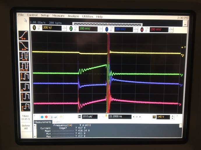

donovan posted this 19 February 2023
I have been spinning my wheels here, for a couple days......then this morning I figured out I had a shorted D2.
So, I am looking for comments on the latest waveforms......
Yellow, L1 Input Voltage from low side MOSFET Driver
Green, L1 Input current. 0.01 Ohm
Blue, L2/D2 current. 0.1 Ohm
Pink, L3/D3 current. 0.1 Ohm
Donovan
PS......one thing I am curious about is that small falling spike, about 1 uS before the large current change on the second photo.....
Chris posted this 19 February 2023
Hi Donovan,
Can you explain this:
I have no idea what you mean by this, it is supposed to be shorted, so you have made a statement that makes no sense?
Your Waveforms have gone backwards, they are not as good as they were.
Perhaps you have not understood what was required? There is much more to this than what the average person can realise! Its very Simple, but only once understood!
  • Plasmonic
Hi Donovan,
These waveforms are heading in the right direction:
You need to stick at it and not change things, moving away from what you have achieved.
These waveforms are heading in the wrong direction:
These are just flyback waveforms and not right.
donovan posted this 20 February 2023
Tonight's experiments....
Yellow, L1 Voltage, low side MOSFET Driver
Green, L1 Current, 0.01 Ohm
Blue, L2 Current, 0.1 Ohm
Pink, L3 Current, 0.1 Ohm
I think I am back, where I was a few days ago.....
Thanks for all the feedback.
Donovan
donovan posted this 23 February 2023
Are the following wave forms closer to the direction I need to go?
Yellow L1 Voltage, Low side MOSFET Driver
Green L1 Current
Blue L2 current
Pink L3 Current
Any feedback is appreciated
Donovan
