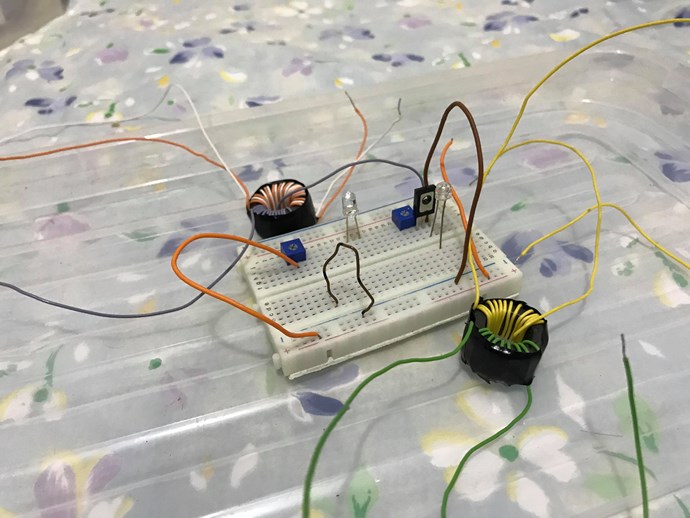

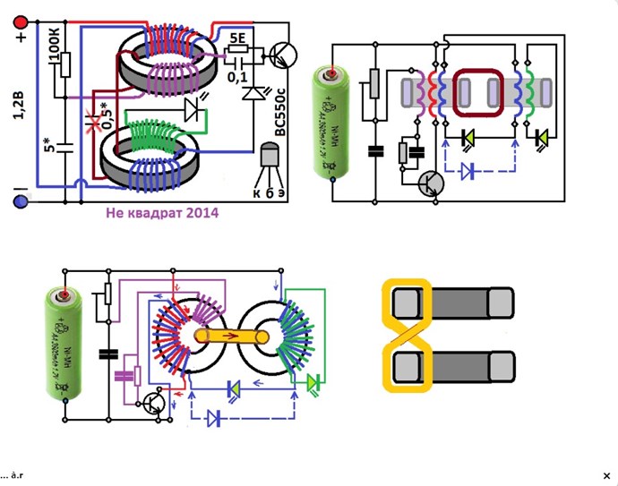

An easy to assemble circuit that works, I have tried it myself and it is stable and functional.
This circuit is not from me it is from a Russian researcher who introduces himself under the nick name of "not a square" in russian  'Не квадрат'' 'on this website you can talk to him.
https://strannik-2.ru/index.php/forum/prakticheskaya-elektronika/220-u-menya-interesnaya-skhema?start=1485
The circuit has been working for 5 days now and the voltage is very stable. Here is the circuit:
I admit that I am happy with the result and that the ferrite fuel is doing its job. This circuit deserves to be studied and developed.

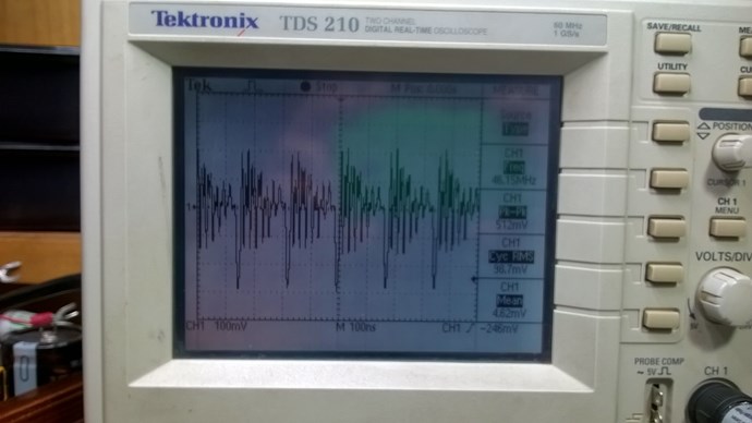

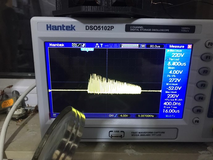

A view of the oscilloscope on the collector
I started at 2.3 volts and now after 5 days the circuit is stabilized at 2.457 volts

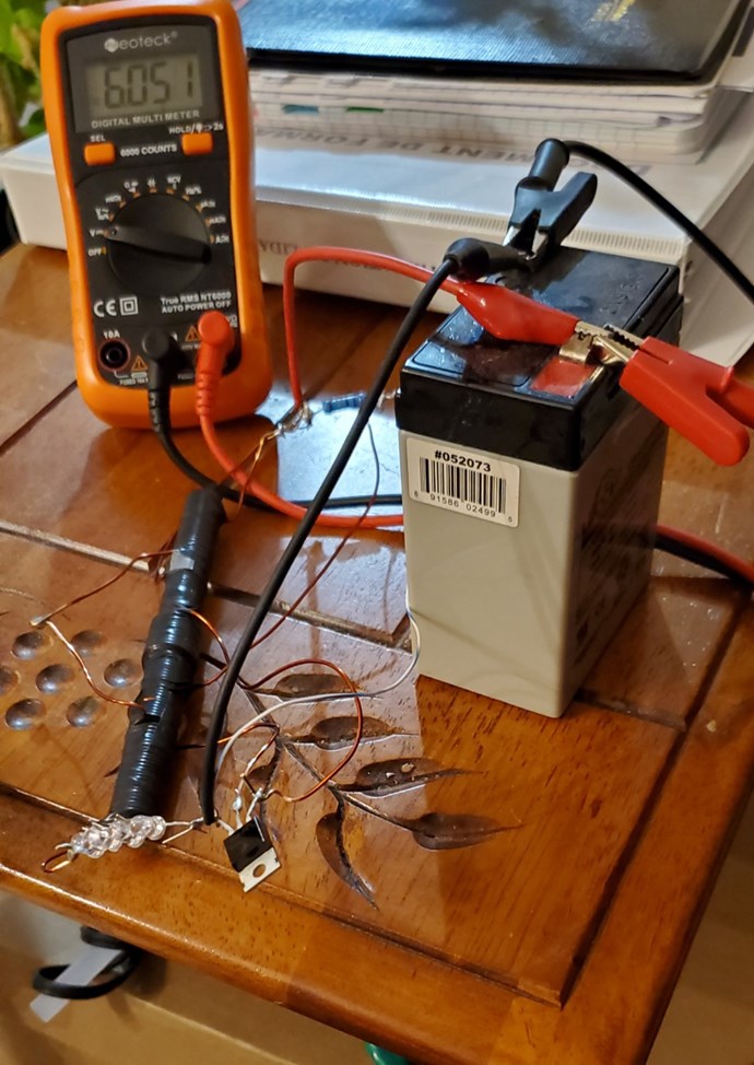

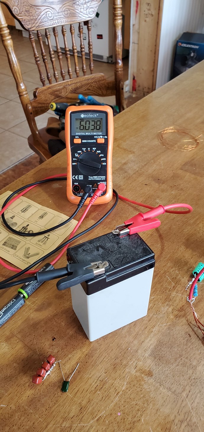

Wistiti posted this 30 September 2020
Hi Team!
After more then 2 days my 6v battery goes down to 6,048v. It is still over the 6,038v before running it at the beginning.
I will let it run to see if it continue to drop.
Thay here is the way i connect it.

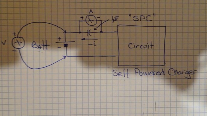

The best way without fear of doubt to affirm that the circuit charges
the battery would be the circuit in this image.

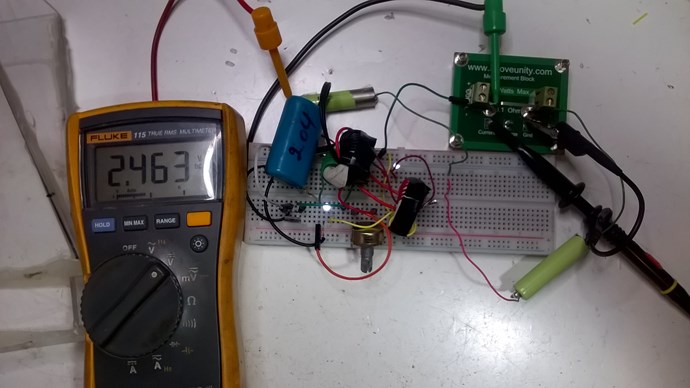

The next step in this wonderful little circuit is to find out what its consumption is in Watts and you have to bear in mind that this measurement is taken after more than 4 weeks of operation.
Using my DDM we can read a consumption of 4 milliampere or 0.004 A. and this on 2 batteries of 1.2 volts, which gives us a total consumption of 0.004 X 2.463V = 0.009852 watt or 9.852 milliwatts.
wth 2 463 volts
As the precision with a DDM is not as precise as with the oscilloscope here is a measurement taken with my oscilloscope.
taken through a precision resistance of 0.1ohm see mean voltage, we can see that the measurement is even more precise, 4.62 milliampere.
So now we have 4.62ma X 2.463v = 11.379 milliwatt
When you calculate how long with this type of circuit the two 1.2 volt batteries would discharge
Battery used 300ma 1.2 v X 2
you can see that after runtime of 64.56 hours or near 3 days later the batteries would be dead.
And this circuit is still working after more than 30 days and no sign of weakness.

Have you tried this easier to read diagram?
To help you try with a voltage of 2 batteries 1.2 volts at the beginning it is easier to debug.
With your images I may be able to help you better.

Jagau posted this 18 October 2020
Hi strape
as you can see in an image already posted on this thtead,
For Tr1 the bifiliar white wire, clockwise you have to adjust for your ferrite, between 6 and 8 turns
for  Tr1   the black wire counterclockwise 8 turns
for Tr2 the yellow wire clockwise goes to the LED and has 12 turns.
for Tr2 The green wire has 8 turns counterclockwise.
I hope this will help
jagau

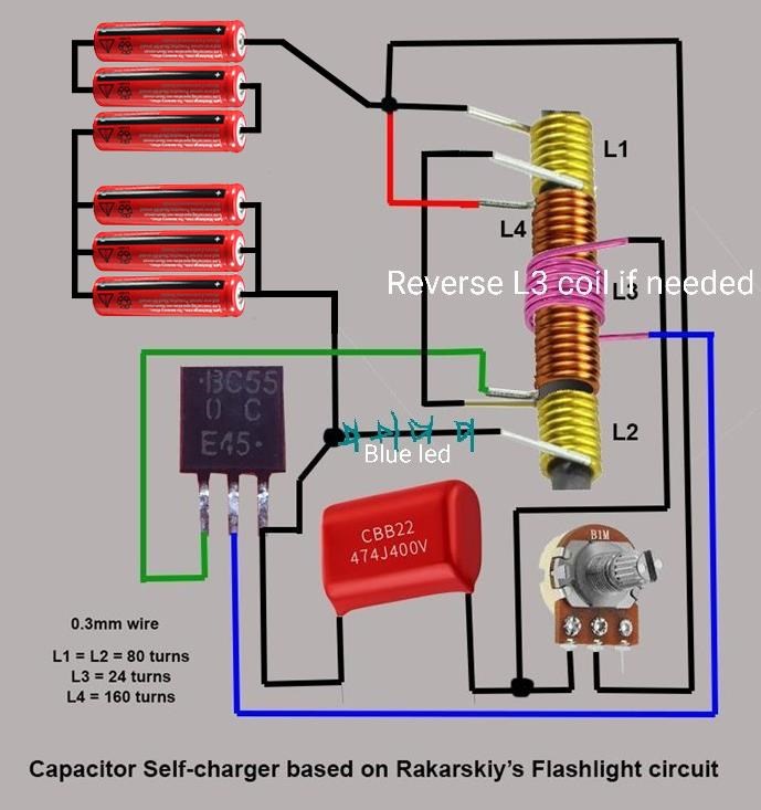

I built a second device with the same parameters as the first one and instead of AAA batteries I used a capacitor with the same energy in joules as the 2 batteries1.2v 300 ma.
It works, I have the same effect on my oscilloscope, but the capacitor discharge very slowly.
One observation, LED2 does not blink when I connect the capacitor and if I switch the batteries everything goes back to normal. Since a capacitor does not have the same internal resistance and does not charge and discharge in the same way as a battery the impedance Z of the circuit changes in the same way.
I am investigating the process that will allow it to operate with a capacitor.

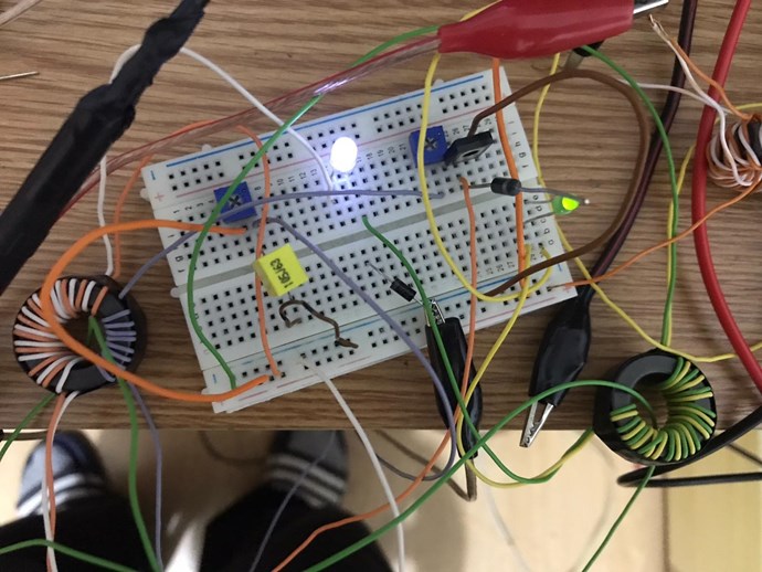

Mitza84 posted this 18 November 2020
this is my setup is not conected now i play for days but the voltage still drops slowly dont know why .
Mitza
Jagau posted this 18 November 2020
Hi Mitza

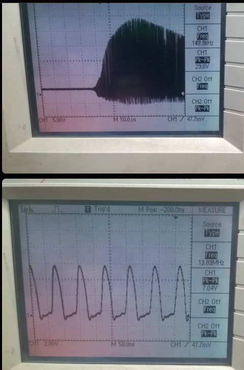

The circuit should be built like this:
Why do you have 2 potentiometers? only 1 in the schematic.
Did you forget the loop between the 2 ferrites? look at Yellow trace.
Hi Jagau thank you very much for the advice i put the loop also if i connect the loop in a way the consumption go high and if i connect the other way the consumption go down and the wave i am getting is similar to yours i will do it the way you showed me now and i will be back with news thank you again Jagau .
Mitza
i think i found the right pulse Jagau  the voltage is rising slowly for now il keep watching for now thanks for the help .
Mitza
Yes well done
you have the right waveform, I can predict a nice trip of more than two months with this setup, well done.
Another great achievement, you are a guy very attentive to details
And if you expand your waveform you should have like the lower one here
thanks for sharing.

Yes is the same when expanded many small like almost sinusoidal waves .

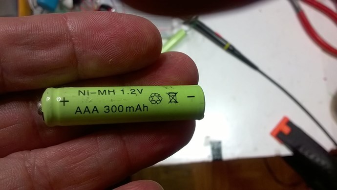

Hi Jagau i tried to push the circuit with two 1.2v 40mA small bateries from solar led lamp for garden but over night in 12 hours it drop from 2.6v to 1.2v because i wanted to see if is really charging ,on bigger bateries it last for ages from what i can see i put it on 1000 mA batteryes in the morning and it stayed at 2.5 v in 8 hours and is still 2.5v so did not drop but it has a consumption of 0.5mA from what i can measure in blinking mode for me . what i need to know from you is you keep on blinking mode or you push it a bit more to have constant light ? and for you worked on one battery or you use also 2 batteryes in series?  i will let it run with these 1000mA to see how long will last . And if you change the capacitance you can alter the wave by making it longer or shorter .i used 1uF and 2uF It goes well with bouth.
Mitza
Jagau posted this 19 November 2020
Hi mitza84

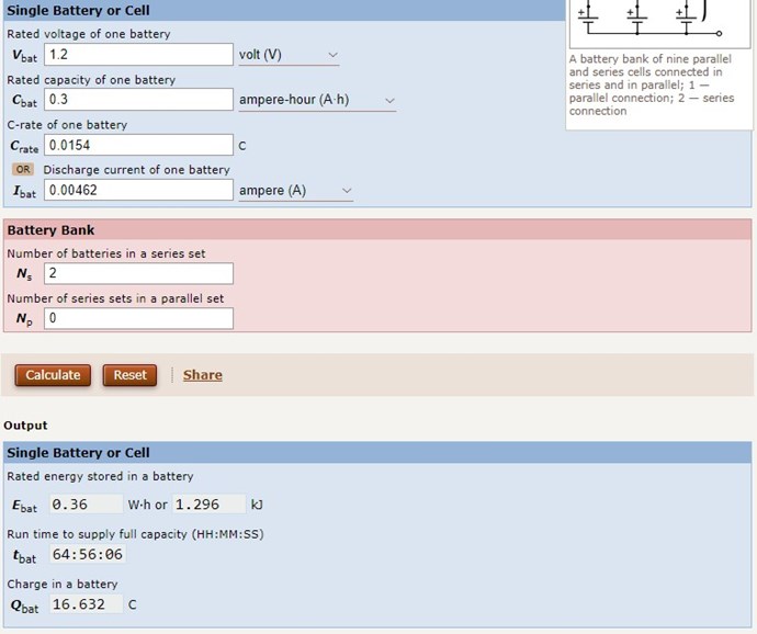

 First of all I use 2 rechargeable batteries 1.2 volts in series of 300mah for more stability.
The critical point of this setup is the pot adjustment.
When the batteries are charging at the beginning the 2 leds flash, the more the batteries charge you will then notice a slowing of the flashing until only one led flashes weakly and the other is stable. As you have the correct waveform at this stage your batteries will be fully charged.
Normally on a different setup other than that one, the batteries only last about 4 days according to my calculations.
Mitza84 posted this 20 November 2020
Hi Jagau ,yes you are right this is indid a very long runner .i will keep under observation longer time to see what happen .thank you for the infos. i hope i can make it on capacitors that would be really cool .but maybe you do it faster .
Mitza

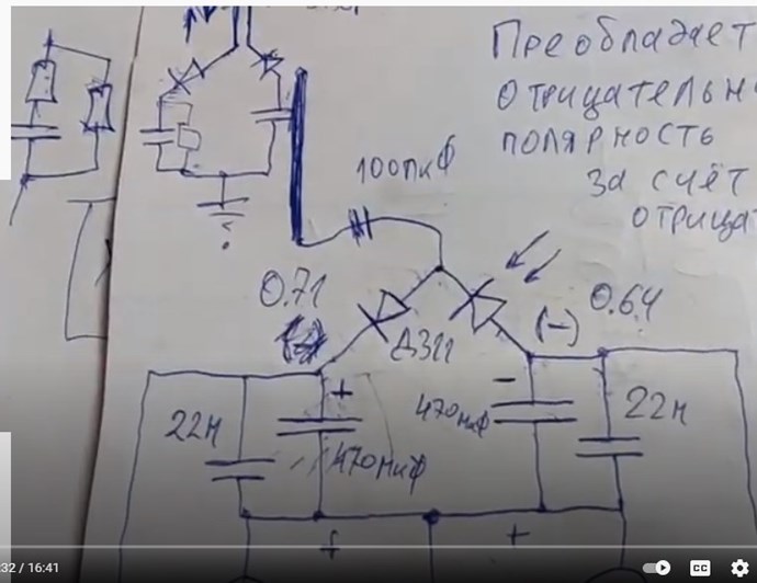

Here is some explanation about "добротность" (looks like is "Q factor" in english) of capacitors. He also do some tests. https://en.wikipedia.org/wiki/Q_factor
At 14:42 he concludes: "when we have a capacitor with so big volts hold/reserve, the capacitor's Q factor increases"
At 15:59 he says: "his (capacitor's) Q-fac looks like it is lower, but it is lower because we charged it almost near to his nominal electric potential (volts)."
Here is Akula's explanation at 0: 33:
Akula says: "Those capacitors that can perceive/catch/capture backward high voltage drop/peak(*оэдс), only high voltage ones are valid. So, 400v, 60v capacitors. Right now I have 63v one and it works fine. For selfrunning (catch voltage peak) those are better. Are better because those aren't paper made, those have bigger distance/space between plates. Those are capable to catch and charge with high voltage peak that are up to 50-60v, while those don't create additional load. All 16-35v capacitors are weak for this, those above 50v catch this backward peak better."
эдс = it is electromotive force
https://en.wikipedia.org/wiki/Electromotive_force
оэдс = not sure how to translate it in english, but it is backward electromotive force drop, looks like one from autoinduction.
