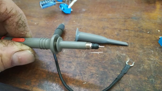

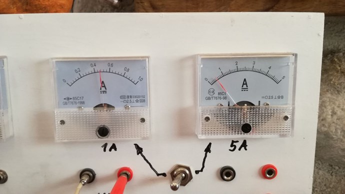

Hello Friends, It occurred to me to post some lines regarding the measurements of Devices under Test, and want to invite all who are interested to discuss in this thread opinions, suggestions, techniques of measurements. Most Researchers know that testing of in and output power, COP and efficiency is an important tool when working on AU Devices, but also that it can be very tricky to achieve really reliable results. For this reason it would be helpful to elaborate the best possible convention for trustable measurement techniques and practice. Vidura

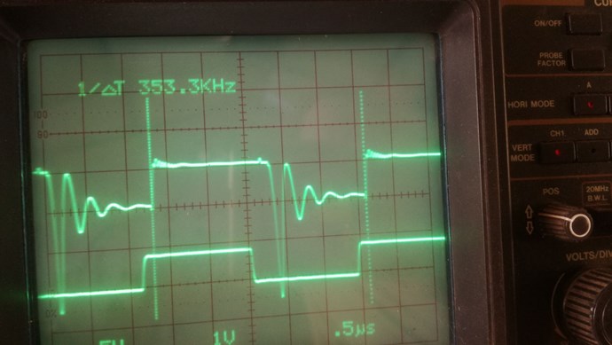

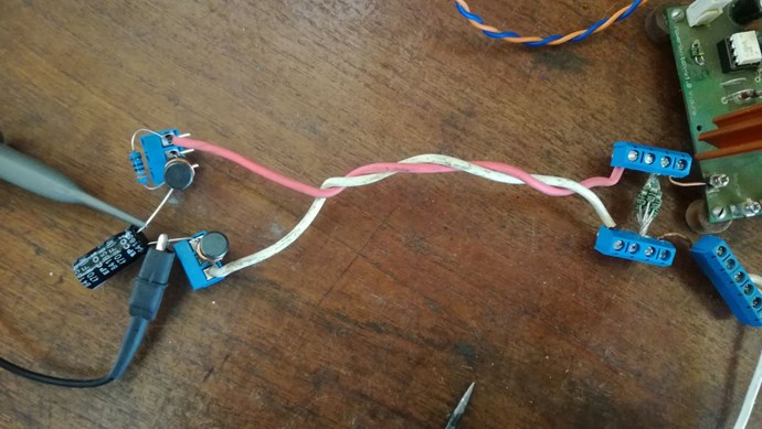

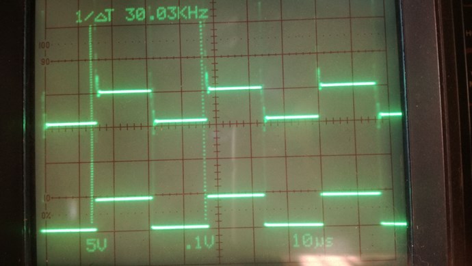

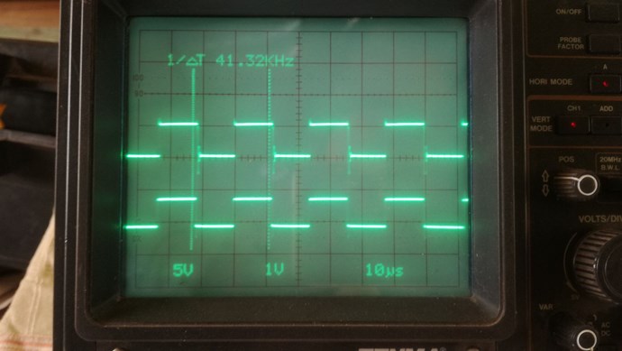

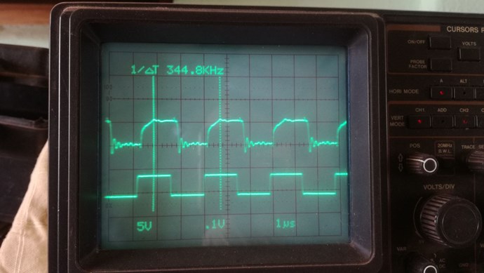

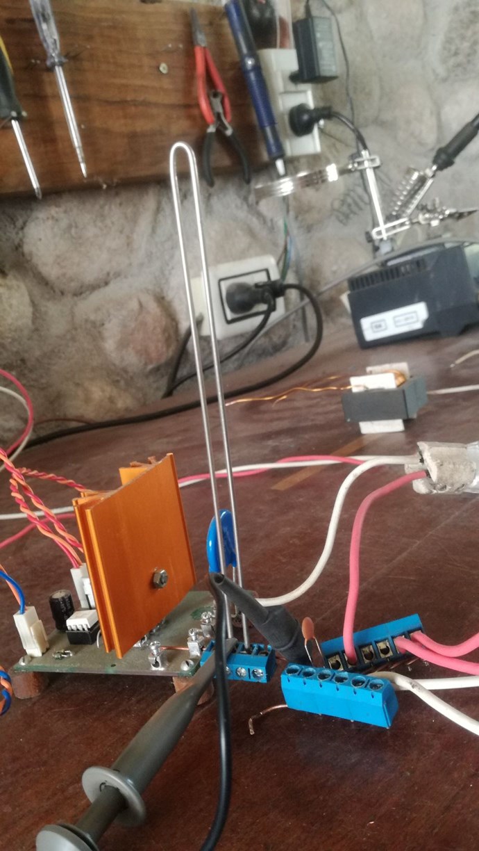

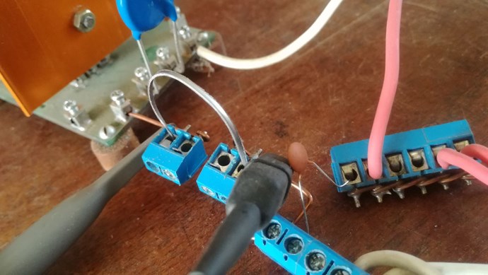

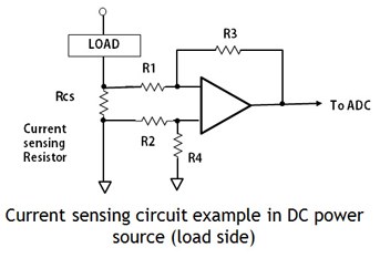

Vidura posted this 10 September 2019

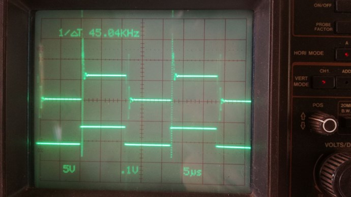

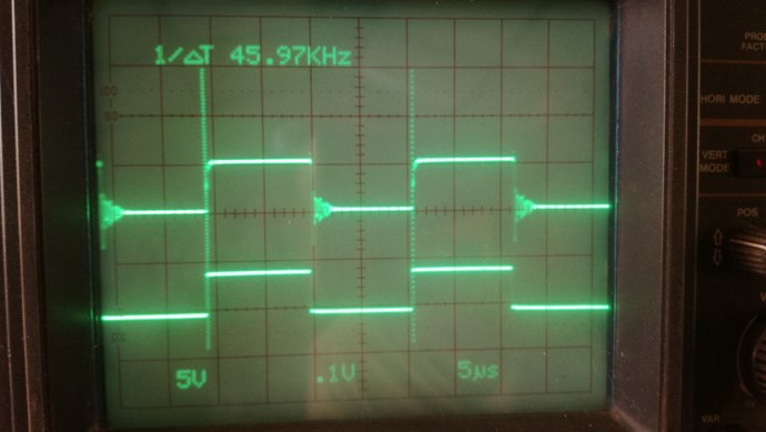

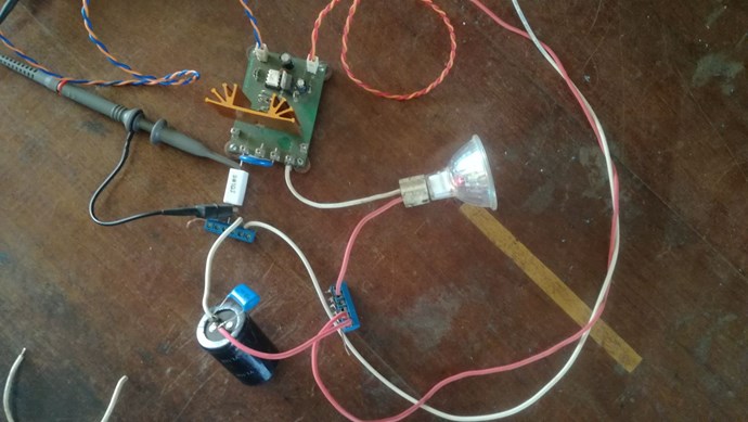

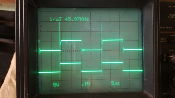

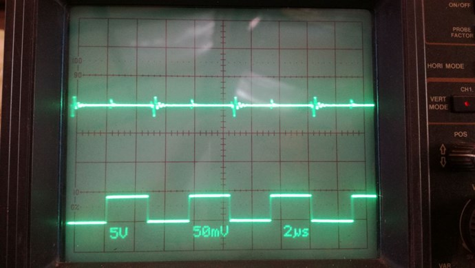

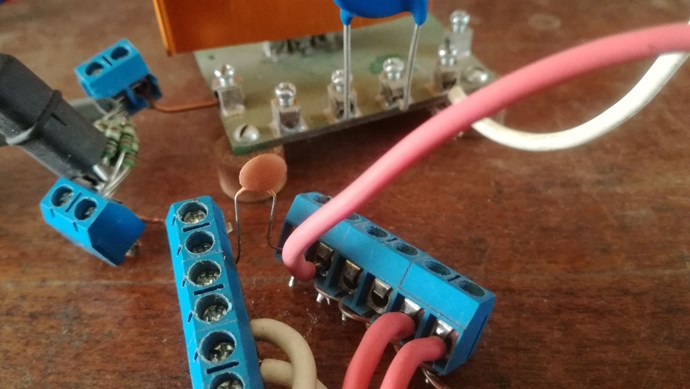

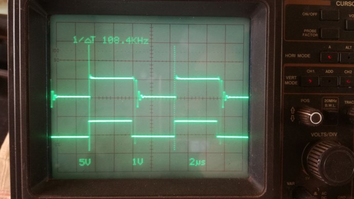

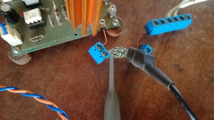

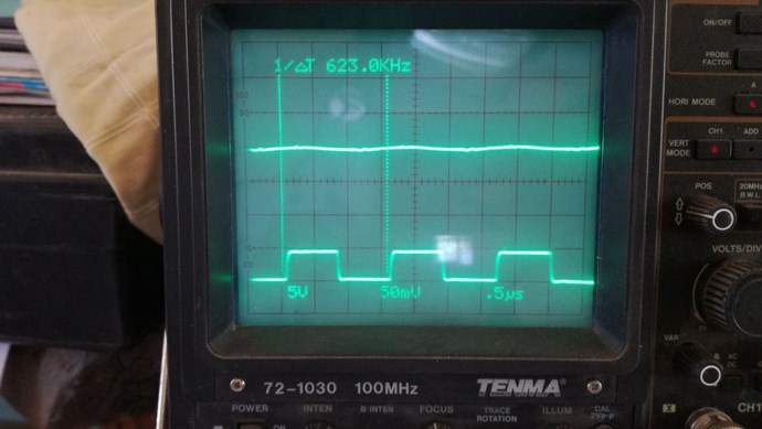

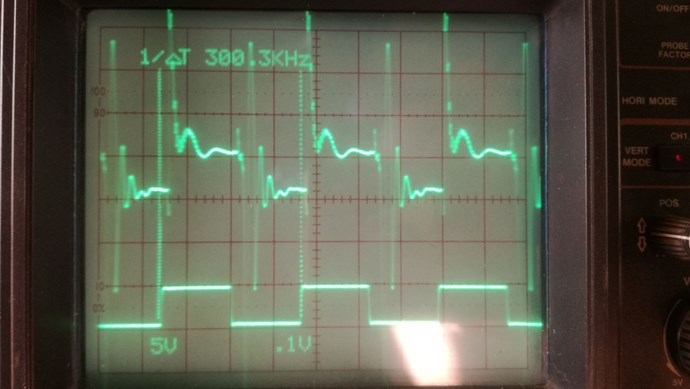

I have made a test of the simple circuit suggested by Chris, and want to remark a couple if things: in any circuit where a switch abruptly is turned on and off there will occur transient spikes, the magnitude depending on parameters like the parasitic inductance and capacitance , voltage , current and frequency. Note also that incandescent lightbulbs have a spired filament, which at high frequencies will have considerable inductance, and high power Leds have a lot of parasitic capacitance. One thing I noted , and can not be explained convincedly with the above mentioned influence, is that the shorter the duty cycle becomes the higher the switching transient spikes. I would guess that the ether environment is stroked harder by very short pulses, but this will be subject of another topic. here the video:
Atti posted this 10 September 2019
Vidura. Szép munka .
CD. Unfortunately, I have a similar problem.
Chris posted this 11 September 2019
+1 Nice Work Vidura! Yes spikes are inevitable, as you say parasitic Inductance and Capacitance is always going to be present, but CD's case is extreme  - Nice work Vidura, thanks for sharing!

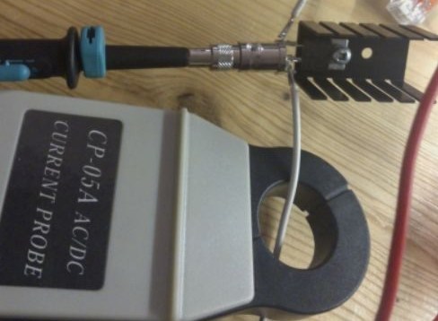

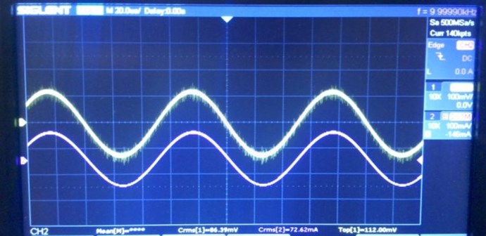

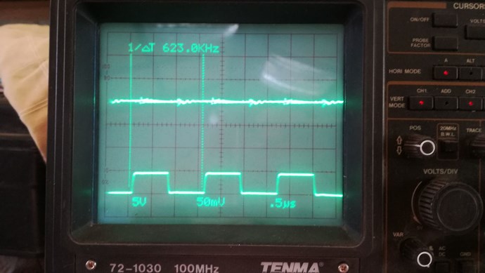

Vidura posted this 12 September 2019
Hello Friends,

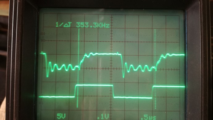

here i will post about an odd result when i was measuring the signal current feeding the opt isolated driver of the Power Switch Modules. In the video you can see the comparison when using the PWM module and then the SG. The scope probes are connected for voltage ch1 (5V/div) and current across a 1 ohm resistor ch2 (10mV/div). the frequency is 30khz  50% duty cycle in both signal sources. Here is the Video:
If someone can check if other SGs also show the same effect would be helpful.
Regards VIDURA.

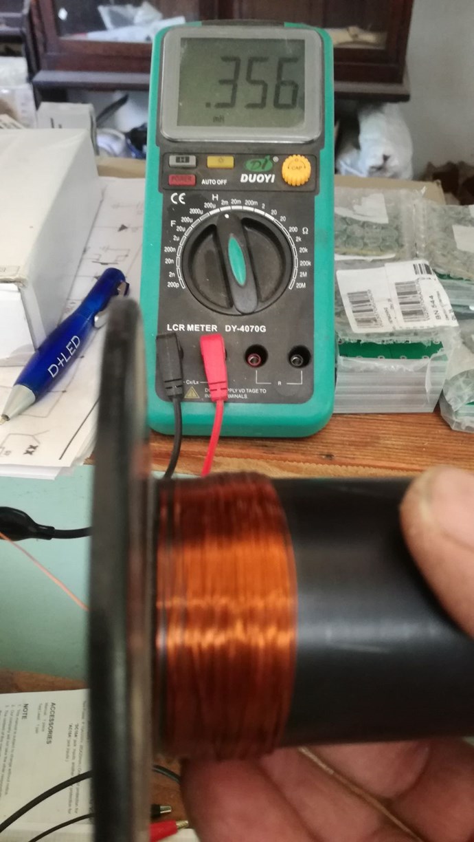

Vidura posted this 08 October 2019

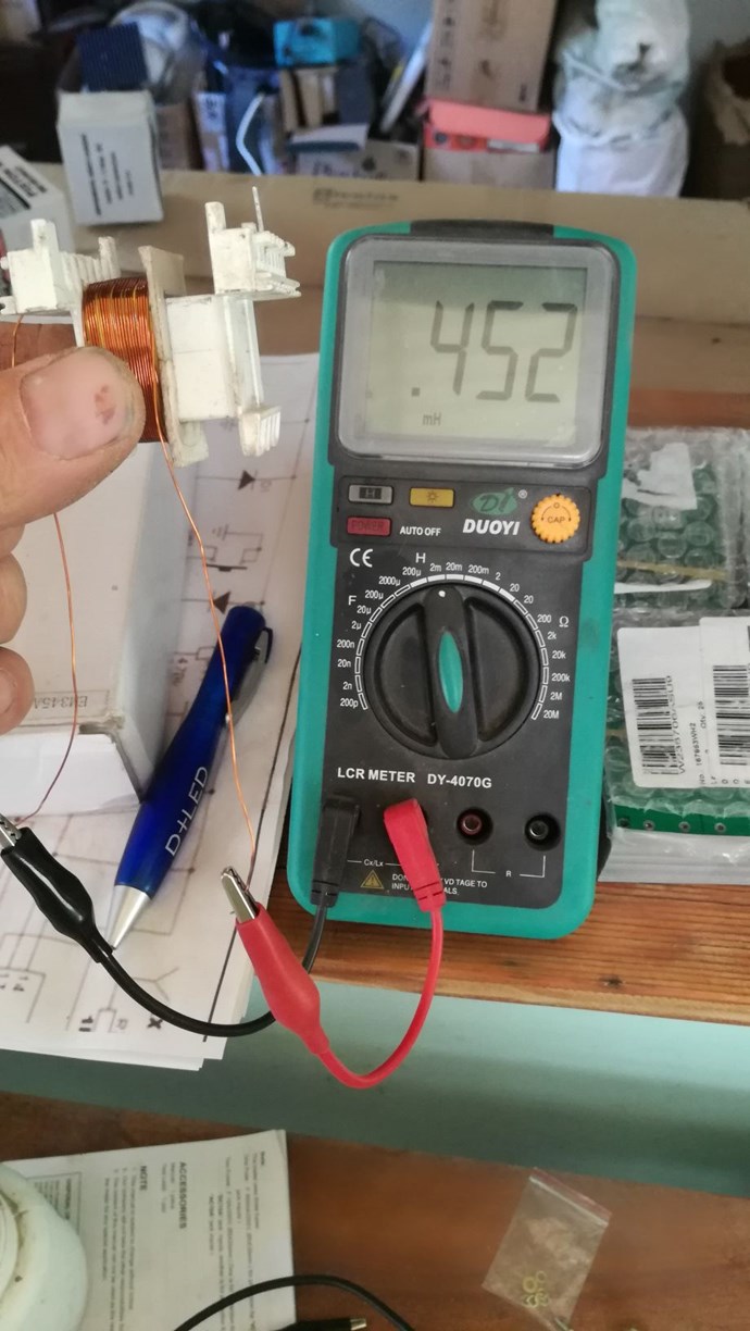

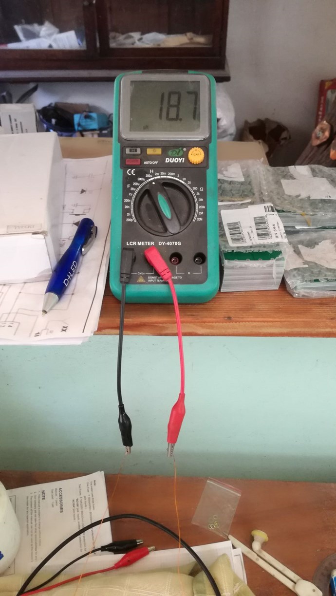

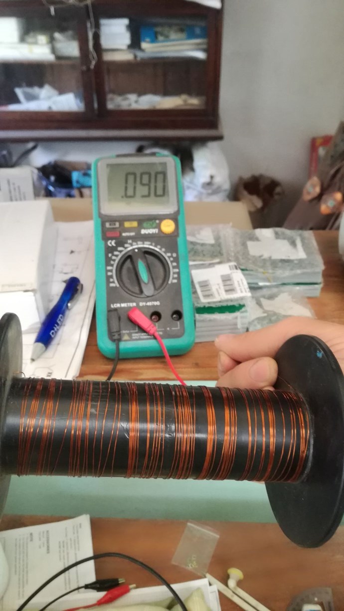

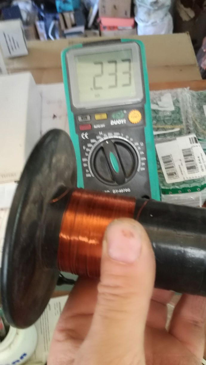

Hello Friends, I Wang to present here a simple test i did , maybe anyone can help to verify if we can trast the LCR measurements, or if this results can be bached up with calculations. I took a lenght of wire 12 meters and connected the inductance meter first with the extended wire:
reading 19,7 uH
then with 75 turns on a plastic former, in all tests the same wirelenght:
the coil is extended over 20cm lenght, reading:90uH
now the lenght is reduced to 4cm:
reading 233uH
the lenght is further reduced:
Reading 356uH
now the last on a smaller former with 145 turns in 6 layers:
Reading :452 uH
I did this tests just out of curiousity, but now i have some doubts on the measurements, or what formulas would mach this results,
regards Vidura
Jagau posted this 08 October 2019
 Hello Vidura
may be an answer to your question with exemple,
look at page 56 of the pdf published recently:
 The resulting inductance of a single layer powdered iron toroid can not be precisely predicted due to the effect of leakage inductance, (uncoupled flux). The further apart the turns are, the lower the resulting inductance will be due to reduced flux linkage between turns
Thanks Jagau, This helps, for air coils it seems to apply also. Vidura
Yes indeed Vidura
it is still a very good question that I had already asked and if it can help. I have read a lot of interesting things here.
I believe in this forum we can make good exchanges of ideas between each member.
I like this forum.

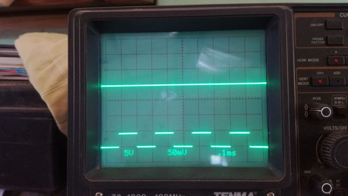

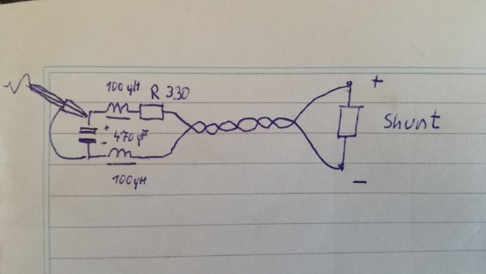

Vidura posted this 15 December 2019
Hi Friends Some thoughts about interferences and noise. Certainly All who do experiments can observe this phenomenon in some cases. How does this impact on measurements? As you might know i don't own a DSO, and my old ctr scope don't have math functions to make measurements of complex wave forms, so I can only use my common sense to evaluate the influence of interference, ringing and so. We can have the case of a "real" ringing in a setup or device, which would of course display actual voltage and current on a scope, and count as actual power. If this power can actually be used to drive a load is another question. But there's also another case, where interference appears in the measurement device, meters or scope, not displaying the actual behaviour of the DUT. I have many times observed that all kinds of digital meters became practical useless, due to interference. Of course a DSO should be mostly immune to this as it is intended bas precision instrument. I have noted that this interferences are special notable when we have devices which develope standing waves, or with partially saturated cores, shorted coils(also half cycle with diode), and hi voltage Oscillating E fields. In a conclusion of my experiences the analogue meters are the most trustworthy ( not the multimeters, the simple versions). It is a good idea to put them in series to the PS , so you always have a comparison and will nota mayor deviations immediately. For the moment I believe that a backlooped device is the best proof to be AU. Regards Vidura.

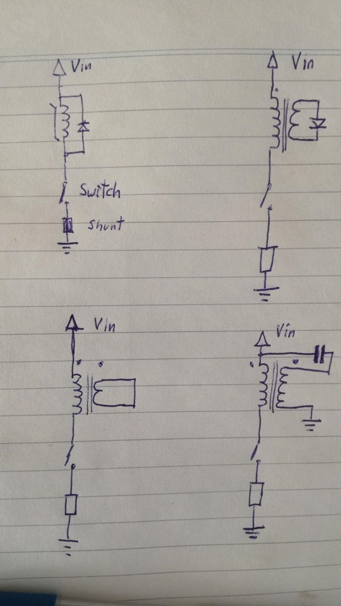

Chris posted this 24 December 2019

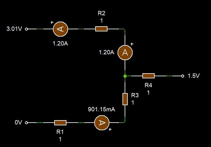

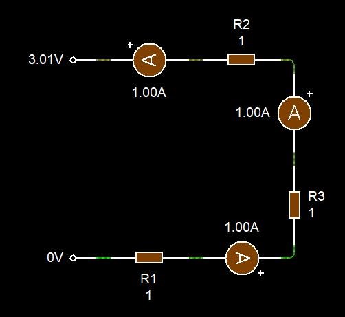

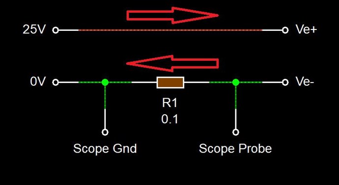

This post is in regard to recent posts on Fighters Thread, The ZPM, specifically the set of posts after this one.
I see a lot more confusion entering at the moment than is necessary! The introduction of Mains Metered, Low Bandwidth, Watt Meters and Input Power Circuitry was the topic.
No matter what the Circuitry is, in regard to the input Line and the Power Source, and as I said, the less the better, the circuitry will play a role in what occurs on the Input Side, being the Circuitry is Input side Circuitry.
Lets break this down to the most basic possible logic:
Your Input power Line:
NOTE: This is Conventional Current, we know the opposite actually occurs in the wire. I am showing Conventional Current so as to not confuse people.
Every single soldier, Charge, that marches up one Wire, must march back down the other Wire. Meaning Current, a bunch of soldiers
From 25V at the Top Left to Ve+, then through the load, not shown, and back again, from Ve-, Right to Left to 0V. Completing the loop. Not a single soldier is lost, with respect to the Circuit!
This is DC, or Direct Current. Directly from one Terminal to the other Terminal. If the Direction of this Direct Current Changes, and this Change is not a function of the Power Supply, supplying the Power, then some or all, or in some cases more soldiers march back the other way.
If 100 soldiers march the Circuit, but 10 come back, then we have not used the 100 soldiers, we only use 90 soldiers. We have a 10% return on our Input Power, not all Input Power is Consumed. This concept appears to be very difficult for many EE's to grasp! Current is NOT Power, but Voltage x Current in a DC situation, is.
E.G:
  • 25 Volts x 100 soldiers, or amps = 2500 Watts.
  • BUT, we had 10 soldiers come back!
  • 25 Volts x -10 soldiers = -250 Watts
So, we used 2500 + -250 = 2250 watts, 250 watts less than was initially thought!
IMPORTANT: Not a single unit can be lost, with respect to the Circuit, every single unit must pass through R1, the Current Sensing Resistor or CSR, sometimes a Current Viewing Resistor CVR. This means all Current from the Source to the Load, and all Current from the Load to the Source can be observed flowing through this CSR, R1.
IMPORTANT: The Bandwidth of this measurement system is only limited to the Oscilloscope and the Current Sensing Resistor you choose to use.

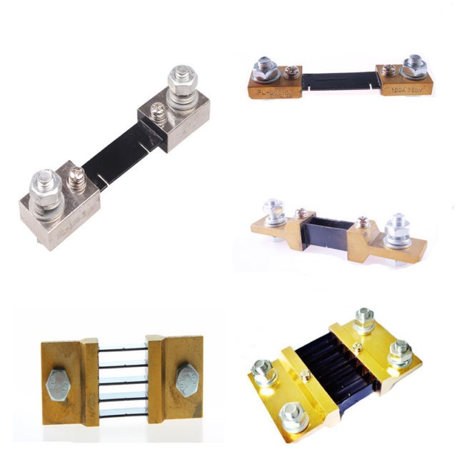

It annoys the length of the measuring resistor I use. That's why I'm buying a precision resistor. We'll see.
"Four-wire resistor optimized specifically for the small-ohmic range. Separately wired sense connectors avoid measurement error caused by transient resistors. Particularly useful in power electronics."
https://www.conrad.hu/hu/precizios-ellenallas-pbv-01-ohm-447331.html

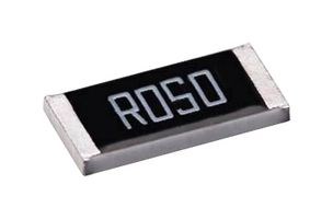

Chris posted this 19 January 2020
Atti is right!
A precision Resistor will be one of the best investments you can make! Get a 0.1 Ohm Precision Resistor, makes for easy Current Monitoring!
A precision Resistor, one with minimal Inductance, ±1% or so is important!

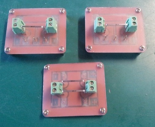

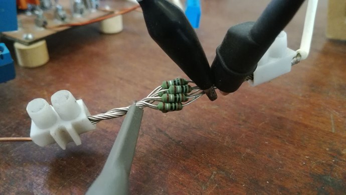

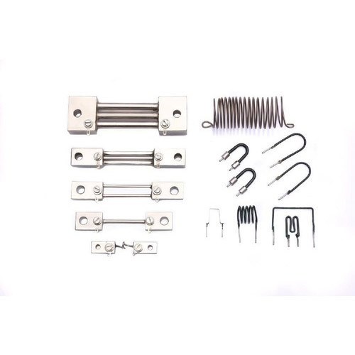

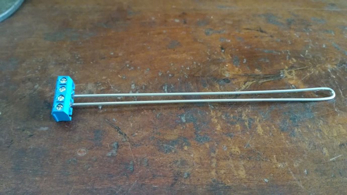

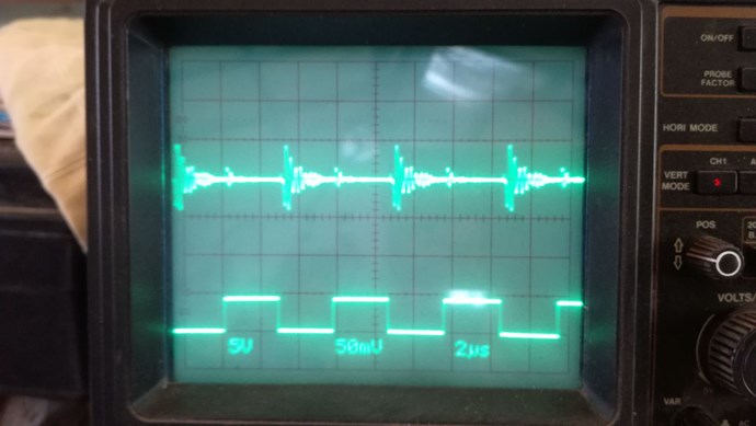

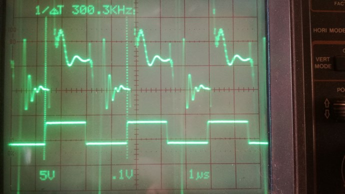

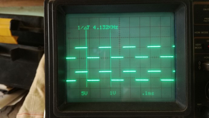

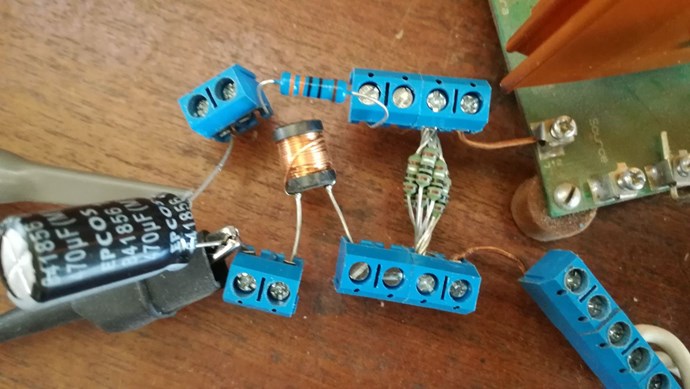

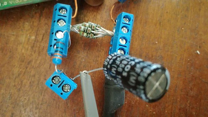

Vidura posted this 12 March 2020
Hello All!
this post in order to make you aware of the unusual behaviour of current shunts with a certain length, when tests are performed ,which involve partially or total core saturation. In some videos titled "the effect of core saturation " I have shown already this strange effects. I was not sure if it was something specific of the analogue scope , but lately I saw the effect on one of CD-sharps videos, on his DSO.
in this experiment he used as current shunt  two metal strip precision resistors series connected. I recently made a test  on a saturable device with this shunt:
and then y changed it for this bundle of 10  1ohm resistors(=0.1ohm):
Under "normal" conditions the stainless steel rod shunt is very accurate, but when a saturated core is present, it showed more than 5x the value of the resistor bundle. So when we are working with this kind of devices, the length of the shunt seems to be a critical factor. I also noticed this readings when I used a current transformer, but I have no data about professional current probes, as I dont have such tools. If someone has these, it would be interesting to make a comparison test , if there are inconsistencies.
Mostly I wanted to post this to avoid you to run in measurement errors, using for example the metal strip resistors, when there is a possibility to reach the saturation area of the core.
Vidura.
Chris posted this 12 March 2020

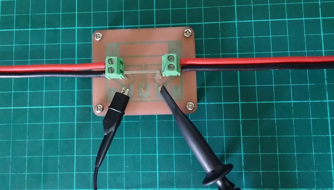

Vidura is right! There are plenty of things that can throw measurements off! Thermal Drift, to Stray Inductance, to a scope probe set incorrectly.
The Measurement Blocks I am selling use Industry Standard 0.1 Ohm accurate to 1% Through Hole Current Sensing Metal Strips, very accurate and very reliable:
These PCB Kits are the product of years of experience, a product of on going reliability. This method is one of the most accurate methods of measuring power that I have every used for the price. Other accurate methods can cost many thousands of dollars, I show in this video just how easy it is to use:
See the thread: Measurement Block PCB and Kit on E-Bay for info on how to purchase.
Keep your cords short, wires short and there is be very few problems you need to watch out for! Stray Inductance is one of the worst!
It is always good to test and verify what your'e doing, always calibrate your scope and watch for thermal drift.

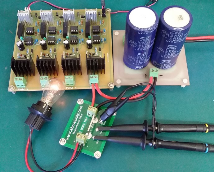

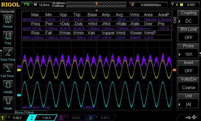

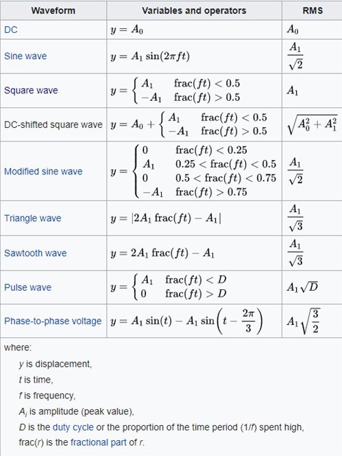

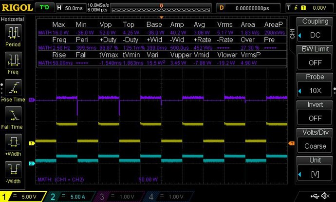

Chris posted this 30 August 2020
Some so called measurement experts call the old fake news line: "measurement error", in reality, they are mostly wrong and can not correctly and accurately call "measurement error". They just don't have enough data and experience to make this call!
NOTE: Run a Scope Calibration before running important Measurements: Utility -> Down Arrow  -> Self-Cal
Remember: Our Energy Machines are Non-Linear Energy Machines! They need proper protocols!
The following procedure is the basic procedure for the Rigol Oscilloscopes:
On the Output, RMS Measurements should be used. On the Input, Average should be used.
Mean is the same as Average.
Sampling, best to use the default: Normal,  or use: High Res.
Setup the Probe Units, set V and I for the probes. Then hit the Math button, go to Math, set A x B, set operation: On, then set Source A and B to the channels you have set.
Set V and I for the Probe settings. Current on 10x on the scope, and 1x on the probe, for Voltage 10x on the scope and 10x on the probe.
Now go to Measure Button, set Measure all: On, and go to Measure All Source, set Math as the measure ticked.
At this stage, you should have a scope menu and it should be displaying Math in purple. You should have three Scope traces, Chx, Chy, and Math.
Turn on your DUT, and tune, adjust the Time and Division scales to fit all trace data, take measurements, screen shotting the Menu onto a USB Key plugged into your scope by pressing your Print Button. Then upload to the forum, this will give you a complete screen shot of the Scope Display.
Basic rule of thumb, Mean or Average is Forward Power minus Backward Power = Mean used Power. Remember, if 1 Amp + -1 Amp = Zero Amps, so forward Power can be the same as Backward Power, meaning if all your Power comes back to you, then you have used no power!
On the Output, RMS is used, as all Power Out is Used, so no Power is going back to your Input.
I have a short video on how to take measurements using the Rigol Oscilloscope.
Note: I have shown the basic setup for most measurements, using the Aboveunity.com Measurement Block using a 0.1 ohm metal strip resistor.
Don't let anyone else tell you you are wrong! You must only measure Used Power, Returned Power is not Used Power on the Input, so you MUST use Average and not RMS!
On the Output, You need to use RMS and compare it to the Average!
The procedures on this thread are very important and need to be understood and followed to make Close Approximations!
It is very easy for Experts, to make wild assumptions and for those not skilled in the Art, to become confused, a tactic they rely on to dissuade others, thinking they have it wrong when they do not! Let no one tell you any different especially when they have Zero Real World Experience!
Only Aboveunity.com Members should be trusted in this Field! No one else!

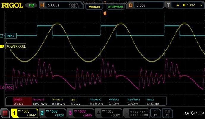

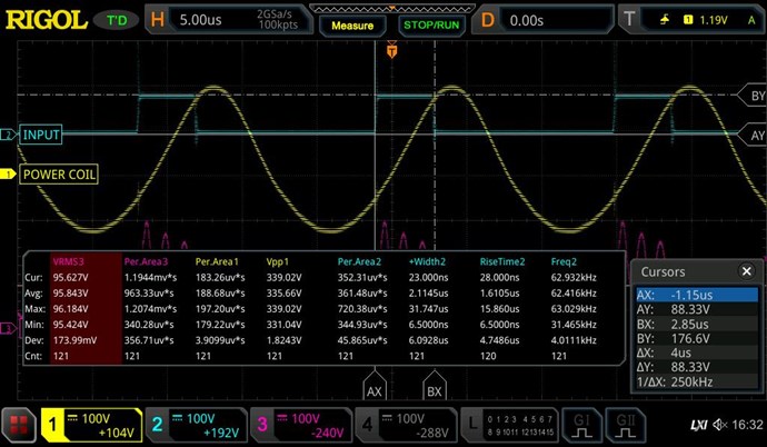

baerndorfer posted this 12 September 2020
hi guys, here you can see a measurement from MSO5204
Measurement Problem
you will notice, that the measurement for the pulsewidth is not correct. the device switches between nanoseconds and microseconds for some reason. the cursor measurement is correct.
what i want to point out is, that we should not fully trust our equipment it helps in many situations but only the operator who knows about how measurement is done correctly can derive meaningful theses out of it.
the next scope shot is for entertainment only...
greetings!
Jagau posted this 13 September 2020
Hi baern
Its look like what EEvblog spoke about this rigol model MSO
Known Firmware Bugs / Issues 11 Time base bugs
look here:
https://www.eevblog.com/forum/testgear/review-rigol-mso5000-tests-bugs-questions/

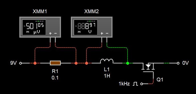

A simple experiment, lets see if we can take a simple experiment and learn something simple?
The Circuit:
The Scope Shot:
The Results:
The power used, is the Average: 3.06 Watts, but the RMS: 5.17 Watts, Power is a long way off!
Using DC, Switching on the High Side, and measuring the Input Power, going to the Resistor, or Globe, we see a massive difference! A difference that the other Forums have not even switched on to!
2.11 Watts of Error!
I have to say, the professionals that so many people have listened to for so long, over on the other Forums, are so far out of touch its just not funny! They are completely Wrong on nearly every aspect!
I hope all Aboveunity Members can now see why I have tried to tell everyone not to use RMS? When using DC, Switched, RMS is not sufficient to give anywhere near accurate measurements!
You must use Average, or Mean, on the Input!
The smallest Experiment can yeild the most important information!

Vidura posted this 17 September 2020
Hello All,

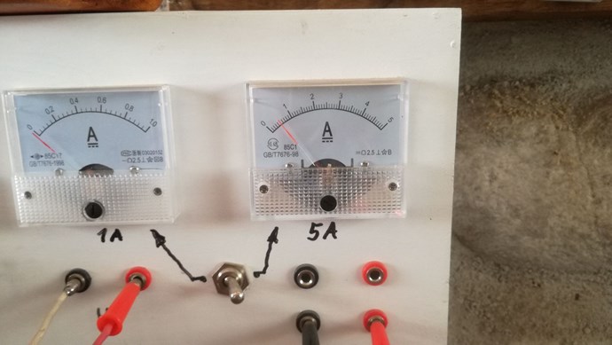

as there has been some uncertainty regarding the current measurements with the scope, I decided to make a series of tests with different shunts and test conditions. The circuit is simple, a low side switch, IRFP460 , a filament bulb 12V 20W, two capacitors on the supply line 10000uF + 100nF. PWM module set at 50% duty cycle.
the analogue Ammeter showed the expected average value of  1/2 peak current in all  the tests:
The first test is made with a wire wound 1 ohm 5 W resistor. I really expected a much worse result with this one, but note that the inductive part isn't significant as the "coil" has only 4mm diameter and 10 mm length, with bigger sizes we can expect more inductance of course. here the scope shots in three different frequency ranges:
above 30khz switching spikes appeared.
@ 100khz  notable ringing and large switching spikes
at 350khz ringing and alteration of duty cycle.
next tests with a boundle of 10 resistors 1 ohm 1%   equivalent  0.1 ohm
less ringing and smaller spikes
at 350 khz  also a lot of distortion and ringing, but I realized that a lot of it is caused by the parasitics of the layout and wires.
I added a 100 nF cap near the shunt and the signals improoved notably:
A selfmade SS rod shunt:
At higher frequencies unsuitable.
metalstripe 0.1 ohm:
conclusion, for the instance non of the tested shunts would give a reliable readings above 150khz, using the math function of a scope. will continue.

Chris posted this 17 September 2020
Hey Vidura,
My Friend, you are exactly correct! Thank You for Sharing!
For very low Resistance ( 0.001 Ohm or lower ), a Op Amp may be required, depending on how much Current the Resistor carries, as the Scope may not be able to accurately measure such low Voltage Drops:
NOTE: ADC is Analog to Digital Converter. A Microcontroller uses a ADC to read the Voltage Drop in a Digital Meter.
None of this is hard, if others that are not sure, just follow the advice of those of us, here, that know better and are trying to help.
Selecting a Resistance Value is important for the Range of Currents you expect, just as Vidura has said.
Your Guide is very valuable! Thank You!
raivope posted this 17 September 2020
For 0.001 ohm shunts, I have built, the op-amp must be chosen with very low offset error to have quality output. Plus and minus supply to op-amp must have good RC filter to avoid ripple noise.
(I used to build amp sensor plus multiplied by voltage we get power and power was forwarded (in range 0..5V) galvanically isolated to output where you can read with ADC or simply with panel meter. Usually I kept 2.5V as a zero centre to measure also negative range.)
Best,
Raivo
Vidura posted this 18 September 2020
Hello Friends,
In this post I will provide a solution for the interference issues shown in the last post. Note that this method is adequate (only) for quantitative measurement, that is for power measurements. It consists in averaging the signal from the shunt (for current) or from other test points (voltage). Note that this method will provide a clean signal, but will not account for the involved powerfactor. Thus it is suitable for resistive loads only.
Up to frequencies of 50khz we can do it as simple as this:
Also the analogue meters are very simple and trustworthy, if some decoupling capacitors are placed near the DUT.
In the following Images you can see how I developed a simple filtered circuit to make clean avarage measurements:
at lower frequencies the above circuit works fine.
But when we increase...
so i tried this:
Much better, but not good enough.
next step....
the result, at maximum frequency of the PWM:
the remaining interference comes from the conector of the scopeprobe:
removed the ground clip:
Now it is acceptable. I hope this helps some.
Vidura posted this 19 September 2020
Hello,
In this post I will address another potential issue on measurements , which you won't find likely on any other Forum. On order to establish a really complete and trustworthy measurement protocol we have to be aware of the following effect. It is not explained by conventional EM theory. I have already posted something about it, but can't remember in which thread. It is documented in the videos
and
I could observe the effect in the following circuits, it happens when the core goes in the nonlinear region near or beyond saturation:
 The most pronounced in the first one, where the core saturates always beyond a threshold duty cycle. In some cases it occurs only with a very fast switch, and the intensity might vary with various parameters. One most important is the physical length of the shunt, it's material and the distance of test point and scope ground connection. So here I have made a short video related to the effect on measurements:
Some recommendations regarding your measurements specially when in the DUT saturation or nonlinearity are likely: If you find some odd behaviour like currents against blocking diodes, or switches in off state, then check again using a different shunt, eventually carbon resistors, ensure that the scope probe is close to the shunt resistor(test point and ground, both).

In the following circuits, you can see the Voltage Drop across the Load and the Current Sensing Resistor:
You can see, with a 1 Volt Supply, with a 0.5 Ohm Load, we get a greater Voltage Drop across the 1 Ohm Resistor than the Load, this means, more Energy is being wasted in the 1 Ohm Resistor than is being consumed in the Load!
This Circuit, because we introduced the 1 Ohm Resistor is now Mal-Performing by a factor of: 2
This circuit is NOT being measured properly, because we have changed the Circuit by introducing 2x In-Circuit Impedance is not greater than the Load!
This Circuit, because we introduced the 0.1 Ohm Resistor is now Mal-Performing by a factor of: 0.2, an improvement of 10 times!
Now we can say we have reduced the In Circuit Impedance by 10 Times and also have a Circuit that is MUCH Closer to the actual way the Circuit is supposed to actually work!
It is Best Practice to measure a Circuit, with minimal Introduction of Impedances!

NO! You need to carefully select a Resistor to do the Job! The exact same waveform should always be available every single time between the Resistors, except for the above stated Resolution issues! If the waveform is in any way distorted, throw away the Current Sensing Resistor and get a Good One!
We have very carefully selected the 0.1 Ohm 1% Tolerance, Metal Strip Through Hole Resistor to accurately give measurements in median Current Ranges! Others can try to find fault all they like, but really, they just show how un-educated they are about such things!
A good Current Sensing Resistor should be nothing more than a piece of Wire of Known Impedance. Remember, keep all wire lengths short as possible! Always!

Chris posted this 21 November 2020
It is true, some totally ridiculous statements are being made over on one of the Other Forums. You know where!
I want to stress again, use: Common Sense
Take a length of Wire, 3 Centimeters, it has an inductance of 300 μH, we remove 2 Centimeters of Wire and replace this length with a Current Sensing Resistor, or Current Shunt, it has an inductance of 200 μH, which just happens to still give us 300 μH in Total.
Are we Better off or Worse off?
Neither! We have the exact same Inductance!
Some people absolutely Grasp at Imaginary Straws! Current Sensing Resistors come in all Shapes and Sizes, with many different Inductances and Resistances! Here are just a few examples:
If someone is Un-Educated enough to choose a Current Sensing Resistor that has a large Inductance in Applications at High Frequencies, then this is a mistake!
However, as already pointed out, if your Current Sensing Resistor has no more Inductance than a piece of Wire of the Same length, then you are ONLY going to have a problem if you have not followed advice already given, which is: Keep all Wire Lengths as Short as Possible.
It is a total joke, just stupidity, to make any wild claims of:
  • In Accuracy
  • Current Waveform Difference
  • Bad Data in General
Unless one has deliberately chosen bad Current Sensing Equipment! E.G: Wire Wound Resistor or similar!
It is obvious, the Current in a Circuit, MUST always be the same in the Circuit, the Entire Circuit, according to Kirchhoff's Current Law:
We simply can not read different Currents at each of the different Meters, or Nodes! That is, unless the Element itself is creating a Change in the Current! E.G: An Active Element!
Those people, out there, should know this already, unless they are Learning Impaired! Alas, they don't! And that's why you should not listen to them!
It simply can not be said, a Sense Resistor with the same Inductance as a piece of Wire the same Length will be any more problematic than the piece of Wire itself! That's just not true! Period!
The Comparison being made by these people is ridiculous:
All people with 5c of Common-Sense is not going to use L1 as a Current Sensing Resistor!
This Current Sensing Resistor:
Has: < 3nH that's less than 3 Nano Henry's of Inductance. Less than some pieces of Wire, the same length! See Datasheet Below.
We have covered this many times:
Again, do stupid un-educated things, expect stupid un-educated Results!
raivope posted this 26 November 2020
Hi co-creators!
I found an amazing solution for current measurement by testing different shunts, resistors(10x in parallel), current clamp.
Lets call it HF shunt (above) and the bottom one is 200kHz bandwidth clamp (realistically you can go to 20kHz where you start having a phase lag).
This HF shunt is virtually noise free and totally free from phase lag - tested up to 60MHz.
However, it will have some anomalous amplitude rise near 2MHz, so I would certify this shunt to have 1MHz bandwidth.
Only 3 pieces needed:
* Oscilloscope Probe, Passive, 150 MHz (run at 1:1) -  https://uk.farnell.com/testec/lf312/probe-oscilloscope-low-frequency/dp/220619
* BNC Coaxial, Straight Jack, 50 ohm  - https://uk.farnell.com/amphenol/b6251c1-nt3g-50/rf-coaxial-bnc-straight-jack-50ohm/dp/1111295
* Current Sense Resistor, 0.1 ohm, PWR220T-35 Series, 35 W, Thick Film, TO-220 - https://uk.farnell.com/bourns/pwr220t-35-r100f/resistor-power-0-1r-0-01-35w/dp/2101746
This Oscilloscope probe had special connector for BNC.
Here you can see the noise difference of this wire shunt you use and HF shunt:
My top:
  • HF shunt - 1MHz
  • thru the hole wire shunt - 200kHz - the same as 10x 1ohm metal-foil resistors in parallel (less noise than wire shunt)
  • CP-05A current clamp - 20kHz (good point to have it is low noise and galvanic isolation)
Raivo

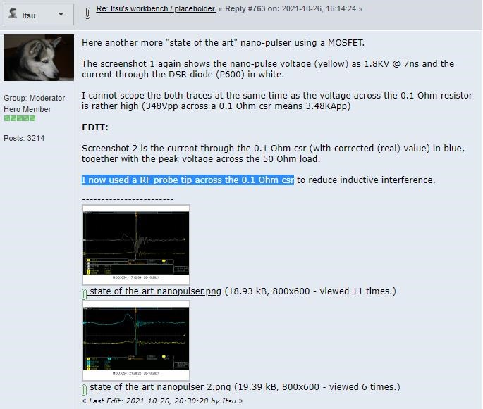

Chris posted this 27 October 2021
It seems Aboveunity.com's World Leading Measurement Techniques have now, all of a sudden, been adopted by others:
Ref: Itsu's "state of the art" nano-pulser
Those that used to try to call fault to Aboveunity.com's technique! Now use this very same Technique!
Isn't that Ironic! My how things have changed! Seems they have managed to pickup on Industry Standard Techniques, the ones we learned many years before!
If Itsu was measuring "Power", can anyone see a problem that Itsu would have in doing so? It is easy to spot!
Best Wishes and great to see the evolution of those that used to pick others work to pieces! See Here for details!

This thread covers in great detail, why we should not be taking RMS Measurements on a DC Input Power! I want to re-iterate this fact, because we have had a situation on Jagau's Thread, where RMS was shown on each Channel.
Exactly as Jagau said:
It seems misunderstood that when we are in the presence of different waveforms the way of calculation is different
Ref: Jagau's Advice for Measurement
RMS Can not be used because all power on the line is counted as Input Power, active Power, used Power and this can be very different from the actual situation!
Why is this important? Watch this video:
Here is an example of why it can be very different: Using a Non-Linear Load on a DC Power Source
EG:
  • 1.28 Watts RMS ⇐ Includes Negative Power: V x -! = -P
  • 0.0957 Watt's Average ⇐ Only the Forward Power, Active or Used Power. If Negative, more Power is going back to the DC Source!
Power Flow in a Four Quadrant Argand Diagram:
Its worth studding the Power Flow in the Four Quadrant Argand Diagram to see how this works. Again, Positive Voltage x Negative Current = Negative Power, Generator Mode!
Again, already covered, the V x I Power, if one does the math, can work out to be Negative, and RMS voids this Power! RMS Includes this power as Used Power when it is not!
Know what your Input is doing, and then you can make so much more progress! Ignore others that do not abide by Industry Standard Protocol!
We have the Best Measurement Protocols in the World! We are Accurate!
Bad or misleading procedure can cost you the Success you work so hard for, so learn Correct and Accurate Procedure, please!
