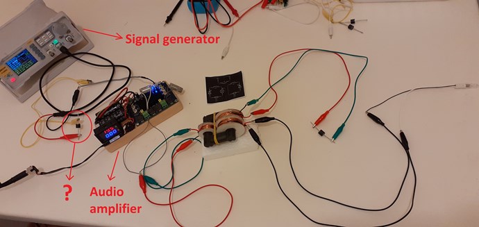

Hello gentleman. I am new here, and need help from you guys to make this little device work. I would only ask that builders with working devices respond (just as I would like to go to a barber that is not bald or take financial advice from someone that is not broke). Jokes aside, you can see my setup at the picture. I have several straightforward questions so please- concise answers only, no philosophy, visionary speeches and the rest.
1) The question mark on the picture. I don't have scope so I don't know weather my signal generator is outputting both positive and negative when I put it to rectangle wave form- this is why I put a diode at the output, to only get the positive "impulses". My question is weather the input should be only positive (swing the magnetic field in only one direction in the core) or both positive and negative (like a pure sine wave or any other wave form).

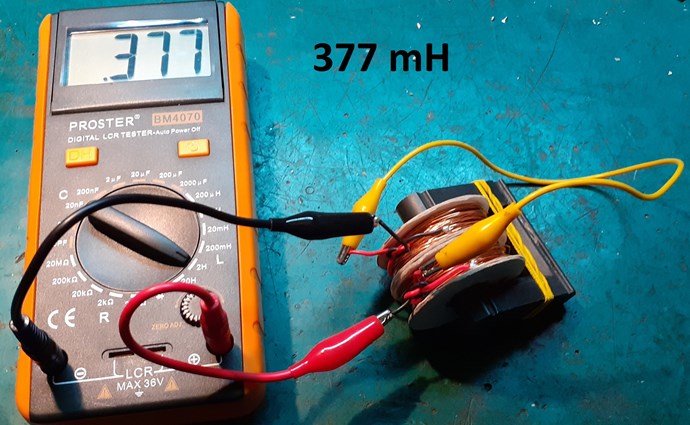

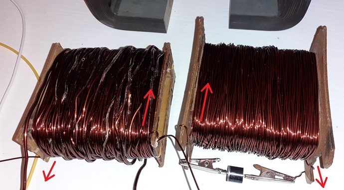

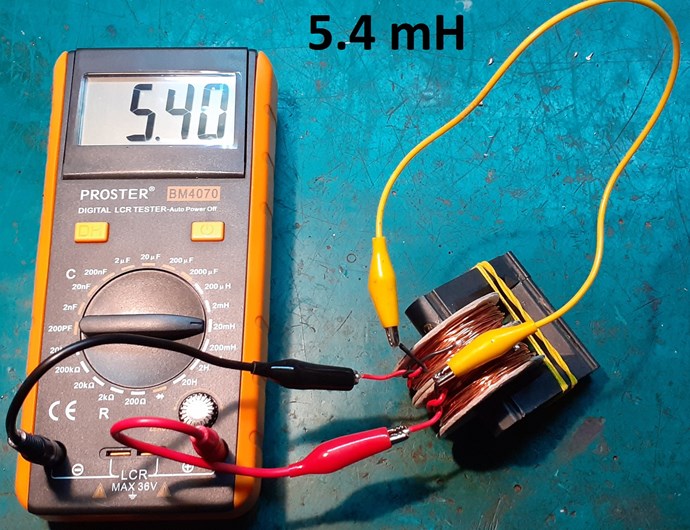

2) My partnered output coils are wound one clockwise, the other counter clockwise. My question is: what is the resulting inductance when in correct configuration (bucking mode) - smaller or larger inductance (first or the second picture)?
You can see that I use a small instrument to see the power draw by the amplifier - not the most precise way to measure input power, but good enough I guess. The load is a halogen 10 W (12 V) light bulb.
I can get the bulb to bright full power no problem, but it is a usual transformer effect. I have tried many combinations of flipping the coils, reversing the diodes, many different frequencies, duty cycles, and wave forms, and I have not seen a single anomaly, let alone over unity.
Please guide me in the right direction. The primary coil is 100 turns, and the secondary 300.
Also, I am honored to be here.

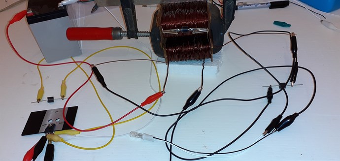

I have made a new transformer.
The POC each have 250 turns of 0.8 mm wire and are wound CW and CCW (as you can see on the photo). On top of the output coil (left in the picture) there is a 25 turns primary with 1.6 mm thickness (wound opposite to the POC).
I'm driving the 25 turns primary with 12 V battery and Mosfet that is switched from a signal generator (10% duty cycle and anywhere from 100 Hz to 3 kHz).

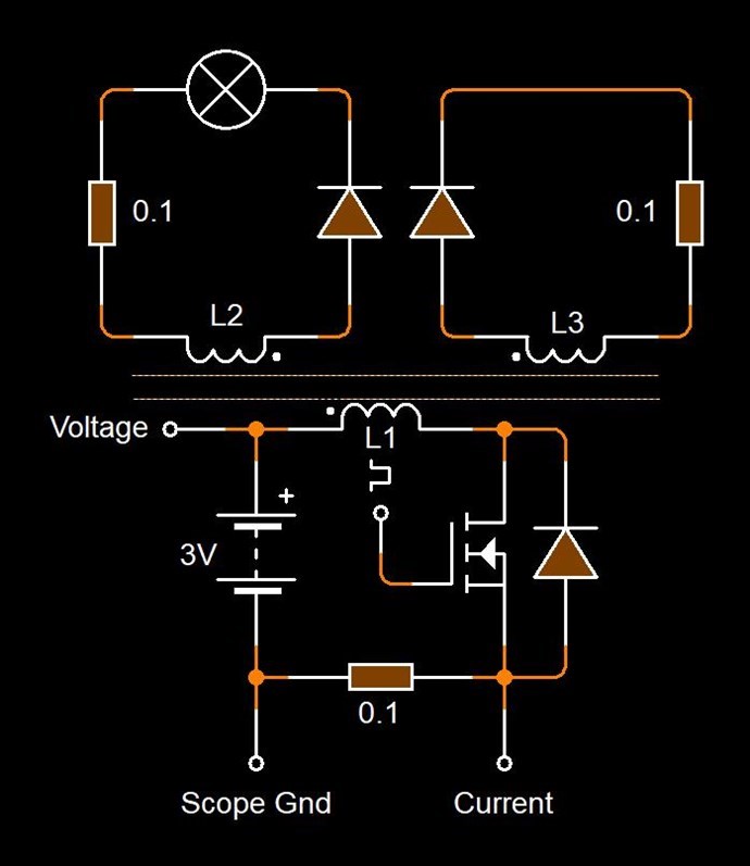

The configuration is the same as Chris's video 7. The upper coil on the picture has only a diode across it, and the bottom POC is the output with the bulb (12 V 10 W) and primary wound over it. I can't get it to light up. I've tried all diode configurations.
This is the schematics used.

Sorry for the late reply. I've been working on it for hours today, and have gotten some sort of linear triangle output on an old scope, but it remains the same when the upper coil with diode is unplugged. I'm so sad. I've rewound the thick wire primary in opposite direction, changed basically all the polarities and diode orientations possible and nothing. I've put a bigger load (less resistance) and I get no effects. Is it the core fault? Because it is not ferrite, it is from a standard 50Hz power transformer. I've ramped up the input voltage up to 60V and nothing. I've literally run out of things to do
Vidura posted this 09 January 2021
Hey fluktuacije, May I ask if you continue using the audio amplifier? If so , you should loo for a simple MOSFET switching device, the Audio amplifier is not suitable for this experiment, as it outputs AC. Try to always post setup, parameters, and eventual changes as accurate as possible, otherwise we don't know what you have on your Bench. It will be much easier to assist you. Also ascope shot is very useful , not important if from an old single channel scope, you can change the probe to different measuring points, and post an image of each. The core should not be a problem, John had good results with a silicon steel core also. Looking forward for more information , so we can help. Vidura.
