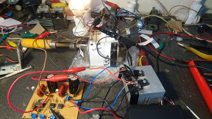

Hi Guys,

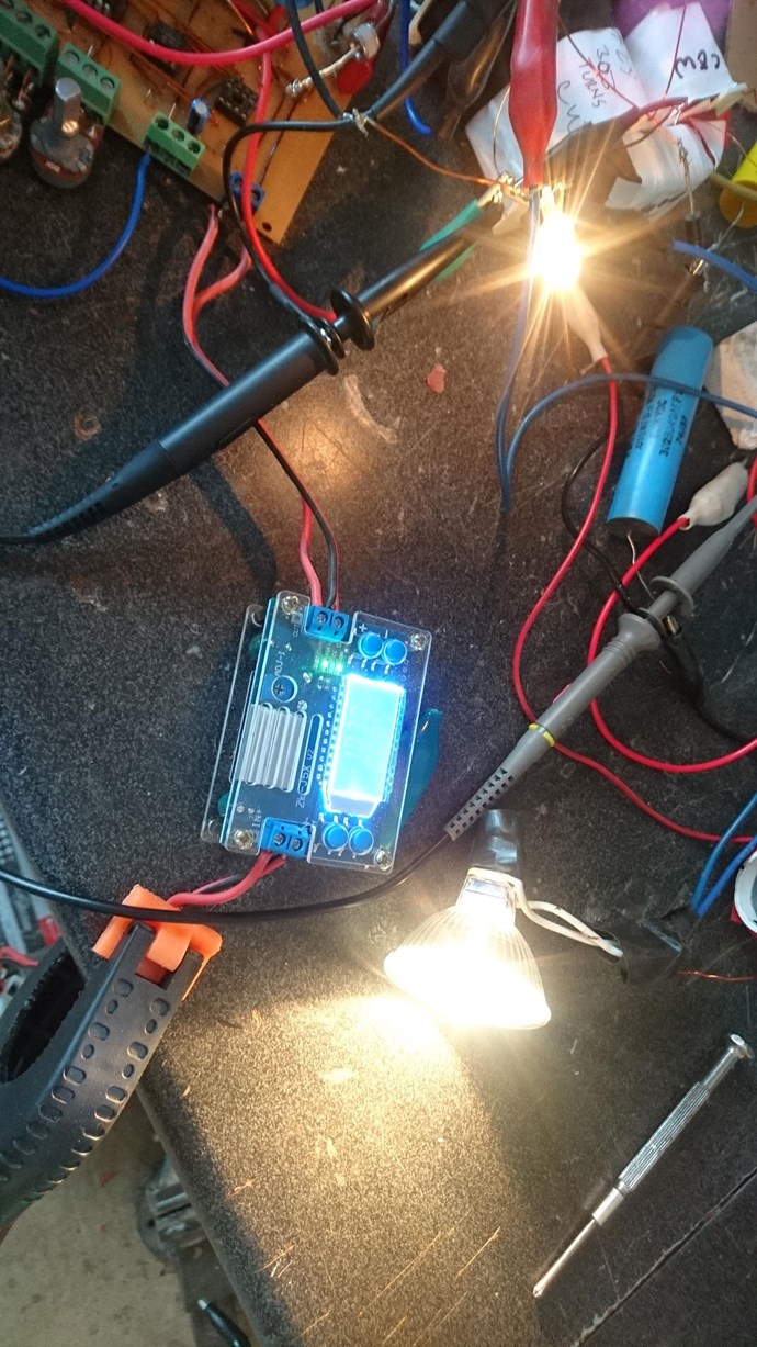

Still here! I am very busy trying to get my new house finished!. I use my small amount of spare time trying to understand what I am doing with the Flyod Sweet circuit.

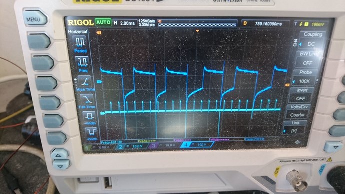

I have attached two photos to show where I am at. This is the best result I have acheived so far. Two globes at around 60% power. However if I cross this with a low wattage 12v 5 watt globe, the 12v globe takes over and I lose the large globes! Anyway, I have an AMCC 320 core. I have biflar wound 214 turns of #20 as secondary windings. I have wound two CCW primary windings #23 50 turns. Best response is low frequency, around 200hz, varies slightly. I am bucking these two secondaries together. I have the primary coils in joined in series and pulse these simultaneously via each input end and use centre back to positive. Voltages are 12v. I have set up two isolated input voltages. One for the mosfets and the other for the pwm circuit. I am using assr1511 optos, which are ss relays, to drive the mosfets. If I set the voltage to 24v for the mosfet output to the coils, they blow almost immediately. I have pulse set at 10%, and I am using GDT's for the earth return from the primaries. They show a purplish color when firing. So I get the idea I am on the correct track.
This is not a final outcome test project. I am looking at the best method to drive a similar set up with HV pulses.
The two photos, one layout in action, the other showing the output of the bucking coils and the corresponding regularity of the drive pulses. It seems to me that three of the pulses are wasted. However, if I reduce the pwm frequency I lose the output. One final observation. At 10% duty cycle, and low current, my mosfets are still progressively heating up.
Thats it for the moment. My next move is a couple of set-ups for HV.

Chris posted this 21 September 2020
Hey Ourbobby,
Nice Work! Thanks for sharing! You're on the right track! Study Coil and Interactions and work to improve on this.
An External magnetic Field influences the Electron (tiny magnet) in the Conductor in the region of this Magnetic Field.
Study these very same effects in the "Generator" or the Conventional Transformer. There is always Symmetry from Rotor to Stator, or Primary to Secondary! There does not need to be!
Thanks for Sharing!

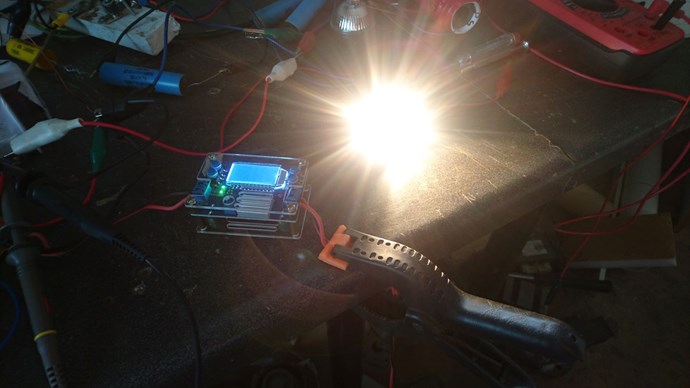

Ourbobby posted this 04 October 2020
Hi guys,
             Latest update! Have the ground capacitor working. Very noisy. However, my multi-bank capacitor is giving me lots of trouble. I am using 1kv metallised caps, and i am constantly having to replace one or two after running a test for a few minutes. This is the charge capacitor, which is pulsing through a GDT through the HV coil across the FLoyd Sweet experiment to the earth cap. Have been unable to prove anything, other than my earth capacitor is working! Maybe I shall have to build a mica capacitor and immerse it in epoxy.

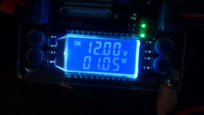

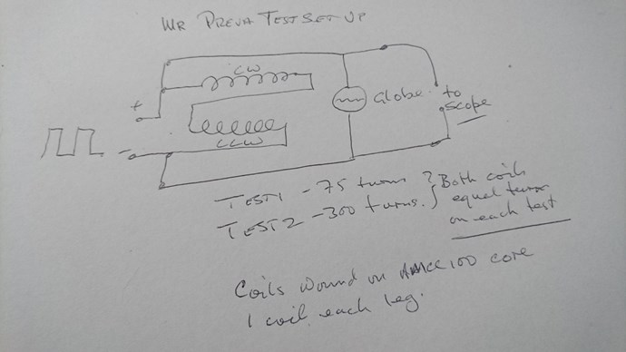

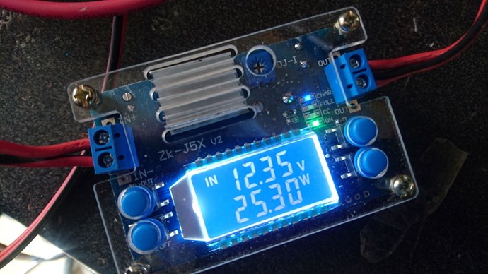

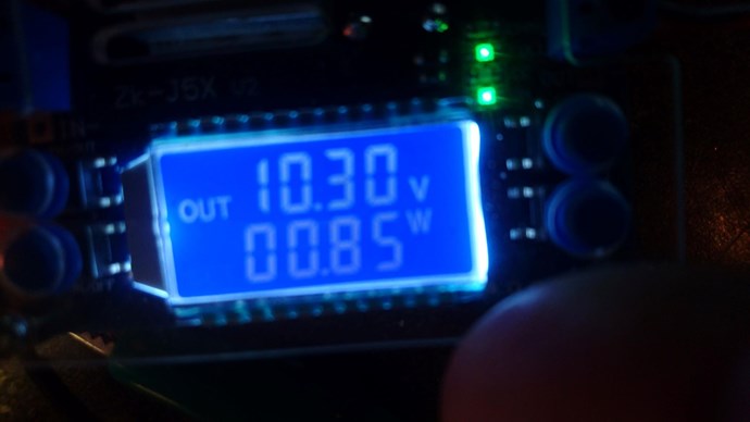

I have had some spare time this weekend to look at some testing. I have an AMCC 100 onto which I have wound at either end 300 turns of 0.25mm wire. Tjhis is for magnetic flux. The two cores I have wound 210 turns bifilar coi ls. So I am getting good response at 27KHz or thereabouts. i attach a photo of the output. This also will light one of the LED 240v globes. The operation is reassuring!
However, I wind 6 turns of heavy duty wire around the two cores, I set up Mazilli and capacitor and spark gap. I am not concerned with resonanc. I only wish to see any output and influence of flux pulsing. But, I get exactly zero response from the HV coil to the bifilar coils. I am a bit puzzled. I then reconnect the bifilar coils as series connected. No difference. Still no transfer of flux from HV coil to series coils. I would have expected the HV coils to interact with the bifilar coils.
Perhaps someone might be able to offer so insight to my results? Here is a photo of the flux pulse output only. Yellox is magnetic pick up at core. Blue is flux at close to resonance with bifilar coils.

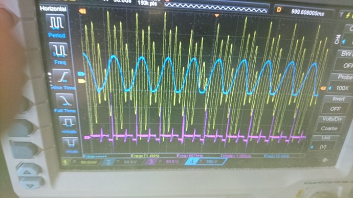

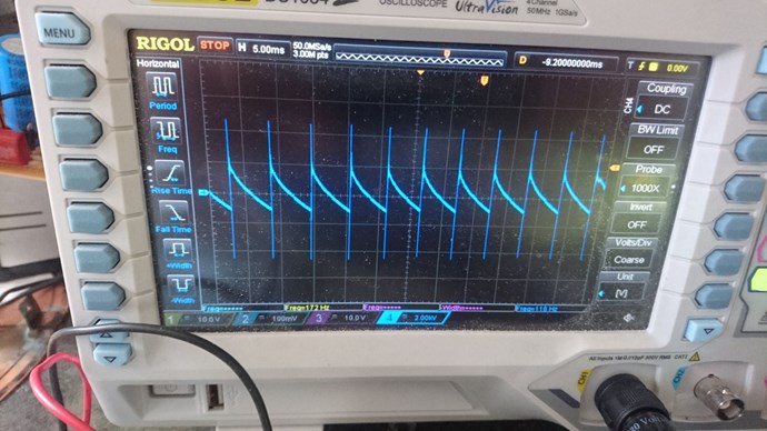

             Have had a couple of days to work on my thoughts! I think I get what is not literally stated, say with Don Smiths primary coils and also the tweeking of the coils for the "Clash of the Titans" using POC's. Took a bit of time and looking for a solution. I had made the mistake of using a pulse as a driver. Wrong! Let the input become the driver!!
Here are a couple of photos. One is the triangle sought. The other is a simple voltage and current regulator boost I got on ebay. quicker than doing the homework when I have very little available time at the moment. Input watts increase with ohms law as I raise the voltage, holding the current stable. Well there is a bit of drift, but, for a few dollars it has proven my thoughts.
Anyway, Christmas day here. Merry Christmas to you all!! And, a successful New Year!!
Ourbobby.
Chris posted this 26 December 2020
Hi OurBobby,
Thank You for Sharing!
I have to honest, sorry, your waveform is still not right. You're on the Flyback side of the Cycle, not on the "Generating" side of the Cycle. You're getting closer! Follow the videos I have shared, follow the specifics given.
The Ramp up on the beginning of the waveform is a tell tail sign of the correct interactions, that are required for excess Energy "Generation".
Thank You for sharing! You are getting closer!

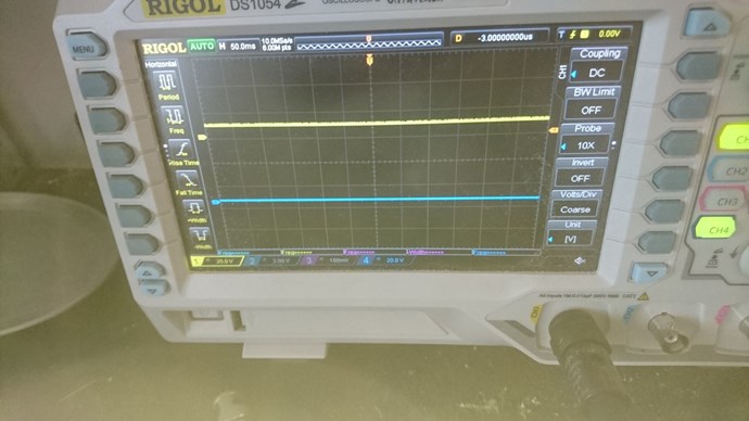

Ourbobby posted this 05 January 2021
              Gets tricky looking for the wave form! Anyway, to get a better understanding of the "vectors" I have been looking at the MrPreva setup. Here are a few photos showing my results. I must admit I am only using one pulse input and not ac input. Also I am taking the output across the coils. I have two coils CW and CCW 75 turns on each connected together. The input is just a basic pulse. I have the load in parallel with the joined coils. I can modulate the input to manipulate the wave form and adjust the output across the load- two globes in parallel. One is a small 12 v 125ma, the other is a 12 volt 50 watt globe. Although the photos indicate full bright ness, I reckon I am getting only about half plus brightness. Globes are hot to touch. The confusing aspects for me to explain are the very low wattage input to the test and the zero scope waveform output for this level of load output. The poor reading of the input is 10.3 volts and 0.85watts
ourbobby
Chris posted this 05 January 2021
Hi Ourbobby,
I see no waveform? Just DC?

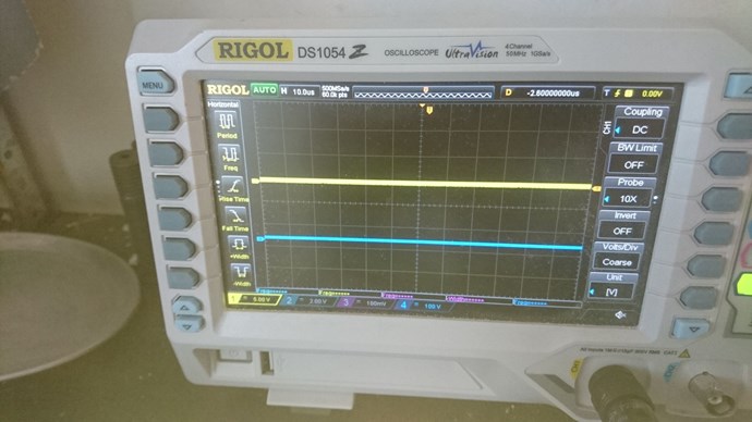

               That's exactly the issue. I lose the waveform as the globe brightens and the input wattage decreases. I have also tried this set up with coils that have a greater number of turns, 300 for example. However, the wave form decreases but not to this extent. And, I can run two 12v 50w globes! I shall try a larger wind to clarify this. Will take a few days to wind!
ourbobby

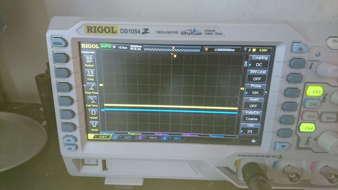

Ourbobby posted this 06 January 2021
Hi guys,
Just an update on my last post. My second test confirms the procedure of my first test. This was a simple set-up to allow me to study the effects with various coil configurations. I am not sure why the waveforms disappears and the scope flatlines!. It possibly has something to do with the set-up being at it's tuned resonance. The output from the 300 turn coils certainly exceeds the outcome from the 75 turn coils. For an input of 87.5mw I am getting approximately an increase of power of 1 to 450. the output to the 50w globe is very bright indeed, but, to be cautious I have suggested 40w output. The two scope photos are when the set-up is off and then when switched on, resonant setting being established. Anyway, here are some photos of the outcome of test 2 and my set-up.

Vidura posted this 07 January 2021
Hey ourbobby, What is your frequency? The switching circuit ? You should be careful with the reading of the digital display, Better place a current sensing resistor and a voltage probe on the input. It's a common issue that these digital meters fail at higher frequency. I don't want to say that there is nothing going on, you might have something interesting, just double check the readings with different options. Regards Vidura

Chris posted this 07 January 2021
Hello OurBobby,
Please Scope the Input Voltage and Current so we can see what is occurring, to help you out. Visit our Measurements Thread for more information. It is extremely simple and will help you to help us to help you.
Its been a long slog, from the start, switching issues, to seeing no sign of any switching at all now.
If you can show switching on the input, then we know where you're heading.

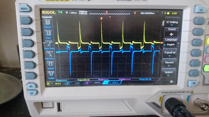

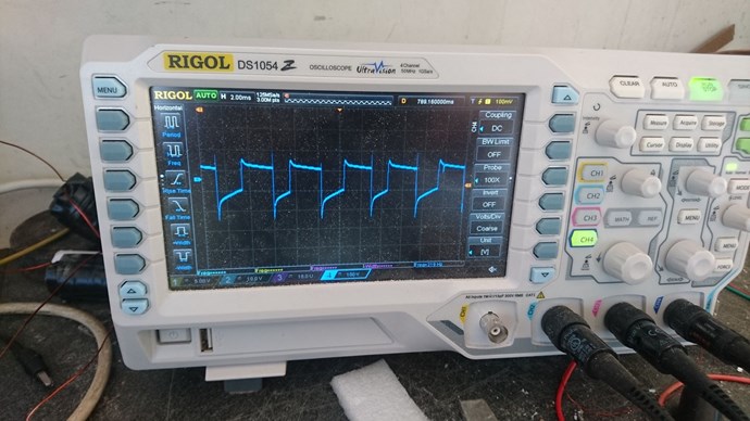

Ourbobby posted this 15 January 2021
Hi guys,
             Could someone tell me if these output wave forms form my twin MrPreva coils are whar I should be aiming for? I have two similarly wound coil pairs, each in a bifilar type configuration. They are alternatively pulsed. they are connected only with flux and are mounted on an AMCC100 core. At the moment I have them balanced. It is very easy to unbalance them with a change in coil configuration.
ourbobby
Vidura posted this 15 January 2021
Hey ourbobby, No, i think there is a switching issue. And the scope is false triggering, as there is a second pulse en between. If correctly triggered you would see an exact mirror image of the other trace. Anyway it is not the wave form you should have. Your switching circuit?? We can't know what you have on your Bench if you don't show information and schematic. Thanks Vidura.
