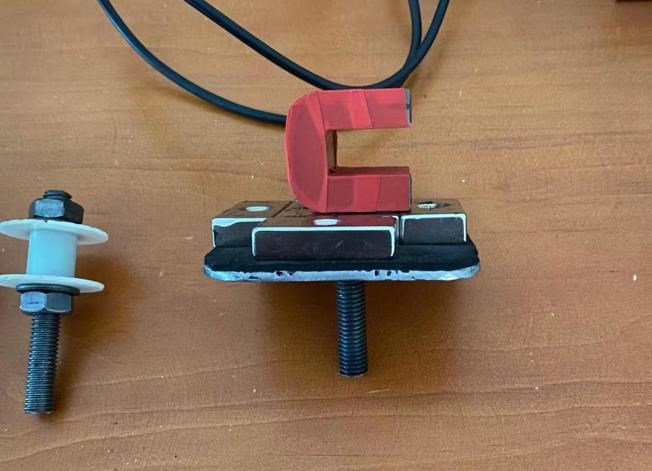

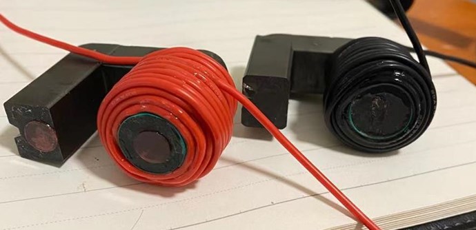

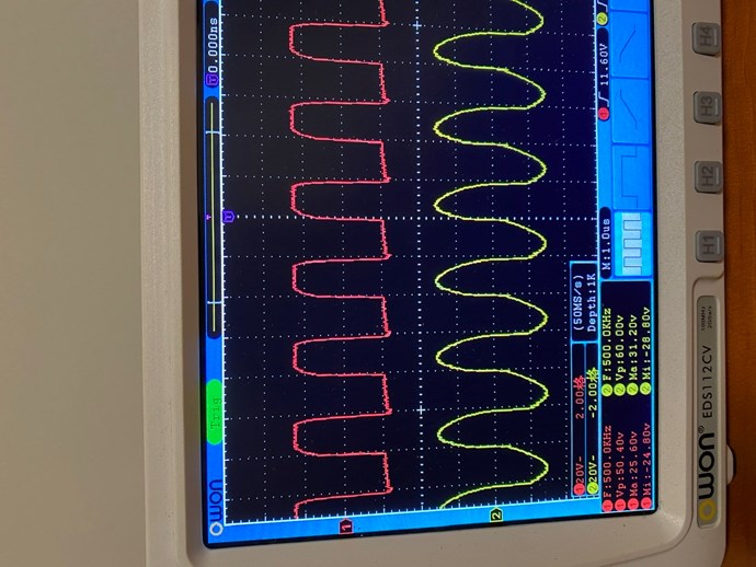

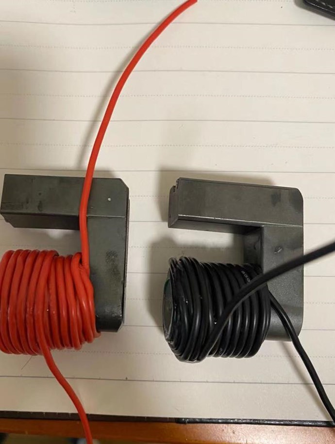

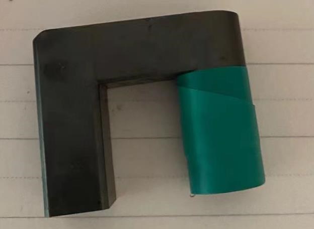

hi fighter,
I copied your experiment with a large iron core and a small iron core.
The oscilloscope shows the waveforms of the two coils.
I think it is impossible to form a standing wave in this situation.
Fighter posted this 14 September 2021
How many turns each coil has ? Are they approximately 150/300 turns ?
Did you checked to make sure the magnetic fields created by the two coils are opposing ? Like creating two opposing North poles in the upper side of the core and two opposing South poles in the lower side of the core ?
Also did you searched for the optimal frequency for your ZPM ? The procedure for frequency sweep ?
I'm asking this because the wave forms are not looking like the ones generated by my ZPMs.

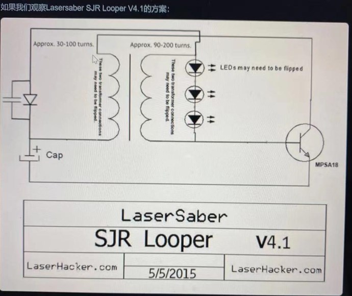

I started copying various battery-free devices from 2019

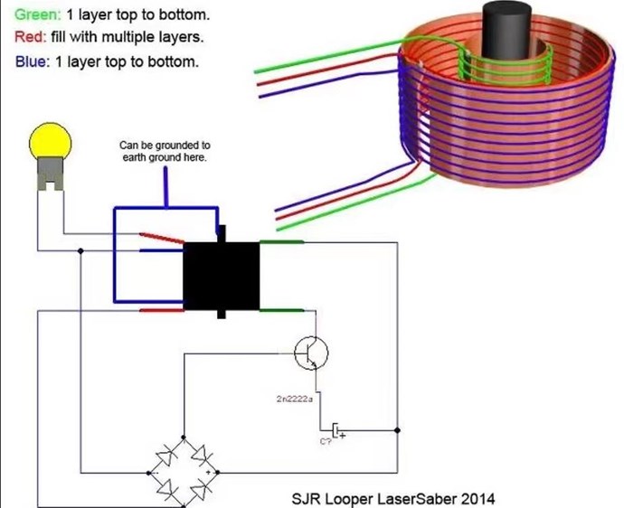

The first one I copied was SJR LOOPER
There are many drawings of SJR LOOPER on the Internet
There is one called Lasersaber https://www.youtube.com/user/lasersaber
He manufactured all kinds of SJR LOOPER equipment many years ago
And refer to the Akula #5 video to wind the coil
After several experiments, I successfully copied SJR LOOPER
Please forgive me for the short duration of my video. I didn’t have the habit of recording experiments with videos or photos before.
Scalarwave posted this 22 September 2021
Although the power of the SJR LOOPER I made is very small, but the LED can work for at least 6 hours
Although this is a joule thief circuit, it gives me a lot of confidence

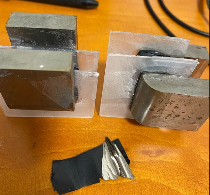

I think the key to akula circuit is 3 parts
1. The circuit control part is BJT or MOSFET, so I try various types of switching transistors
2. The winding method of the primary and secondary coil, I also tried every winding method I can think of
3. The choice of iron core, I tried thin silicon steel sheet, ferrite, amorphous
But I still have not successfully copied it, although I have tried various methods

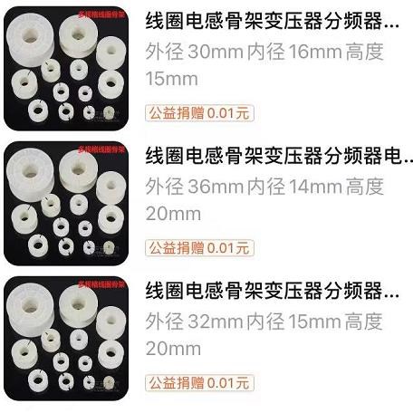

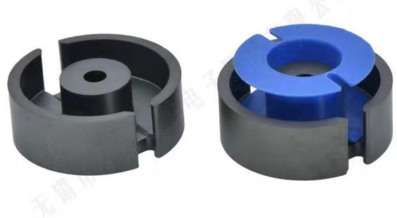

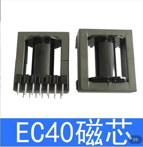

@Melendor
You can buy more of various diameters. In China, enameled wires are sold by weight. I also don't calculate how long a coil is wound with many layers.

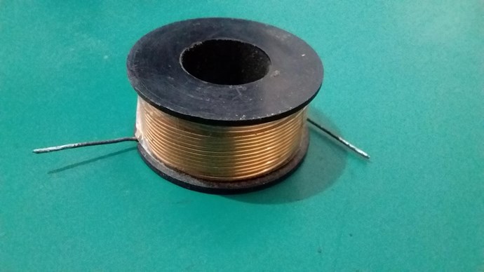

Hi Melendor,
Wire Length is easily calculated, simply Turns x Average Circumference. Average Circumference is Min + Max / 2.
Circumference = 2 π r
For Square or Rectangular Coils its just Add all 4 sides.
For example:
Lets take this coil:
We have the parameters:
  • r min = 8.75mm
  • r max = 16.5mm
Now we calculate:
  • CMin = 2 π 8.75mm = 54.977871437821378mm
  • CMax = 2 π 16.5mm = 103.67255756846318mm
Now get the Average: CMin + CMax / 2 = 79.325214503142277mm
Now multiply by Turns, 180, so: 79.325214503142277 x 180 = 14278.538610565611mm or 14.278538610565611 Meters.
Make sure you add some more onto the Length, as you will need Output Terminals.

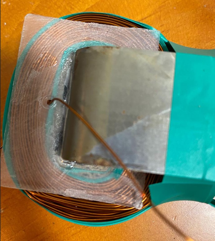

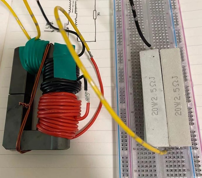

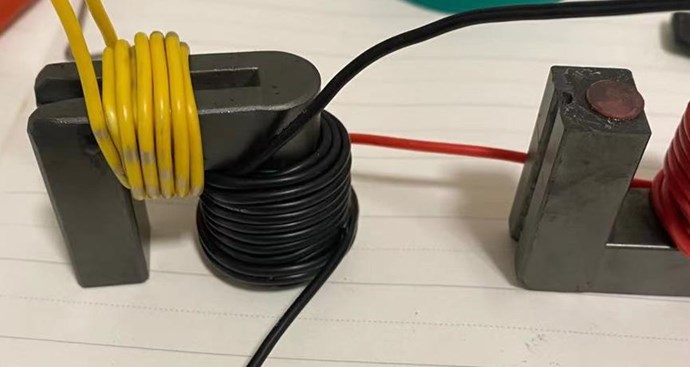

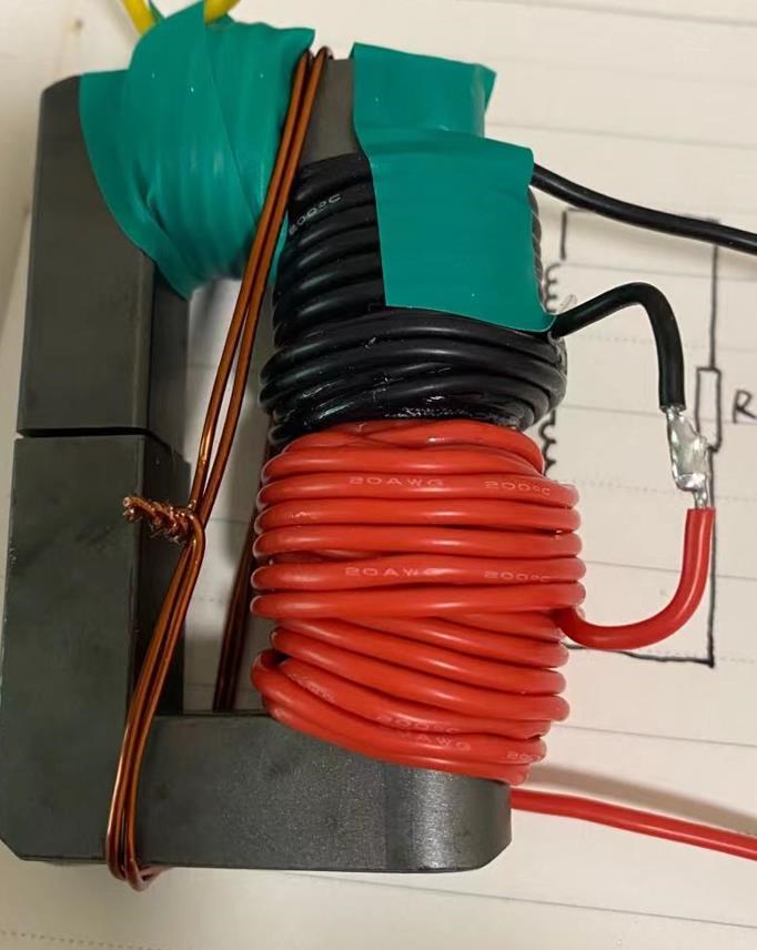

According to the drawings provided by Chris, I made a POC circuit
Some glue was used, so it looks dirty
Scalarwave posted this 23 September 2021
The yellow input coil has 9 turns, the cooperative output coil has 40 turns in red and 36 turns in black.
The model of mosfet is irfp250n
The initial output voltage of the DC power supply is 3v, and the current is 0.5a
The output rectangular wave of the signal generator, the duty cycle is 10%, and the initial frequency is 300hz
But the pulse voltage at the center point of the cooperative output coil I got exceeded 1000v, which also exceeded the range of the oscilloscope.
I will continue to adjust in the evening (China time)
I hope to see the appearance of sawtooth waves!
God bless me!
Is there a problem with the oscilloscope I am using? Or is it disturbed by the high current generated by the POC coil? I'm going to have dinner first, and I will continue at night.

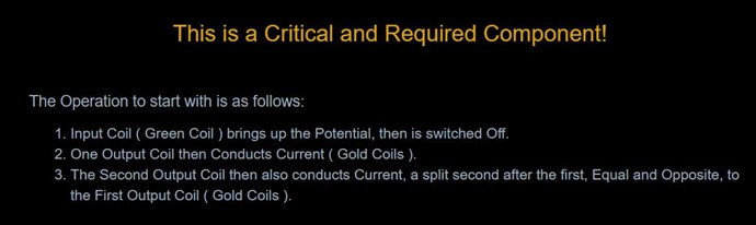

Scalarwave, if you're trying to replicate Partnered Output Coils there are some things to do:
  • the output coils should be equal (the same number of turns), meaning the black and red coils;
  • you should check that the black and red coils are generating magnetic fields opposing to each other, that's very important;
  • the yellow coil which is your input coil should be on top of one of the output coils (the red coil or the black coil, you choose which one);
Be careful, in the center of the partnered output coils high voltage peaks will appear.
If there are real 1000 volts spikes you could damage your oscilloscope.
Follow in details the schema which Chris provided, allocate some time to see the videos made by Chris, pay attention to details.
Don't do things in hurry and you will see the results, many experimenters here replicated POC successfully.
@Chris, if I missed something or there's something which should be corrected in the list above please feel free to update it.

Scalarwave posted this 24 September 2021
hi Melendor,
thanks for your reminder
I also know that there is still a lot of power output on my DC power supply. Like MR.Fighter, there is only a very, very small output on his DC power supply. I still need a period of adjustment.
I bought some plastic rings for winding copper wires。
In order to make the transformer more efficient, I don’t know whether it is possible to use some special-shaped magnetic cores with very small leakage flux.
I need to test

Scalarwave posted this 25 September 2021
Hi MR.Fighter
Regarding the cooperative output coil, whether the two coils are the same length, I still can't fully confirm.
1. With different winding methods, CW and CCW, the direction of the magnetic field generated by the coil will not be the same.
2. The relationship between the primary coil (input coil) and the magnetic core is that electricity generates magnetism,
The relationship between the magnetic core and the POC coil is that magnetism generates electricity.
3. The time for the pulse to travel inside the wire.
I remember that the transmission speed of electric current inside the copper wire is 6 inches per nanosecond,
This does not include the influence of the magnetic field on the speed of the current.
The pulse time is a very short nanosecond time,
It is very difficult to generate the right two interacting pulses at the right time and at the right place.
I think that for coils wound in different ways, this is not just a problem that can be solved by adjusting the frequency or duty cycle.
So, this is why many "trolls" will completely deny this technology.
This is just my personal opinion!
It may be that I didn't find a suitable method or a suitable "key" to have such an idea.
I have been doing what I should do.
Denying my own ideas is something I have been doing.
yes,the black and red coils are generating magnetic fields opposing to each other.Otherwise, I will not detect thousands of volts at the center point.
But, it is difficult to make these two positive and negative pulses form a standing wave.
In my opinion, it is as if two strong magnetic N poles and N poles are paired together, and they will easily slide apart.
So I think it gives us very little space to operate.
Or there are some other tricks that can be used.
I need to find.
By the way, does your re-made smaller ZPM work properly?
Chris posted this 25 September 2021
Hey Scalarwave,
Please Follow:
The Circuit:
L1 is your Input Coil:
Please do not deviate!

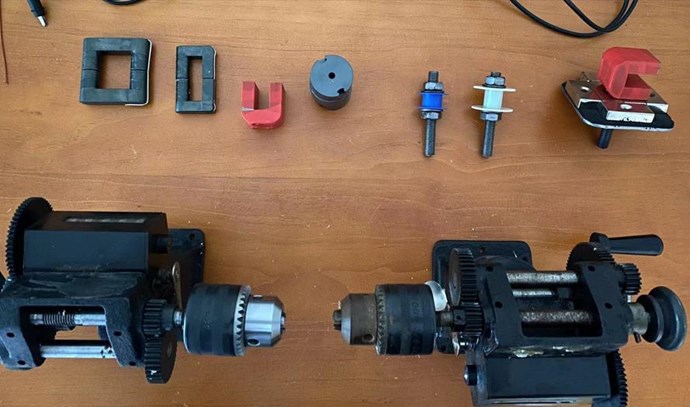

Scalarwave posted this 05 October 2021
Two consecutive holidays (Mid-Autumn Festival and National Day)
I have not received my purchase yet
Half a month has passed!
The manual winding machine I received before was damaged in transit, and I had to use an old winding machine.
I used thin iron sheets and strong magnets to make a fixture for the winding of U-shaped cores.
The strong magnets is very strong and will not loosen during use.
Strong magnets should not have any effect on the amorphous magnetic core, right?
Scalarwave posted this 30 November 2021
I followed the settings of MR.fighter and copied it completely
But it did not achieve the same effect as MR.fighter
Even the waveforms appearing at the three ports of the cooperation coil are the same
What is the reason for this? I am really not sure.
Do I still need to adjust the coil or other aspects?
Fighter posted this 30 November 2021
Hi Scalarwave,
ZPM can be replicated, all I can say is that an member of the AboveUnity team has successfully replicated it but I cannot say more without his permission.
I see you're providing  just 7-8 volts on input, try go higher with the voltage, I use 25 volts.
Is the signal generator providing sinusoidal signal or rectangular signal ? I use rectangular signal with 25-50% duty-cycle to drive the MOSFET.
Then do a frequency sweep as I do here:
When ZPM will start working at its optimum/resonance frequency you'll see your input current (amperes) going down (like just 0.03 A consumption), you'll see ZPM's specific waveform on your oscilloscope and you'll notice the MOSFET will get very hot, the radiator you use on MOSFET will not be enough to dissipate that heat.
Please check my videos and use the input parameters I shown in these videos (voltage, rectangular signal, do the frequency sweep procedure).
Edit: please make sure the magnetic fields created by the two coils are opposing to each other, that's very important.
Fighter
Melendor posted this 30 November 2021
Hello Scalarwave,
All the things Fighter has said above are true. 25% duty cycle , Square wave , more voltage to push a greater curent into the coils , Twin polarity on the coils N-N above and S-S below.
I want to add that your oscilloscope is Frozen. You can not Probe 3 different sides of a circuit..and get 0 modification on the scope. You probed v+ , middle of the coils and the source of the MOSFET without any movement on the scope monitor. You used the TRIGER Funktion to capture 1 single wave...and now you must hit Cancel or Auto. Love your coils and experiment. You did a great job. ~~~Melendor the Wizard

The common mode inductance is a cooperative output coil through suitable wiring
Scalarwave posted this 30 March 2022
This is a typical device. From the position of its primary coil (differential mode coil in the middle) and secondary coil, it can be seen that this device does not transmit and amplify energy through magnetic induction.
Although piezoelectric ceramics can generate a maximum pulse of about 20,000 volts, it can be seen from a few simple electronic components that the internal high voltage of this device will not exceed a few hundred volts when it maintains continuous lighting of the LED.
Although I haven't tried it, if I directly "ignite" the secondary coil, that is, the POC coil, with piezoelectric ceramics, I can be sure that the LED will not be lit continuously. So what exactly does the primary coil do? What exactly does a single-tube self-excited circuit do? What exactly is the energy transferred from the primary coil to the secondary coil?
I have seen many videos about kapagen, MEG, Don Smith device and many more. There are only a few well-known gentlemen who can really make OU devices. Many devices either fail completely without context, or are "on the road to success" all the time. Is it that hard to make a device truly run itself?
please forgive my chinglish!!!embarassedembarassedembarassed
