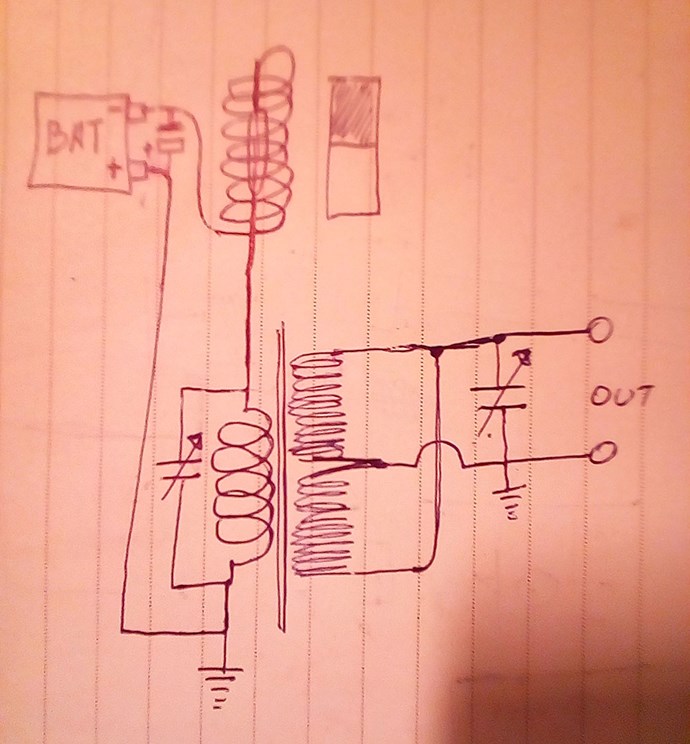

let me explain.
I wanted to make the simplest setup that may be proved overunity.. So I started from the primary side trying to spend the lowest power to make oscillations.
You know from past experiments that this classic reed setup is very efficient! It offers free bidirectional switching, with the cost of the difficulty to get a stable frequency and the current limits. That is working but the battery needs to be low capacity so you will not worry about excessive current passing through reed. Also a high inductance coil does act as current limiter, but to be sure do both. Of course effect proved me wrong and fried the reed. That made me stop and try to replicate the effect... So is my fault I should explain before I let you proceed with that circuit.
The main purpose is to get secondary and third in resonance but in a way that will not kill reeds oscillations... To be isolated somehow. This will transfer power to third coil and make secondary coil a big resistor, this resistor must not kill reed's oscillations somehow. So I am not sure I have this correct in my head.. It was in plan for testing it.
So again the circuit I showed at my thread is just a test, is not complete.! I am sorry my friend for my fault.. but because of what happen (growing effect), it was the reason I stopped and post it.
The secondary is bifilar... BUT It shouldn't .. remember I was testing... I had it ready so I give it a go..
The plan was the secondary to be electrically connected but be inductively separated coil away from primary, to protect reed's oscillations and be on a core with a third coil. (See image) So by having secondary and third coil in resonance with the reed working is most important. Power will be transferred to third coil and also because secondary is electrically connected to primary (remember primary is only needed for the reed to work.. It is not a real primary), will appear as a large resistor (extra current limiter) at primary.
Now the secondary and third coil should be tanked with a capacitor each, to be in resonance, the third coil in my opinion has to be POC.. like don smith secondary for best results. But even with a simple coil should work fine.
This is the circuit I had in mind.. So I will continue working on it..
Resonance is a must for the cored coils. The hard is to have reed also tuned.
The electrolytic capacitor at battery may be a problem, I just put it there for testing.
This is a basic concept circuit.

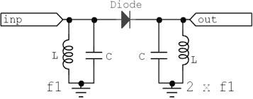

I know it is difficult to get more than 2Khz from reed but maybe a passive frequency multiplier can be between the primary and secondary coiling to bring frequency more compatible with the tank LC's. I am not sure it will fit but I guess it will not kill reed oscillations as long as the high frequency is a complete wave division. Just thinking.. needs testing!
https://doc.xdevs.com/docs/_Materials/Frequency_multiplier_circuits_survey_and_theory_ROSU.pdf

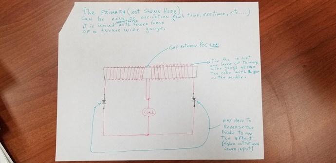

[img]https://www.aboveunity.com/content/uploads/b5d8d256-5657-4ec2-ac7c-a741014a20b4/e8ba81c8-a939-4ed9-8aa2-ab51014bd4fa_wistiti's-poc-experiment.jpg?width=690&upscale=false[/img]
The load should be on one coil only, the other must have least resistance for max Lenz to the coupled coil.
- Liked by
- and 1 others
Hi Alann
No, this is not correct! Wistiti is showing the Partnered Output Coils here! Equal load must be on each Coil at the same time to make this work!
Magnetic Asymmetry is how Lenz's Law can be avoided on the Input Coil, not shown in this image you show.
Experiment is the best path forward, we will help you if you want to gain a better understanding, please create your own thread.
The image I copied from this thread is correct then? I think this is the first one I see that resembles the 3d render with the U connection between the coils.
Then I did understand it incorrectly that one coil must have least resistance to maximally oppose the changing flux.
Hi Alann. You are right about what you say. It is one of the way. Im showing another's one like Chris said. There are different configuration where poc can be used.
Ciao!

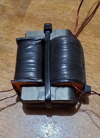

Hello everyone! I have finished to build the transformer like the one OS (OriginalSkywatcher) have share. It is an experiment i want to try since a while but have not and when I see him, it give me the will to go!😁 On my setup, the POC are 222 turns each (23 awg) and the primary is 55 turns (18 awg).
I have really few spare time for now but when time permits the next step will be the 555 timer control circuit. I plan to use the one shared by Jagau. Happy building to everyone! 🌞

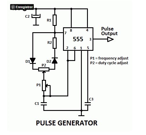

if you want a circuit that adjusts the frequency and DTC use this one
pot 1 is fir frequency and pot 2 is for DTC
A complete description here
https://www.electroschematics.com/pulse-generator-with-555/
