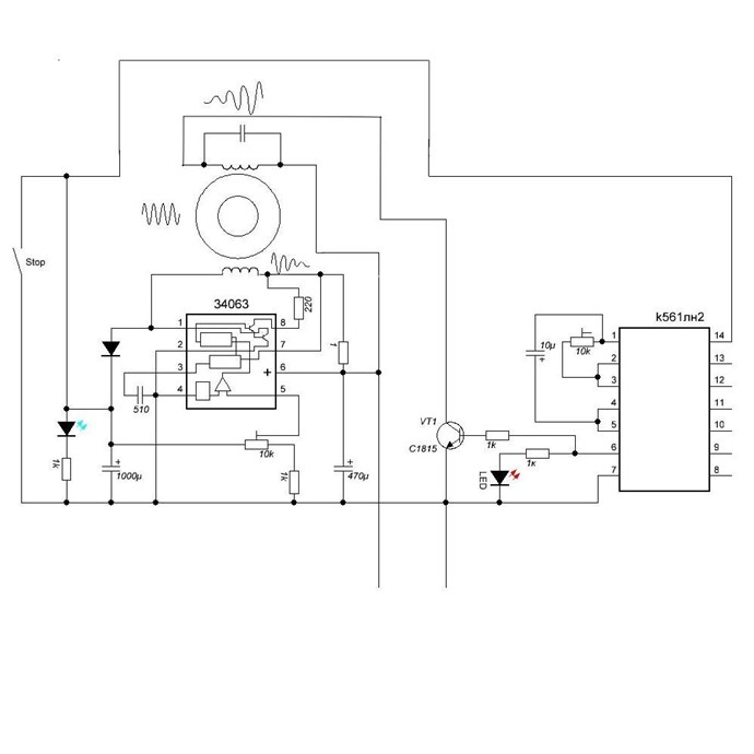

This is the schematic he is explaining on the video, I'll post the relevant details: the test points are highlighted in the colour of the scope traces.
He seems to point out that the CD4069  inverter is not needed, or not important for the basic operation, at least the shaded area, the inverter connected to the external FET forms a synchronous rectifier I would guess and could be probably replaced by a shottky rectifier if the CD4069 is not employed . The resonant oscillations are driven by the MC34063 chip, which  is an analogue dc-dc converter driver. Here the internal circuit from the datasheet:
Now this reveals a very important aspect of the operation principle: note that the fundamental frequency of resonance is 269Hz (the low value indicates that the coils are bucking), but the switching frequency of the converter is set to a much higher value by the timing capacitor C  on pin 3(for 300pF it is approximately 25uS  Ton and 10uS Toff). The Inverting Comparator input on pin 5 will shut down the switching when a the threshold voltage on the output is reached. So when the output voltage downscaled by the resistor divider  on pin 5 becomes greater than the 1.25V internal reference, the driver shuts down. With this technique it can be achieved by adjusting the variable resistor , that the switching occurs predominantly at the lower halfwave of the cycle(in the case of the boost converter, where the pulses at the yellow highlighted test point are negative), which will maintain the fundamental resonant oscillation with a minimal expense of energy.
Another detail that has called my attention are the copper sheets inside of the bobbin, which are found on some other devices of Akula as well. I don't think that this is a emf shielding, more likely it forms a capacitance or capacitor in conjunction with the second sheet at the inner end of the second winding. This will of course have no effect at the fundamental oscillation of the coils at 270Hz, but referring to the switching period of the driver with a 35uS period it will have a mayor effect, and might be used in this design to achieve a capacitive coupling of the second coil.
Note that in the following screenshot the schematic sheet which is below the circuit in the video has two modifications marked:
First a resistor in series with the output Led's -likely a impedance correction
Second the variable resistor for the shut down signal is changed  to a diferent configuration - for a broader range of adjustment
I think that this particular circuit would be a good start point to experiment as the basic design is quite simple. And in my opinion first the coil set have to be tuned to the fundamental resonance frequency, which is the tricky part, then the adjustment of the driver pulses and load impedance should be easier.

Hi all.
I tell you about the operation of the MC34063.
It is a hysteretic type DC / DC converter.
There are PWM controllers that vary Ton and other Toffs while their frequency
it remains fixed, it is not the case of this.
This type of control varies both Ton and Toff in normal operation.
If we apply to the potential ground 5 pin, the control will be in current through the resistor
connected between pins 6 and 7, this will cause Ton to vary only, but as
its service cycle is approximately 83% and remains fixed due
Since the Toff control is disabled, its frequency will vary according to
of the di / dt of the associated inductor in its output.
This is an approximate analysis of its operation, but I still do not understand
the phenomenon by which it is AU.

Mitza84 posted this 14 November 2020
vadik posted his video 3 and look at the description of the video maybe we can convince him to join us on aboveunity it would be very good .i have him on russian facebook il try to speak with him again but i know he is very busy and he is working on metal detectors for a while i was amazed to see him posted this video he told me he lost all the videos that he had about the device because he was haked or virus something like that .   this is his account on russian facebook     https://vk.com/delamorto
the schematic for this is this one   is tricky i got the consumption down to 1-2 mA but not self running yet
Hi Chris and hello guys this is how he describe the  operation of the device from above    delamorto:    Principle of operation - ferrite cups consist of two halves, the lower half contains a coil that excites the ferrites at the magnetostriction frequency, forcing it to rattle. This results in an RF magnetic field. It is induced on the second half of the ferrite cup, which enters into resonance and also rattles, there is a feedback coil in it, with which the energy is pulsed to the main capacitor, thereby compensating for the losses. It turns out a self-sufficient generator, the load of which is a white LED, the green LED indicates loss compensation (feedback).
Mitza
circuit diagram delamorto
Mitza
and this is all the answer he give about this project
delamorto( vadik guk)  :      time of run      20 minutes as much as possible kept. If you watched the video carefully, then you can see how quickly everything is cut off if the circuit is not self-supporting.
Now I would have assembled it easier, at the peak, with auto-tuning .... but I don't see the point - there is no power there ..... from the word at all!
@Simple Sergey Not everything is so smooth with math, you consider the load as an LED, I consider the load to be 2 generators and 2 LEDs. The containers that are worth I speak on the video, and I say again, REPEAT AT LEAST THIS! But not in theory, but on practice
Well, you know that Akkula fakes all his "products"
And if you remember this video, as it was the third, look for the first 2 parts, where waveforms are shown and the effect setting is described. And published because of the dispute how much you can squeeze
@FreeEman URI Stecho, the company that dealt with him said it herself, he got caught opening the device, found batteries under the windings.
@FreeEman URI all at one time on the forum was what from where and where. The video is not posted for repetition, but as an indicator that there are no megawatts in ferroresonance, there is negligible power.
@FreeEman URI I immediately said - this is the ceiling for ferrites, but in the video I said try to get it at least! Do not make plans for ferrites, this is not the source with which to resonate!
@Simple Sergey so everyone knows this, it's strange you don't communicate on the pages ?! Ask DOZOR for details yourself .....
Mitza
