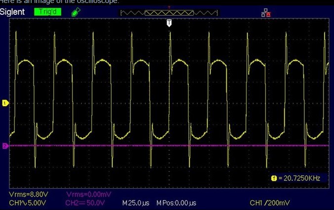

YoElMiCrO posted this 01 August 2020
Hi all.
@Jagau.
Yes, your circuit is 80% dependent on impedance maching
between both Generator / Load and 20% ferro-resonance.
I tell you that I managed to replicate it 100%, but only after
to properly couple the two.

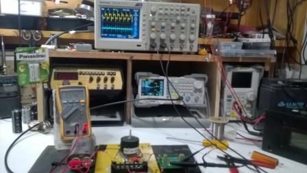

Here is an image of the oscilloscope.
As I commented earlier, the leakage inductance is the
causing to open that window to the sea of energy and the capacitor
to store it for later use.
Your two inductors coupled in non-inductive mode to be
biased cause leakage inductance to grow and polarize
the external environment to them, is that gap between them of which you speak.
If the current flowing through both is such that Ur is maximum
then the collector coil is capable of capturing said energy.
Thank you all in advance.
YoElMiCrO.

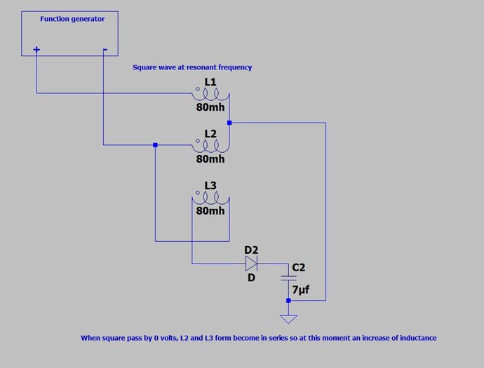

A circuit update more easy to read, 100 turns each and follow the dot.
The one i am working now. Do not forget the gap between the coils, this circuit is very simple but requires attention to the assembly and like the CD said,
it is necessary to understand the scene that the coils and how they work between them in order to connect them well,
Another update will follow with an emitter follower and an ideal op amp (TL084) in order to adapt the impedances well.

In the same setup, when I add a fourth coil and a second 7 uf capacitor I get 350 volts in each capacitor so 700 volts total and this without increasing the load at the input.
So a non-inductive coil does not affect the input only the magetic part is transmitted.
I think that's what Don Smith meant by only dealing with the magnetic side and not the electric side.

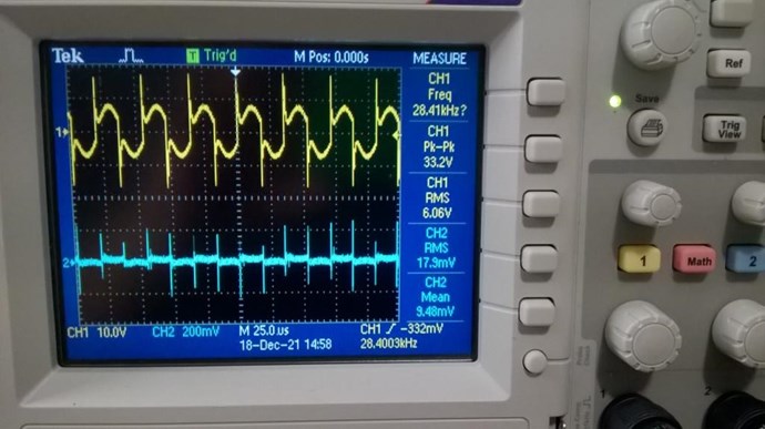

Jagau posted this 17 October 2020
Hi Yo
Excuse me Yo I had misjudged your oscilloscope image. You have probably noticed that even if you short the output it does not affect the input at all.

Hi.

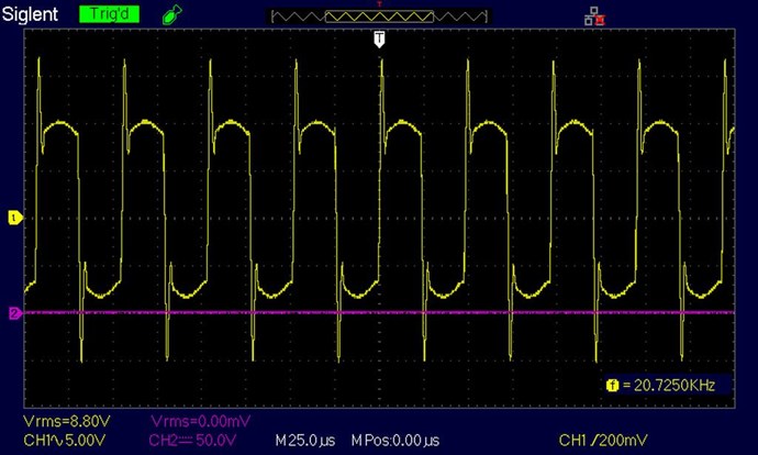

I have one of the resonance points. The yellow trail is the H bridge control sign. When this resonance point is there there is some recharging to the power supply.
Atti.
Jagau posted this 03 November 2020
Hi Atti
You mean that compared to the number of amps at the input you have the same result but the current drops at the input??

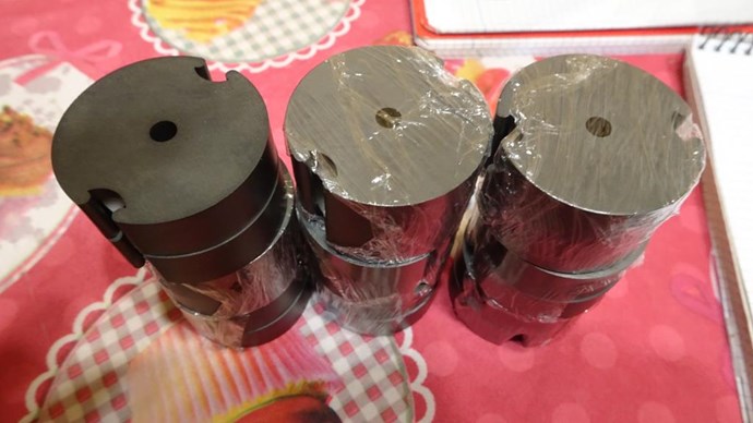

YoElMiCrO posted this 18 December 2020
Hello everyone.
@Jagau.
I already have the POT-Cores in hand.
I'm starting the experiments.
Buy 10, they've got 9 whole, all right.
Here's an image.
Thanks you.
YoElMiCrO.
Jagau posted this 18 December 2020
Its's look very good Yo
Good experiment and have pleasure with this.

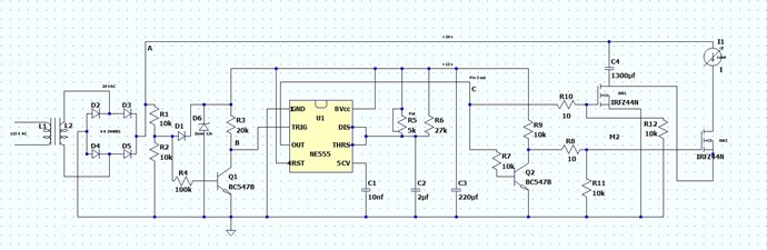

The construction of a zero crossing detection circuit goes well with the way switches (mosfet) are to be positioned in order to precisely control the 4 phases of a sine wave.
I wanted to make it a separate thread but I think it fits well here in the phase control of an asymmetric transformer.

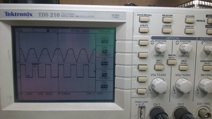

The 4 phases of a single sine wave.
As you will notice I have built a circuit which controls these 4 states. Circuit will follow at end.
I took a small transformer to demonstrate 115 volts AC 60 cycle-

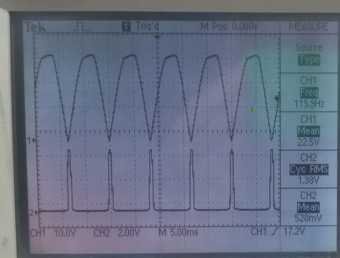

First the detection of the zero crossing
The oscilloscope allows us to see where the zero crossing occurs, and with negative cycle pass in bridge you will notice an increase to 120 hertz.
On the top waveform, see A point on schematic, that's what it looks like after passing a full diode bridge.
On the bottom form, zero crossing detection, see point C on schematic,  with the 555 on shot with adjustable DTC conduction time.
From there, the conduction time of each of these phases could be adjusted with this circuit
With a tlc555 configured in single-shot astable mode, at zero crossing the conduction time can be increased at will (duty cycle). A working cicuit with 4 cycles conduction adj.
With the 5K pot we can adjust S2 so that it opens and closes at the right time.

 In order to end the year on the right foot I would like to show you the again experience again a more precise way, which allowed me to go beyond unity, as a first step.
In the second I will demonstrate how to make the coils with lots of details and photos so that anyone who wants to replicate it can do it.
In the third step what I recently discovered as an improvement. It’s a lot of work to show those experiment on the web!
First stage; here a photo of the last montage with photo of the set up what the oscilloscope sees.
The calculation of the input power E in volts X  I in amps. X t sec. (E x I xT)
Which gives 6.06 volts X 0.0179 amps. X 3 sec. = input power of 0.108474 watt or 108.474 milliwatts.
17.9 ma are took on 0.1 ohm precision resistor as we can see value on oscilloscope.
As for the output power stored in the 8uf / 660v capacitor a voltage of 335volts in 3 seconds. I have done it more than 3 times with always the same results. This gives us a stored power of CV squared / 2 = 8uf X 335 squared / 2 = 0.4489 watt or 448.9 milliwatts.
Calculation of the performance factor of n = Pout / Pin = 448.9mw  / 108.474 mw = 4.1383

For the 3 coils of this project.
I have used on a 6800 inductance factor potcore and wound 100 turns for each of the 3 coils and it gives me 80mh for each of the 3 coils. Having tried different types of cores I have found that the results are pretty much all the same so other cores do, but keeping the same electronic diagram and the way of winding the coils.
The first coil L1 is clockwise 100 turns,
The second L2 coil is counterclockwise 100 turns,
The third L3 coil is clockwise 100 turns too.
It is important to isolate between L1-L2 and L2-L3 with electric tape the capacitive effect that this gives to the coils is important and by checking it with your LCR meter you will notice the minimal inductance with L2-L3 in series, it should be way below 100 uh if you got the job done well.
L2 and L3 are in opposite series (buck mode) and the third L1 is the output, it is very important to note that we are pulsing the coils L2 and L3 in order to have an output on L1 which is the first coil wound and which is closest to the center of the potcore given that this is the first coil that I wound.
I explained this before I think I was misunderstood, we are pulsing L2 CW and L3 CCW which are connected in series (buck) and the output is on L1.
schematic by PM only
Any questions?

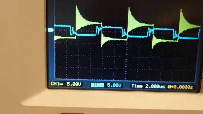

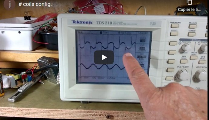

see what you mean ,so the in and out windings are isolated from each other, it is the principle of an isolation transformer, there can be no loop in the input and the output.
One of the cases where we can have a ground loop is when we place two measuring devices with the same common ground (earth ground) as an example a generator at the input and an oscilloscope at the output having a common mass.
In the video I plugged in the oscilloscope to show the waveforms. The same results are even after removing it and the same when I run it entirely on battery with a TL494 oscillator powered by a 12volts DC battery.
I use a battery powered DDM on the output for the voltage measurement and you will see it after the holidays the system works entirely on 12 volts battery so no ground return.
There is no power supply or battery in my circuit which provides voltage.
The Function generator has a maximum output power of 0.5watt and at this frequency 0.1 watt then the surplus come from where?
it comes from the current without mass which is converted by the capacitor into coulomb and which can be transformed back into current with mass, as Tom Bearden explains very well in his technical documents.
